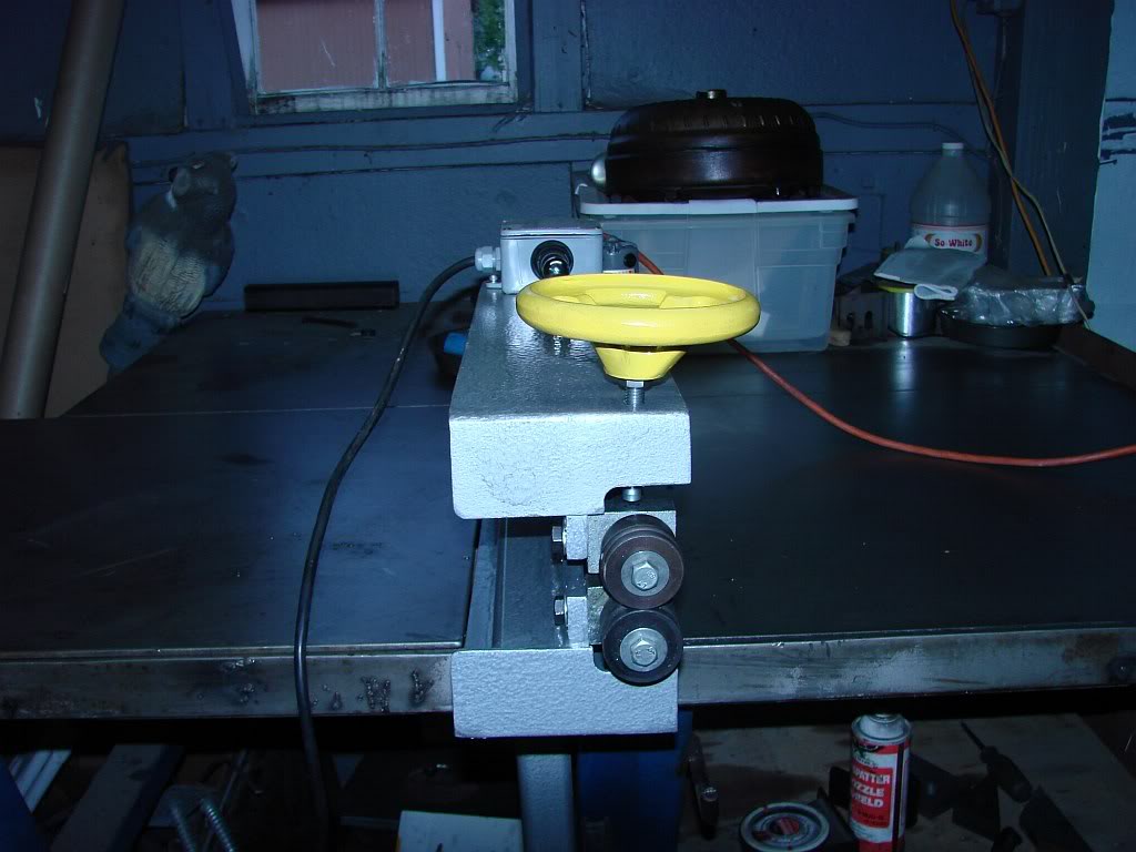

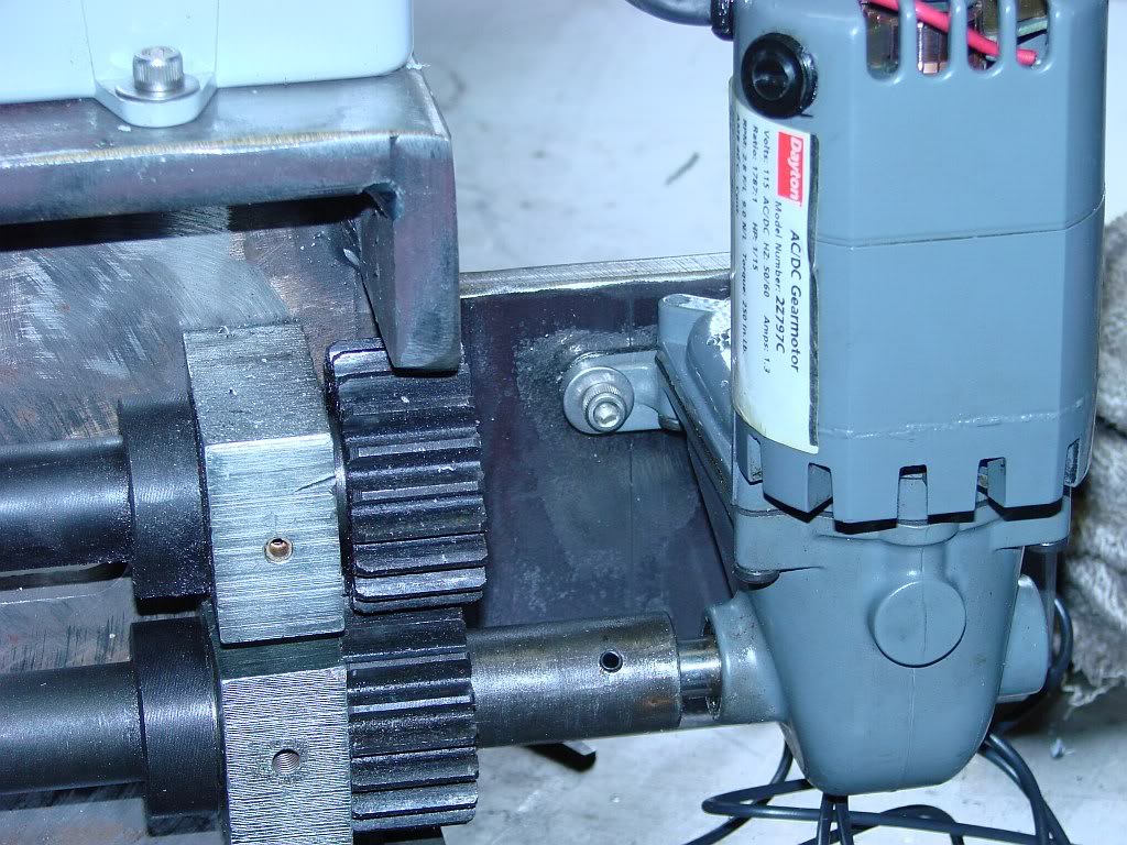

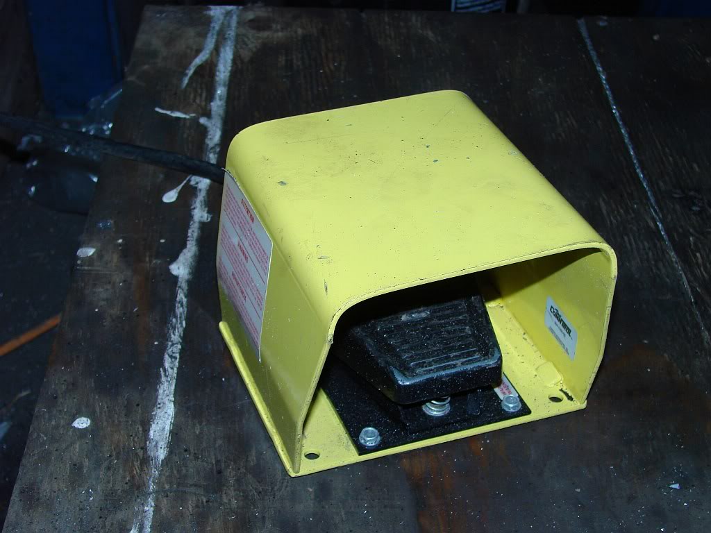

The bead roller I have is a Woodward Fab unit from Summit.
The pins I use are called cleco pins. They are like a reusable mechanical rivet. Very handy for things like this.
