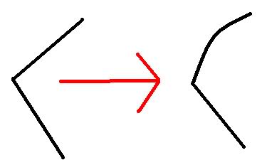

Sweet, sounds like you had it all planned out. What I ment about the wheel smoothing the swage isn't if you run over it, but if you are creating a curve 90 degrees to it you may artificially lessen the swage. Kind of like what I have below (though I suck at paint) or is this not an issue? Just curious to see how the metal behaves in this situation

Yeah I see where you're going with that. It wasn't really a problem with this though as it's such a shallow panel, and the main compound curve is high in the guard. If it were folded and curved as much as your drawing then yes you are totally correct. I did over fold the centre swage a bit, as I knew where I hammered in the flare would change the shape too, and it's easy to flatten a panel, but not easy to put more fold in once the flare is hammered out. Does that make any sense?????
Just so people understand what Sam is saying, whereever the top and bottom rollers of the english wheel touch the metal, it creates a high spot, so if you roll a panel too much in one spot, you need to roll the rest of the panel to bring it up, you can't roll things down.
