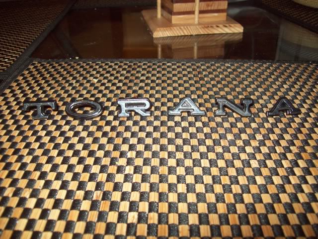

Clips that look like this (There are 12 of the suckers):
I fixed these up while I was at it:
Let me know if you want measurements. They are plastic.
The other post I saw looking for this one suggests that some peeps silicon them in (little silicon). I don't like the thought of silicon and paint, but anyways.
Thought I was missing a letter, but I aint. Woohoo.

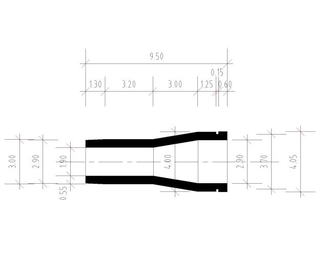

Mmm, I'm onto it, but the nose cone I'm currently preparing has holes at 3.6mm or 9/64 measured with veneer calipers and confirmed with a drill bit. Drawing to follow shortly.
Pins on letters 2.4mm dia.
#40 _Yella SLuR_
Posted 10 January 2012 - 09:48 PM
Drawing. I only measured to the nearest 0.05mm. Plugs are plastic and round.
Edited by Yella SLuR, 10 January 2012 - 10:02 PM.
Thanks for that I will try and find the correct ones

I have some original ones. Hanra, PM Les your address and give them a whiz. You could send me a couple to compare the fit with the old ones. I was worried that the little nick measured too small, considering the go into 1.6mm steel, but that's what it measured.
