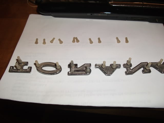

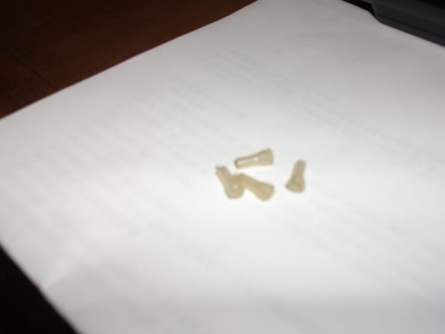

I assume these are the plastic plugs you refer to.
The ones pictured are a mix of mainly NOS ones & a few mint second hand ones. How many would be needed for the purpose of reproducing them. I would like to help if i can but i am reluctant to part with them as i spent years searching high & low for them to use on my SL/R project & i would only be willing to do so if they were returned or replaced with exact the same quality/quantity. Cheers Matt

Posted 01 November 2012 - 07:16 PM
Thank you for putting your hand up Matt!!!! Hopefully Les and the Team at Rare Spares can help out here!!!!
And I think your requests are more then satisfactory!!!!

now thats a rare bit if ever i've seen one

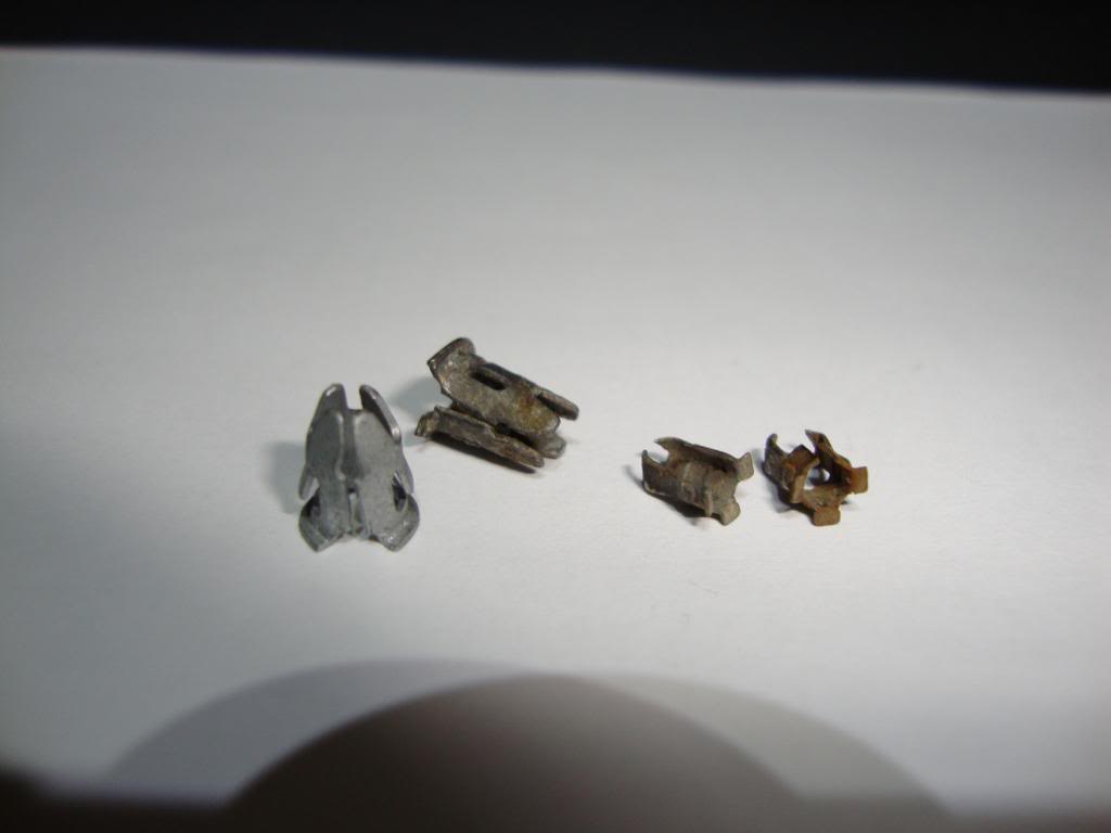

Hi Guys
While I have been doing a little research into Badge pin locations, I have found that the above letter badges that I have do not have the plastic plugs. They have a metal clip similar to the larger badge clips.
Looking through the parts catalogues, they list the following;
LH
1.265 LETTER, CLIP, NAME PLATE, TRANSFER - Front end panel
Clip, Letter: SP2419 Qty 12
12.182 Letter, Plate, Clip,Rear Deck Lid
Clip Letter Attaching: SP2419 Qty 12
LX
Hope this helps...

My original LH nose cone had the same plastic plugs as shown in the photos posted by LH SLR 3300.
The plugs are inserted into the holes in the nose cone from the front and then the letters were installed. They dont go onto the back of the pins once the letters are fitted into the nose cone as you might suspect. I tried to remove them without damage, but they are hard and brittle, l now have about half a set.
