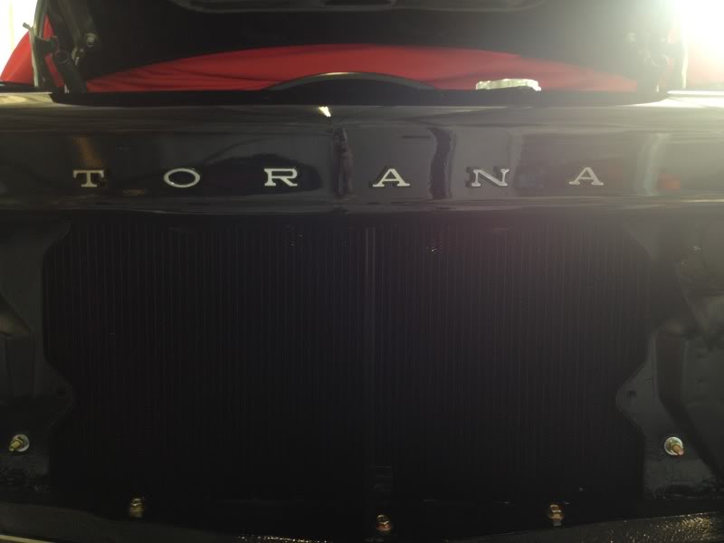

just found some suitable old stock plugs for the torana, but as I checked my new rare spares letters I noticed that the N letter has 2 thick pins instead of like the other letters.
they are a very snug fit to the hole, meaning no plastic plug could be used and the metal cup that fits on the back wont fit either. WTF
