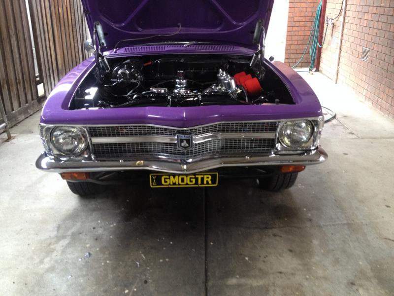

Well, car is officially registered. Just a bit pissed off as i have to go back and do some stuffing around to get my custom plates registered, i had to buy standard plates for now. Nothing ever goes to plan. They also wrote the market value for me without me knowing and overcharged me a fair bit. Ive emailed the state revenue office, i wonder if i can get a refund? Seriousness aside i would never have declared the eBay value, and he must have written down what was on the receipt. So apart from the bitter taste of lost money im pretty happy to have gotten it driving. Car behaved and didnt spew any water, so i cant complain. Just havent driven it in heavy traffic yet.
Im pretty happy with the drive, speedo was making a noise so i refitted it to the dash and it fixed it. Pretty used to the reversed shift pattern now so might leave it. No flat spots, but im still going to try and get down the the carb builder this friday as he retires for good this year.

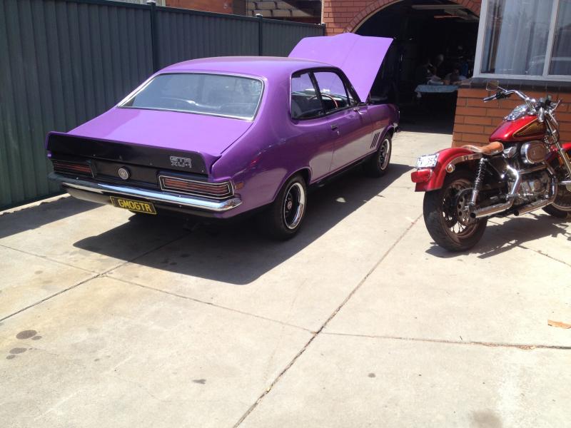

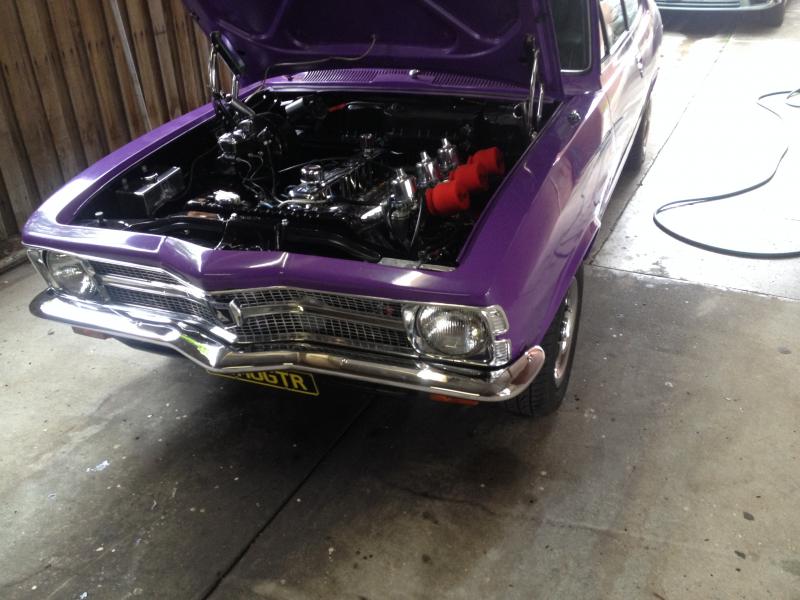

Few pics:

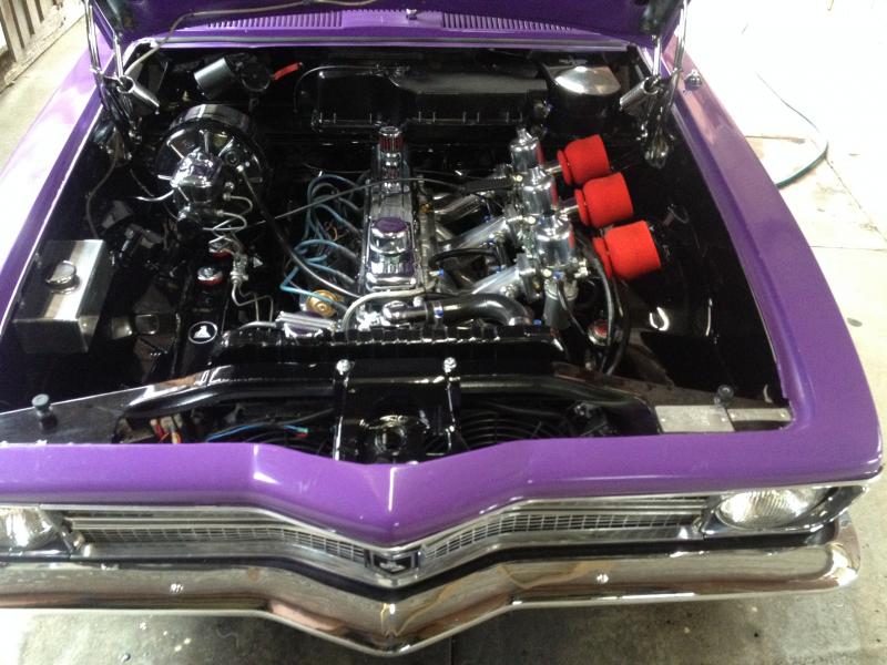

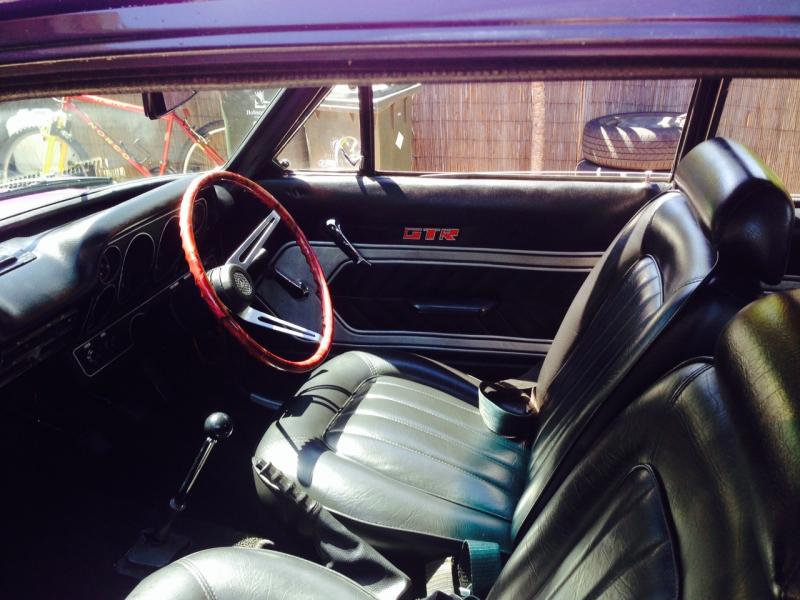

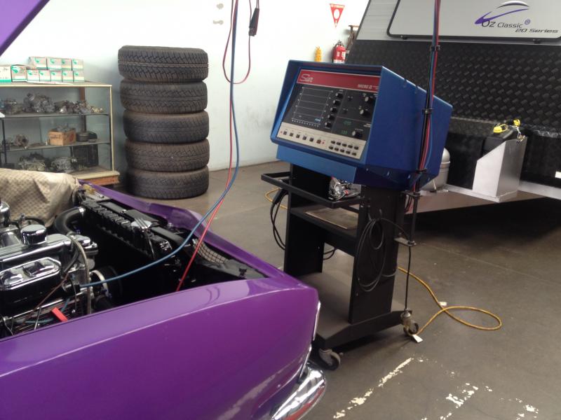

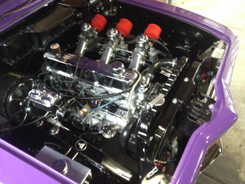

Anyway forgot to ad these of when Mr Wilson gave it a tune, and the interior. Still have to get up a pic of the headlining.
