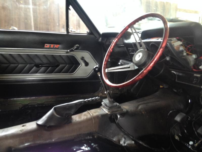

Marty figured out the problem... I switched 1/2 and 3/4 around so 1st is third and 2nd is 4th. Whoops. Makes a lot of sense now.

Just a swap over at the shifter's all that's required. You can see in Jacob's build pic he got them mixed up.
