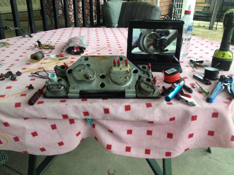

As for the wiring it had a standard dash put back in so there was a circuit for the alternator, now I have to re wire it for the xu1 dash. The wiring diagram shows a wire going to the alternator (for GEN light) and also a power wire from the same circuit as the gauge power. Can I just loops the gen light power from the other lights?

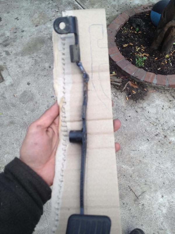

Cut and shut my new accelerator pedal. This will stop the pedal from sitting 3 inches below the clutch and brake.
Dash station
