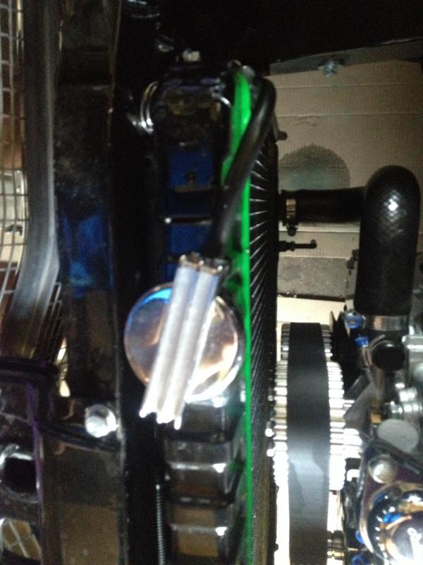

Well anyway, fixed the temperature gauge issue. Turned out to be the wrong sender and a VDO one did the trick. I explained it in more detail in the separate thread i posted. So it still gets hot (needs a cowel), but at least i can see it climbing. Sometimes i notice coolant just bellow the top tank of the radiator on the side in that little lip. Just cant figure out if its coming from the cap or leaking out of the overflow outlet.

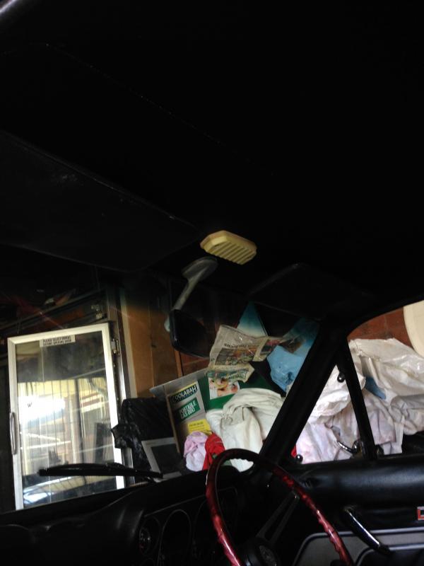

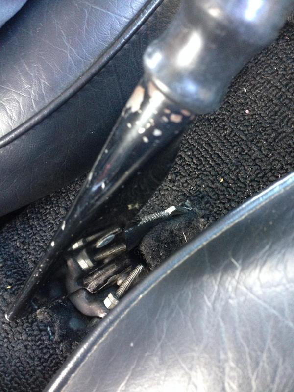

Got the headlining in, pretty happy about that, but he bent the absolute shit out of my rear view mirror which im not happy about. I wonder how i can straighten the base to stop it from rocking back and forth. Apart from that my damper came off my SU and it turns out the thread is broken. So now it pops off and throws my engine out of tune. Not sure if i can glue it, pretty desperate for a replacement so i can drive the car this weekend. Also noticed that my rear screen was put back in sort of the one side, how can i shift it over so it closes all gaps evenly?

i dont know if you can see but the thread had split away from the actual top.

Ok now i seem to see this a lot lately, after i have driven the car and it has cooled down (typically the next day, never on the day). I cant figure out where its coming from. Doesnt look like its leaking from the overflow hose, so it must be coming from the radiator cap. But its brand new, as is the radiator?

Could be the radiator cap or upper hose or a fault in the solder joining the top tank to the core or one of the fittings into the top tank.

It's not the auto line it must be a bit of an illusion but the coolant is in the lip of the top tank. I too was thinking overflow line but there is no evidence of it dripping coolant.

I'll have a look but it's strange as it does it only when cooling
I think you're on the money with the top hose I didn't even think of it. Perhaps it has something to do with the thermostat coil being fed through.

Did you put the little rubber spacer in with the thermostat tube inside the top hose?
