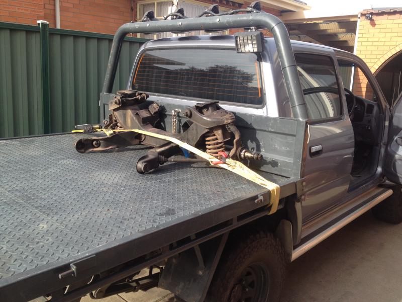

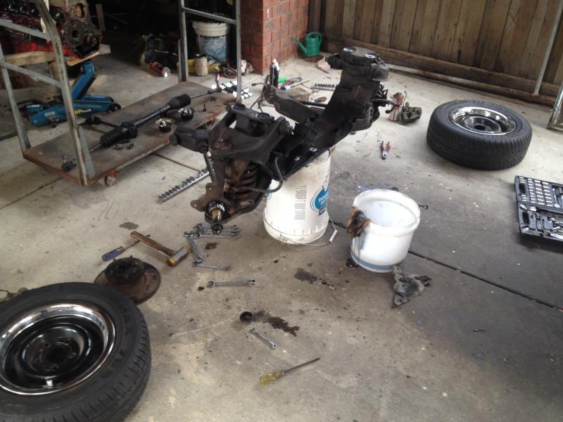

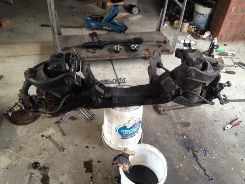

So pretty much separated the k-frame from the engine as it is due for sand blasing and powder coat. Contemplated 2k but for $250 all up i cant go wrong. Pulled it apart and off it went. Only problem is i stripped on of the brake line fittings and it's pretty much done for as i had to cut it off. What can i do now? Would my best bet be to find a second hand brake K frame brake line?

If your getting that k frame sand blasted you need to strip it completely down wishbones and all
And all the way back i came! Ill be stripping it sat!

Apart from that spent most of the day pulling the bushes off the k frame. Was pretty happy with the result. Used piping and sockets to press out the control arm bushes in my vice!!! Who said you need a press? Also spent a bit of time hammering the crap out of the ball joints. Had to drill the upper ones out and sort of enlarged to holes. Should i be worried or will the new ones just bolt back in?
