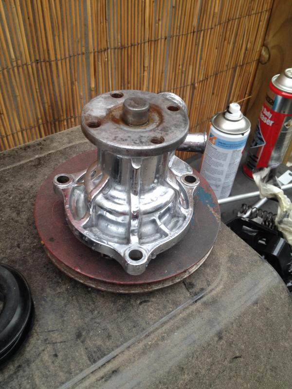

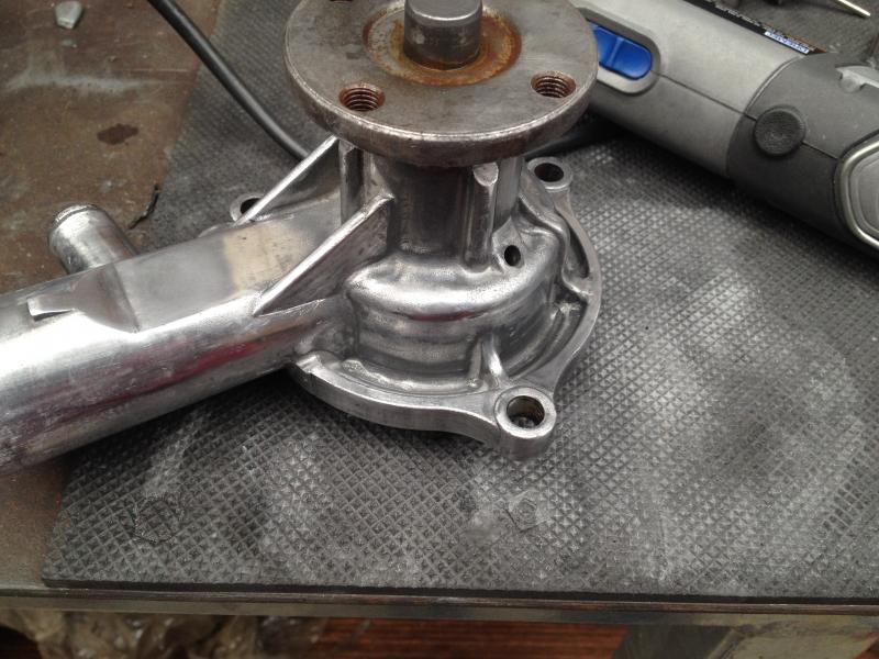

p.s. the water pump gilmer pulley is probably for a long shaft pump and you have the short one,
I remember they only sold long bearing kits and I cut the shaft down for my short pump.
p.p.s. fine scratches come out with finer polish, uncontaminated

You may be right about the polish. I think its because my flanno rag is way too dirty. It is black after all.
 My question is are they even worth the extra $100 with standard girlock calipers.
Hi Jacob,
Throw away polishing materials when used too much and use the same polishing material with each grade of refining,
also could not dimple and slot 4 sides for $100. Dave I

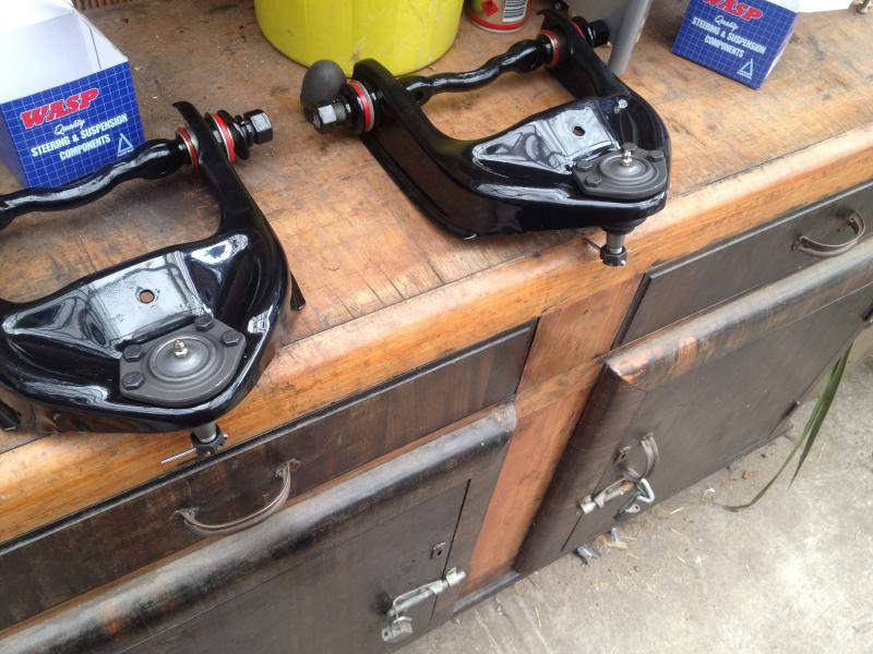

Calipers are gone and will be cleaned and painted. As well as shifter linkages which will have the slack taken up. Idea is to get everything as tight as possible.

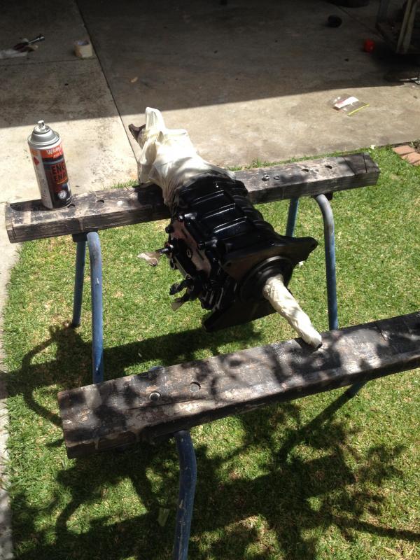

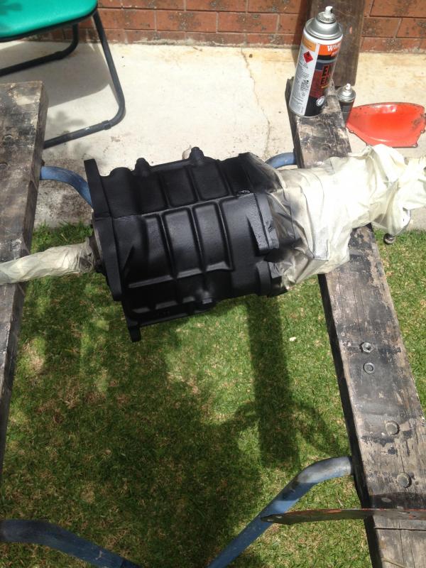

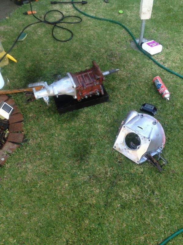

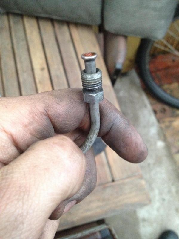

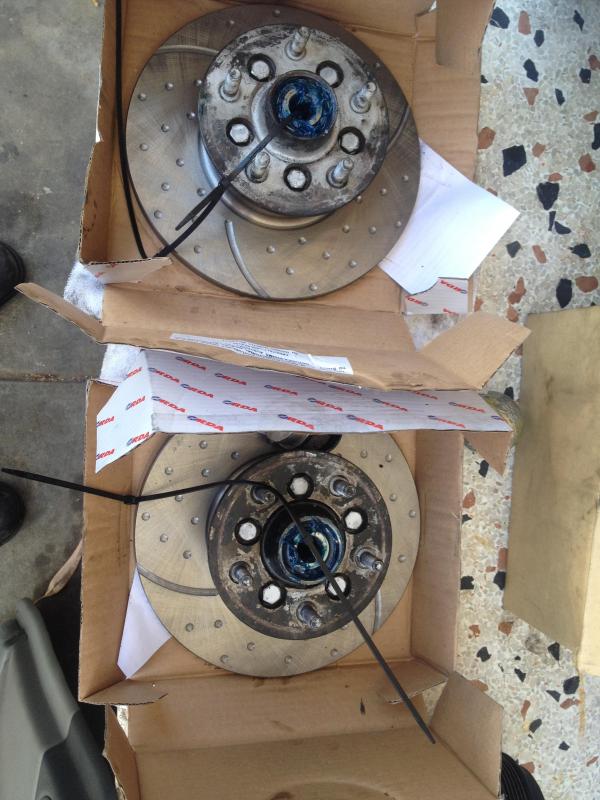

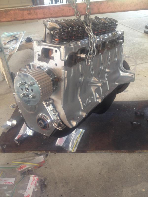

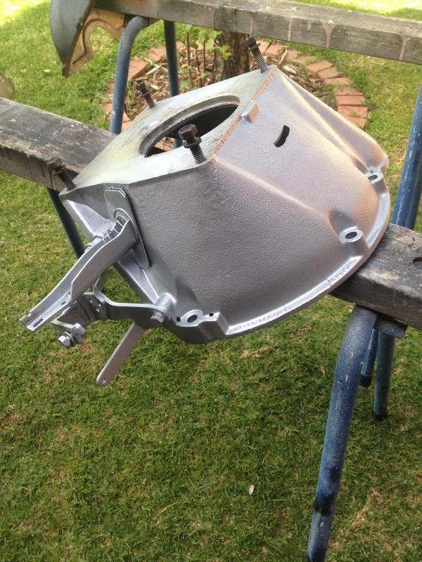

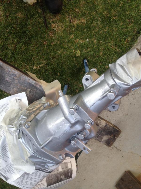

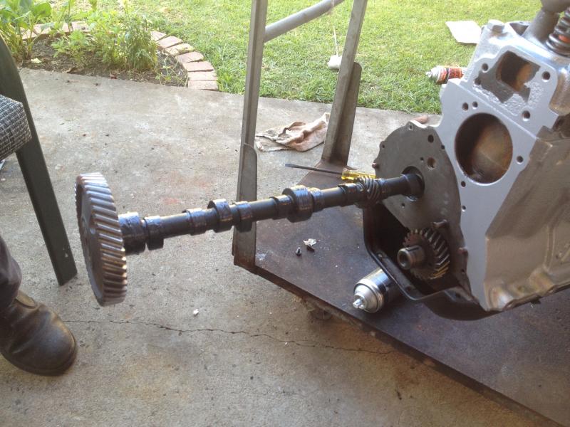

Ok well things are getting tricky. Sort of running out of time to finish. Just waiting on my discs (drilled and slotted). In the mean time have to put the k frame back together, polish the engine bay, paint motor/box/fit clutch and assemble everything else. Still need some braided line so if anyone knows who stocks it in Melbourne that would be great. Also, do i need to run a hard line from the fuel pump the fuel block or can it be rubber/braided?

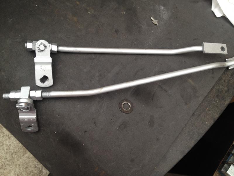

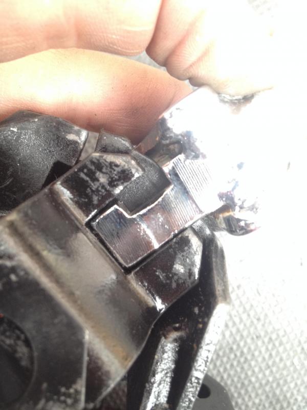

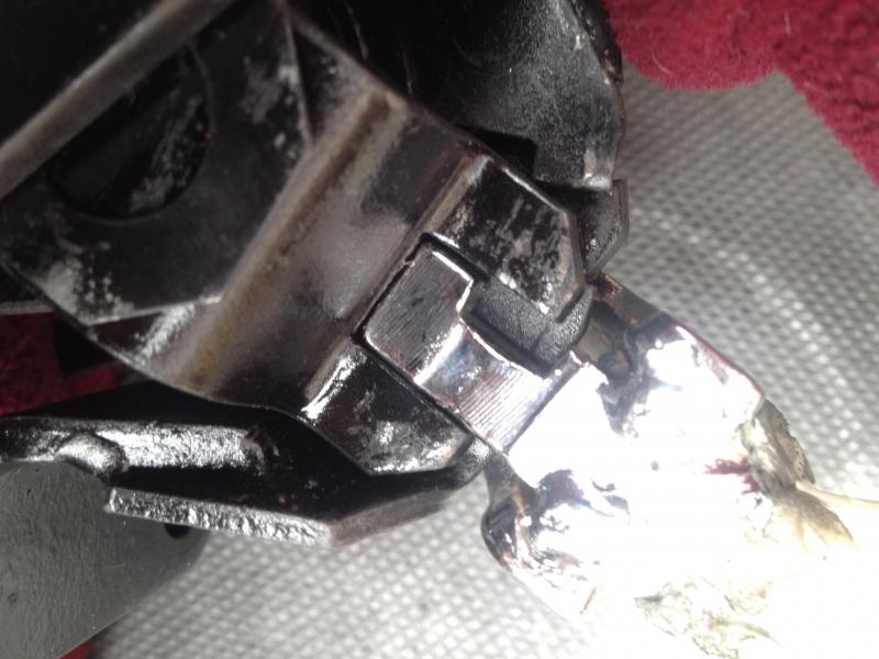

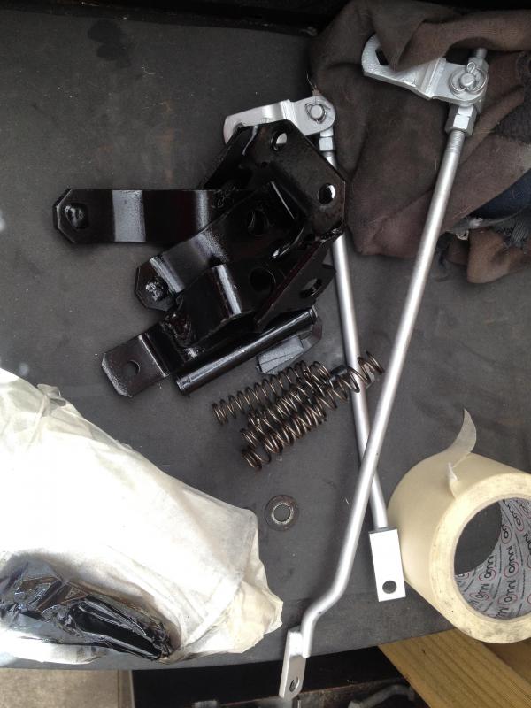

Now some opinions needed. Do these gates need welding? there is a little bit of play, is that normal. Will making them tight eliminate the sloppyness of the gear stick or is that what they are like? I have never used a 'new' on so i have no comparison to draw from.
After
Before

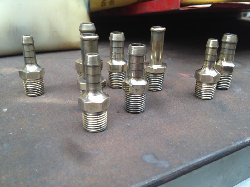

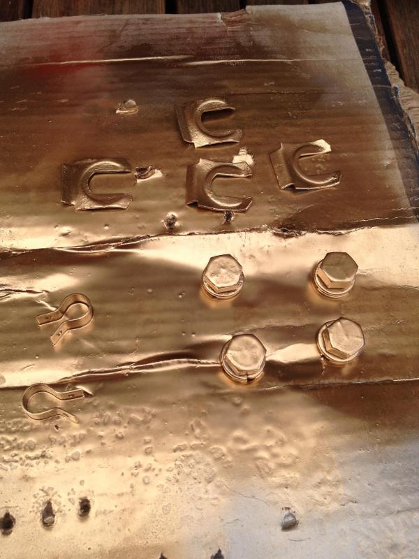

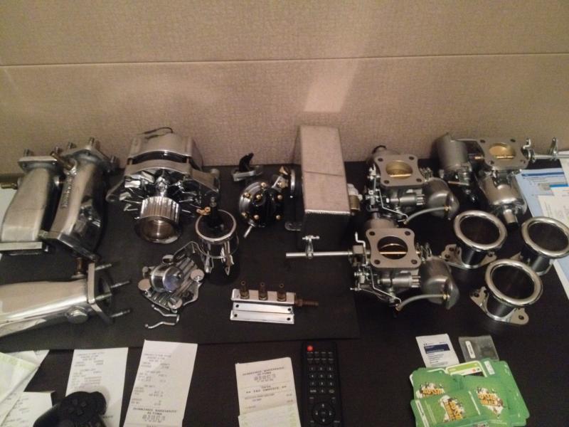

Polished my brass fittings (mostly just the heads)
Some new toys
Before

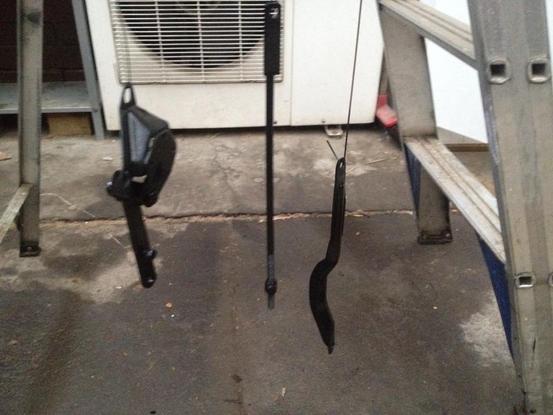

Everything rebuilt, no more sloppy linkages.

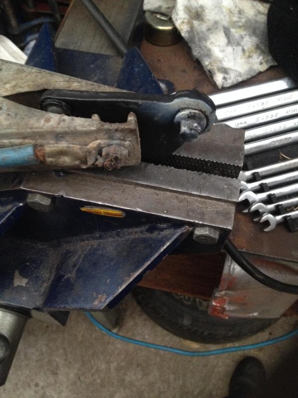

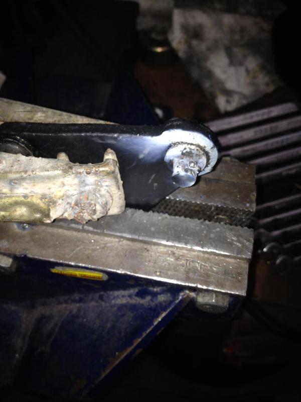

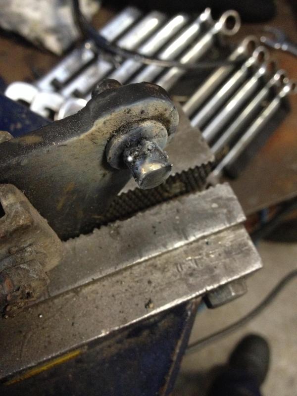

Badly worn rat trap pivot points. Filled with weld and re shaped.
Finished product

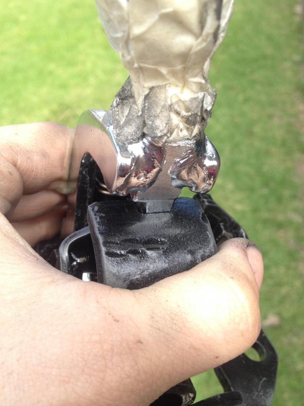

Tried reflaring some line, turned out pretty crap. Need to re do?

Haha someone gave them to a fam member and they were given to me to sell. I had a look and cannot be bothered. Its all just enamel Hayden, probably looks better than it is. The cleaner and smoother the surface, the better.

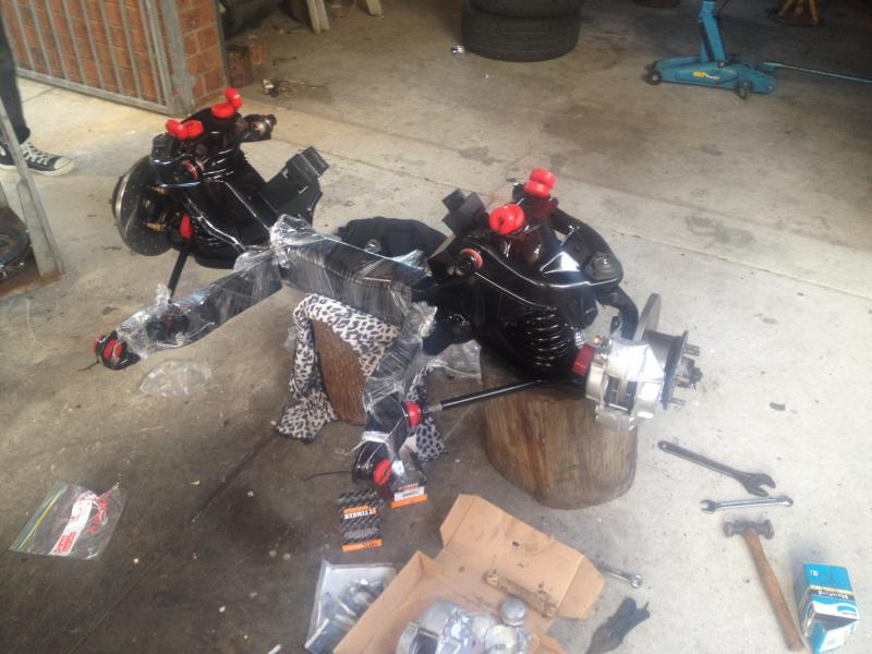

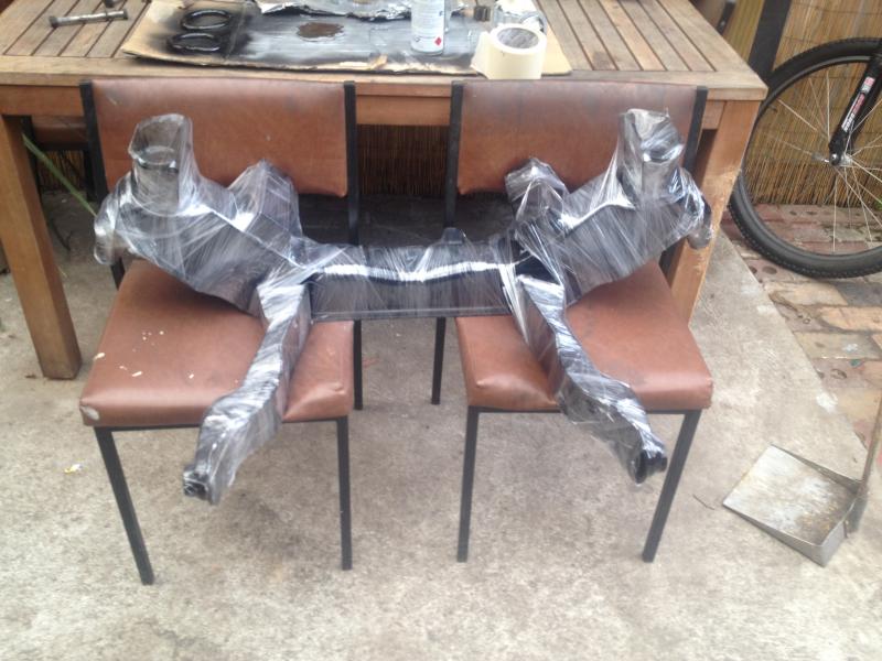

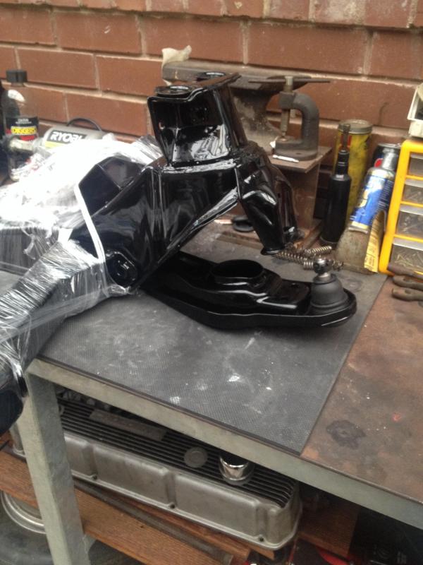

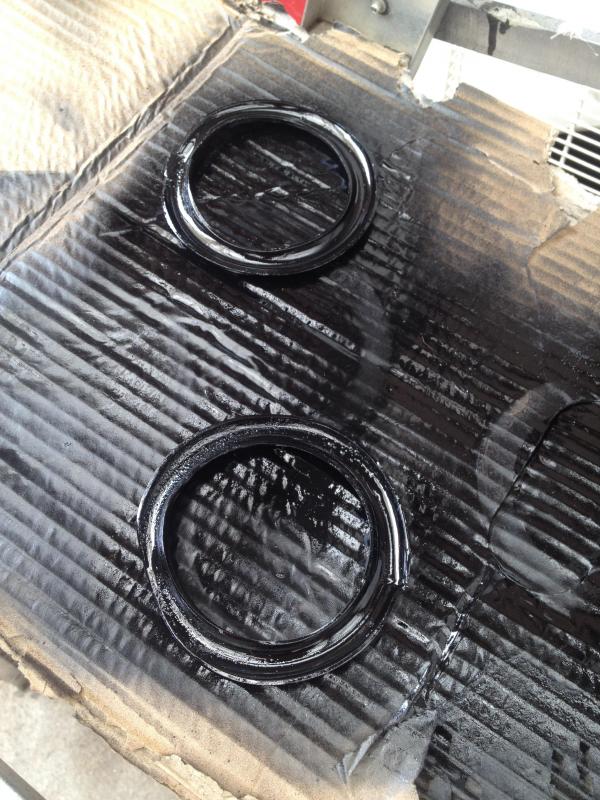

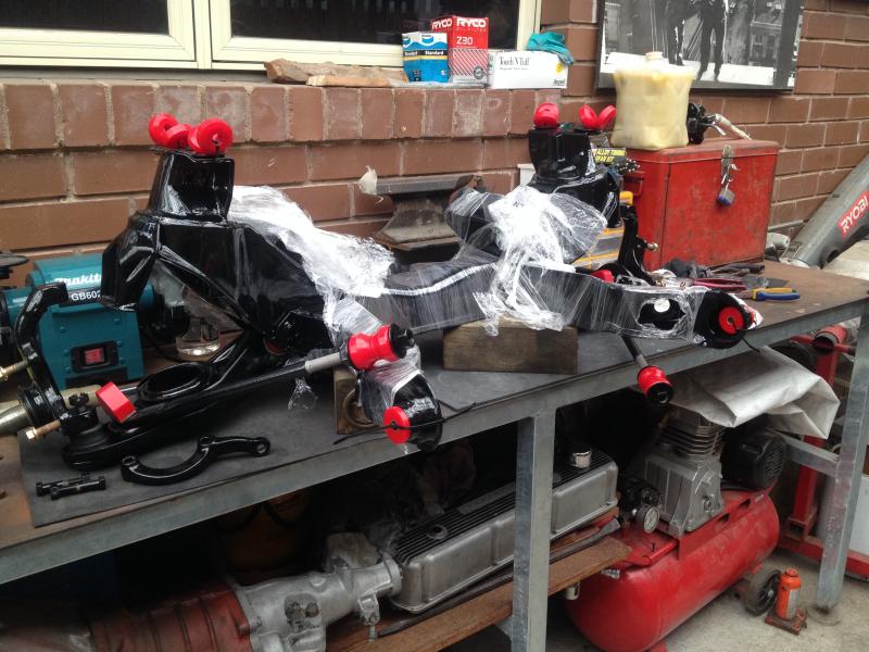

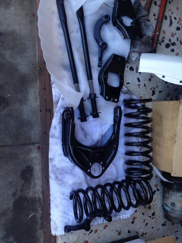

Finished k frame

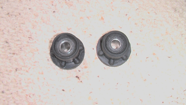

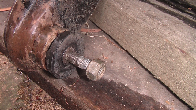

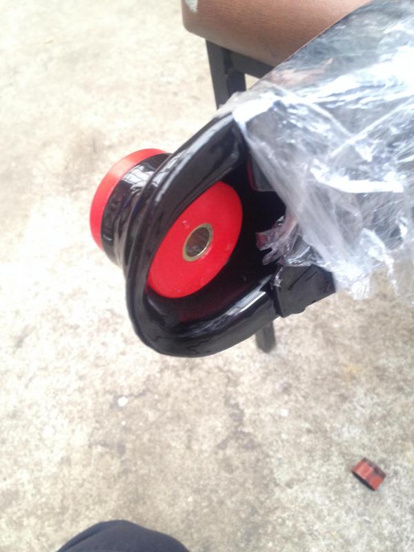

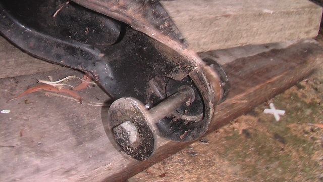

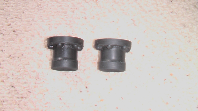

Are these the right bushes? They feel loose.

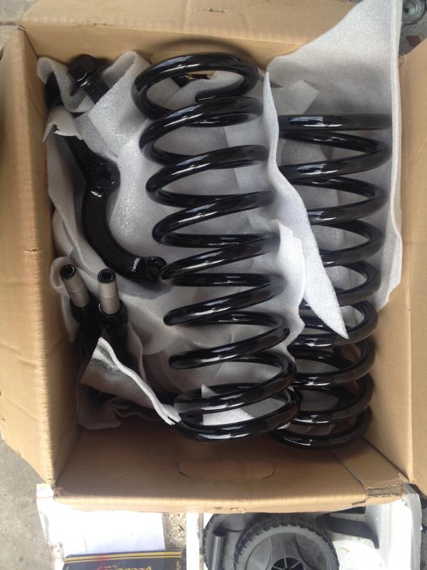

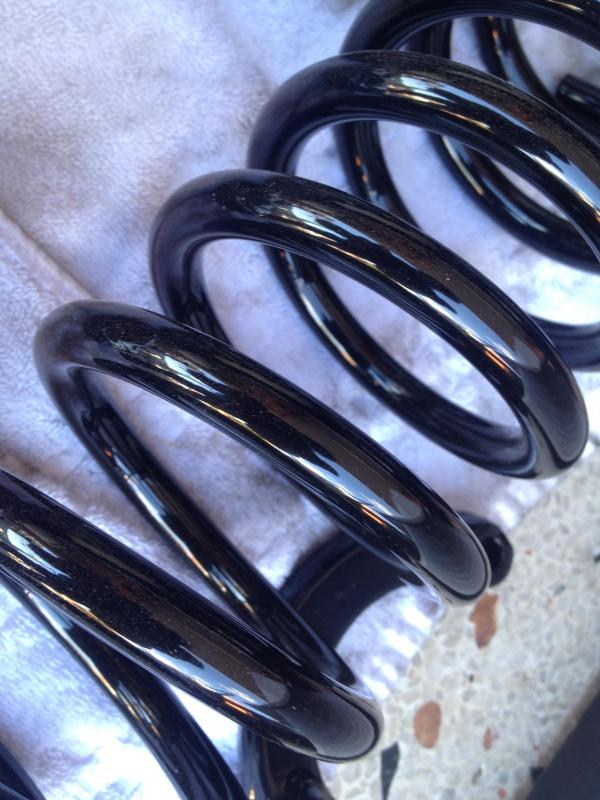

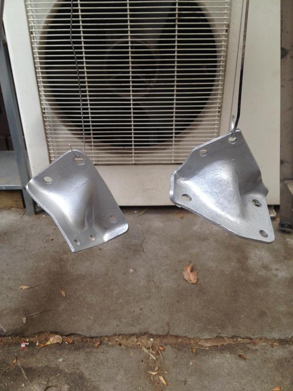

Spring bases
Couldnt get these chromed in time.

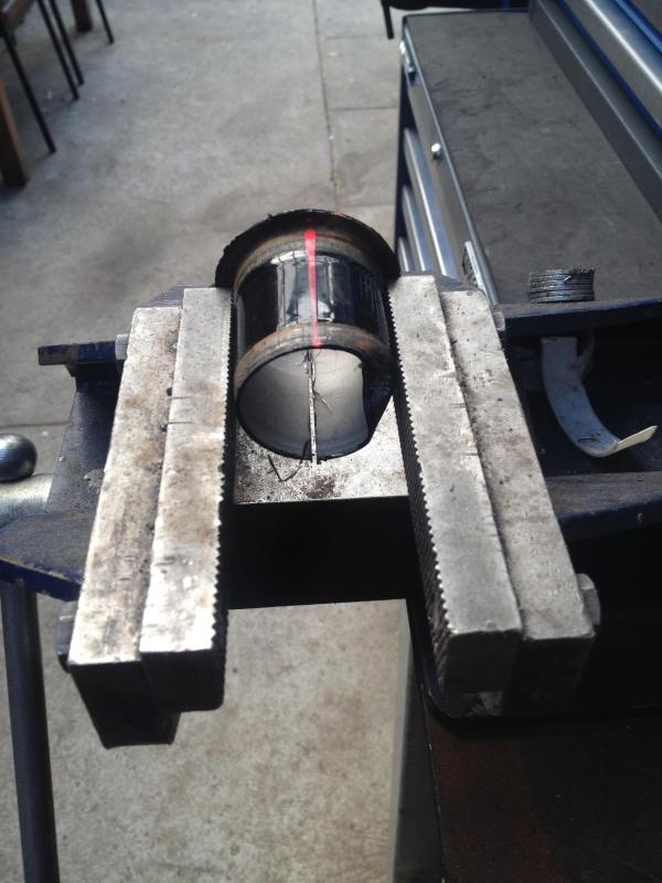

Made up some bracing to fit inside the control arms to support them when pressing in new bushes.
Edited by judgelj, 29 October 2013 - 09:25 PM.

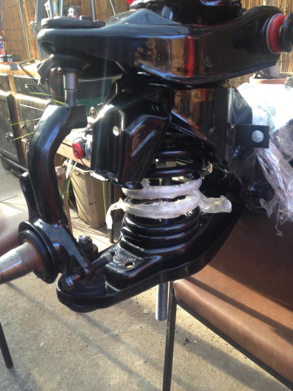

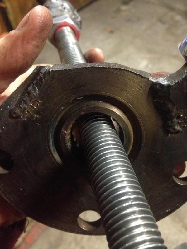

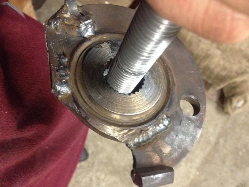

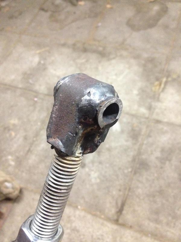

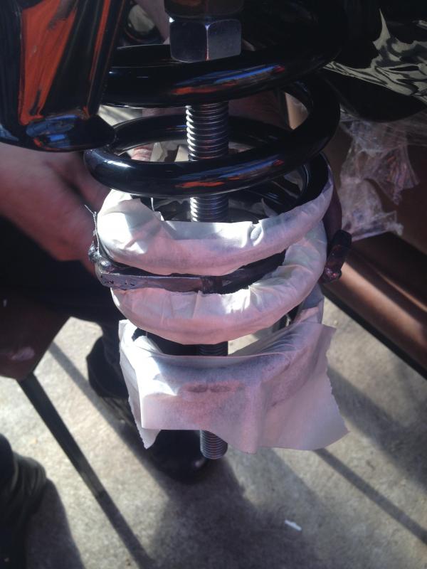

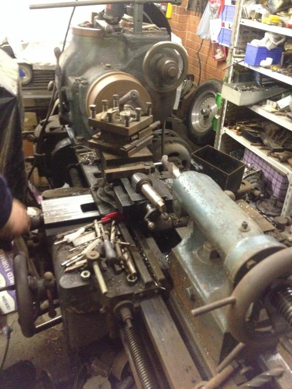

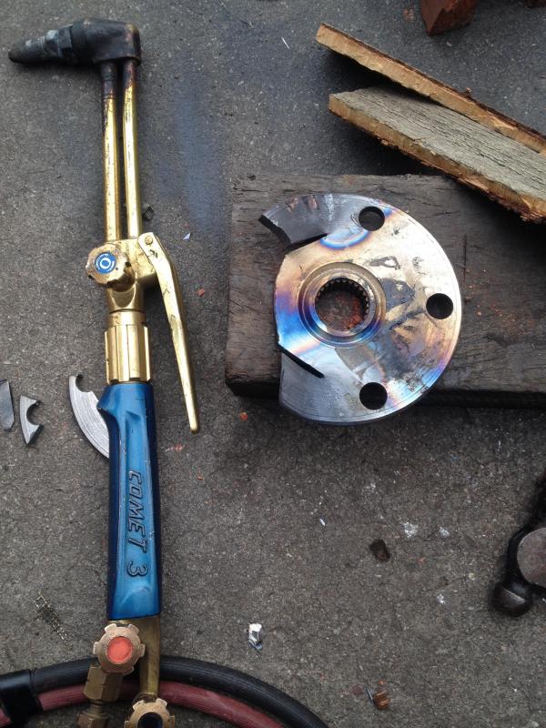

So had to make up a tool to compress the spring inside the k frame so i can connect the stub axle and ball joints. Ended up going with some threaded rod and fair few hours of mucking around to get it right(ish). Would still like to make another one now that ive used it, but then again it does the job. Basically turned down a washed to locate a thrust bearing, and accidentally drilled it out too much so it had to be welded to the nut.

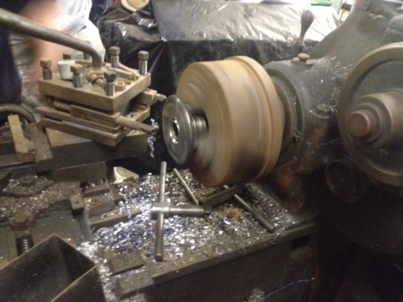

Turned down a tapered slot in this toyota hub flange (which was once round) to locate the other end of the bearing.
Bit of overkill can't hurt, can it?
The two welded washer and pipe fasten two halves of rod. Which is so it can be disassembled once the lower control arm is in.
Cut, heated and bent two tabs to help keep the plat straight whilst inserted into the spring.

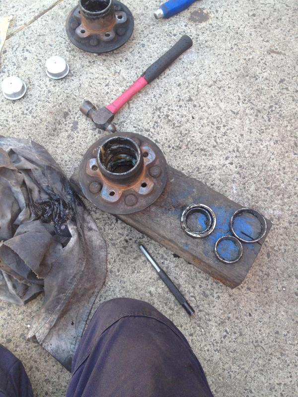

Just waiting on my dizzy to get back from curving, and i need to order some front wheel bearing kits. Any advice on upper bump stop install?

#160 Ice
Posted 31 October 2013 - 08:33 PM
It will be like riding in a go kart will all that red stuff
#161 S pack
Posted 31 October 2013 - 08:58 PM
Can you pull the bush out and post a pic of it? It doesn't look right and it shouldn't be loose.
#162 _Hamster_
_Hamster_
Posted 31 October 2013 - 09:47 PM
lewking lewking
if my memory serves me correct..........that is what they should look like but in a go fast colour
(trying to find pics  of it on the axel for you but i dont seem to have any)
found some on it before redo
Edited by Hamster, 31 October 2013 - 09:52 PM.
#163 _judgelj_
_judgelj_
Posted 31 October 2013 - 10:05 PM
Yeah they are the old ones Hayden. I think they are the rubber equivalent.
Dave I'll have to get a pic but they are basically the outer diameter stepped down to fit inside the arm. Consists of two pieces, one on either side with a sleeve through the middle.
Gene, be interesting to find out never had urethane before. I hate floaty cars so maybe a good thing, time will tell.
#164 Ice
Posted 31 October 2013 - 10:17 PM
It wont be floaty at all just a nice tight hard ride why do i know these things because my front end is full of the red stuff to bar a couple of rubber bushes
#165 S pack
Posted 01 November 2013 - 12:35 AM
No need for a pic then Jacob. I know what you mean by the bush being made in two pieces. Made that way for ease of installation.
These are the original type bushes. Interestingly the HB Torana and the early LC's had two piece bushes before they changed production to the one piece bush.
As typical of a lot of LC/LJ Torana these bushes are installed the wrong way around.
#166 _judgelj_
_judgelj_
Posted 01 November 2013 - 02:20 PM
Thats how mine were installed, Dave. I know because i cut them out. Spoke to the nolathane and he said they will tighten up once bolted in. Also had trouble with the lower shocker rubber as what they gave me is different to the shock i have, but perhaps being a monroe shock it is not the same as factory.

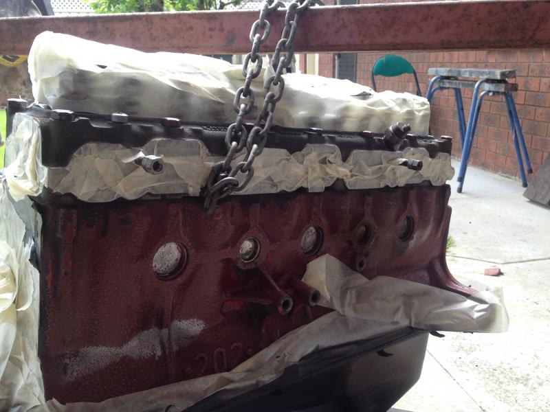

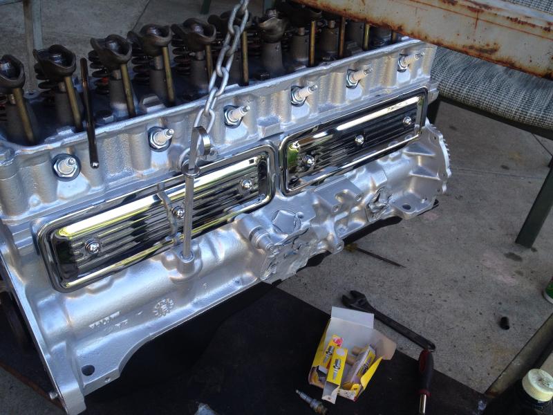

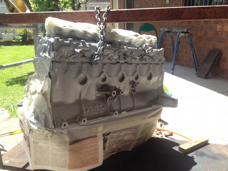

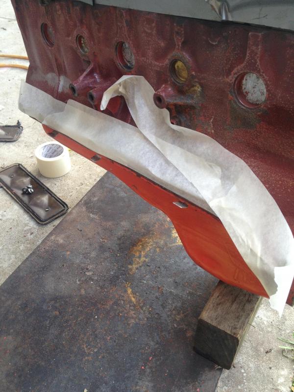

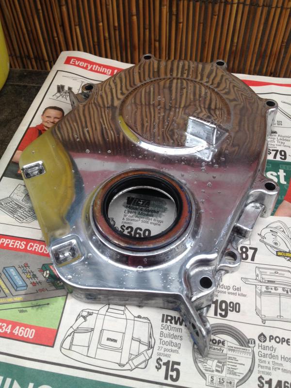

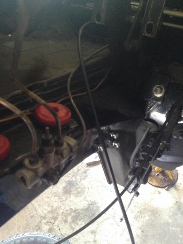

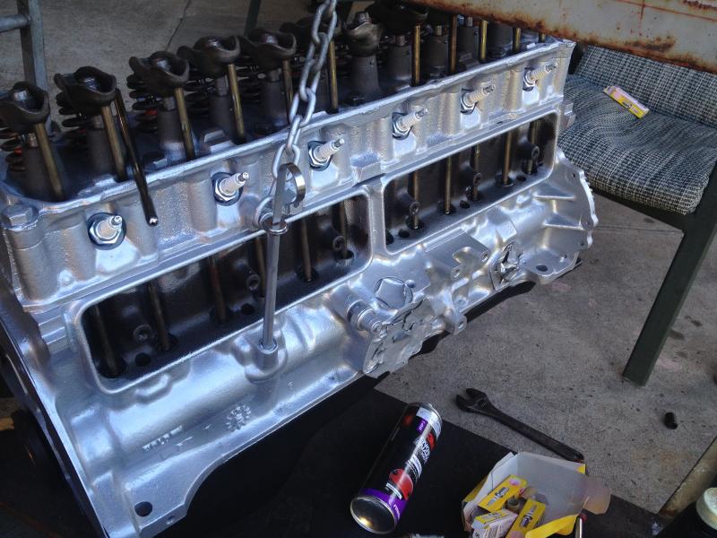

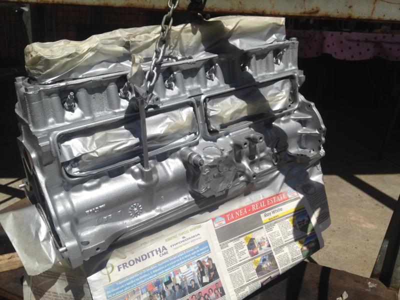

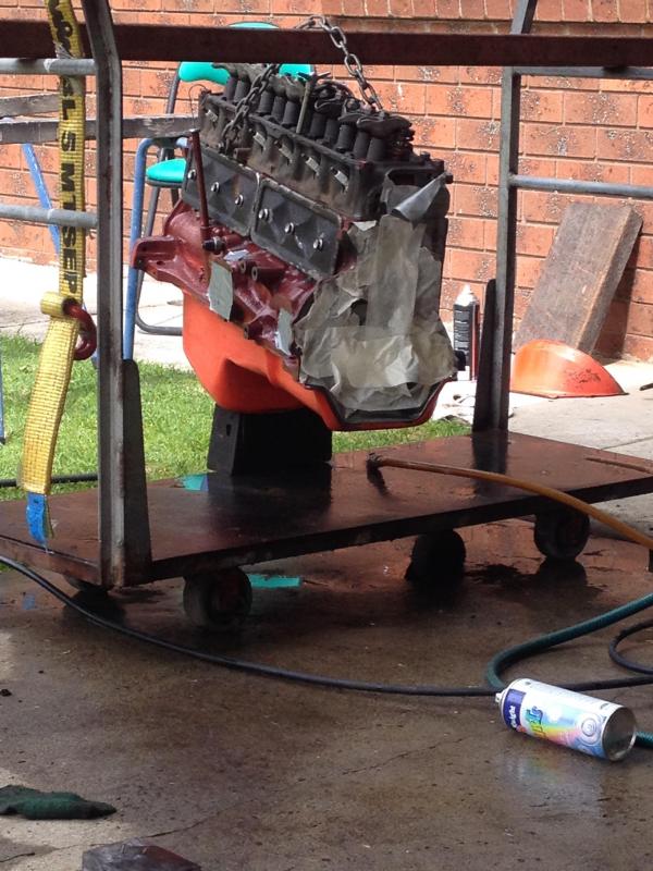

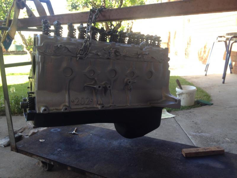

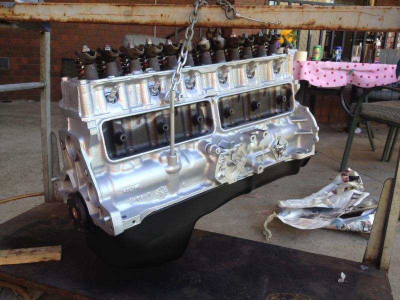

Ok so front end is together bar the brakes (discs on). Not sure if i can adjust the tension on the wheel bearings with brakes on? Apart from that engines done, just needs assembly. Not sure if i should use gasket sealer anywhere? I've got 3 bond in a canister, is it suitable? I was thinking timing cover, oil pump and thats about it?

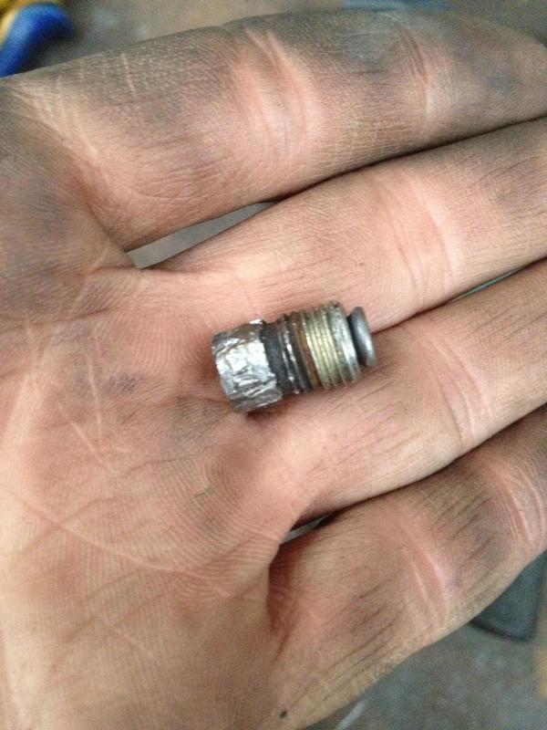

Also, is the welch plug behind the cam on the back end of the block in contact with water at all? If it's not i wont change it. Also not sure if i should change the side ones (one is brass) and the rear most is brass also. Ive painted the engine so i might leave them be.

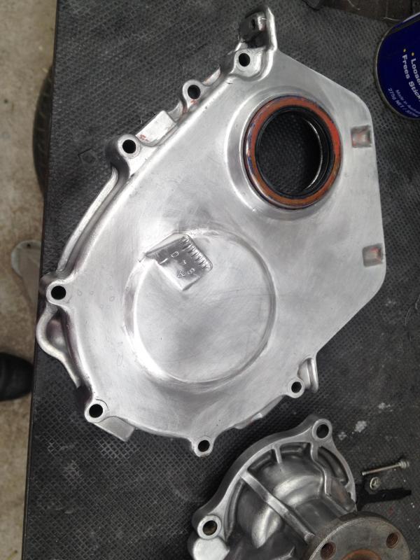

Gave this bad boy a quick polish.
Took me 30 minutes to mask the ports.

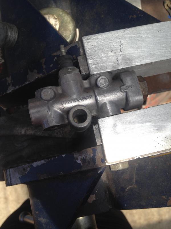

I wanted to ask if thats standard prop valve to rear brakes routing?
Edited by judgelj, 05 November 2013 - 07:03 PM.

#171 madtoranajzedded
madtoranajzedded
    Sir ask alot
  • 2,907 posts
  • Name:Maz
  • Location:Southern Tasmania
  • Car:72 LJ SL SEDAN.
  • Joined: 30-September 13
Posted 06 November 2013 - 12:19 PM
hi judgelj,  your vision on what you thought it would look like is better than you think,looks good bud,thats the std prop,not sure on using gasket glue on oil pump ,them gaskets have a specific thickness for clearance,especially the oil pump coverplate for correct end clearance.the 2 cover bolts go to 6lb.the rest to pump go 20lbs.make sure them bolts are clean too .i always change my welch plugs to block,just to see how much gunk has built up in there .
maz
#172 _judgelj_
_judgelj_
Posted 06 November 2013 - 01:46 PM
Thanks maz those torque specs are helpful. I'll probably leave the sealer out then. Will also change the welch plugs stuff it!!
Glad you like it too mate thanks

Posted 06 November 2013 - 02:01 PM
definitely do the welsch plugs. you may kick yourself later if you dont do them when they are easy to get at.
looking good.
#174 orangeLJ
Posted 06 November 2013 - 03:00 PM

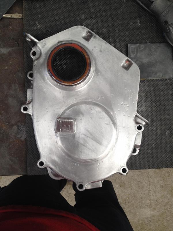

I've gotta say, you'l regret having a polished timing cover.
Its near impossible to get in there and keep it nice and shiny (been there, done that) and it tends to accumulate a heap of road grime, dust, water etc.
Thats my experience anyway.
#175 _judgelj_
_judgelj_
Posted 06 November 2013 - 03:20 PM
I think I'll regret polishing just about everything but I thought I'll give it a go anyway.
And welch plugs ordered. I'll leave the back of the cam as it's in oil. Back of the block is already brass and ill do the side this week
