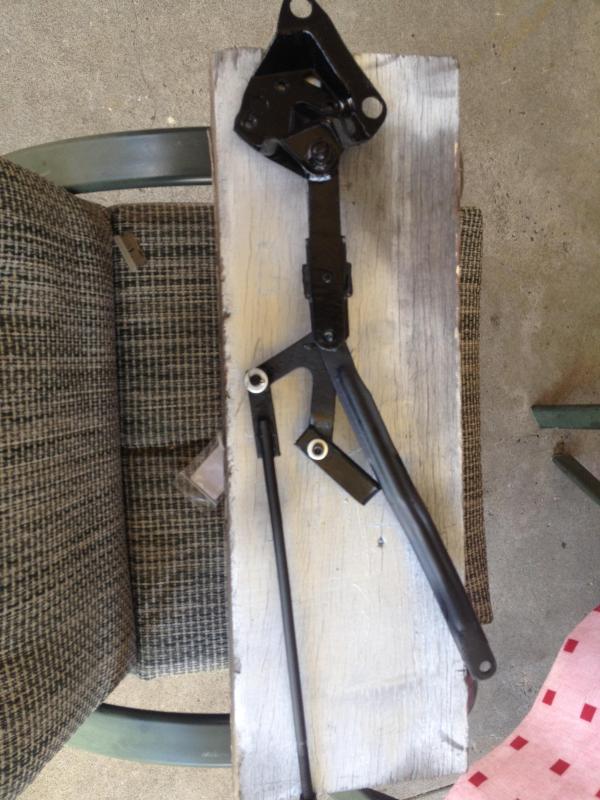

Thanks for that DJ. Hopefully sort through some shifter linkage clearance issues and perhaps drive it by this sunday? I sat the linkage adjuster to pivot on the outside of the bracket and it hits the tunnel.

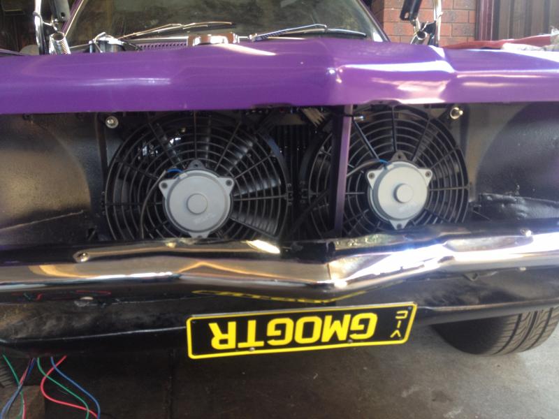

Whats the best way to go about wiring thermos?
#205
Posted 18 November 2013 - 09:17 PM
Just looking at your older picks, you cant sit the 1-2 linkage on the inside of the bracket? Or run the bracket the other way around?
Been to long since i had a stick in my car.
Wiring thermo's....Well, i hate wiring, but i used to run one of those dodgy adjustable resistor type things that had the capilary line in the upper hose and switched a relay, have a Spal controller now, much nicer.

I actually ended up pissing that off and using a genuine one, but its side mounted like the 1/2 gear one. Its the block with a pin if that makes sense. I made it sit on the outside of the bracket and it hits the wall. Will have to take a pic.
Yeah that's what i thought but dont really like them too much. What is the spal controller?

Better yet, go to post 194 and you will see the picture. But i stupidly moved it on the outside and locked up the adjusting nuts. Should have left it where it was.
#208
Posted 18 November 2013 - 09:44 PM
194 is the one i was looking at.
I #@$^%& off the plastic POS as well and ran metal ones like yourse, never had an issue but it was long enough ago (about 9 years) that i cant remember where they sat.

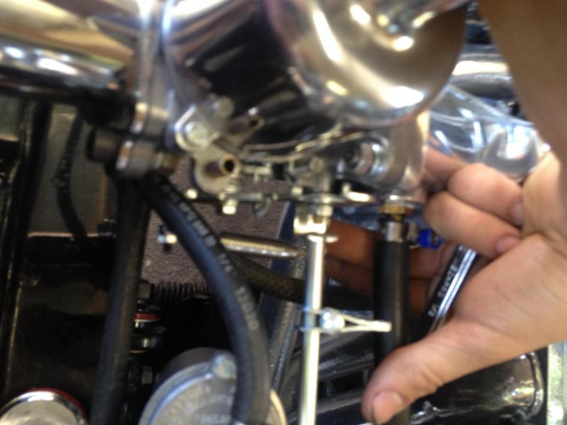

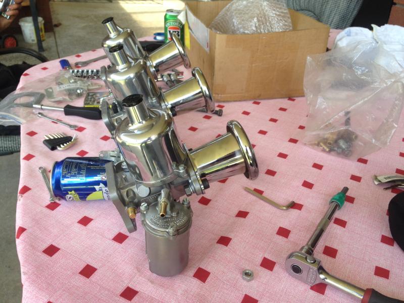

Having trouble with re installation of cotter pin, also have to line up my manifolds as they do not sit level with eachother and I can't get them on with the fixed throttle linkage.

NOW... That is how i used to have it with a little steel replica i made of that plastic bracket, problem is it fouls on the tunnel for some reason. I had to bend the bracket inwards to compensate. Now that i am using 2 steel block adjusters, i find that the 3/4 gear selector rubs on the side of the tunnel. Whether i can spin it around on the inside like the 1/2 gear adjuster in your pick, im not sure and it will be fiddly now that the box is back in. At this stage i can change gears if i put a bit of muscle into it, so im hoping something will wear out and it will stop rubbing. Wishful thinking.

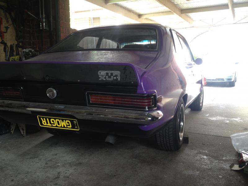

Posted 24 November 2013 - 09:47 PM
Actually, i lied, its the other way around. 1/2 selector adjuster is fouling (sits on outside) 3/4 selector is fine (sits on inside). Probably have to swap them around!.

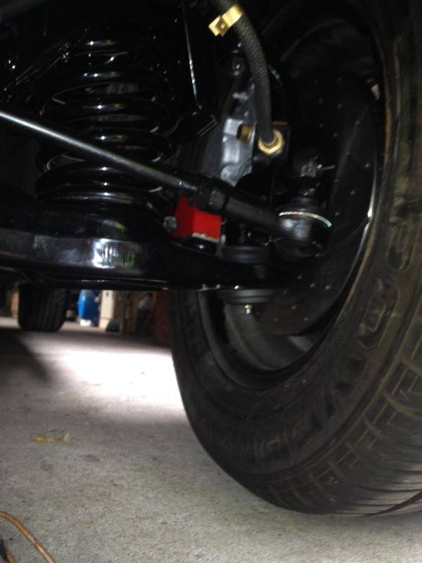

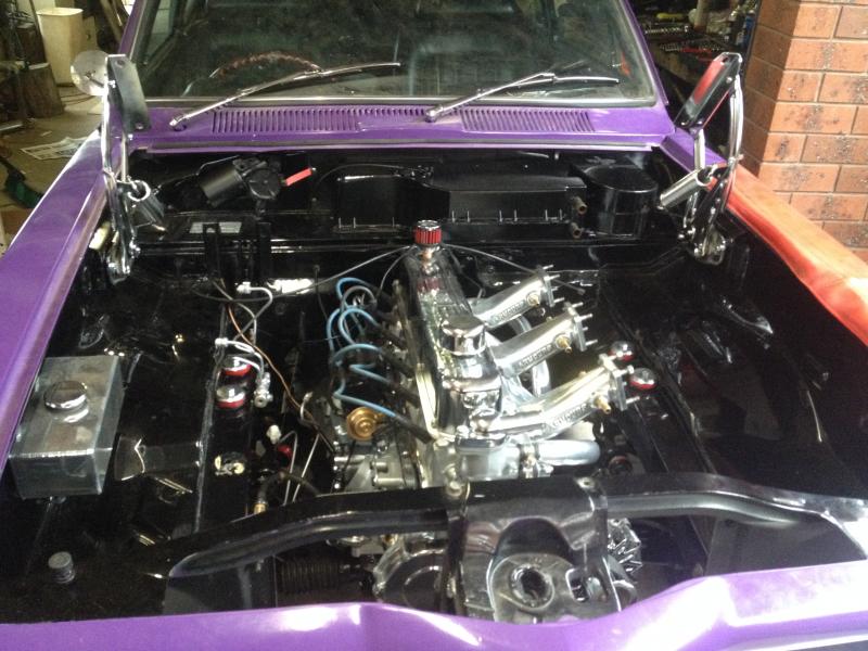

Anyway some more progress. Just about done, have to make a bracket for my rat trap rod as it fouls on the steering knuckle. Apart from that the front su throttle linkage is bent and i havent figured out where to mount return springs.

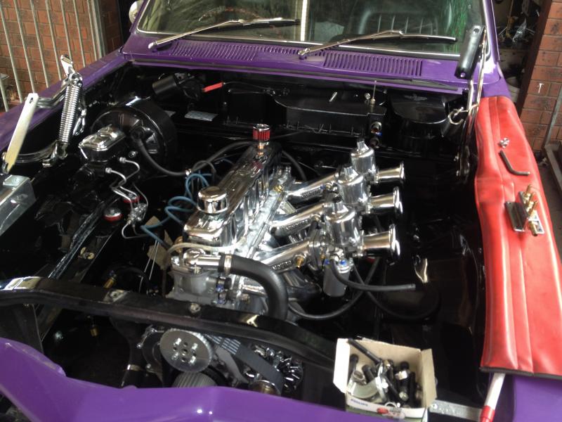

Freshly rebuilt

Need to wire up my thermos and XU1 dash. Do i just chop off the existing dash plug and wire everything separately?

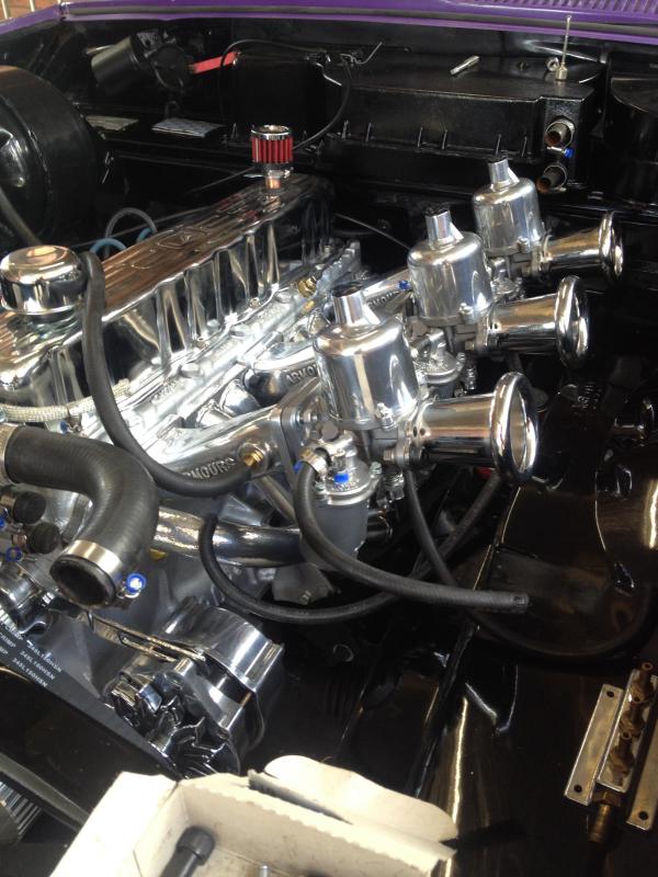

Mounted thermos
Throttle springs sorted
All fuel lines and fuel block connected. Just have to connect my main fuel hard line tomorrow.

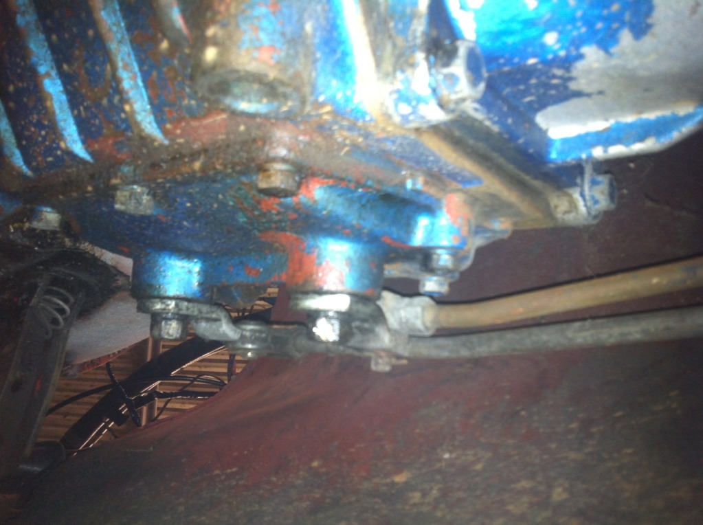

That cross member has auto insulators, do you still run them ?
Mate i didnt see that, yes i do. Does it change anything can i run without? They are a bugger to fit back up im pretty sure 3 out of 4 are cross threaded but oh well.

Never had an issue, just bolted crossmember to holes that were already tapped in the LC as manual cars never had the rubber insulators or additional brackets
I don't notice any more vibration
