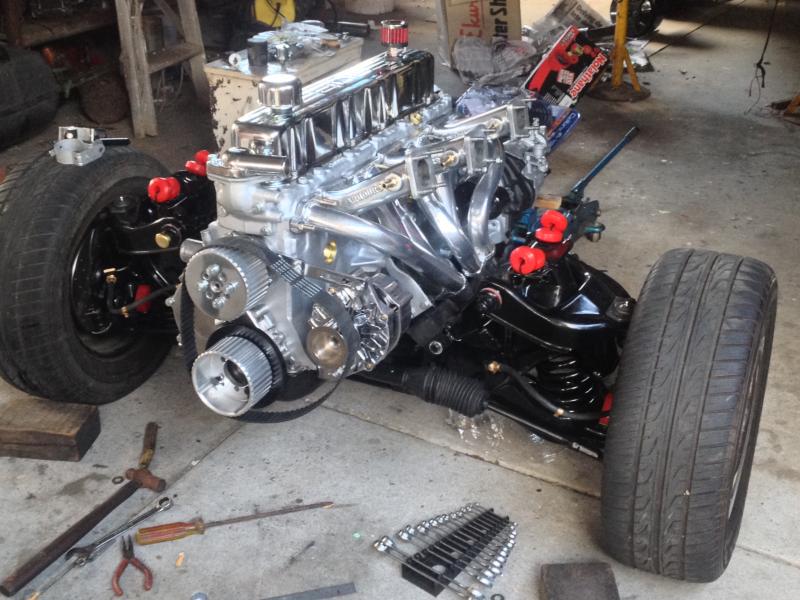

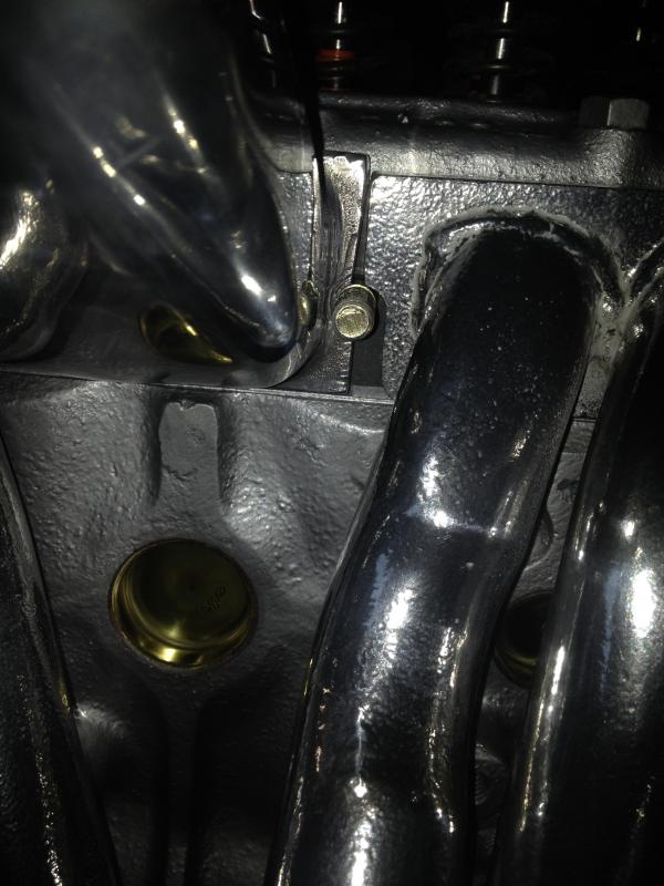

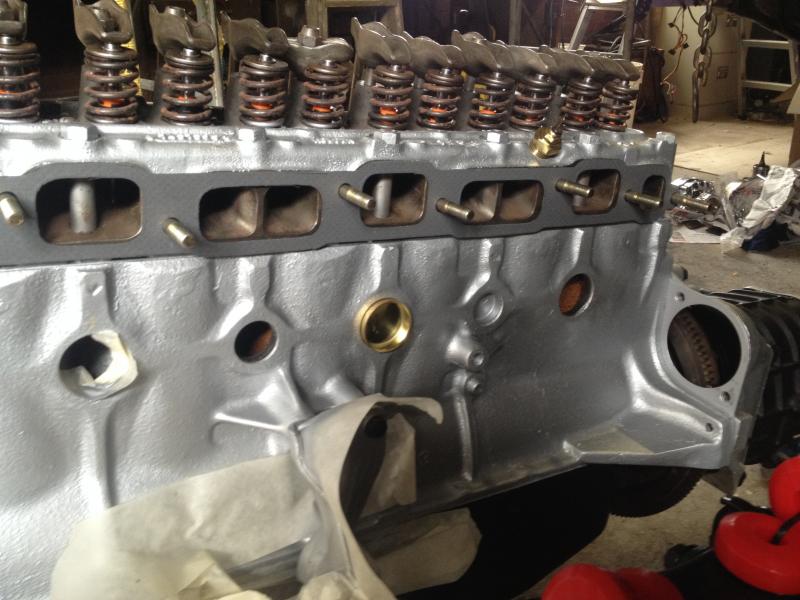

OK, so i always day dreamed about the days i would actually make progress, and im glad its all happening. It is stressful, but i reckon next time i do this (hopefully never), will be much easier. Now one thing ive learnt, is to lower expectations when it comes to things fitting, so here i go.
Finally guilted myself into changing the welch plugs. Lucky i did as they were pretty badly corroded inside. Replaced with brass that i thought i would polish.
And voila!
Used some of my special 3bond cant get in shops and bolted on pretty much everything.

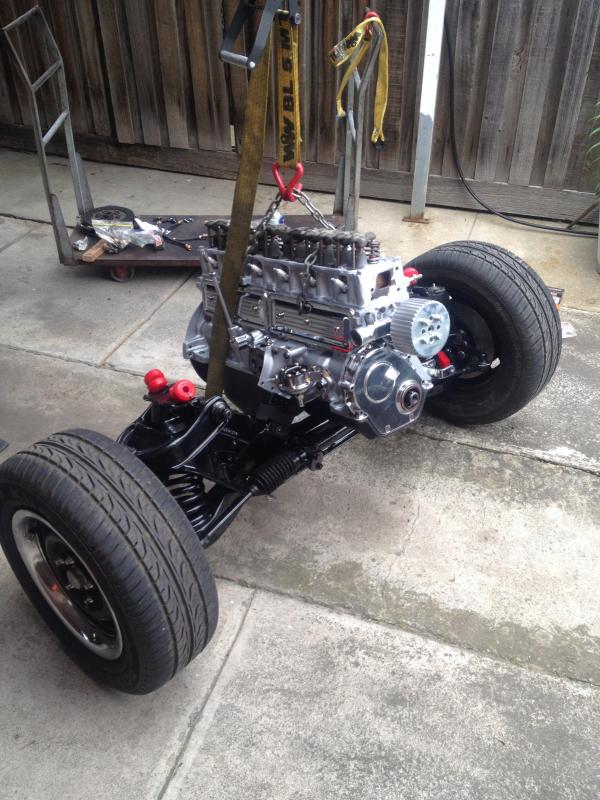

Dont ask about the oil spill. Lent out my lifting blocks so used a ratchet strap and when i let it down the weight was at the front of the engine, not the back (go figure).

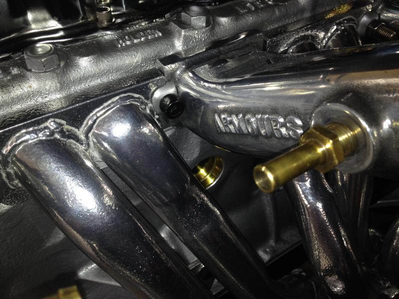

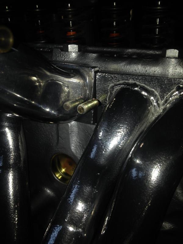

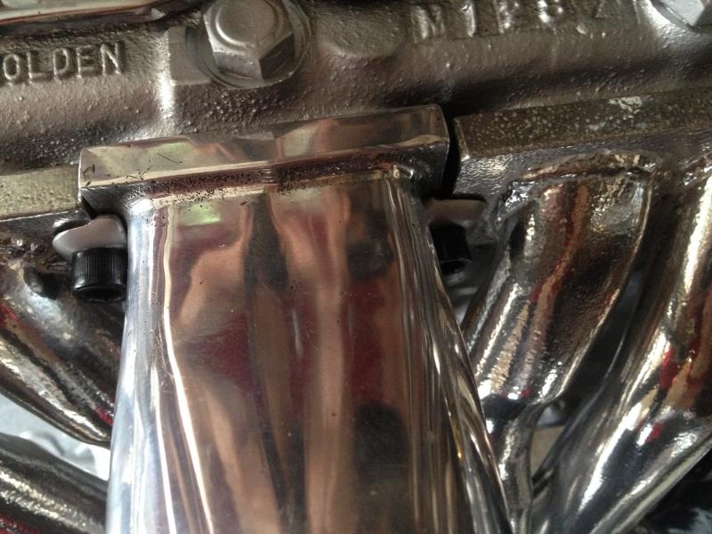

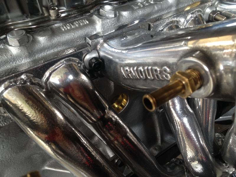

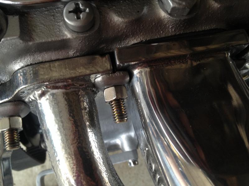

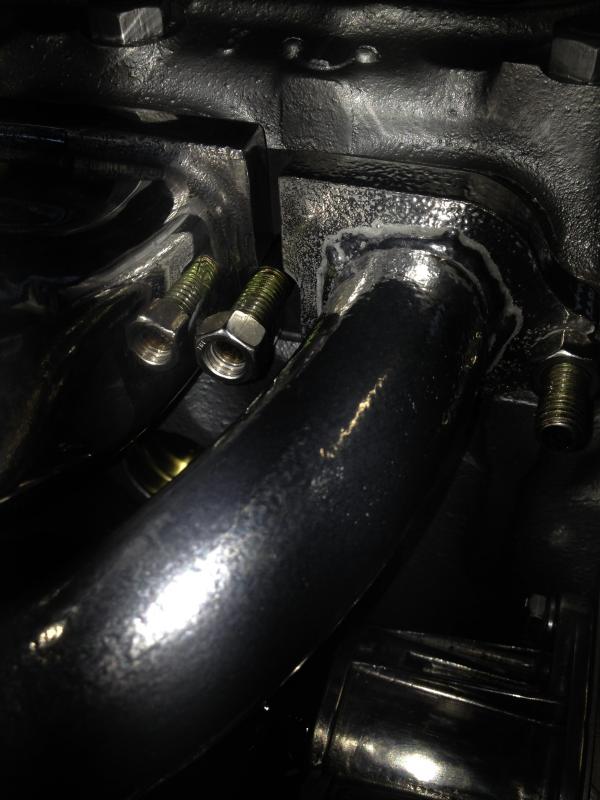

Now as you can see im having some problems with the manifolds. The middle runner sits wayy too close to the studs and i cannot get the nut on, let alone the spacer. What do i do? Looking for opinions using allen key bolts and multiple small washers instead of spacers.

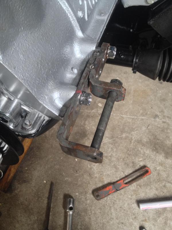

Apart from that i need to move my alternator forward and was wondering if anyone cold confirm whether or not holden made a long alternator bracket. Apart from that i could use a picture of the factory k fram brake line the plumbs up the passenger caliper to prop valve as i had to cut mine out and now it doesnt have to right angle to connect back up.

exhaust shops have smaller nuts that may help

Smaller nuts you reckon? I got some socket heads today which seem to work, but as for spacers I don't think the holden ones will work they are too big? I don't suppose I can't go without and not get any vac leaks?

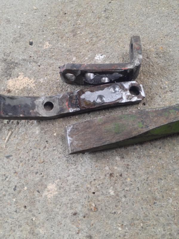

I'll have a look mate. Two options, extend the pulley length or make a new bracket. Pulley length is probably easier but puts too much strain on the alternator shaft. I can make a new bracket but I won't be able to chrome it right away and I won't be ecstatic. Didn't holden make a long style alternator bracket?

As far as I'm aware Holden only used one lower mount on all Holden 6's.
I made this using 2 lower mounts to push the belt forward to clear the bigger balancer that I fitted.
Attached File  P1010855 (600 x 450).jpg   67.92K   3 downloads
#191 _judgelj_
_judgelj_
Posted 12 November 2013 - 08:09 AM
Mate that is EXACTLY what I need to make. How exactly did you extend it from two? I was considering starting from scratch

I cut a second bracket, welded it to a another at the correct length.

Thought that's why you did, problem is you would have picked up a bit more than the 15mm I need. Problem i have trouble lining up bolt holes as they foul on the bend of the second part of the bracket that lines up with the back of the alternator. If any of that made sense?
#194 _judgelj_
_judgelj_
Posted 13 November 2013 - 05:35 PM
I made one up today, ended up splitting the two halves, which was near impossible and sliping the half that bolts up flush forward and drilling holes/adding material. Will have to make a spacer to sit behind the alternator.
I went around this morning to a couple shops no one has them?

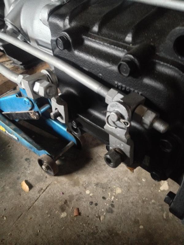

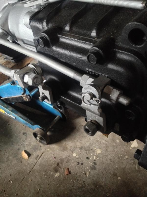

Fitted up the linkages. It used to have a plastic type looking bracket the sat above the selector which i had to bend inwards to fit. Im not using a side mounted type, will this foul on the tunnel (1/2 gear selector)

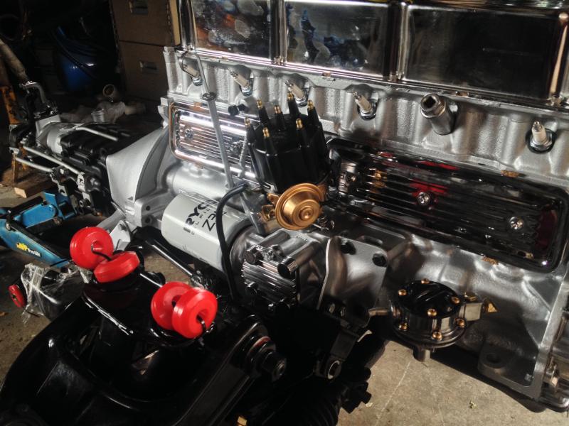

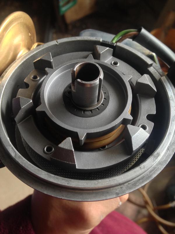

Got my dizzy back so took some time to fit it and set up timing and leads. Anyone know which terminal on the dizzy is for pink/green? Also where do i run the distributors new 12v wire to?
Rebuilt/curved, looks brand new!

Brings the alternator forward 15mm which sits the belt nicely in the middle.

The smaller nuts are same thread but a spanner size down on the outside. Extractor nuts I believe they are called. Any reputable exhaust shop or spare parts shop should have them
#199 _judgelj_
_judgelj_
Posted 14 November 2013 - 09:09 AM
Ok, I asked them for 12 point nuts probably why they didn't have any, I'll ask specifically for what you have said seems more likely that they will have them.

Couldnt find these small size extractor bolts, strangely. Dont know what ill do might just go cap heads for the trouble spots.

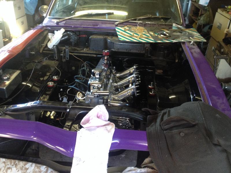

Apart from that everything is in and im in the process of connecting everything. Only problem is going to be a 56mm radiator. Wont fit  now with the gilmer drive (insert lame i told you so joke here) so will have to get creative. Either go back to stock (ugly), or machine down the pulleys. Will have to see. Also waiting for my third and hopefully final belt as the 320 and 367 sizes that i received were wrong.
Trouble spot nuts. Cant get a spanner on.

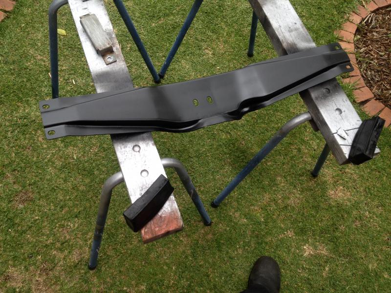

Freshly painted crossmember. Goodluck fitting it !
