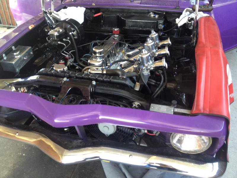

Sooo... SHE LIVES.

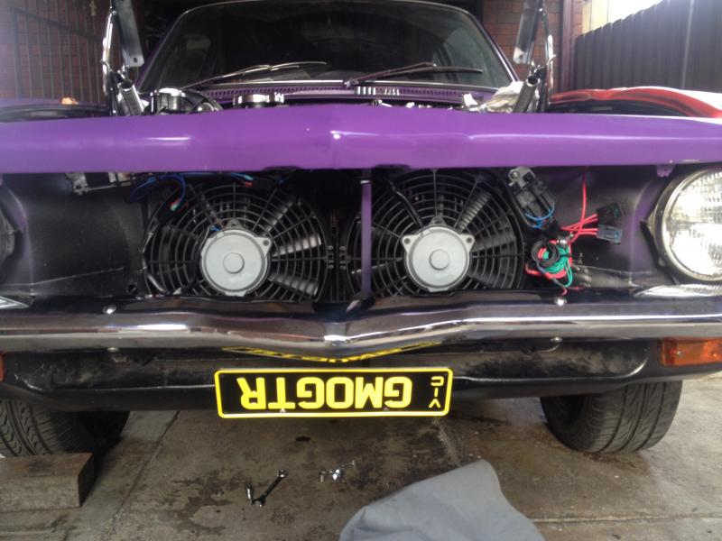

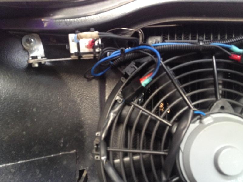

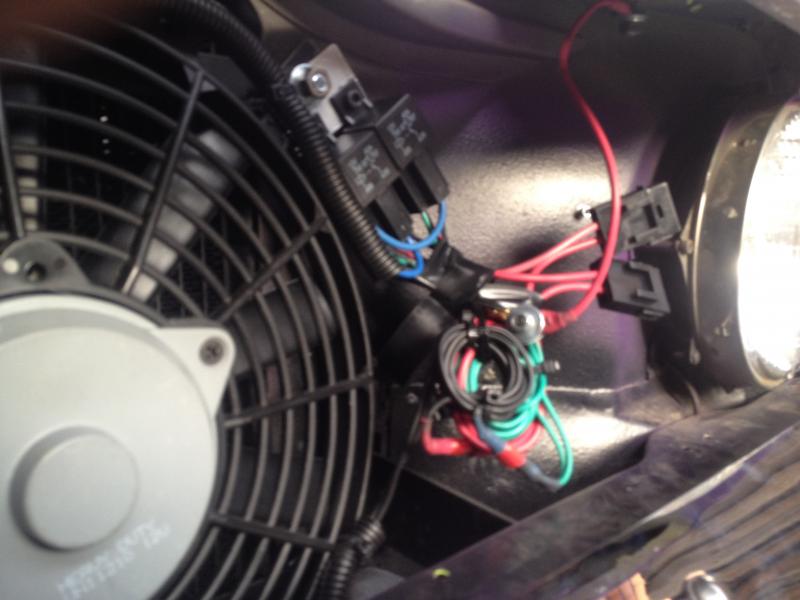

Fired first time, ran in the cam. Nearly scolded everyone when my heater hose bungs failed, not to mention the radiator cap, but anyway... Just have to re wire my 12v feed the coil as the way it is now, car doesn't turn off lol. Apart from that went well, timing was pretty spot on, just have to get a light on it to tune it right. Little bit of a cooling issue even with fans, but it's hard to troubleshoot as I can't get my temp gauge working.

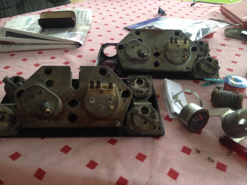

Apart from that have to figure out why my alternator is no longer charging. Used to work but since taking it out and putting it back in it doesn't work. Once I sort that just have to throw on the timing light and wire in my dash. Having trouble with the dash can't get readings when bench testing gauges don't know if it's the senders or the gauges or both.

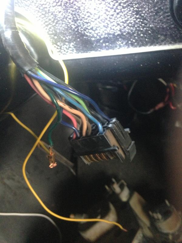

Standard plug, might not cut it off, just splice into the existing wires...

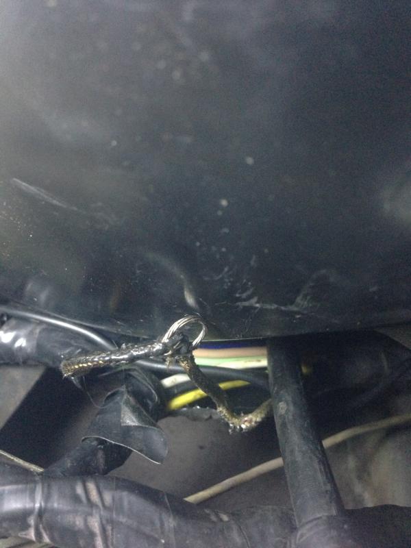

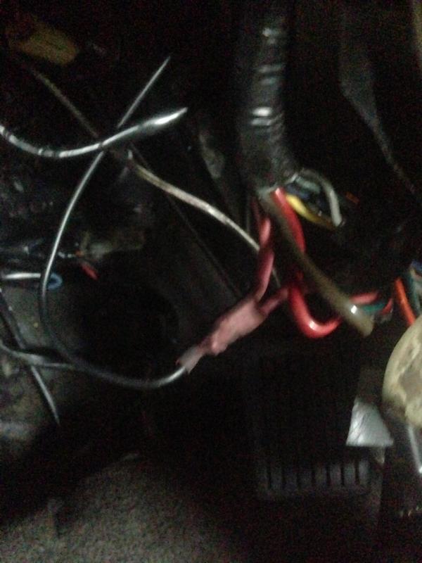

Does anyone know what this braided wire is for? Runs into the back of the ignition barrel, its braided.
12v for coil

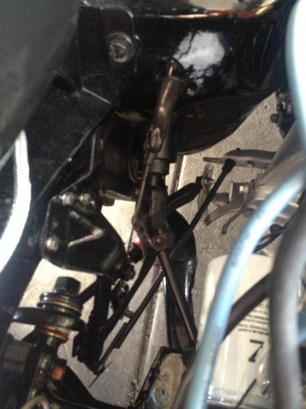

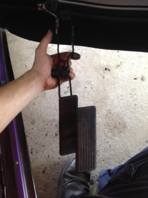

Clutch rod fouls on the steering. Need ideas for rectification. Can i drill the hole for the clevis further down from the original hole? Will this change the pivoting angle too much?
Have to lengthen new accelerator pedal.

Looks like a resistance wire for power supply to ignition coil with points distributor.
Has the original pink resistance wire been replaced?

Yeah I think you're right. I had a better look on the car and wiring diagram and it runs to the positive side of the coil along side the yellow power supply. Don't know why it's gotten so hot though, a bit worrying...
Spent all day today cleaning up all the cars wiring, but I'm pretty much happy to be done. Just have to start making up a harness for the dash and hopefully get it in tomorrow, I'm drilling all the standard bulb holders and soldering wires to one of the tabs to power them as I can't find any HT/G ones. I just want this bloody car to drive!!! I wonder if a bad earth is what's causing my temp sender not to work...
^Yep.

Wonder why it got so hot? Not only did it melt there but a few spots down the line. Worrying.
#249 hanra
Posted 03 December 2013 - 10:01 PM
Because it measures about 1.5ohms from memory. It is probably more effective at dissipating heat them a ballast resistor as it stretches over a longer area. There is a lot of current going through that wire, especially at low rpms because the primary winding has more time to fully charge and saturate.

Because when your running electric ignition you shouldnt have said resistor wire?
