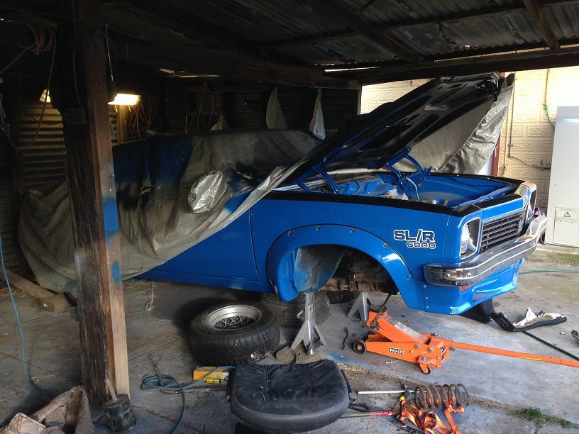

Hey mate, by "memory" you need 2 sets of those, 4 rubbers go underneath like in your photo there, obviously 2 bushes each side. & 4 down inside the chassis rails. 2 per side. Gary.

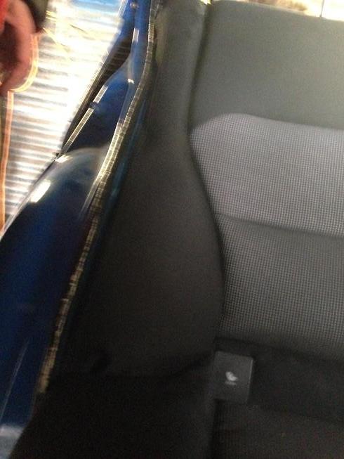

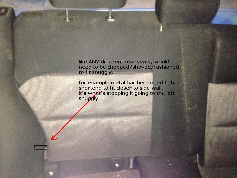

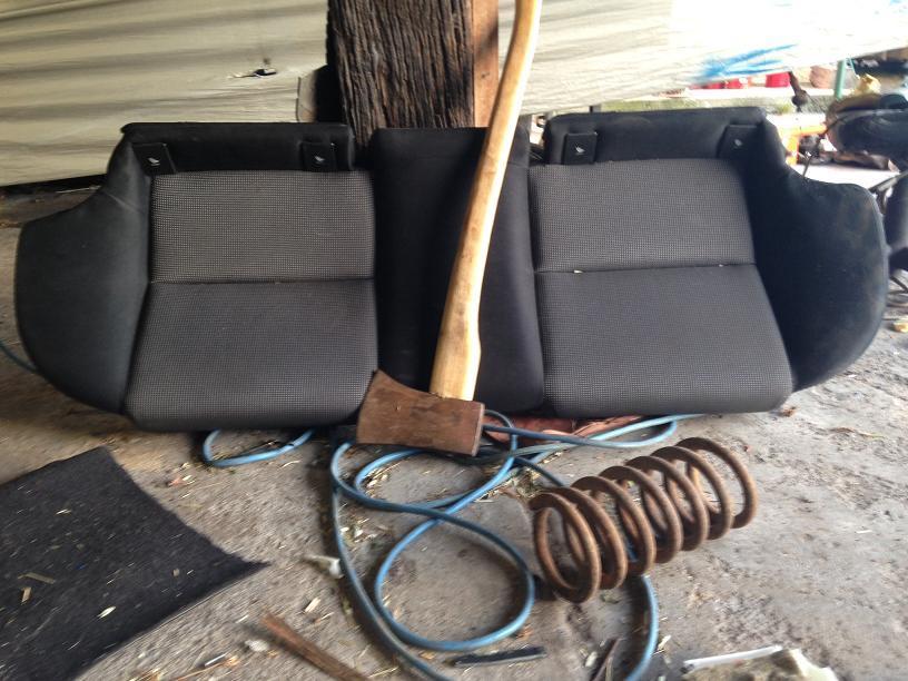

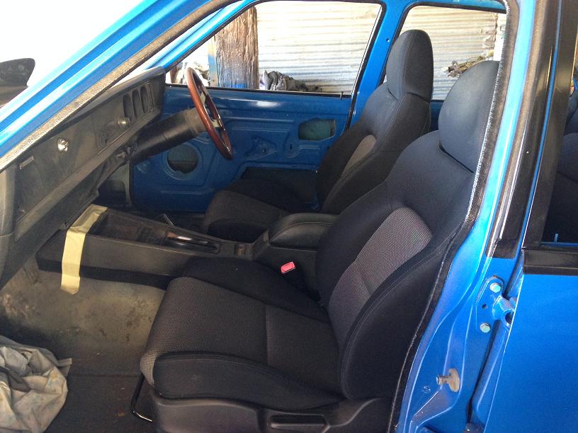

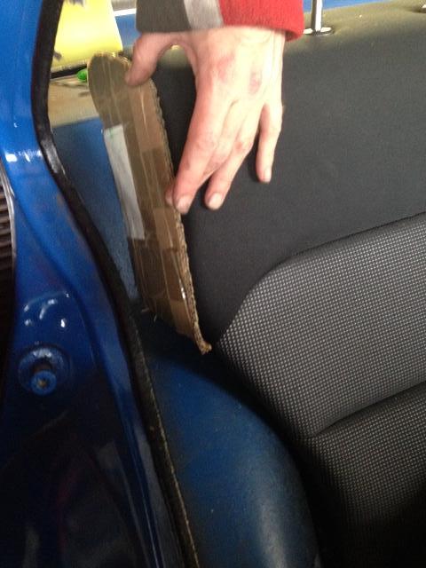

a question was asked got me thinking, go to the effort of installing Subaru liberty rear seats, as well as fronts.
a lot of work, not sure. was planning to just go an easy nice black seat cover on original rear tory seats.
pics just for interests sakes
(station wagon set shown, not "sedan's")
snug, but indeed fits sideways
like any different modern rear seats, would take a lot of work to fit.

My gosh this has come in handy.
(might do the same for others rebuilding front end)
..just wish i could say all the parts, like lower control arm bushes and ball joints went in as easy for me as did him..
FOR THEY DID NOT! haha

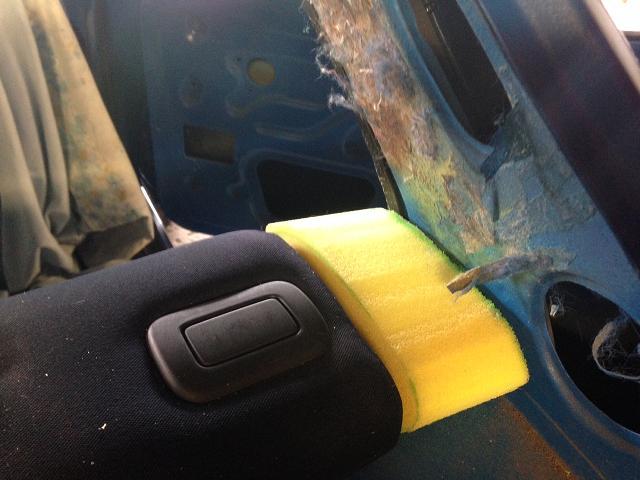

#242 _livo74_
_livo74_
Posted 06 October 2016 - 09:24 PM

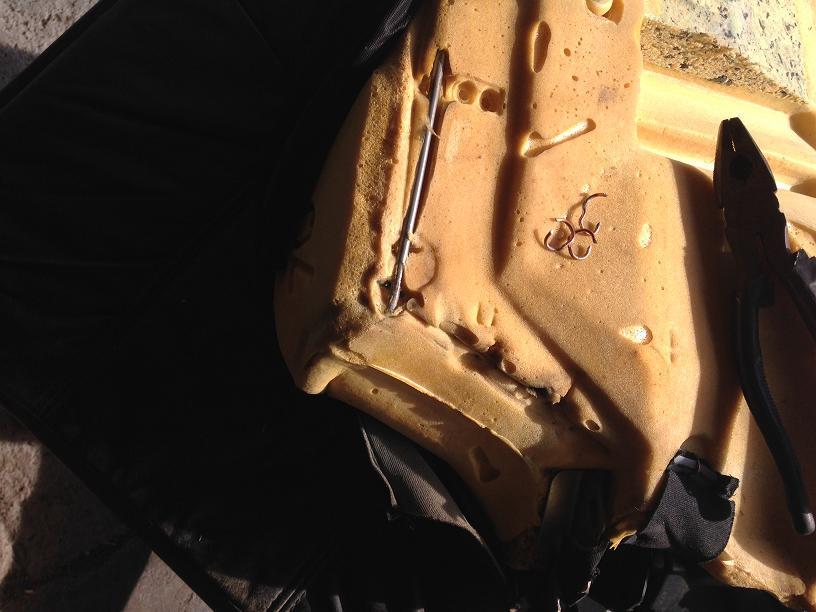

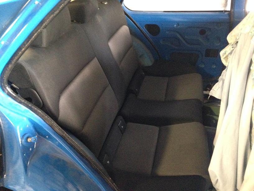

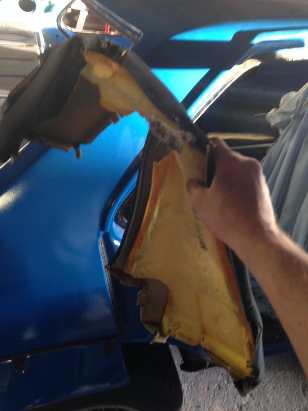

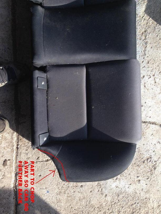

off with it's head
3 pins removed and material folded back
chop away, and with angle grinder, that metal had to go.
test fit
and now lower seat anchors meet footwell, bonus
20 pins and a quarter of a tube of araldite later, waiting to dry

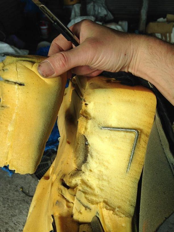

_____________

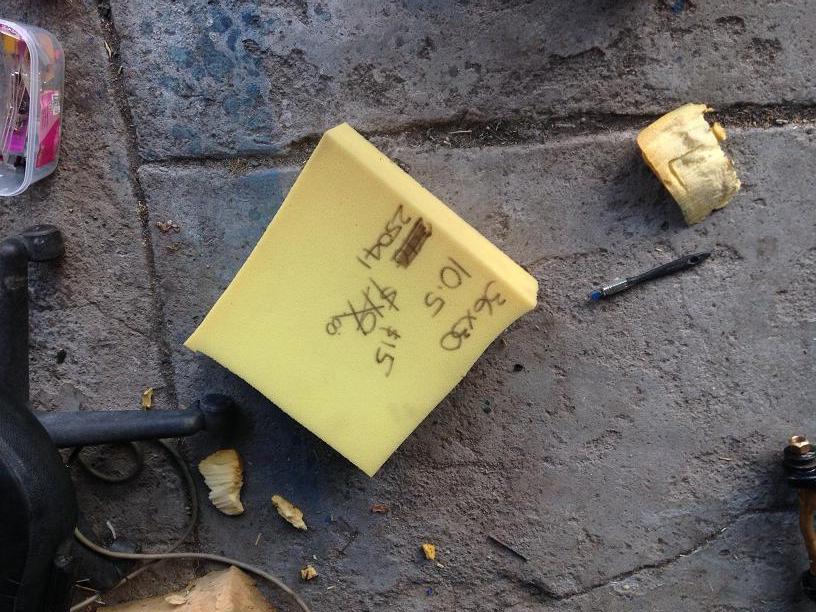

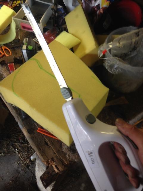

and the shoulder skin, removed off the liberty's plastic moulding.
bottom perfectly moulds to tory hub, top need to be recreated.
bought some firm foam from clarke rubber to make the two shoulders.
Edited by livo74, 06 October 2016 - 09:25 PM.

Posted 06 October 2016 - 09:52 PM
(and if wondering, those square bit of plastic at bottom of seats are where "child seat" anchors were on the suburu liberty/outback. anyone using these seats would be best to buy the ones without them. they were an "option".)

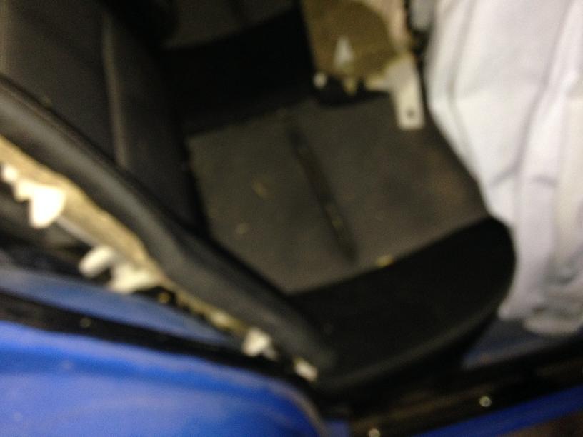

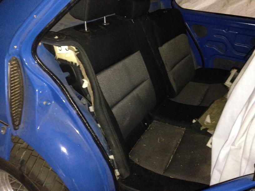

#246 _livo74_
_livo74_

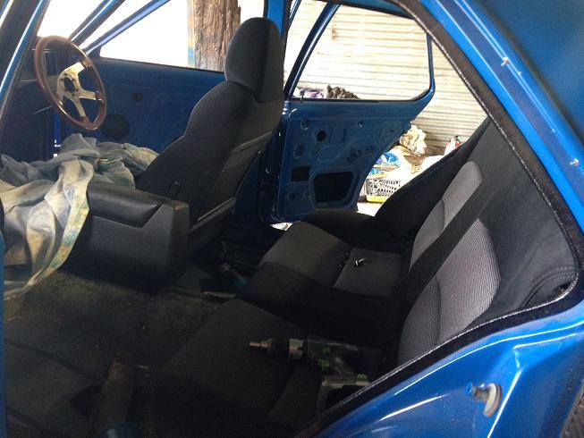

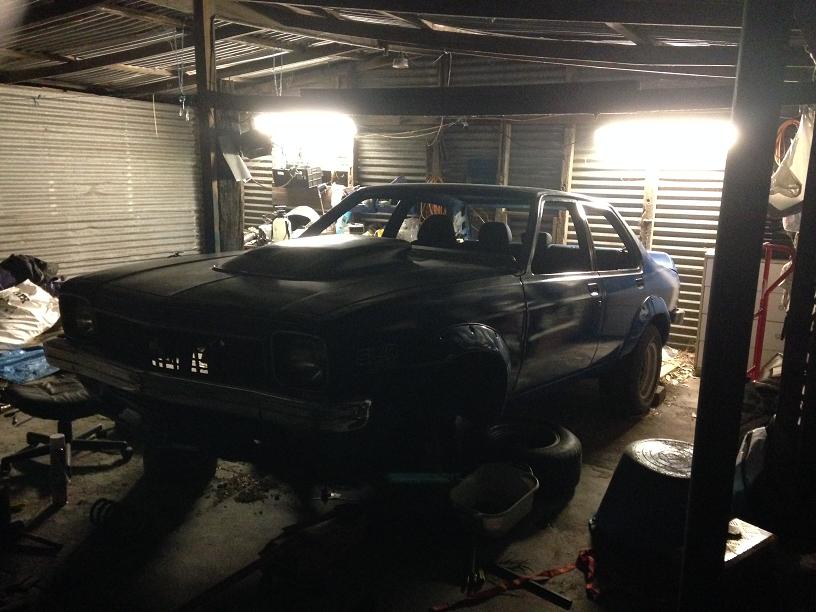

Posted 07 October 2016 - 01:44 PM
far from finished.  more padding out, patching (read: glueing) missing sections, anchoring seats etc etc to do
but gives me good idea of finished product, which i really like.
(hmm.. camera pics give idea of "dark grey and light grey" seats", when really almost "black and dark grey" in the flesh. odd)
Edited by livo74, 07 October 2016 - 01:45 PM.
