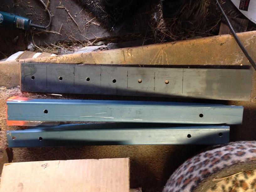

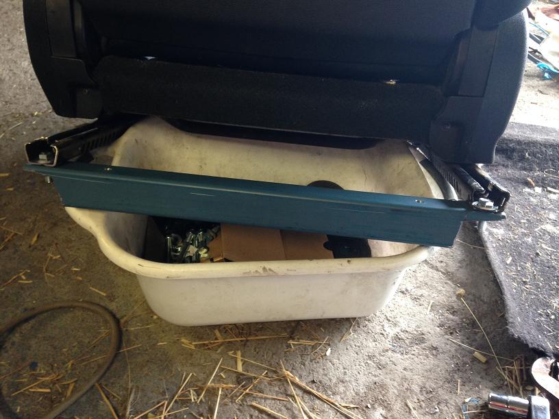

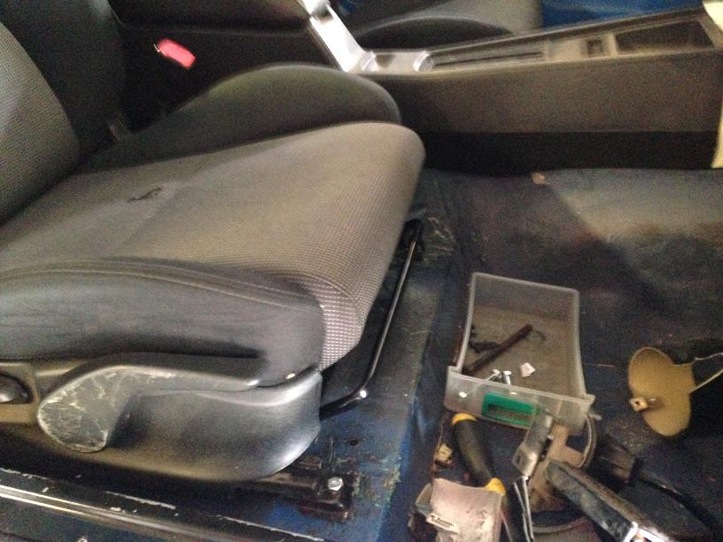

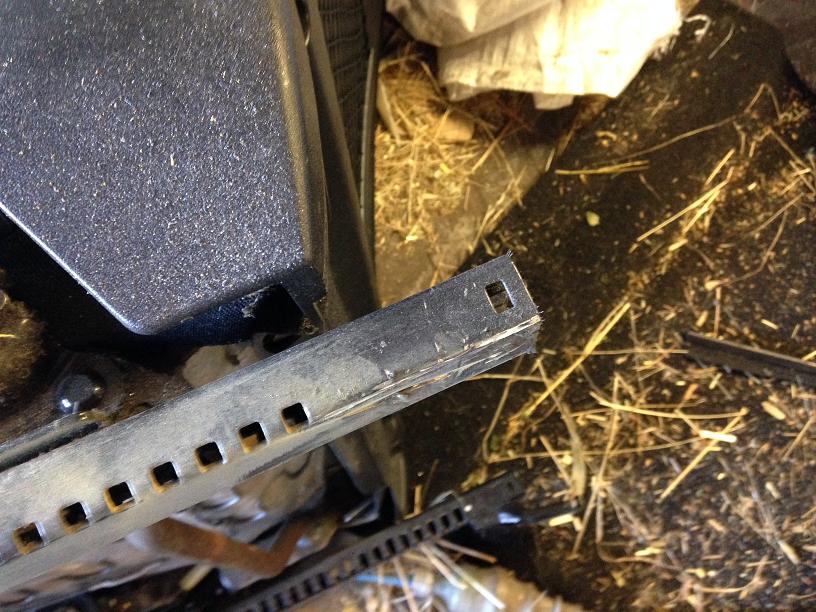

seems as car tunnel and side start to be bit messy with folds/brakelines directly below the (rather widely spaced) rails,
..have to bring holes/bolts inwards an about 3 inches, at rear ends, to mount to the floor.
used 3mm square, and 5mm flat for backing plates/captive nut
neatened front mounts
hacked off rear mounts
prepared mounts
trial mount begins
shows how much longer front inner bolt needs to be, to reach under car floor to captive nut/plate
doesn't interfere with foot space very thankfully.
about a 1/3 finished, but getting there

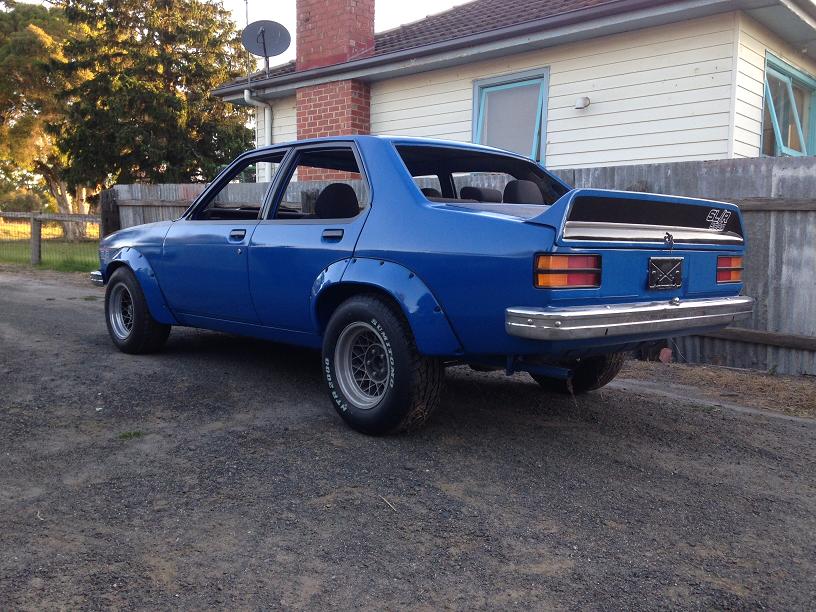

lovells HFL-14's matches the paint, bonus!

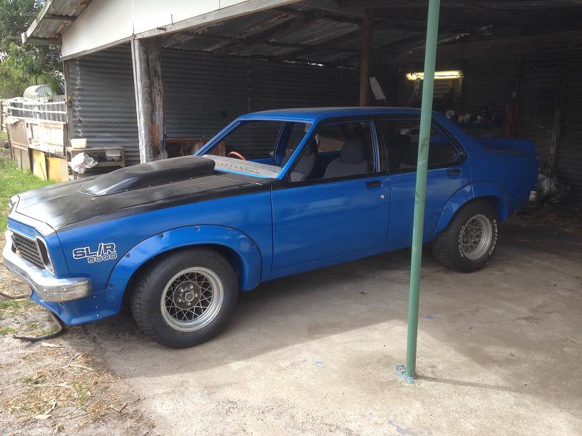

#255 _livo74_
_livo74_
Posted 15 January 2017 - 03:26 PM
minus sway bar and shocks (long story!)
... but lowered on hfl-14 lovells at front.. instead of the mega cut 6cyl's that were in there. (rear still to buy/do)
Edited by livo74, 15 January 2017 - 03:30 PM.

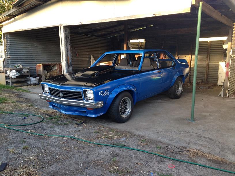

Posted 15 January 2017 - 07:16 PM
the open walled barn find look mecho!.. complete with loose hay bales for added ground ruffidge!!  :lol:
cheers shiney! i'll tell you it felt good just rolling it around again, can't imagine what it's like to jump in and drive!
 bit dusty in pics above. gave it a wipe with micro fibre cloth, and took some pics at "magic hour", will put up.
not washing her properly till glass in. (well, that's my excuse for being slack anyways!)

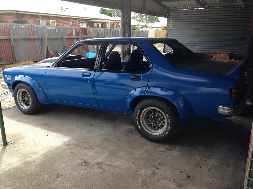

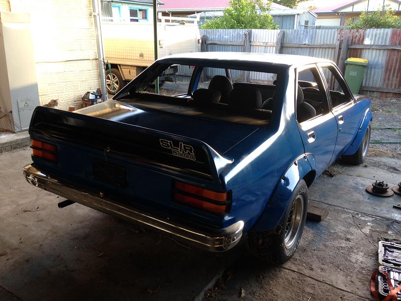

#260 _livo74_
_livo74_
Posted 15 January 2017 - 07:28 PM
not washed, haven't cut back yet.. but even still
..maybe because i used a $40 spray gun and it has orange peel the size of walnuts.. it's never going to look like glass. hahaha
(and for $400.. no one expected it too! ;) )

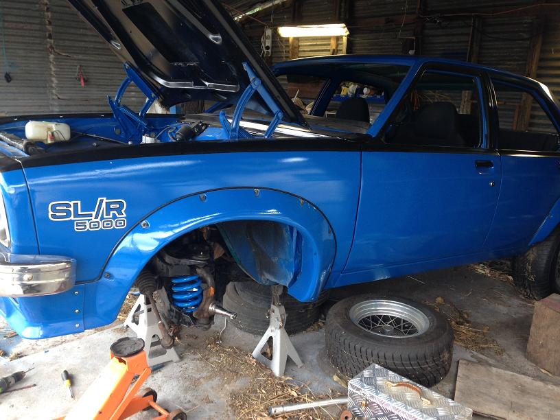

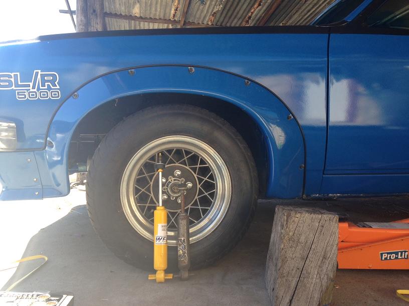

Posted 16 January 2017 - 08:03 PM
cheers shiney, didn't think of that. (hadn't water washed it due to it not having glass or rubber kit, so lucks a fortune!)
am looking forward to the rubbing back and polish. normally an odd thing to say! but hopefully get to see it in full vigor
and, frOck. so i put in the shocks today
told they are for lowered and standard.
they raised the car/front another cm!?? lowered... not really! arghh!
am looking out for shocks like the ye old ones in pic, tiny monroe riders.. or alike

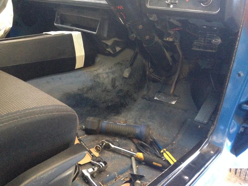

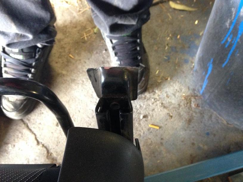

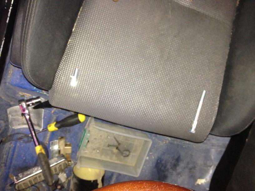

Posted 27 January 2017 - 03:21 PM
out with the manual clutch pedal and small brake pedal.. and in with the large brake pedal.
am sure other people fond it easier than me but i thought the working position and room ssssucked!
#264 Bigfella237
Bigfella237
    Socially Distant
  • 4,396 posts
  • Name:Andrew
  • Joined: 31-October 14
Posted 27 January 2017 - 08:20 PM
Well there's ya problem... you've done it backwards... you're supposed to take the big pedal OUT and put the two smaller ones IN! :P

(just a heads up, if anyone else is planning to put cheap webco shocks in... make sure you have UC lower control arms, which have the wider opening. or else you are going to have to take whole fooking suspension apart to install or replace shockers... or?? have to cut hole bigger! shocks are WIDE!)

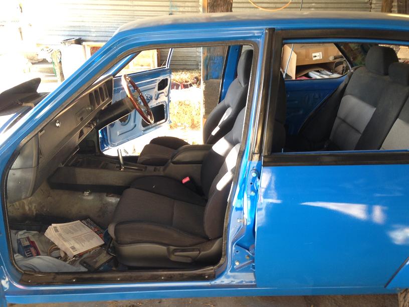

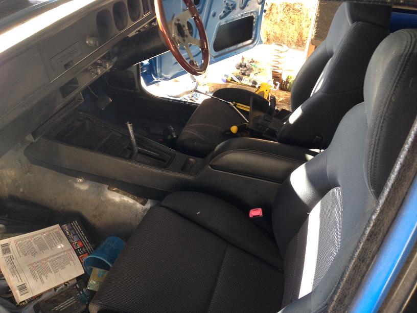

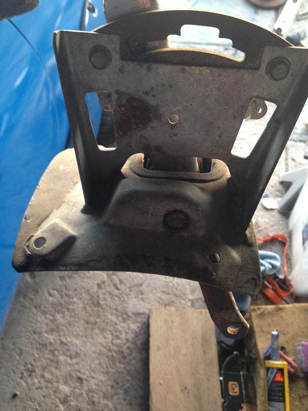

Posted 02 February 2017 - 07:36 PM
console brackets and shifter mounted
#271 _livo74_
