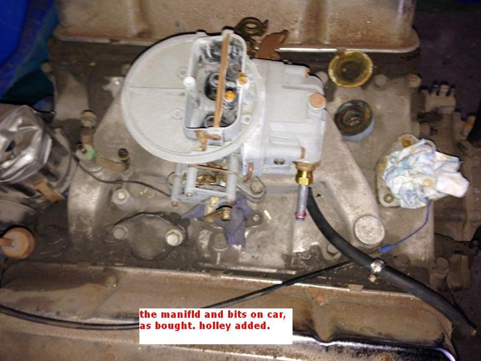

and now my lack of knowledge regarding engines is coming to the fore.
i just bought a second hand manifold to get  the egr off it.
seems to have a few pollution? bit and pieces i may also need. ??, um, ??
(any thoughts would be appreciated)
edit: manifold on my car is a 2 barrel,
told new manifold is off a 308
Edited by livo74, 23 February 2017 - 07:56 PM.

Yeah that 4bbl manifold is off commodore...extra pollution crap/cold start.
Really just need charcoal cannister hooked up & as long as it looks neat should be fine...if fussy fit pcv & factory snorkel aircleaner.
Torries are old now most don't even know what's meant to be fitted to them
As above more likely to knock you back for holley or aftermarket seats if they're strict.
Edited by gtrboyy, 25 February 2017 - 03:49 AM.

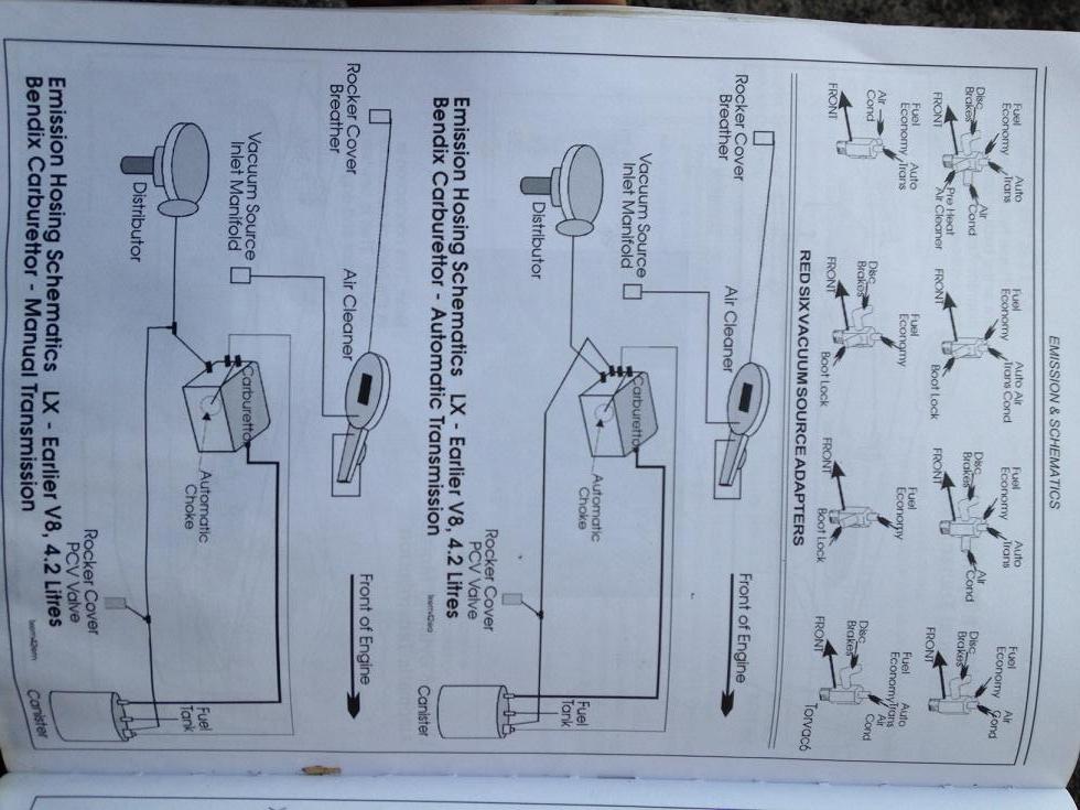

from my manual
but never mind, is all sorted.
if i just attach the battery, surely it will fire up nicely running a smooth idle.

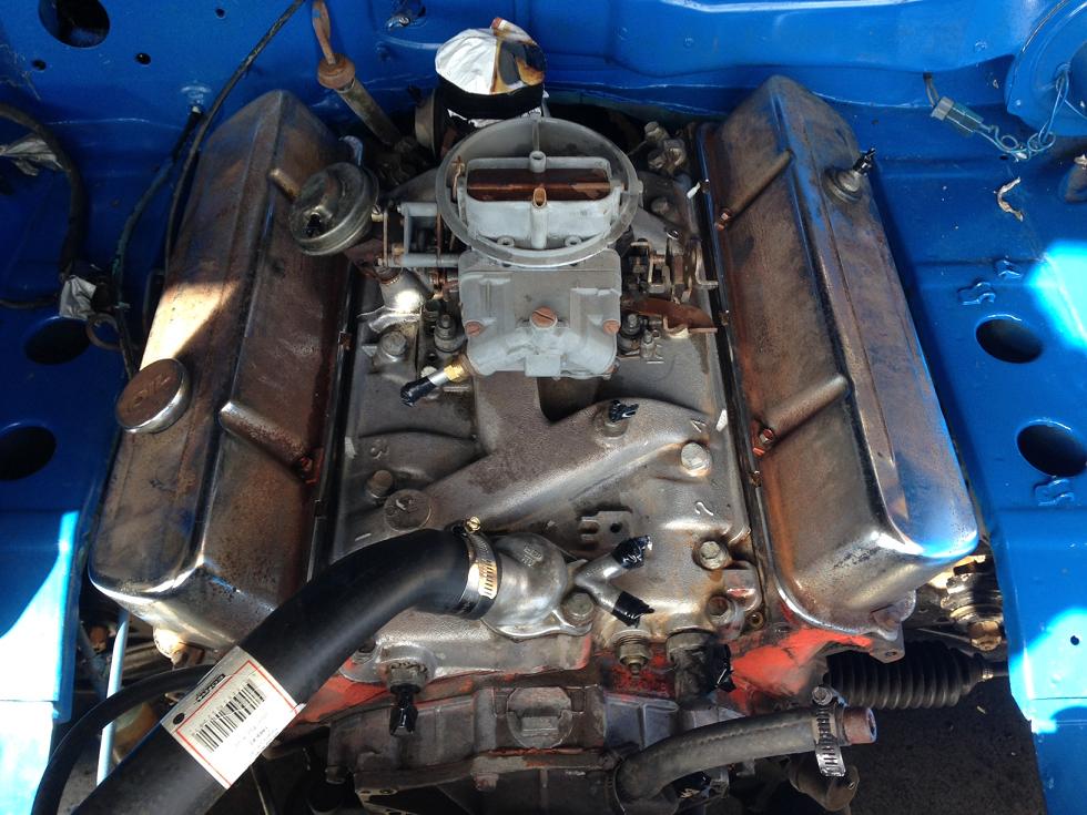

#290 _livo74_
_livo74_
Posted 25 February 2017 - 10:39 PM
maybe if i knew the names of some othese things i'd be able to get a grasp
any help would be appreciated!
1=
2=
3=
4=
5=
6=egr valve
7= dizzy vacuum advance (?)
8= goes to disc brakes (on booster i gather)
9= joins to pipe leading to auto trans
10= "fuel economy"?? is that a pipe that i can't see in image?

#292 _livo74_
_livo74_
Posted 25 February 2017 - 10:52 PM
cheers rob, image is from the lx resto manual though. as shown above. (shows about 10 variations of that "tree, just to be confusing)
and my tree only has 3 ports coming off it, (and not a 4th, i think. well the tree i am using anyways.. the metal one on car as bought)
Edited by livo74, 25 February 2017 - 10:56 PM.
#293 gtrboyy
gtrboyy
  • 3,265 posts
  • Location:SYDNEY,NSW
Posted 26 February 2017 - 12:26 AM
1-temperature switch for air con fan
2-water temperature sender(green wire to dash)
3- cold start vacuum switch for commodore pollution crap (not needed)
4-vacuum nozzle (hook hose from there to no.7 distributor vacuum advance)
5-heat riser pipes(pollution gear suits original carby only) block them off
6-egr valve (usually hose off no.3) messy commodore pollution crap..prefer blank plate you got.
7- Distributor vacuum advance
8- Brake Booster
9- should also have long thin pipe from that piece all way down to back of auto(helps shifting gears etc)
10- commodore dash has vacuum/economy gauge (not needed)
Oil sender is chunky thing down lower right side (blue wire to dash)
Hose on water pump with bolt & clamp on end goes to thermostat housing in front of it
^^^ That's enough to keep you in trouble for a while.Use the original metal tree piece for brake booster etc as plastic tree version tend to break.
Still got any of old wiring harness?
Edited by gtrboyy, 26 February 2017 - 12:35 AM.

#295 Bigfella237
Bigfella237
    Socially Distant
  • 4,396 posts
  • Name:Andrew
  • Joined: 31-October 14
Posted 26 February 2017 - 12:34 AM
Okay basics first, and you missed labeling a couple of things too...
Attached File  IMG_1102_b.jpg   360.24K   4 downloads
In this image, connect the two fittings circled in blue, so from the right-angled fitting that comes out of the Holley metering block, to the vacuum advance on the dizzy (7).
The two water outlets circled in orange need to be connected together, this is the thermostat bypass circuit.
The other two water outlets circled in red go to your heater core (inside the dash), the top one from the thermostat housing goes to the top pipe on the heater core, the bottom pipe on the heater core returns to the second fitting on the water pump (I assume there is a second fitting, it's hard to see).
Hopefully there is another large vacuum fitting under the front of the carb too, where the purple arrow is pointing? You can connect this to the charcoal canister. Assuming your charcoal canister only has two fittings, the second one will connect to the (steel) hard-line that runs back to the fuel tank (vent). If your canister is the later type with three fittings then I suggest trying to find an earlier one with only two (the third fitting was a float bowl vent on later carbies but yours has no provision for that).
Brake booster (8) and auto trans modulator (9) you already have sorted.
(1) and (3) are thermal valves (they open and close vacuum ports based on coolant temp), for now you can leave them completely disconnected but I would be trying to find some blanking "bungs" to replace them with and removing them altogether, nobody will miss them on a Torana.
(2) is your temp sender and should be connected to the wiring harness (it's a green wire from memory).
(4), (10) & "air cond" can all be blocked-off for now (I suggest a short piece of vacuum hose with a small bolt jammed in one end rather than using insulation tape, or (10) & "air cond" can simply be joined together).
(5) and (6) can be left disconnected for now.
That should be enough for initial startup, there's still a few things to address later but one thing at a time!
