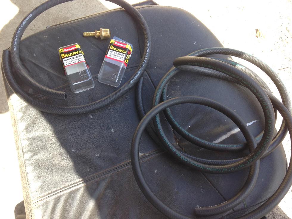

new bits! $30 well spent.. hopefully!
(going to repco and saying... yeah... about that ish diameter;)
note, the full vac nozzle and bung for canister "purge"
Edited by livo74, 03 March 2017 - 03:41 PM.

What's with the "Reducing Bush"?
Surely that's not needed for your #4 vacuum fitting (the one up on top of the manifold)?

and to answer the question... it COULD be, but wasn't specifically.
went in for rubber hose, saw that they had the bung and reducing bush for $4 each.  thought, can't go wrong trying?! surely not.
Re: "purge"
i asked a zillion times trying to get my head around it..
full vac, thermal vac, #4 vac...
obviously, i didn't do a great job at that, aye!
so, saw those for two parts cheap as and...
was... planning to take out one of front manifold bungs put them in, and run the hose to  "purge"
..and if that wasn't right
(as #4 is far smaller nozzle than the "purge" outlet) thought could replace with these to keep same diameter hose to "purge"
????aaargh!

That's what I was saying before about those thermo-valve things not having vacuum.
Those three larger bungs that screw into the front of the manifold from the front (including the temperature sensor) go into the coolant passage, if you were to use that reducer in one of those it would pump coolant into the charcoal canister... which would not be good!
You should only need the ΒΌ" barb fitting to replace your #4 fitting, the one that screws into the top of the manifold.
#375 _livo74_
_livo74_
Posted 03 March 2017 - 05:49 PM
so... NOT in the front, aye?
hahaha!
um, oops.
and, glad only $8 total.
kinda was looking at the wrong pipe.  "purge" outlet is only bit bigger diameter than #4
still might use the 1/4 barb fitting
___________

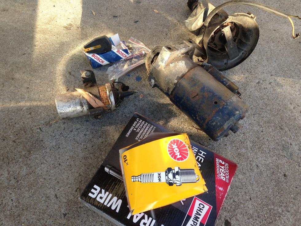

stuff have scrounged together over last 2 years.
am... hoping that i made a mistake in saying that "the dizzy in car is NOT what i am using"
cus the one in pic is snapped, and is the old "points" one, i think
hoping the one in car is the electronic dizzy.. that i bought the rotor for.
