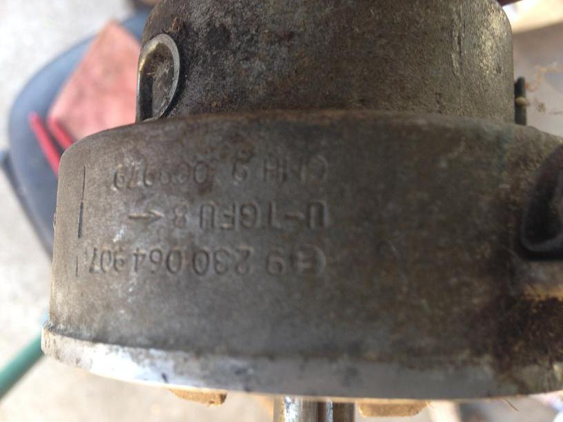

~ looks like once the "lower" bit that is broken is taken off the dizzy it might reveal that the dizzy will take a standard cap and rotor ? ~
Yep they will, the bottom half even clips on with the same standard clips that secure a 'normal' cap.
As mentioned earlier, I'm pretty sure those bigger two-piece caps hit the firewall in a Torrie? And I think there was a smaller ford high energy cap (with the male terminals) that fits, just can't remember the specifics?

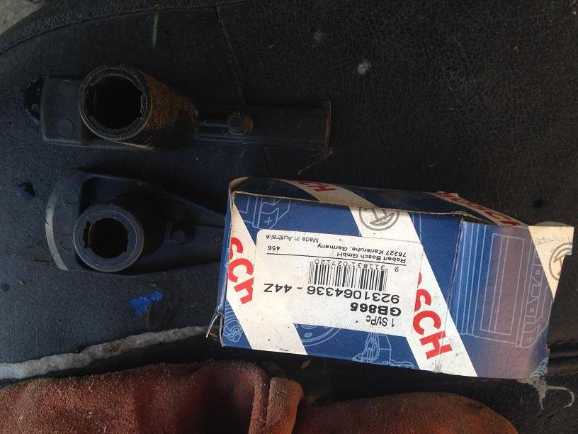

much appreciated info on dizzy fellas!
hoping this helps
if the cap fits...
which it DOES, perfectly! (cap from old dizzy on car)
the old rotor doesn't fit.. because too LONG (but has right size hole, of course)
nor the new one i bought, because hole too small
nor the one on old dizzy, agin hole too small to mount
wear it..?? (with the changes you mentioned, andrew ..??)

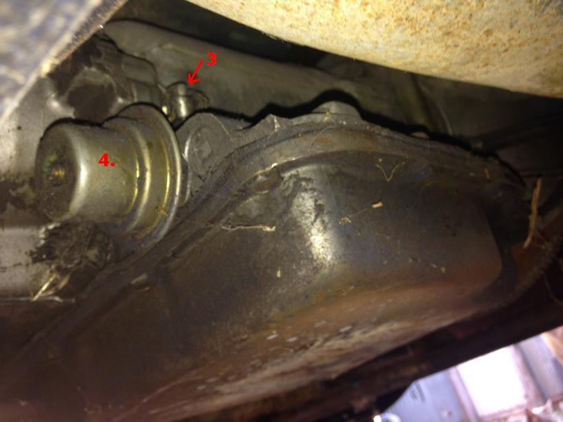

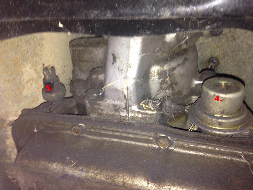

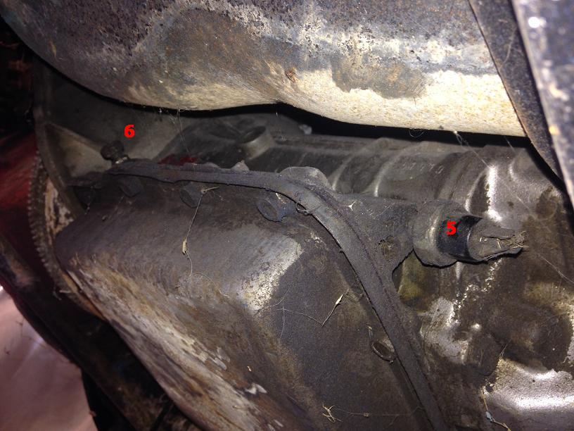

now, the other mischief i have been up to
so.. i jacked up car to check color of drive gear (inside the trans)
and... i couldn't fkn find it. classy!
found all these things i don't know the name of..
and, if anyone can point out the trans drive gear place that would be tops! haha
1. trans modulator line
2.
3.
4.
5.
6. selector
in the words of meatloaf..
2 out of 6 ain't bad

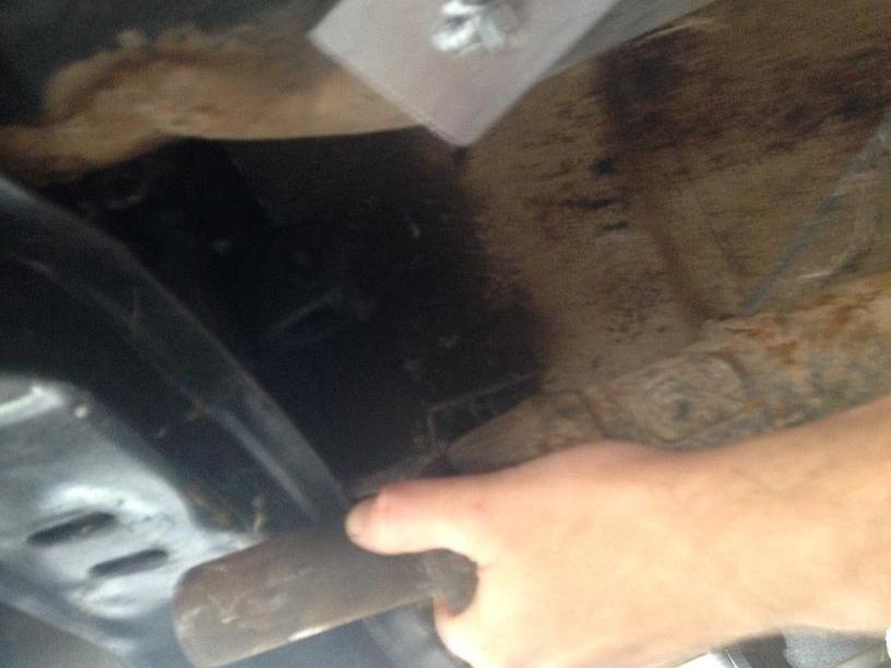

Posted 04 March 2017 - 07:17 PM

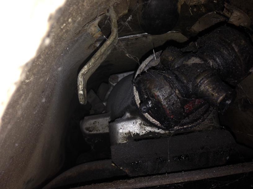

and wasn't expecting to see this..
hope you guys were!
won't be slipping a yoke in there any time soon! what the hells that doing there?

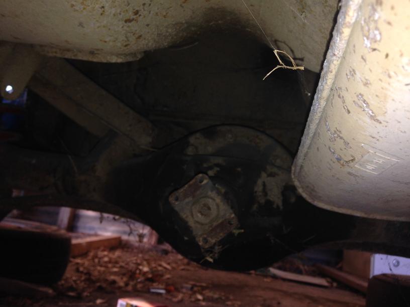

and, this is the rear

There is one coloured gear on the end of the speedo cable and another one inside the transmission extension housing where the cable plugs in.
You should be able to see the colour of the inside gear through the hole with a torch.

& 4 is the modulator by memory, haven't seen a trimatic up close for a long time.

1. Trans oil line to radiator/cooler
2. Kickdown switch
3.Trans oil line return from radiator/cooler
4. Vacuum modulator
5. Reverse switch
6. Selector shaft.
 Good luck!
couldn't find the hole even! not a good start

cheers gary, and lemon!
oops, trans oil line is #1, NOT modulator
(hmm, where to attach the hose??)
i need so much luck it's not funny lemon.
hand some over if have any spare too, k ;)

looks like someone has slipped a slip yoke up the rear ext. housing minus the tail shaft ...always a good idea to block off areas that could
let moisture/dust etc. into the trans.
Going on the picture  ...# 2 will be what they call the " high speed kick down"....this was a solenoid that was activated either by a switch on the throttle lever on the carb. , ...or in the case of LX auto  (as far as i know?) was activated by a switch on the go pedal ? , it only works when you stomp on it given a certain speed was sensed in conjunction with what the vac. modulator/governor  was doing in regards to road speed to kick back a gear given preset  conditions in trans. ?
#4 is the vac. modulator , it has a  place where a tube is fitted from full vac. from the intake manifold.
# 5 looks like it might be a switch to turn the reverse indicators on when needed.

and, so if i yank on that yoke it should slip out?
sounds very good that they left it in there to stop dust and crap

Yes you can just slip that yoke out but be prepared for a trans fluid shower if it still has oil in it.
BTW, that's a V8 slip yoke, notice how much wider the uni joint is than the 6 cylinder tailshaft you pictured earlier?
Also, it's bloody hard to see from this photo...
Attached File  IMG_1208a.jpg   222.01K   3 downloads
...but I think I can see the bolt and tab thingy holding in the cutoff end of an old speedo cable (which would explain why you can't find the hole)?

You won't have to yank it mate, just pull on it. Put a bit of rubber grease on the slip yoke where it goes into the seal when you fit the tail shaft & don't force it in. In the middle of the vacuum modulator you should see a little pipe coming out of it & that's what you put the vacuum line from the tee onto. External switches, solenoids & the modulator i would personally replace as you assemble the car. Quite often they're pretty ordinary from the conditions, Gary.

thanks andrew , "slip that yoke out"
can do.. when i have a v8 tail shaft by the sounds of it. darn it.
"but I think I can see the bolt and tab thingy holding in the cutoff end of an old speedo cable (which would explain why you can't find the hole)?"
excellent, wondering where that sucker was.
um, not fun accessing it?

"In the middle of the vacuum modulator you should see a little pipe coming out of it & that's what you put the vacuum line from the tee onto"
on the rear of it, in pic?
thanks! will have a closer look (not that access/working conditions are great)

The 6 cylinder tailshaft will physically connect to both the transmission and the diff you have, but it will likely be too short (I think it's that way around)?
If you find a V8 tailshaft, it will also fit the transmission and it will be the correct length, but it won't fit the 6 cylinder diff yoke.

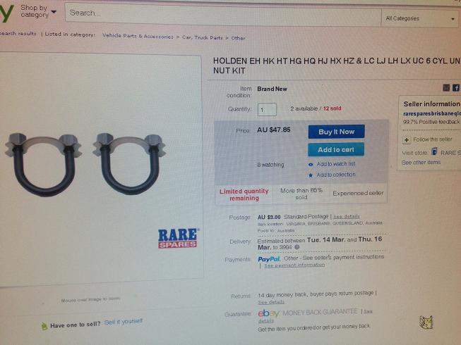

Bypass fuel tank,just use your lawnmower jerry can with hose in it...save yourself the headache.
Add banjo 6cyl tailshaft u bolts to WTB ad
Use wd40 & fine wed/dry sandpaper give slip yoke a good linish...leave that chopped yoke in there,keep auto sealed.
Use that tailshaft,be fine for normal usage.
Green arrow is speedo hole,probably still bolted in & they cut cable...unbolt...clean yours up & bolt it up,make sure write down gear colours.
Looks like lemonaro labelled correctly.
Should be nozzle in middle of modulator hose will slip onto.

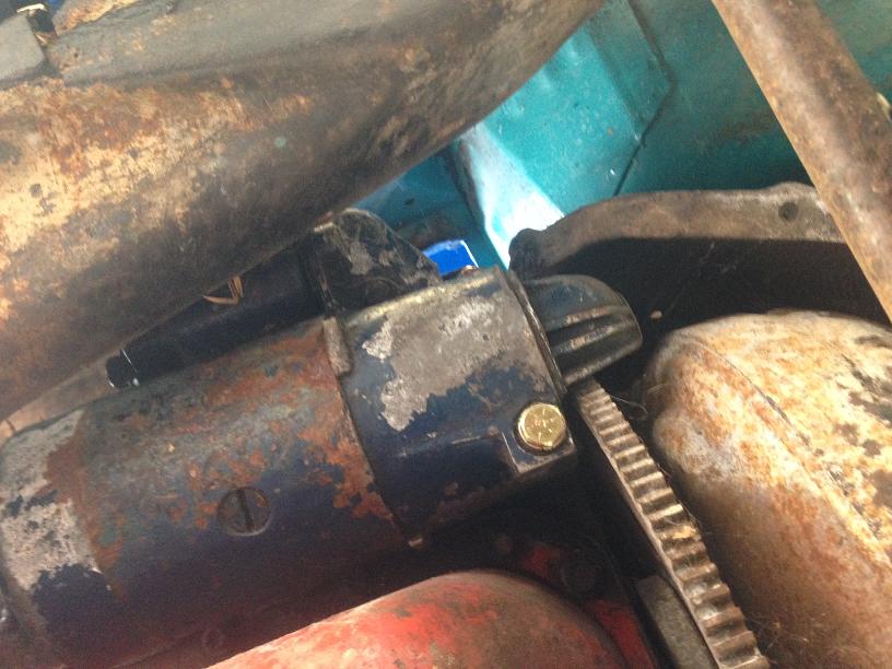

Flip starter on end as in nose up take pic so can see what starter bolts needed...early ones take 1 short 1 long later have 2 even length bolts

"The 6 cylinder tailshaft will physically connect to both the transmission and the diff you have, but it will likely be too short (I think it's that way around)?
If you find a V8 tailshaft, it will also fit the transmission and it will be the correct length, but it won't fit the 6 cylinder diff yoke."
well thats just depressing andrew!
will check length.
"add banjo 6cyl tailshaft u bolts to WTB ad"..
now that's more optimistic gtr!

re: speedo drive, andrews nice green arrow work it is, then.

"Flip starter on end as in nose up take pic so can see what starter bolts needed...early ones take 1 short 1 long later have 2 even length bolts"
bought the bolts kit, it is the longer and shorter for my old model starter
(and i like grump's suggestion for future.. "the vs v8 starter is very easy to fit in with extractors anyway so that would be what I'd use when you need to replace it. ")
and...

and the good news
i fitted my (tested and working) starter moter :)

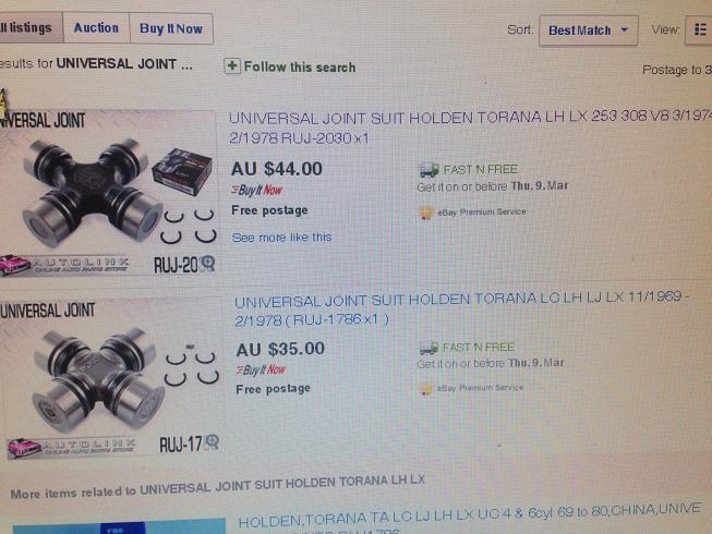

and i gather these are the u bolts i may need
and one of these whilst i'm at it

anyone else running a tailshaft that fits,,,
but is almost 2 inch's shorter than perfect length!
darn it.
here's the odd part.. i could post 5 times how people in threads doing 6 to 8 conversion said shaft will be fine/or HAVE done it.
did they just forget to mention that there's is 2 inches short and not tell anyone??
(some did say "might of/have to" changed yoke or uni.. but NOT all.)
anyone got a yoke 2 inches longer i can chuck on hahaha
Edited by livo74, 05 March 2017 - 10:04 AM.

Yeah I figured that would be the case, a 6 cylinder engine is longer than a V8 and so sits further back, therefore has a shorter tailshaft.
You'll probably find the gearshift selector rod is the same (a V8 rod will be longer than a 6).
I would definitely hold-off buying those 6 cylinder uni-joints and U-bolts too until you know which way you're going with the tailshaft, if you end up using a V8 tailshaft you'll have to change the diff yoke to a V8 type and the 6 cylinder uni and U-bolts will be useless to you.

You will need an inspection cover fitted to your bellhousing too for rego...
Holden-V8-Inspection-Clutch-Cover-Nos-Tr
...which needs to be fitted before the starter motor (and is much easier to fit before the extractors too).
BTW, is the torque converter actually bolted to the flex plate? It looks like it's not sitting all the way forward?
are there longer jokes? googling them they appear to be specialist jobs
in this pic the EJ/H appears to be the perfect length,
but might cause other probs?? yoke/uni not fitting??
http://holdenpaedia....lshaft_ID_s.jpg
and will source v8 rod :)
and hold off buying everything.. till i stop my brain leaking out of my eares from meltdown
