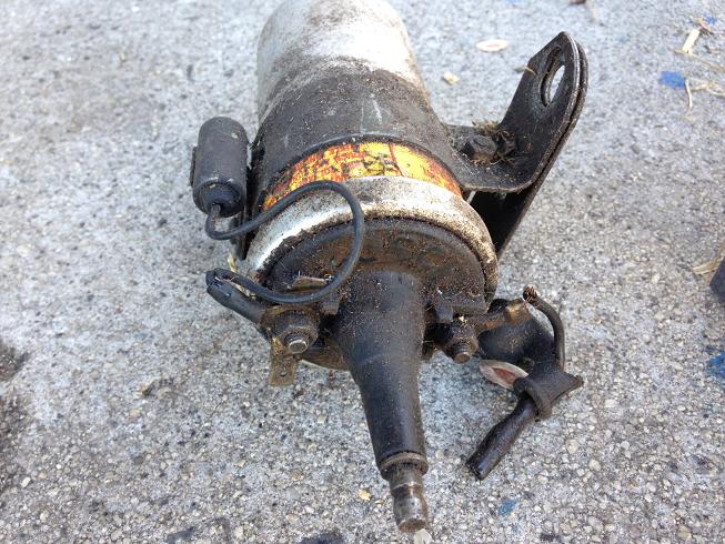

That distributor pictured above is electronic ignition, it's the HEI (High Energy Ignition) distributor from a blue motor (WB or Commodore), providing it works I'd be using that over a points dizzy any day, although it requires a different coil, leads and some re-wiring of the ignition circuit in a Torana.
It looks like only the bottom half of the cap that's broken and it looks like you're missing the top half of the cap, but I think those large caps hit the firewall in a Torana anyway? You can get a smaller cap and rotor for those distributors, from memory I think there was a ford HEI cap that fitted but wasn't as big as the Commodore one?
But honestly I wouldn't be taking on any new projects for now, just get it running with what you have and worry about upgrades later, unless there's some wrong with your current dizzy of course?

"..although it requires a different coil, leads and some re-wiring of the ignition circuit in a Torana."
yup. later project!
damn it. i think i bought the new cap too that you are talking about.. only i can't find !
was told to by guy bought car off, and did/tried to. 2 years and many beers ago.
don't think anything wrong with dizzy, he just wanted me to have the better one.
i think i snapped it by having in same box as starter motor, though cant find any broken bits in.
puzzler.

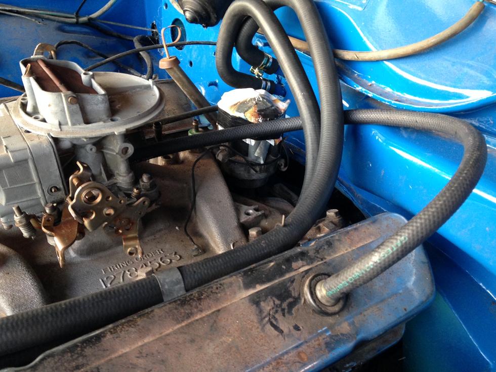

see, looks like everybody else's!
doh!!
fine tuning aplenty, (and most don't have clips to secure hoses.)
"purge" to #4 hose was all had and is wayyyy to short. will re-route when have more.
not keeping, but put EXTRA filter so could see fuel when trying to get going.
don't know if good idea or not.
and here is the first of the pcv's as yet.
am going to get an angled tee, so leads to carb better.
.. that said, wondering if i can get a double, like this.
or, the one to the air filter needs to come from other rocker cover.
and haven't connected tee to trimatic and booster as yet.
Edited by livo74, 03 March 2017 - 07:06 PM.

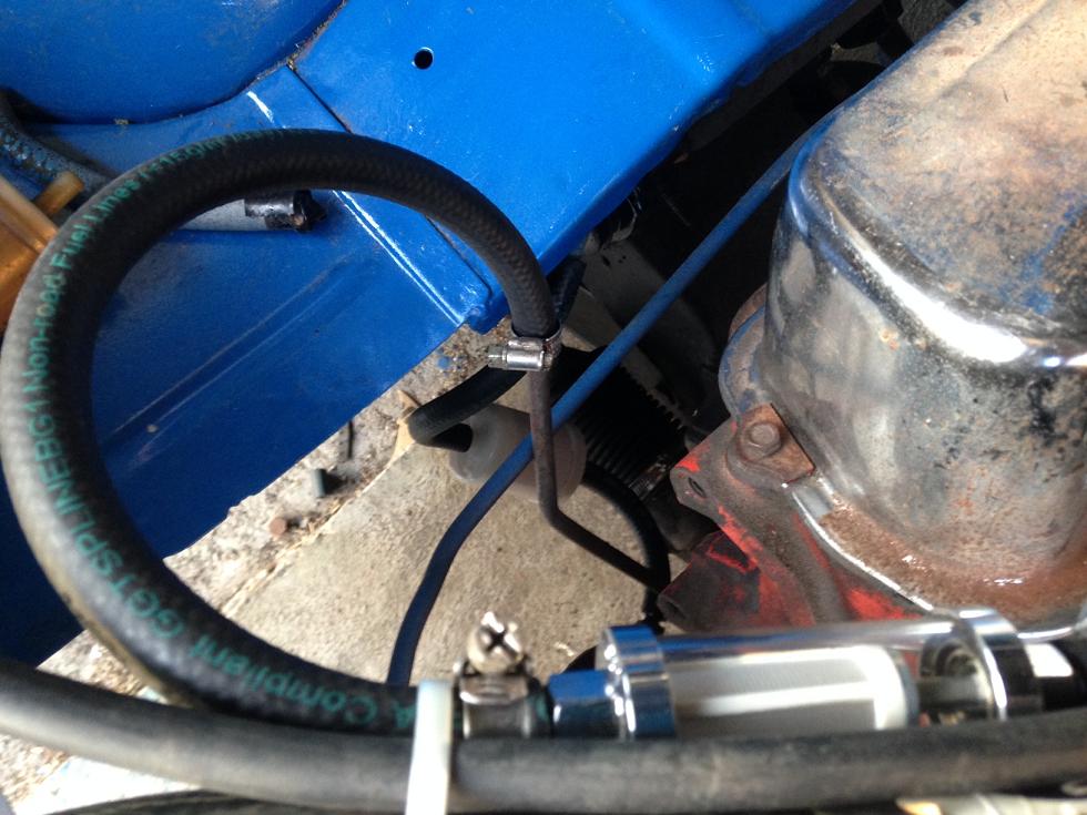

Posted 04 March 2017 - 12:26 AM
Ditch glass filter...when it's running you'll see fuel in plastic filter easily enough.
If I was doing it for first start up I'd use gerry can or 1 litre bottle(long hose off fuel pump)...that factory tank will need a good cleanout..bet ya smells like paint stripper & manky rusted water.
Ps Looks like that new rotor(xd falcon??) button is for small cap so it's probably hiding somewhere,check if points one fits (search on forum to be sure)
     Coil looks 6cyl hei,bolt it to the exposed bolt hole 4 inches behind 'firing order'
*Hose from vacuum tree to modulator should be ok...can check again later when it drives.
*starter motor looks like chunky earlier version,will be fine with cast headers...check that it works off the car then use it untill it dies,get proper factory bolts
Not keen on purge line like that...rather glue fake nozzle underneath aircleaner or carb for it.
Same with pcv hose off rocker cover goes to fitting underneath aircleaner...then VAC hose off canister to that.(My guess)
How's that for sensory overload haha

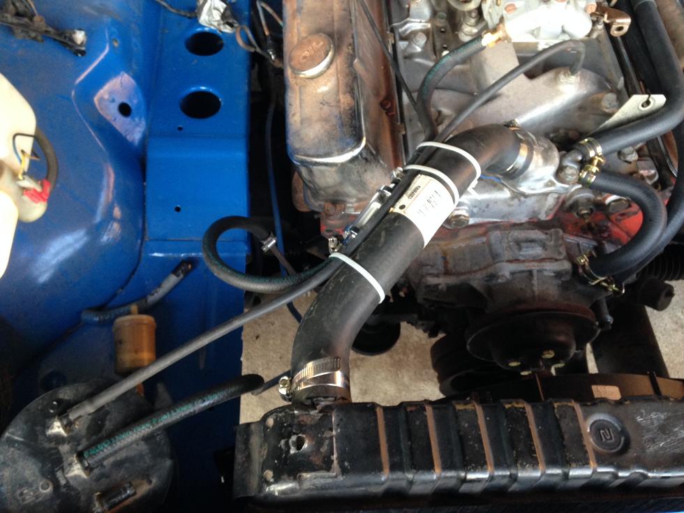

I can't remember exactly but I think there's a twist to that PCV valve, I think the top port 'controls' when the lower port opens, or something like that?
Are you running the auto trans cooler lines to the radiator (is that even a radiator from an automatic car)?
Or are you using a dedicated transmission cooler? If so, you'll need to get your air con condenser mounted in front of the radiator first, then mount the cooler in front of that.
I would definitely install and test (or test and install) the starter motor before installing the exhaust, if you're gonna test it on the car, make sure you have engine oil and trans fluid before turning it over (do you even have a tailshaft in yet)?
Did you get the speedo cable in too? Did you happen to see what coloured speedo drive gear was inside the trans? If we know that, and your diff ratio and tyre size, we can tell you how accurate your speedo will read and which driven gear you need to fix it?
EDIT: I've been meaning to mention as well...
I'd be a little concerned with the way those heater hoses are angled too, there's a good chance you will get two pockets of air trapped in those? Is there any way you can turn them clockwise so they run flat or is that second bend moulded into them?
Technically the radiator cap is supposed to be the highest point in the cooling system so any air pockets find their way there and are expelled automatically when the system builds pressure, but I don't know if the flow through those heater hoses would be enough to push such a big air bubble through?
Edited by Bigfella237, 04 March 2017 - 06:06 AM.

ok, here goes fellas.. (and gtr, being capable of dealing with sensory overload is not my.. specialty ;) )
1 -will ditch glass filter...
2 - FUEL TANK
-never done before/or researched, classy aye!
..but imagined before ran car was going to open/disconnected fuel line at engine bay.. and point hose into a jerry can ,
-then, pour in 5 litres, send power to fuel pump? (or are they solely mech?), then run pump till tank empty, ...
-repeat another 3 times... to have cleaned tank... and then THROW AWAY the petrol,
- and then reattach fuel line, and fill tank with new petrol
or... use jerry can as gtr said ??
3 - DISTRIBUTOR
re: "new rotor(xd falcon??) button is for small cap so it's probably hiding somewhere,check if points one fits"
- will take photo's of the rotor and serial, will look for new cap i bought.. or tried to buy.. but failed? something happened, can't remember
4 -COIL
"Coil looks 6cyl hei,bolt it to the exposed bolt hole 4 inches behind 'firing order'"

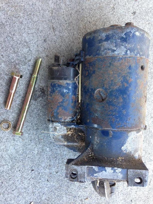

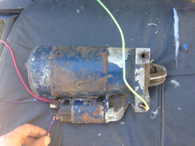

6 - STARTER MOTOR
"starter motor looks like chunky earlier version,will be fine with cast headers...check that it works off the car then use it untill it dies,
get proper factory bolts"
and
" I would definitely install and test (or test and install) the starter motor before installing the exhaust, if you're gonna test it on the car,"
- will test off car.
??in a vice, or on floor.... and just plug power to it??
- damn, i bought NEW bolts off ebay for it, will show a pic to see if right ones.

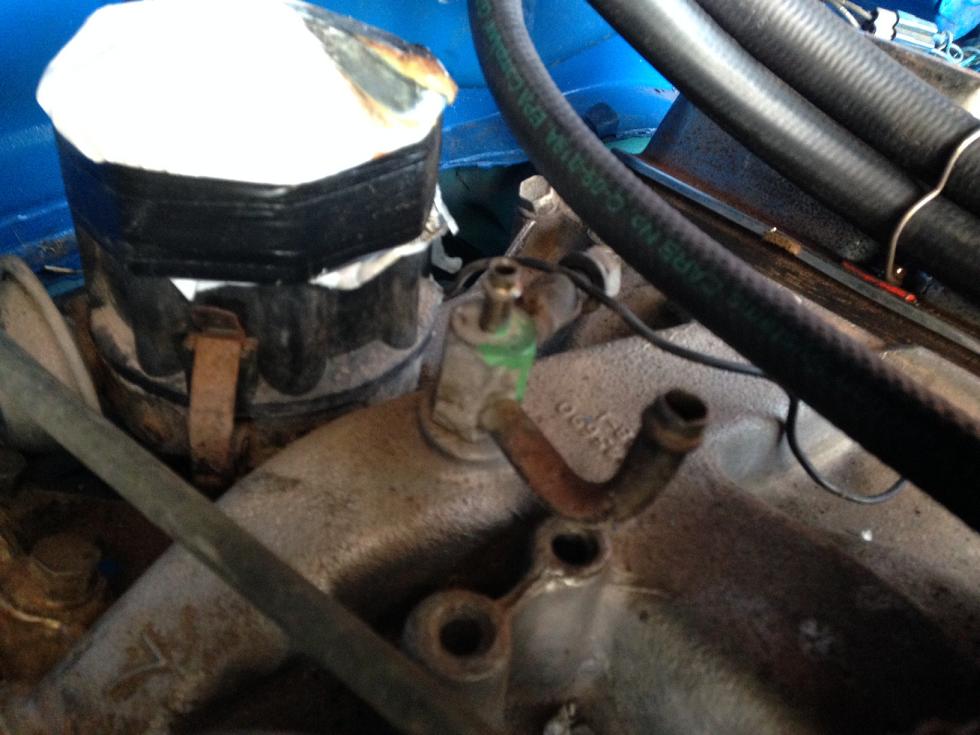

7 - CANNISTER PURGE LINE
"Not keen on purge line like that...rather glue fake nozzle underneath aircleaner or carb for it.
-will block off #4 for now ?,
- and not run canister purge anywhere for now maybe.
-i can glue fake nozzle underneath aircleaner or carb for it, if needed easily

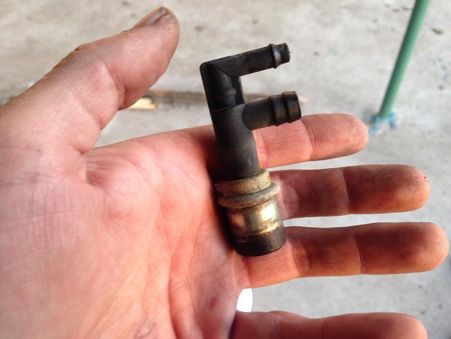

8- PCV VALVE AND HOSE
-was planning on running TWO pcv's
-one from pcv hose off rocker cover goes to fitting underneath aircleaner...
and one from back of carby to the other rocker pcv
(all trickiness caused because my carrby doesn't have the usual carby port on front of it.. to simply run to canister "purge", i believe. )
re: "then VAC hose off canister to that.(My guess)"
- none of canister ports are labled "vac".. do you mean "carb", "tank" or "purge"
9 - DUAL PCV
throw away

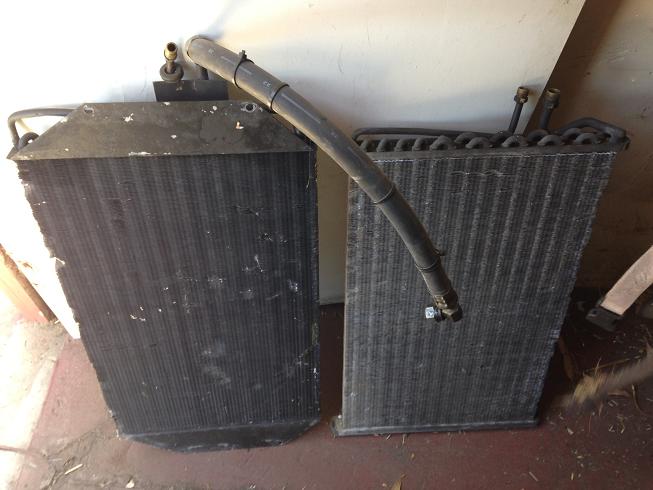

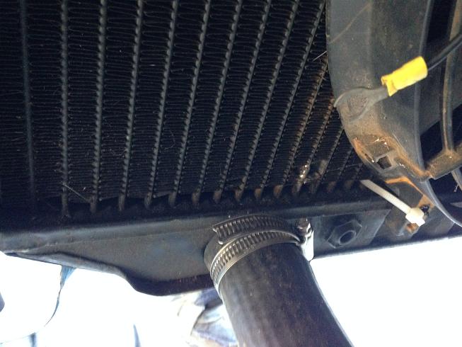

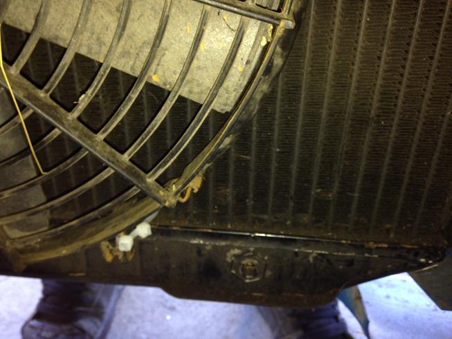

10 - TRANS COOLER
"Are you running the auto trans cooler lines to the radiator"
-surprise! i have no idea. (slaps forehead) will post pics of what i have
"Is that even a radiator from an automatic car"?
. um. hmm. again, will post pics

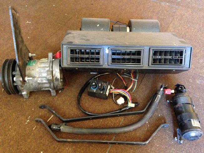

"Or are you using a dedicated transmission cooler? If so, you'll need to get your air con condenser mounted in front of the radiator first,
then mount the cooler in front of that."
(i do have another two smaller radiators, but it think are for AIR CON. ?? will post pics)
-was given radiator with car. believe is V8.
-and, is it better to run DEDICATED trans cooler?
or... simpler to run lines into main (proper/correct AUTO) radiator?
- will buy new one if need to
11 - HEATER HOSES
"Technically the radiator cap is supposed to be the highest point in the cooling system"
- wondered about that.
-and, that is how they are molded.
-tried to look at other pics, but always seem to be hiding behind "air cleaner" in pics of others engines.
-they are FAR higher than radiator cap, at present
-turning clockwise (in pic) might help,will try,
-anti might too, as would PULL away and lower height, i have been suspecting

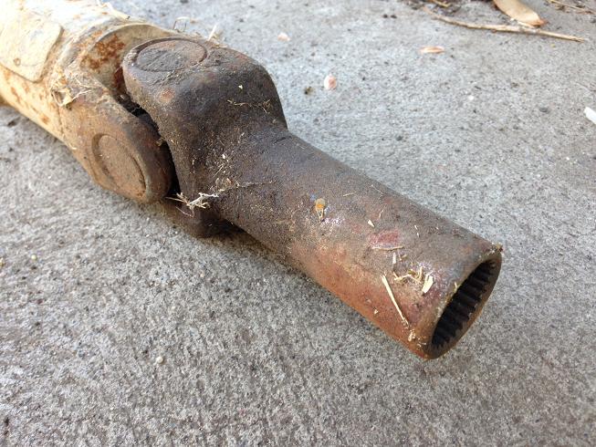

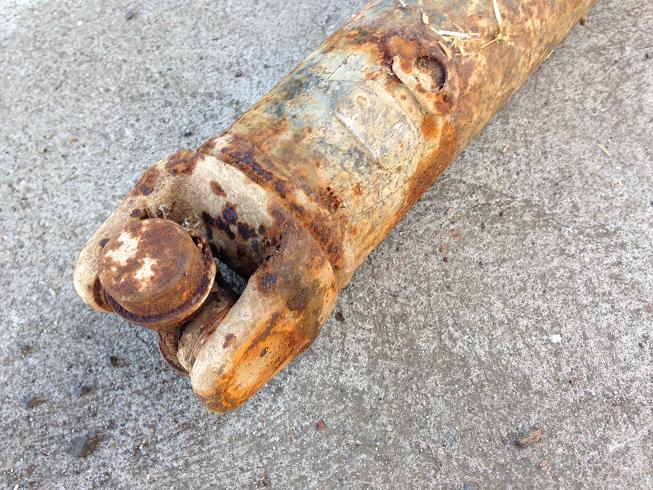

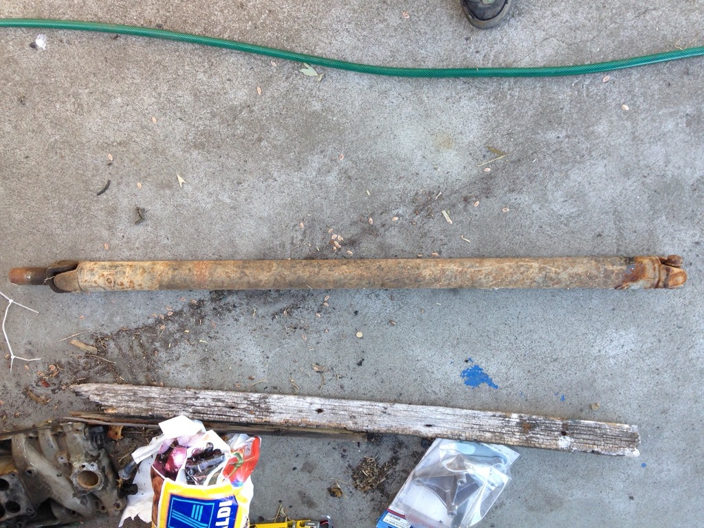

12 - TAIL SHAFT
-i have one... was given with car. will post pics. (might be off a six/wrong one)
-is not connected. (nothing was. dont even have engine mount bolts, just "plonked in", was told.) *must remember to buy Mount Bolts!

1. may as well leave that glass fuel filter where it is for the initial start up, the more filters the better for now!
2a. looks like you just have a standard mechanical fuel pump it won't pump unless the engine is running.
2b. the only way to really clean a fuel tank is to remove it so you can slosh it around and drain every last drop (the fuel pickup never gets the last little bit on the bottom of the tank and that's where any water/rust/crud/etc. will be). You can get fuel tank "treatments" that leave a coating on the inside of the tank but you still have to clean it properly first.
If you're not going to pull the tank out, then you can put some fresh fuel in, disconnect the fuel line from the fuel pump and siphon it through the line to the front of the car yourself (try not to swallow too much), in this case, include a couple of litres of mentholated spirits in your first flushes (it absorbs water).
5. the modulator is the round thing on the back of the transmission that the vacuum line plugs into
7. you already have the PURGE line connected so leave it now until the engine runs, you can test whether it draws too much vacuum then.
8. no point running two PCV valves, the hose to the second rocker cover (which you don't have a hole for BTW) is just an open hose which runs into the air cleaner, it just vents crankcase fumes into the air cleaner instead of the atmosphere... more pollution crap that you don't really need.
10. radiators from automatic cars have an extra tube inside the lower tank (you will see two 1/4" flare nut fittings on the back of the lower tank), the oil lines from the trans goes into one end and out the other just to cool the fluid, or you can buy a separate trans fluid cooler, like a mini radiator.
You can simply leave those fittings on the radiator open (disconnected) if not used, the pipe inside the radiator is sealed off from the coolant.
12. tailshaft... who knows! All the yokes on the back of Trimatics are the same, but I think you said this car was originally a 4 cylinder, which I think have the same diff yokes as 6 cylinders? But V8's have a bigger diff yoke and different length tailshafts.
All you can do is crawl under there and see if it fits I guess, if it's the right yoke it will probably be the wrong length and vice versa.
Do you know what diff ratio is in the car now (if it's the original diff, tell us what the "RR AXLE" code is on the body plate (passenger's side engine bay))?
 -ok, gothcha

3 - DISTRIBUTOR
pic
-i take it i need to buy "upper and a lower " caps ??
4 -COIL
-ok, will do
pic
5 - VACUUM TREE AND MODULATOR
"Hose from vacuum tree to modulator should be ok...can check again later when it drives."
re: " the modulator is the round thing on the back of the transmission that the vacuum line plugs into"
-ok, gotcha
6 - STARTER MOTOR
and
pic
re:  "no point running two PCV valves, the hose to the second rocker cover (which you don't have a hole for BTW) is just an open hose which runs into the air cleaner, it just vents crankcase fumes into the air cleaner instead of the atmosphere... more pollution crap that you don't really need."
-thought was doing so as to look right for rwc. can leave and worry about later.
9 - DUAL TIP PCV
throw away
10 - TRANS COOLER
pics
-auto, now ..i think ?!
re:adiators from automatic cars have an extra tube inside the lower tank (you will see two 1/4" flare nut fittings on the back of the lower tank), the oil lines from the trans goes into one end and out the other just to cool the fluid
- will buy trans oil lines!
11 - HEATER HOSES
12 - TAIL SHAFT
re: tailshaft... who knows! All the yokes on the back of Trimatics are the same, but I think you said this car was originally a 4 cylinder, which I think have the same diff yokes as 6 cylinders? But V8's have a bigger diff yoke and different length tailshafts.
-car was a six originally
-rr axle  is plated "GV4"
pics
re: "All you can do is crawl under there and see if it fits I guess, if it's the right yoke it will probably be the wrong length and vice versa"
-fun!

15 - AIR CON
wasn't planning to worry about till far later date! have enough on plate, maybe ;)

which end is slip yoke?
(sorry!)
ah!!!! "60" is the PERCENTAGE! gotcha, thought was mm height something, obviously
#394 _76lxJAS_
_76lxJAS_
Posted 04 March 2017 - 01:54 PM
Left side of your photo is the slip yoke./the end that goes into the box.
As said above give it a good clean before fitting it so it don't damage the seal in the box.
Also when cleaning try to go in circles around the yoke. Not up and down as the up down marks can cause it to leak.
Use a very fine emery paper then some scotch Brite with some crc etc to clean it until u get it nice as smooth.
Edited by 76lxJAS, 04 March 2017 - 01:55 PM.

imagine you and andrew were saying scouring/clean the "outer" surface..
(and not the inside/splines..??)

3 - DISTRIBUTOR
pic
-later date upgrade, if want.
-buy "upper and a lower " caps, coil etc
4 -COIL
-ok, will do
pic
9 - DUAL TIP PCV
throw away
10 - TRANS COOLER
pics
11 - HEATER HOSES
12 - TAIL SHAFT
pics
-fun!

Yes clean up the outside of the yoke clean and smooth. Wouldn't hurt to get a tooth brush and some spray to clean up the inside splines also. Ya can get small tooth brush size wire brushes they would make it easier to clean up the splines.
#398 _livo74_
_livo74_
Posted 04 March 2017 - 05:19 PM
cool, can do!
