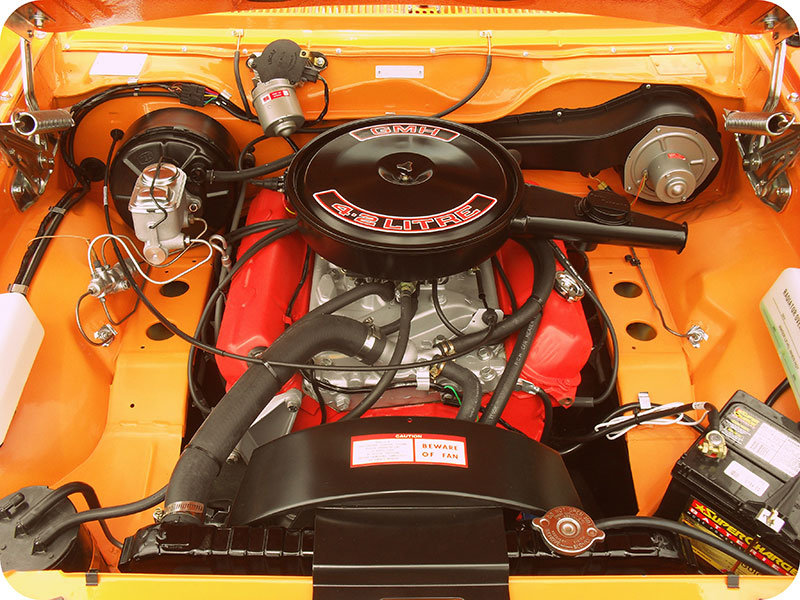

Aircleaner on & charcoal canister hooked who would care or notice as long as it looks the part.
*pic from notna thread
Edited by gtrboyy, 28 June 2017 - 02:54 PM.
