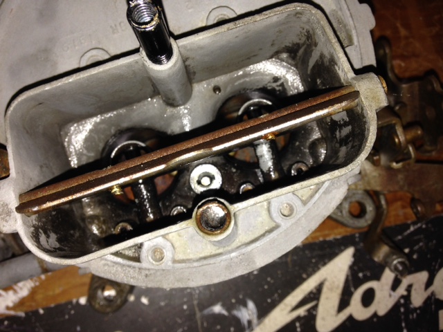

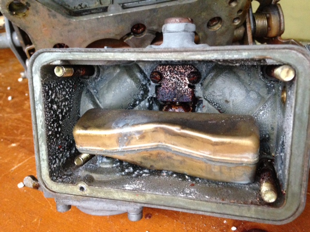

#666 _livo74_
_livo74_
Posted 23 June 2017 - 05:56 PM
have watched a number of vids.
found this one helpful to get a grasp, though will keep watching more.
Holley Carb Rebuilding Part 1, 2 and 3

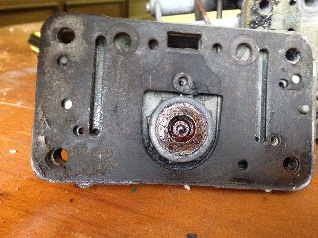

and the insides of mine.
time to be clean again!
will get a can of that carby cleaner and will borrow my mates air compressor.
going by the vids i've seen it's to not only blow out the holes but also to remove any water that might used, so not left to corrode.
i think?
Edited by livo74, 23 June 2017 - 05:58 PM.

#668 EunUCh
EunUCh
  • 2,774 posts
  • Location:not this planet
  • Car:japos
  • Joined: 23-November 06
Posted 23 June 2017 - 07:59 PM
Use the pump that they came out of the box with , i would guess 30cc which is not actually what they squirt in one full stroke of
the pump , heard a rumor that the cc of the pump is what they pump over 10 cycles (3cc/squirt at one full mash of the pedal ?) ....and make sure there is about 10 thou. extra on the pump lever at WOT so that the diaphram on the pump does not get well and truly.
Good thing to pull em to bits first , make sure you get the right metering block gasket for that list/model # because there is differences on some ? The power valve is probably rooted as well so you will need to get at least a couple to play with once the overhaul is done and is driveable.  ...and don't over tighten the PV ....they split and cause "flooding" problems?.
The number on the power valve is what it opens at usually in HG of vac. , eg, a 75 will open at 7.5 inches of HG and so on and so forth , the lower the number on PV the later it opens when pedal is pushed.
Generally they reckon a 65 PV and 62 mains should be good enough to get a 253 going on a 350 carb and then fine tune from there on in.

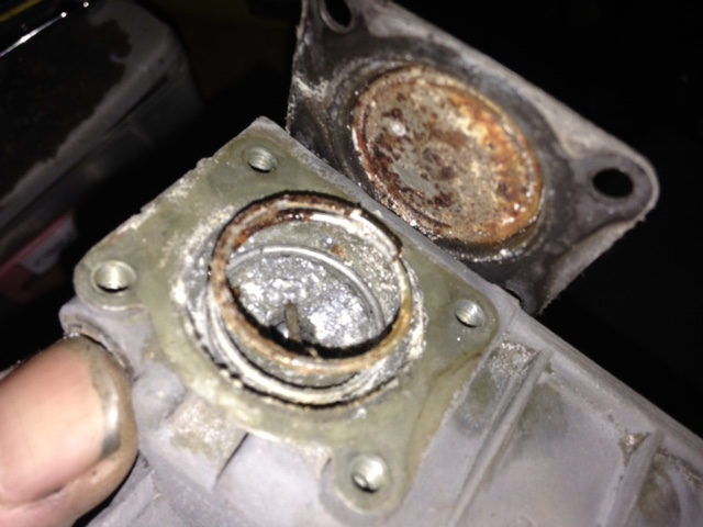

#670 gtrboyy
gtrboyy
  • 3,265 posts
  • Location:SYDNEY,NSW
Posted 24 June 2017 - 01:20 AM
Grr that looks more like moisture/water has got into it.

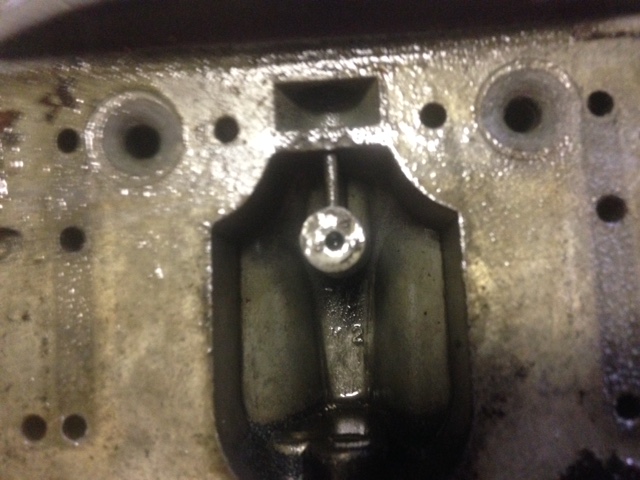

#671 _livo74_
_livo74_
Posted 24 June 2017 - 10:12 AM
wondering that myself gtr!
parts certainly looked "rusty" compared with andrews crisp brass parts.
also, i removed pump nozzle squirter to clean and check size, (it's a smallish 31)
and supposedly there is a "check valve needle" underneath, and when i turn carb upside down it should fall out.
here it is in pic
mine doesn't fall out. clogged/jammed i gather
or is there another reason maybe??

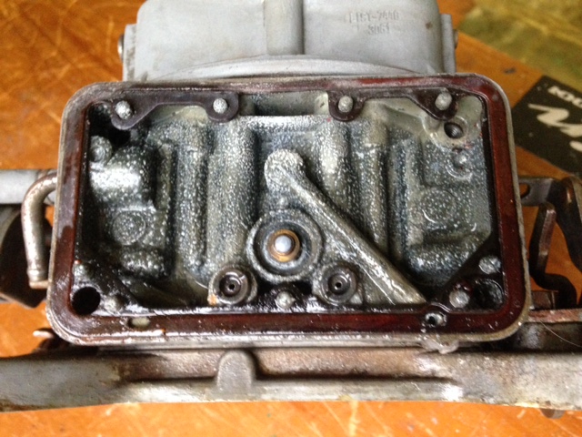

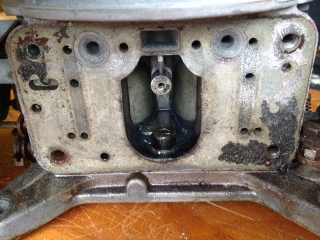

#674 _livo74_
_livo74_
Posted 24 June 2017 - 12:45 PM
IF .. this is indeed the hole that feeds my nozzle jets.. then might explain why no petrol ever reached the bowl of carby.
spraying carby clean into it doesn't come out of the nozzle mount hole. acts blocked.
and as said, my nozzle's discharge check needle won't move/fall out.
i even made a strong rare earth magnet "stick" to reach in and try to pull the needle free, whilst holding the carb upside down. didn't move.
time to try and free up with compressed air.
_______
also, my "power valve" wont undo, so far. ratchet won't grab and shearing "nut" head.
hmm. RUSTED in nicely??
will try a spanner if can get hands on.
Edited by livo74, 24 June 2017 - 12:51 PM.
#675 Bigfella237
Bigfella237
    Socially Distant
  • 4,396 posts
  • Name:Andrew
  • Joined: 31-October 14
Posted 24 June 2017 - 01:00 PM
If everything is that badly corroded it might be worth looking for another complete carby that's had a better life?
