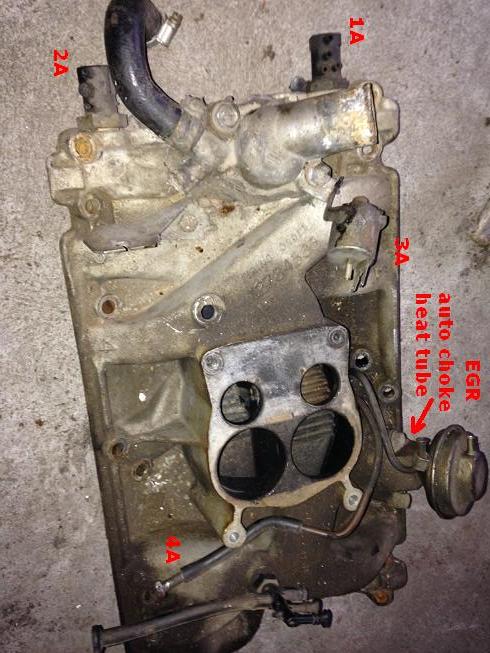

"good fuel economy, ok power."
that's the deciding factor, as every trip i'll be doing will be between 100-50 k's, to elsernwick and cockatoo to visit daughter and mum mostly.
got my head around most of this. any help with rest would be much appreciated.
will be going as less post-polution ..as possible.
_________
1. Fresh air feed to the auto choke heat tube (?)
2. Vacuum pull diaphragm
3. Pipe from manifold heat tube to ?? "Auto choke"
4. Egr valve (Hidden in pic ??)
5. Distributor vac advance
6. PCV valve
7. ?
8. ?
9. Cannister "carb" (i think ?)
10. Fuel line
11. ?
12. ?
13 Fuel pump
14. ? (air mixture screws at a guess)
Pic below
1a.
2a.
3a.
4a.
__________
point being, if not running an Egr .. can i just block off port on carb? (suspect.. not!?)
here are some parts can steal off spare (vb 253) manifold
and some example pics

#698 EunUCh
EunUCh
  • 2,774 posts
  • Location:not this planet
  • Car:japos
  • Joined: 23-November 06
Posted 26 June 2017 - 05:34 PM
#7 is just a full vac take off to run other stuff that was hooked up to pollution control stuff ?
#8 is what they call "fast idle" screw and is adjusted to get the idle ok when the choke is on , this screw touches on the 'steps" of the
odd looking camy thing that it lines up with.
It is only used to get cold idle right while choke is "on" , after the choke comes off it does nothing but take up space.
#10 is a bowl vent and goes to canister
# 12 is "normal idle" adjustment , used to set "curb idle" or just plain idle once engine is at operating temp.
# 11 which is #14 in the other picture is idle mixture adjustment , 2 of them because it is a 2 barrel and each one is set to get
best idle.
#13 is accelerator pump.
The fuel line from fuel pump goes into the bowel on the choke thermostat side and has a special brass fitting that is the seat for the needle as well as being able to screw a flare nut with a piece of flared steel tube into it from the out side , the original fuel line from pump to carb was all steel tube , these days most people just use rubber line and use a short piece of steel tube onto the carb as can be seen in the picture showing the lectric solenoid thing.
Your manifold looks like the EGR port is plated does it not ? , if not then plate it and do not use EGR , EGR was obviously a problem
which is why they probably blanked it off to bypass making more pollution.
They are not a bad little carb , bit harder to play with than a 350 but look "factory" and work ok on a stock 253.
Yeah , it's hard to make a choice  at times and satisfy the rest of the rules & regs , surely someone has a serviceable WW that could be tried out ?

7. so.. block off (?)
8. gotcha!
10. so.. is a bowl vent and goes to canister. (and not the fuel line, like i wrote)
on cannister is it "carb" or "purge" outlet
i have written #9 as cannister "carb".
right? wrong?.
might of been a different model ww i saw that #10 as being "fuel line". (they had a fuel line and filter attached)
i see now,
the fuel line is the nut to the side of the choke.
i need to screw a flare nut with a piece of flared steel tube, to run hose.
12. gotcha!
11 &14. idle mixture adjustment x 2, gothcha!
EGR, will keep blocked with plate. (and block with end cap #4 on carby, i gather.)
much appreciated! will update my main image soon.
am settled on this carby, finally! hahaha
looking to get the reco'd one i linked.
expensive, i know
..but hoping to avoid any unnecessary hassles, if poss.
---------and realised,
#4A goes to the #1. ("Fresh air feed to the auto choke heat tube")
