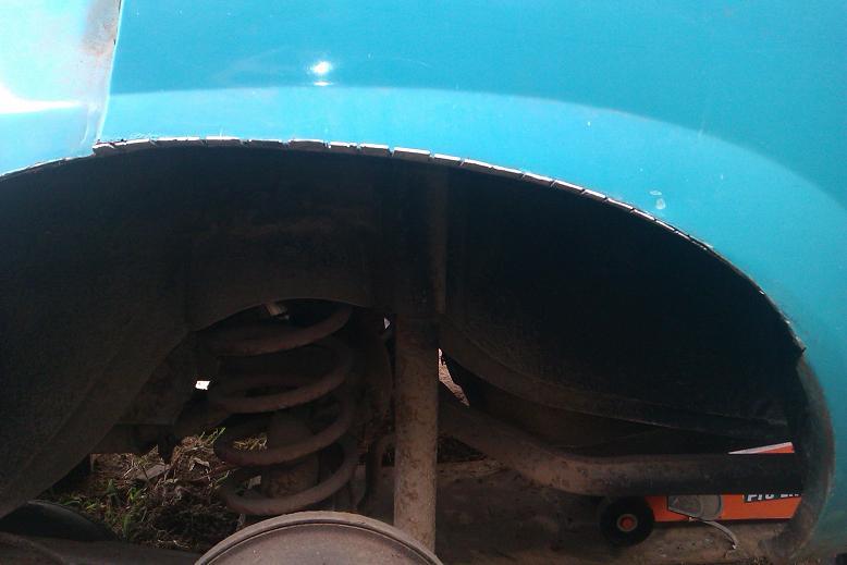

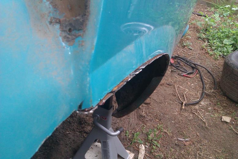

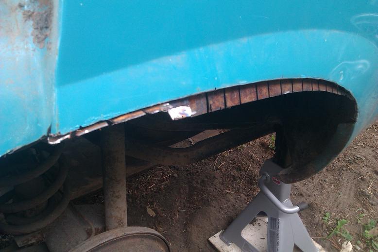

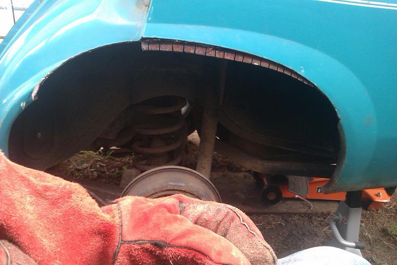

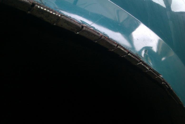

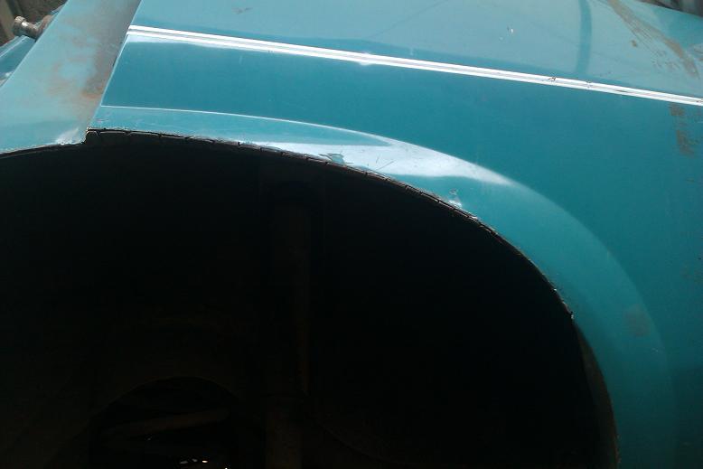

worked on second rear flare cut today
this time, didn't leave to chance..
cut off leaving more than what need to bend over, so can easily/precisely cut off flush later
our pesky dual layer again. (nipped into about 2 mm)
recessed into/off first layer of welded dual layer (that cant nip off) so can go "one layer" flush
sweet!
ran angle grinder along so is flush
yippee!! two rears done
_______________

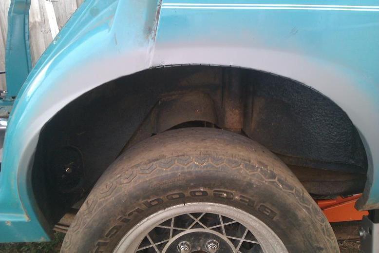

and other side (image flipped) for comparison
not bad.
did't have physical template to replicate, just estimated. am quite happy (read: lucky)  :)

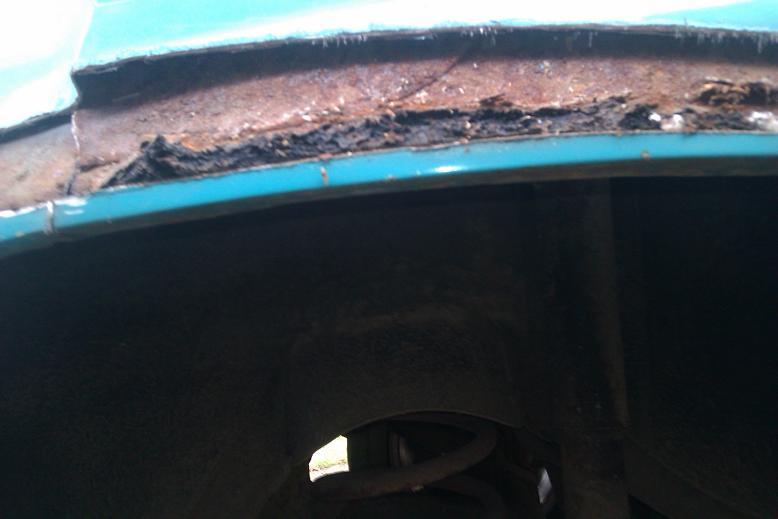

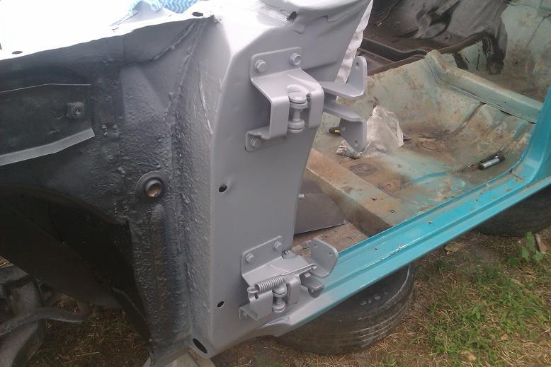

note for anyone with limited resources/means like me,
if you expose bare metal and are are outside getting moisture, prime/protect surface to protect from rust! can always EASILY sand off later if need to work/weld
or can end up like i did with more work to do.
took off door hinges exposing bare metal, and took no time at all to rust up and sucked to remove.

Just a question, should you have rust converted and cleaned/primed that second skin you folded over? Being rusty and now in a join, I could imagine it's not going to stay good for too long.

right you are liam, but (to be honest)  ..have, um,  kinda run out of money for rust converter (and few other things could use nowish) till next week
but couldn't resist doing guards. (found exciting, did!)
so.. have just covered over to protect for now

liam, forgot to add
as is easy to unfold/refold the thin metal, i didn't let the thought of having to do so from stopping me from folding over to see how it looked. just HAD to see how it looked ;)

Looks good Mat. When you can afford some money for rust converter it probably wont hurt to drizzle some in there. Might be able to tip it down from inside the boot. The Ranex brand from Bunnings works well.

#87 Bigfella237
Bigfella237
    Socially Distant
  • 4,396 posts
  • Name:Andrew
  • Joined: 31-October 14
Posted 04 February 2015 - 01:27 PM
was thinking of doing that previously to the whole cars innards, even drilling holes to pour everywhere!
That's a good idea if using a rust "preventative" like fish-oil (or a modern equivalent), but as you said, some rust "converters" have acid that needs to be neutralized.
There is such a thing as weld-through etch primer too, but I haven't bought any for decades so not sure if you can even still get it (or how many arms and legs they'd want for it)?
It can be used when welding two sections together (like the bonnet hinge reinforcement plates to inner guards) so you can prime each before assembly. You'll still burn a bit back off near the welds but it's better than having two bare metal panels stuck together (thanks Holden).

I just grabbed some 20x3 flat bar and bent it to the shape of the well and welded to the internal skin cut the protruding piece and welded it up, smooth as and a bit more compassionate to tyres if they make contact.

heya liam, is exactly what i plan to do with the fronts!
might of been your pics? i saved/reviewed that showed me how.
invaluable.
not tyre cutting death traps ;)
waiting to see how gentle/rounded the rears are after welding and grinding.
might end up runnig a bar as well

WILL be doing flat bar (with rounded edges) to rears as well.
too good/safe to pass up. big cheers for mentioning, liam
