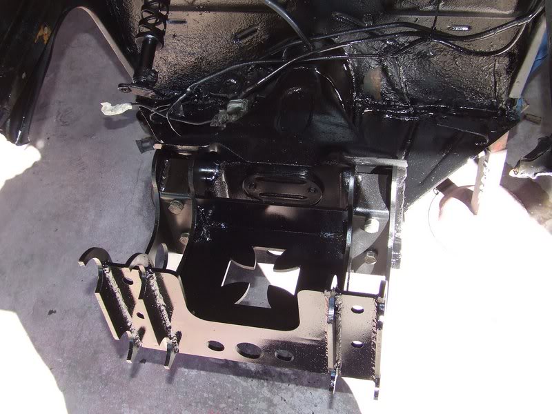

Well today saw a few more little things get either started or ticked off the list.

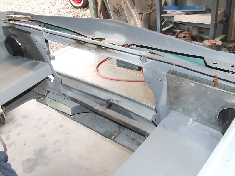

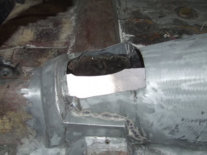

The gearbox came out so the underside of the tunnel could get a good clean.
The crossmember that I had to cut through to fit the gearbox also got finished today. Where it was cut was welded to the new section from underneath, so it's all tied together now.
You can see through the shifter hole where the old crossmember has been welded to the new metal. It's not pretty, but I can bet you it's damn strong. Once it's had a bit of a grind It'll look better.
If you look on the outside of the tunnel where the new support is nearest the front you can see where the weld has penetrated from underneath where the old crossmember meets the new one.

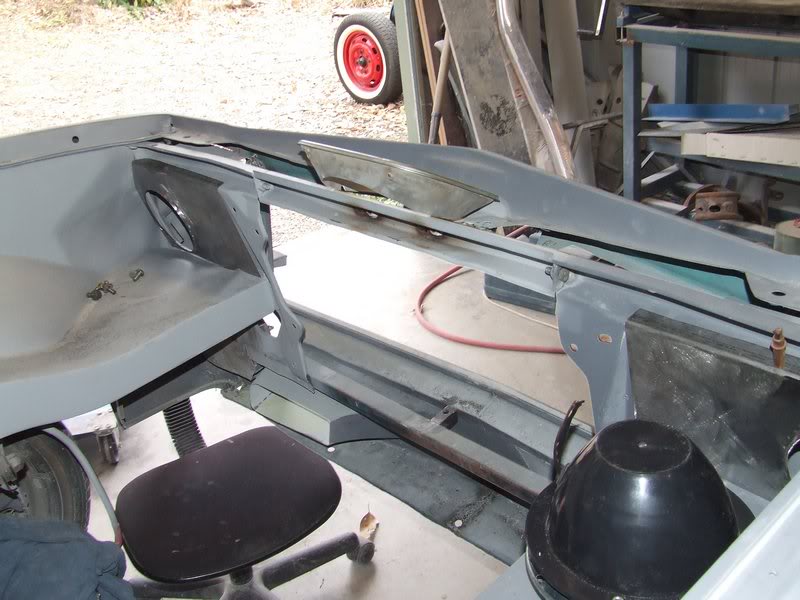

Next job on the agenda was to fit the bonnet catch properly. The lower mount on a UC is totally different to an LX so a new one was made from some small thick walled angle iron.
The top radiator support bar has been made removable. When I did that, I actually flipped it over 180 degrees as the top of it was really bent and ugly. The bottom of it was perfect, hence the flip over. The only problem is that the holes now didn't line up with the bonnet catch. New captive nuts were fitted and the old holes welded up. Simple.
This is the first time it's had the LX bonnet catch fully bolted in. Yay.
The chrome bonnet latch was also fitted and adjusted.
Finally the bonnet is latched down without a bungy strap :spoton:

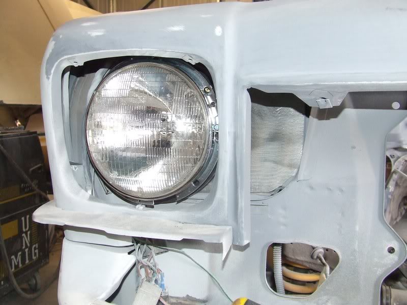

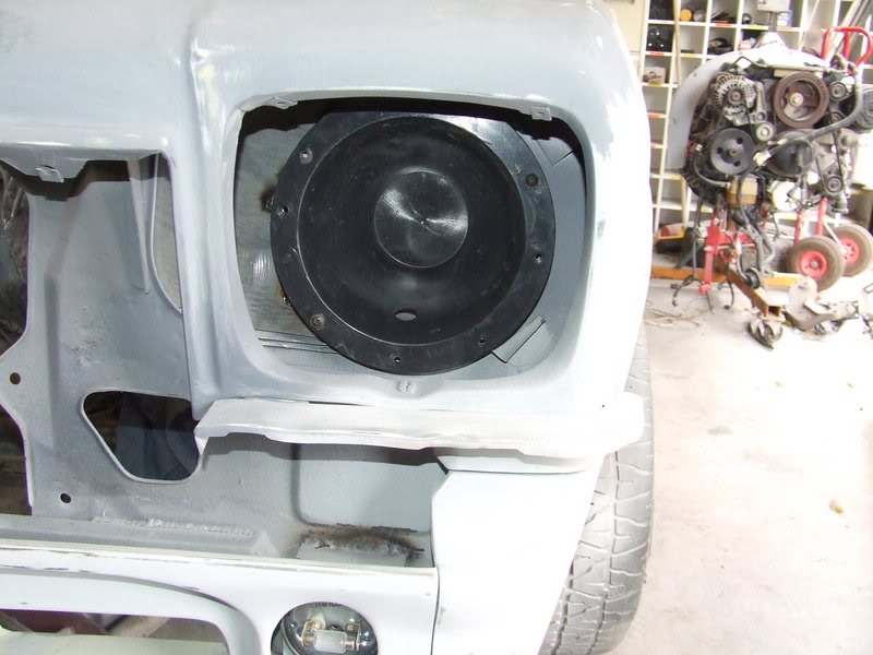

Next thing to do was to start mounting the headlights. I made a cardboard template and transferred it to a piece of 2mm steel.
I took a guess at the size of the hole I had to cut by tracing a 5 inch cutting disc.
The headlight sat about 10mm too far out, so my guess wasn't too bad.
To fix the problem I just flared the edges of the hole so the headlight bucket could sit in a bit further. It looks neater too in my opinion.
I screwed the light in temporarily with some long wood screws, so I could get the light to stay still while I measured how long to make the mounting brackets.
And no, the wiring wont be staying there, it will go through the front of the headlight bucket, behind the nose cone.
Just a look at the new piece from the front.
With the light secured by the screws I was able to take some measurements for the mounting tabs. I didn't get a chance to make them today, but that's what tomorrows are for.

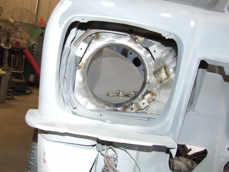

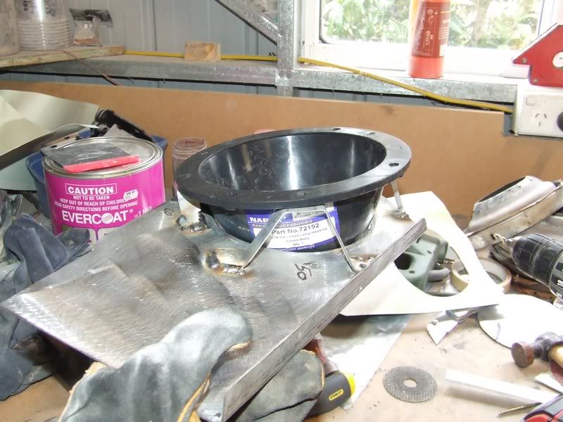

Hello again. Well today saw the headlight mounting tabs get made for both lights.
I was thinking about welding the backing plate in, but thought being able to remove it might be easier for any future headlight issues. I'll just bolt the backing plates in with some more stainless allen bolts, same as the flares and bonnet scoop have.
The mounting tabs were tricky, as the bucket doesn't sit level with the backing plate.
They're not pretty, but they're strong.
Here's the plate fitted so you can see the 3 mounting tabs that secure the headlight bucket. Getting this in the perfect position was a little tricky, but I somehow managed to fluke it in the end.
I got the other headlight backing plate finished today as well.
Here's the other headlight bucket fitted onto its new mounting tabs. I'm really happy with the position of the lights in the opening. With the surrounds in place they look really good.
Here's both plates clamped in place with the headlights screwed in. I think the look is nice and clean from the inside. Once it's all painted I think it will be a nice touch having no wiring.

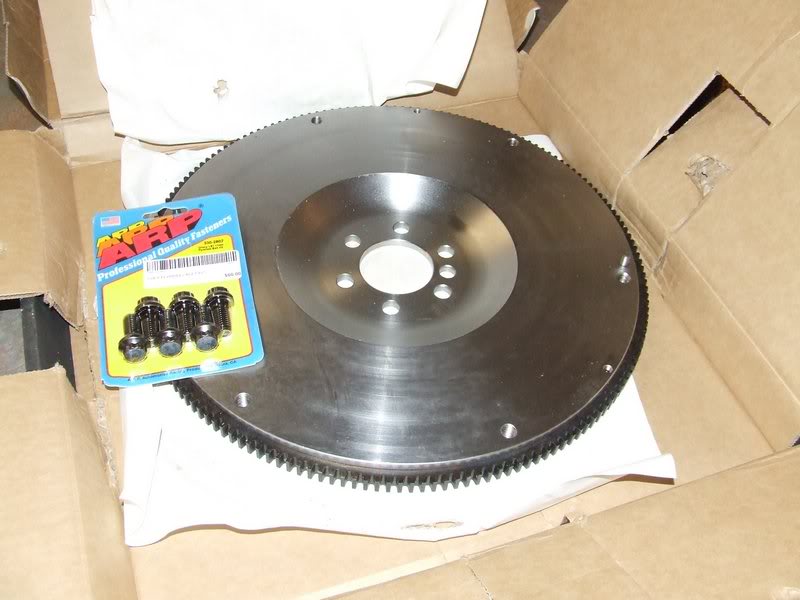

The flywheel and ARP bolts arrived too. That flywheel is seriously light. I just need to get the sump back from the welder to fit it all back together and start making extractors.

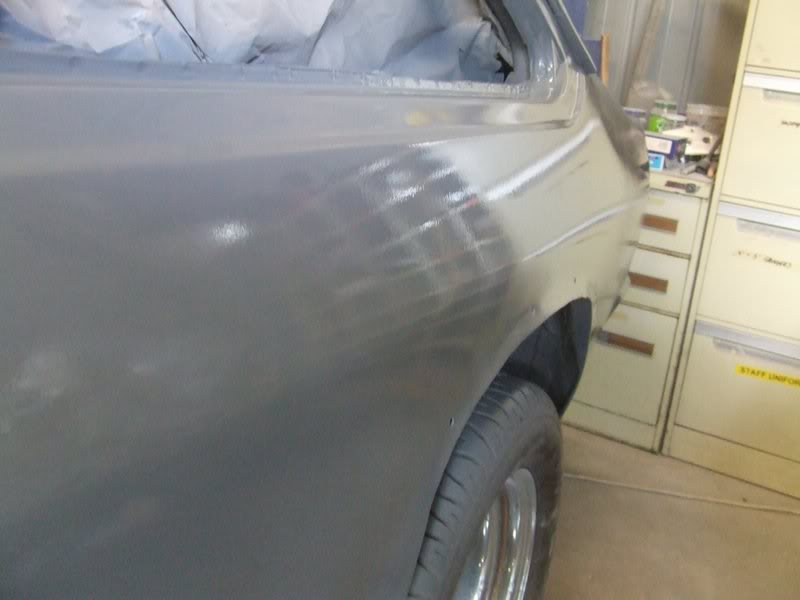

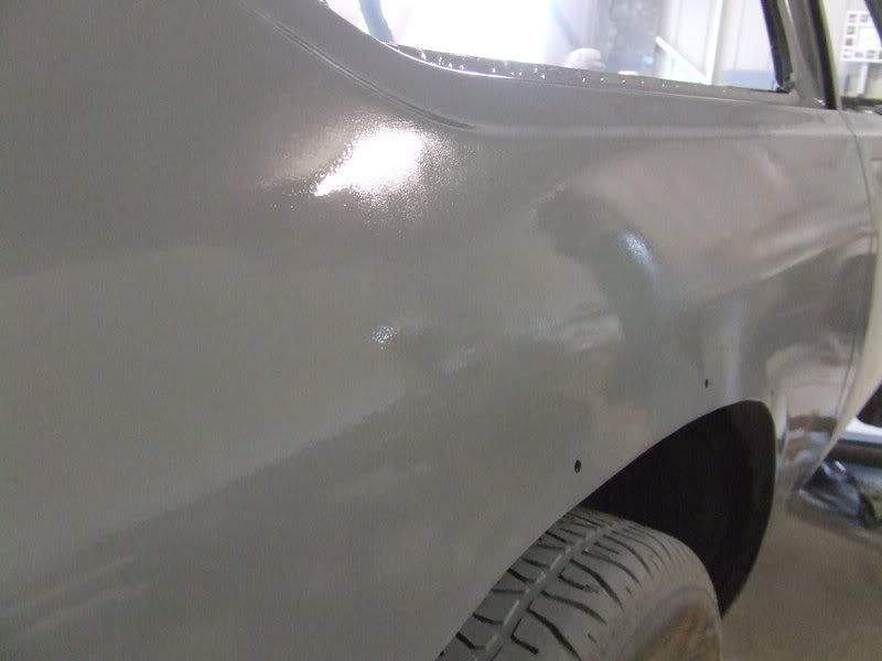

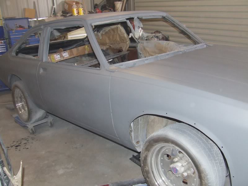

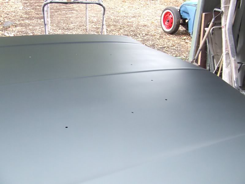

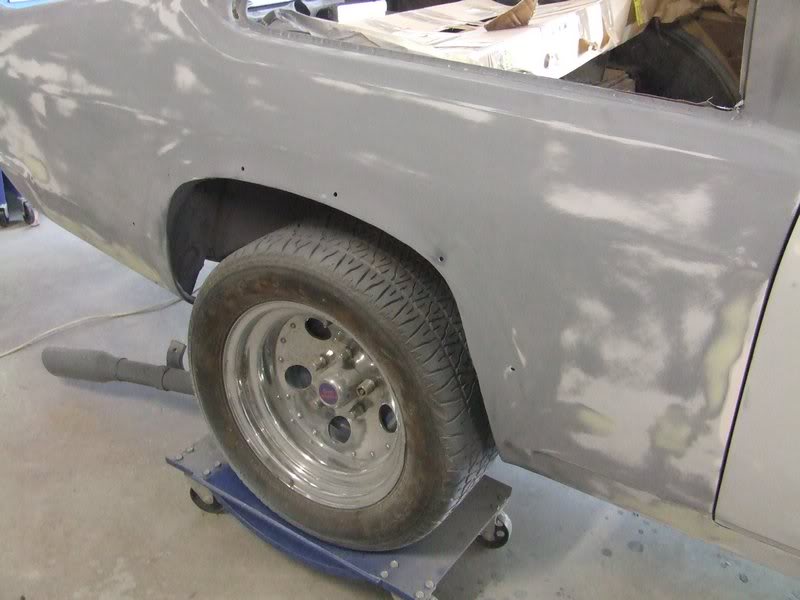

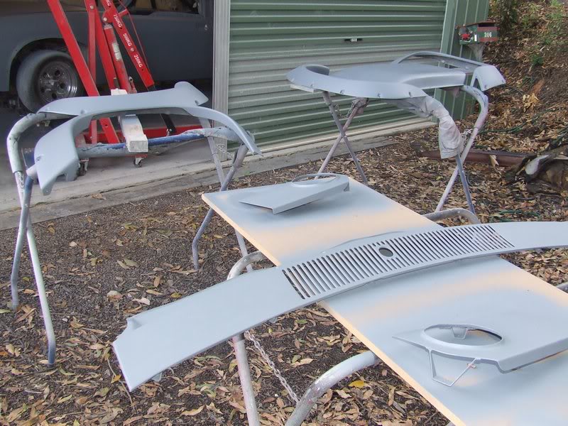

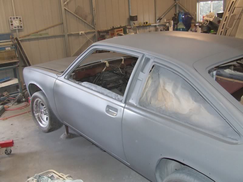

Well here's a bit more of an update. Not a lot has changed but I did manage to get a bucket load of dry sanding done and fix up some minor imperfections.
Nothing more fun than hours of sanding : )
It's nice in Qld summer when you're all sweaty and then there's this primer dust all over you. Lovely!
Just filling some minor problems. I couldn't even feel these low spots, I only found them by sanding with a long block.
You can sort of see where the little bits of filler are. They're pretty much see through it's that thin, but had to be done. I should have found all the imperfections by now, but that's kind of what this whole process is about. Getting it as good as possible. Plus I find it a lot easier to see what's going on with this darker primer.
All the flares got a rub down as well with 120grit paper ready for more primer. Then the rain came, so I just kept sanding other bits instead.
The good thing about the rain is my little volksrod gets a wash.

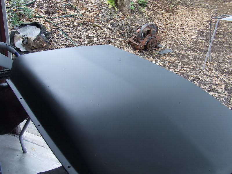

The hatch is the last panel to get sorted out properly. It's pretty good now, but still has some little wobbles. I just smeared the problem areas and will block it out next week. It's probably only about 1mm thick at the moment, but should make all the difference. The sun is coming out again so want to get some primer on other panels.
The primer went on fairly well. While it's wet and somewhat glossy I can see if the panel has any faults. I have to say it's all looking really good. So it should, it's taken long enough.
All the flares, bonnet scoop, cowl panel and headlight mounts all got a few coats as well.
The bonnet that was such a pain is finally spot on.
The scoop is looking a lot better too.

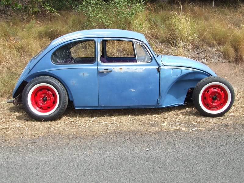

I noticed you reversed the trailing arms (so made them leading arms) on the Volksrod, any reason you went with this method over the more common front end relocation?
Oh you build has been very enjoyble to follow, although I wish you stuck to more UC bits though.
#247 _dirtbag_
_dirtbag_
Posted 02 February 2010 - 12:22 PM

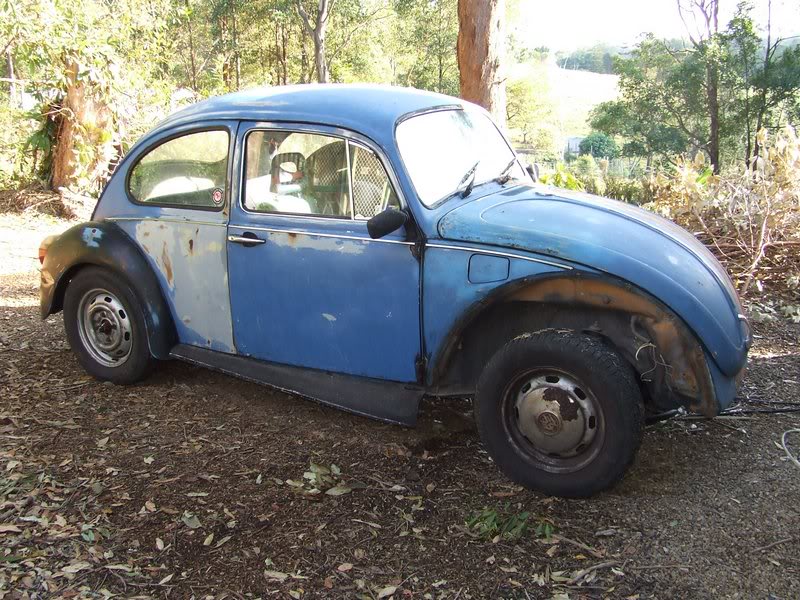

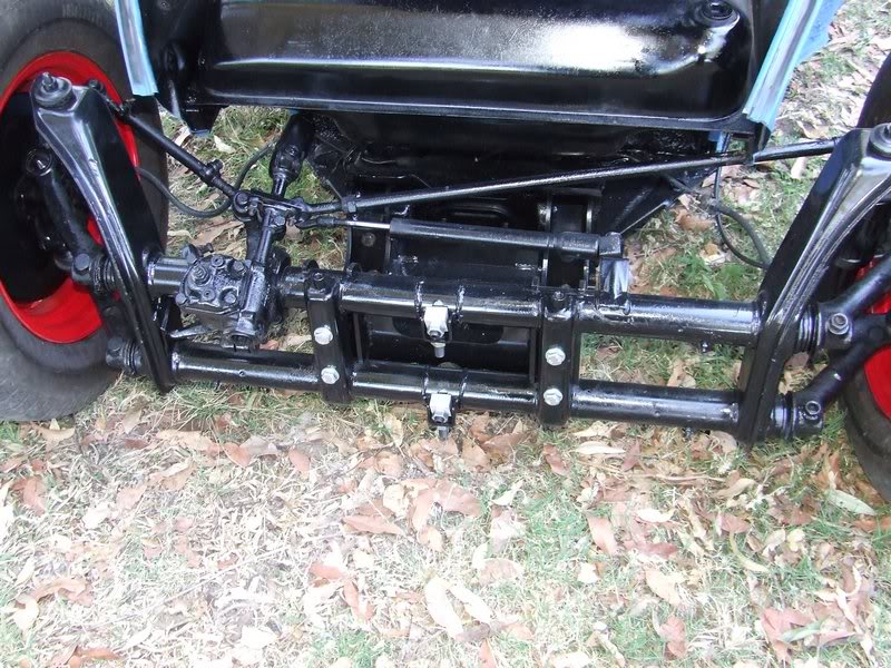

Hi Peter UC. There are still heaps of UC bits left. The roof, doors, rear quarters, most of the floor, most of the front guards. OK, that's enough, I know what you mean : ) My brother couldn't find an LX at a reasonable price so this is the result. I know UC people will frown at it, but at least it's not an XD falcon : )
As for the front trailling arms on the dakdak, they're not reversed. I've lengthened the wheelbase 10 inches by moving the front beam forward.
Here's the front end when it was stock.
Here's the beam extender fitted and steering lengthened etc.
And here it is now.
Here's a pic of the extender without the beam on, so you can see what it is.
This beam extender lengthens the wheel base by 10 inches and lowers the car 2 1/2 inches. I then welded adjusters into the front beam so the car is now about 5 inches lower than stock.
Hope that helps.

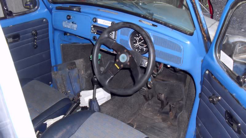

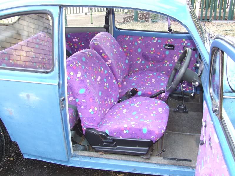

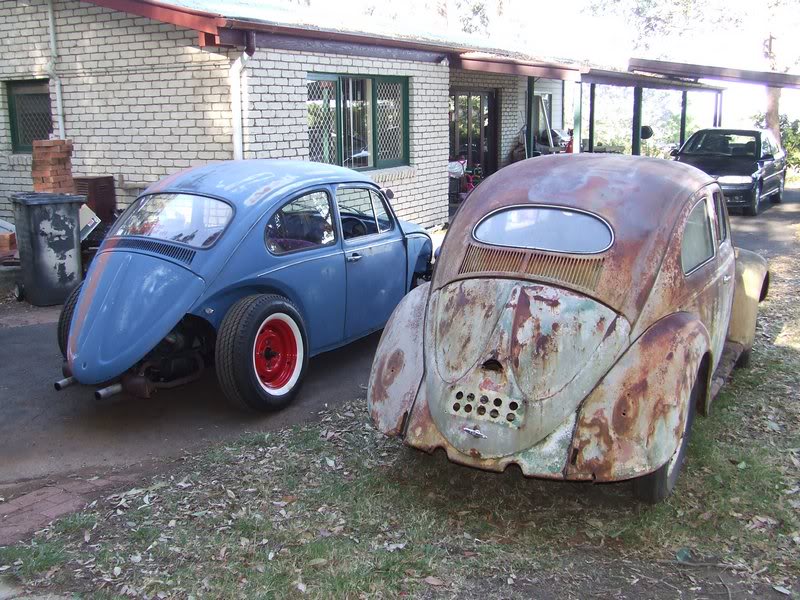

Hehe Ken. Mine isn't a volkswagen, it's a dakdak : ) You lowered the front another 2 inches? With those tyres? You must like the sweet smell of burning rubber, on your guard lips. mmmm....rubber....
Another thing I find really funny about this car is the interior I did for it. Here it is when I bought it.
And here it is now
Haha. It makes me laugh whenever I look at it. Obviously this car is very serious........NOT!!!!!! It has an EMPI quick shift though, because it really needs that :badabing:
Here's another little project I have for a rainy day. It's a 1957 oval window.
Well that's enough about dakdaks!
