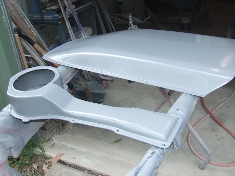

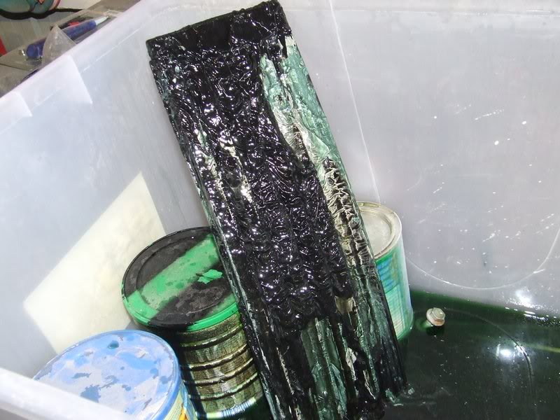

Well after a day in the gunk, the side vents are coming along nicely. It can take up to a week depending on how stubborn the paint is.
I gave them a quick hose down to see how it looked.

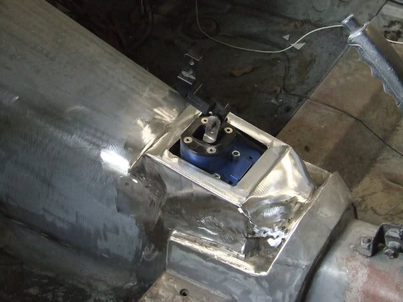

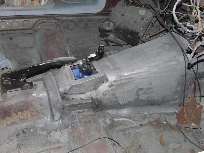

Here's the shifter surround getting made. I was going to make this a bolt in piece, but there's really no need. The shifter can fit out through the hole, so that's the main thing.

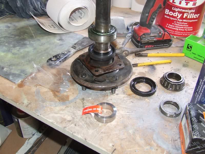

I was quoted $90 to get the new bearings fitted, which is ridiculous as I was supplying the bearings. So I took one off myself as it's not hat hard. I was going to do the usual piece of tube to knock the bearing into place then heat the collet red hot and slide it into place to cool. I did a quick trial fit with the seal and bearing to make sure it was right, then as I was about to pull them back off and grease the seal I noticed the collet had a red sticker on it saying "do not heat to install". Bugger. I guess I'll have to find a press after all.

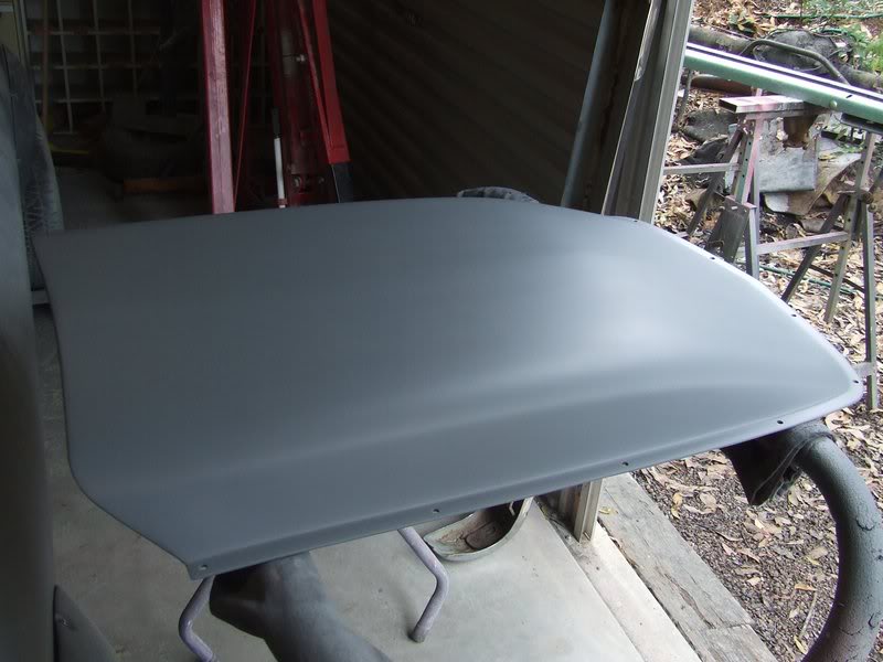

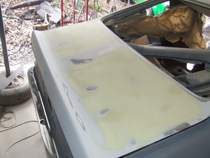

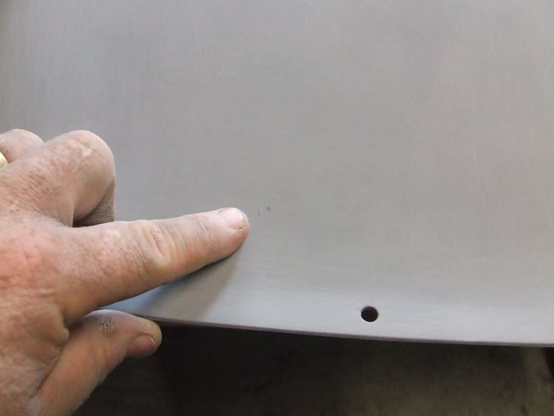

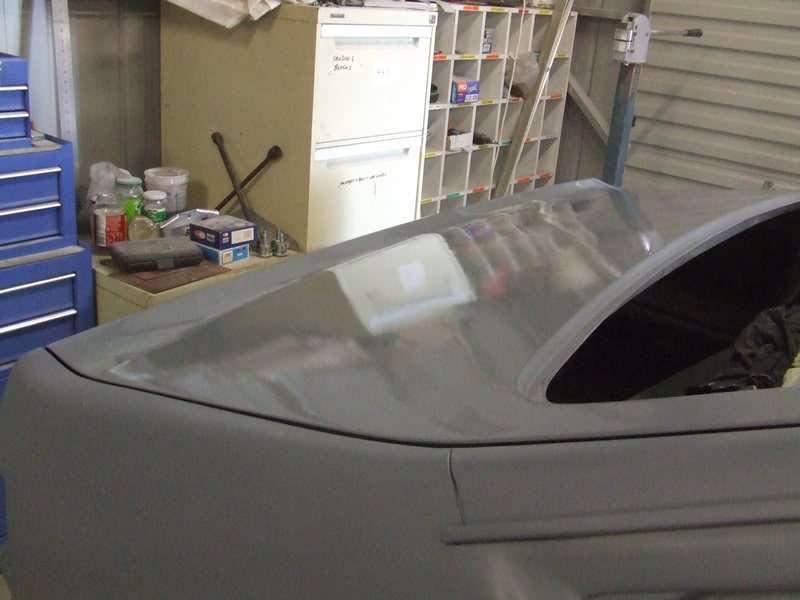

The hatch is finally ready for a decent coat of primer.

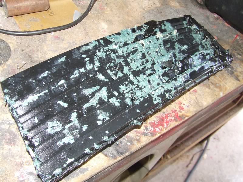

Looks like a ton of bog, but again, it isn't very thick. Unlike me : )

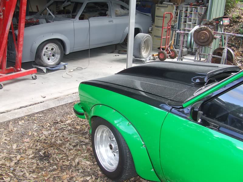

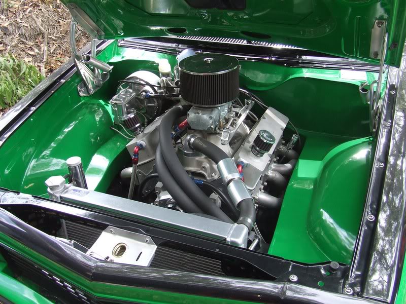

I figured I'd better give you all a better look at the green hatch.
Pretty.
It's a 383 small block, brodix heads, big roller cam blah blah just under 600hp at the flywheel, built by widowmaker engines. Backed by a muncie 4 speed and spooled 4.11 9 inch. 10 inch front and 12 inch rear wheels with 245 and 295 tyres. Lovely : )
Anyway, back to this much better, more interesting car.
Here's the shifter surround welded in.
And after a bit of rust converter.

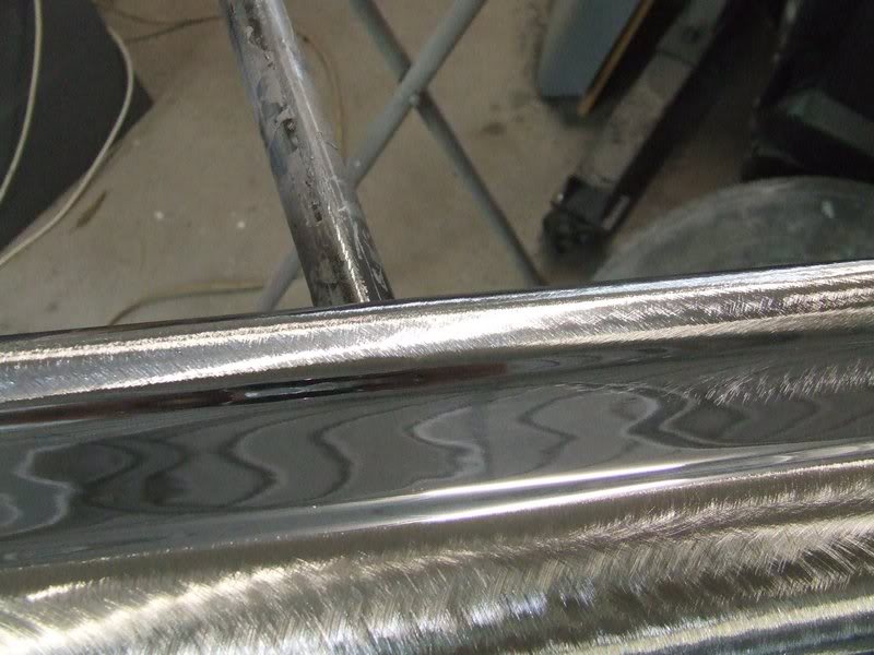

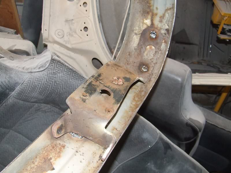

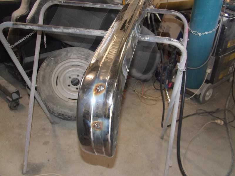

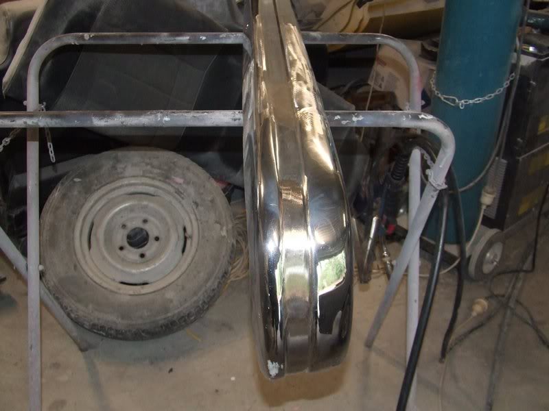

I finally got to work on the rear bumper. To be honest I was putting this off, as it's a painful job.
There were a few little dings that needed to be tapped out before I welded all the holes up.

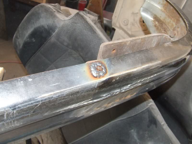

I used a pin hammer and a lump hammer to knock these little dents out. Put the pin hammer against the inside of the dent and hit the pin hammer with the lump hammer. Lots of smaller taps rather than one big one. I then sanded the area and it's all good.
This is where one of the jacking point slots used to be.

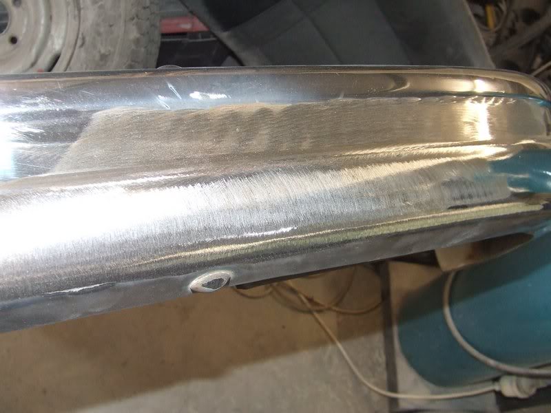

I find when doing this to make sure you over weld the area. All the holes are punched out, not drilled, so they curl in a bit around the edges. Make sure you weld over this section so it can be ground and sanded smooth.
Even on the smaller holes, weld a larger area.
Then it can be sanded down and end up like this.

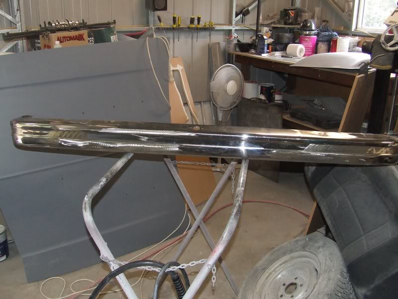

Here's the rear bumper smoothed out.
I welded the mounts to the bumper one bolt at a time. This means the mounts will be in the right place. I welded the hole up fom the outside, then flipped the bar and plug welded it to the mount.

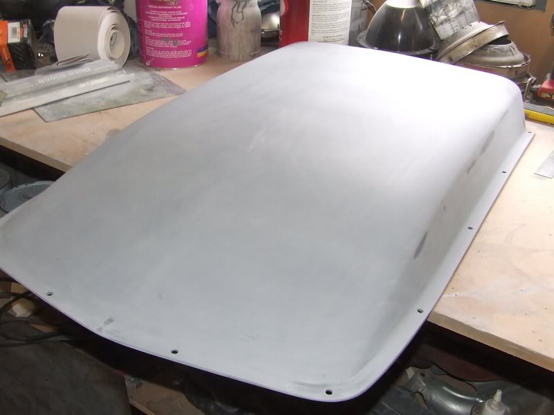

The bonnet scoop got a dry sand today. There was only a couple of tiny pinholes that needed fixing before the next lot of primer could go on.
This is the bigger hole I had to fill. Massive, isn't it? I usually try to sand all of this stuff out, rather than filling it, but the surrounding area was already nearly back to the gel coat, so it had to be filled to keep the area level.
The modified heater box and scoop then got some primer.
Once the primer had dried a bit, I could see the scoop had turned out pretty nicely. Good stuff.
The hatch also finally got a good coat or three of primer. It looks really good even if I do say so myself : )

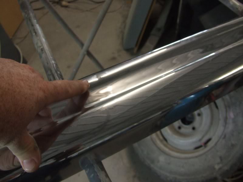

cruiza - hahahahaha. That's awesome. Good one :badabing:Can you also do the Blue steel?
Hi Paul. Bars will be getting rechromed. Lots of work but worth the effort for all that shiny stuff : )

Hey michael. Each to their own. I think painting them is a bit of a cop out. Too easy. I like doing things the hard way : )
As for them looking retro, that's the whole point of building a 70s car.
Having said that, I've seen lots of torries with painted bars and think they look fine. We just prefer chrome.
