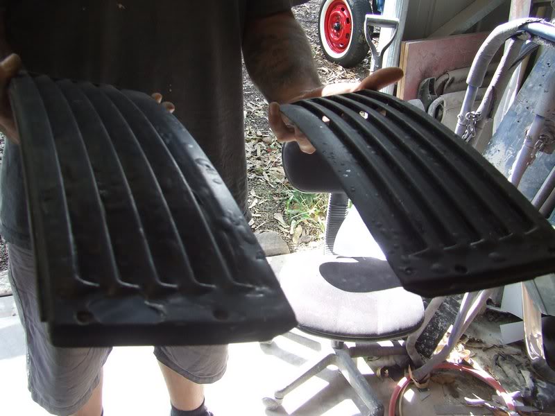

I found this hideous creature in my shed the other day. Actually, it's out there all the time. Any idea how I can kill it?

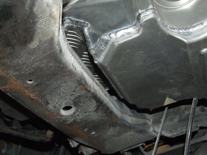

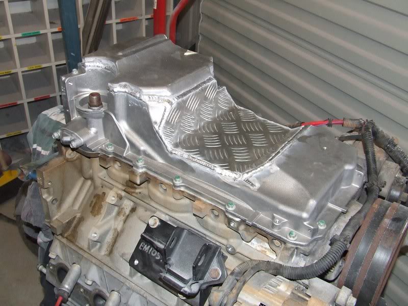

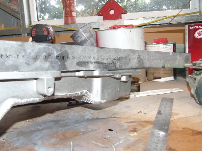

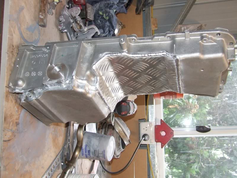

I finally got the sump back from the welder. It looks a little odd, but so do I, so who am I to judge : )
I actually really like the checker plate.

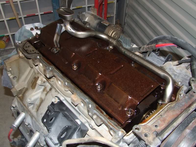

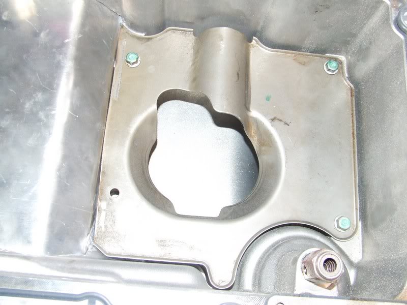

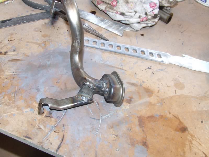

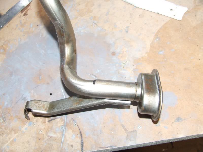

I took a heap of measurements then set about modifying the oil pick up to suit the new shallower pan.

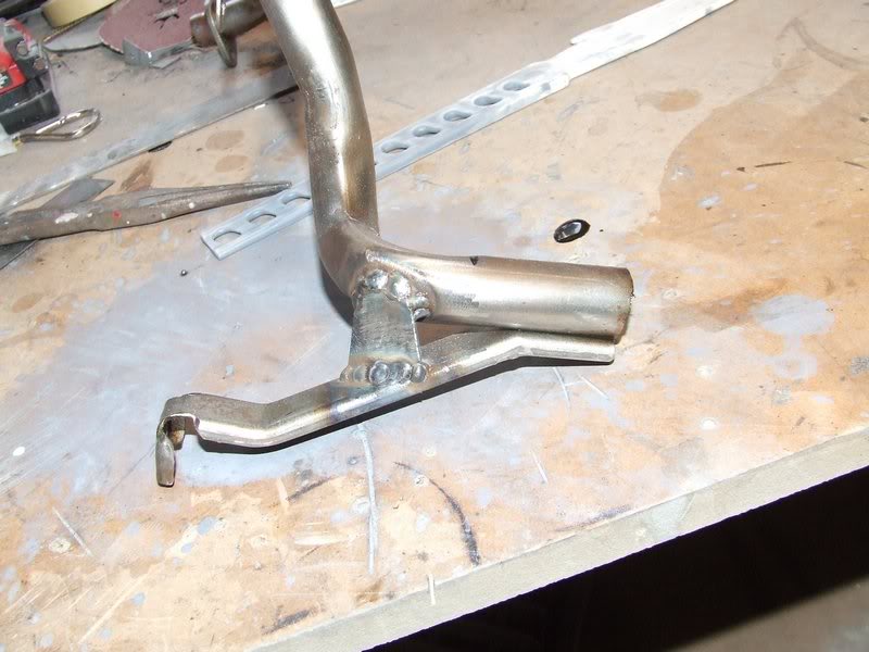

I have to cut 50mm out of this, which will remove the part of the tube where the mounting tab is attached.
I just welded a new support on the mounting tab before cutting the pipe, so the tab stays in the right place.
With a bit of trimming a even got the baffle back into the pan. One of the bolt holes was lost in the modifying process, but it's such a sturdy plate 3 bolts will be fine.
Here's the oil pickup with the 50mm taken out.
It even fits!

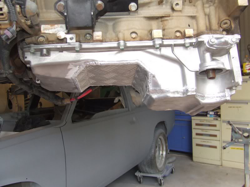

When it came time to fit the sump I had a good look at it and noticed it had warped in the welding process. Not great.
I thought I'd just throw the sump on anyway just to make sure the modifications I'd made were going to fit how I'd hoped. I put all the bolts in finger tight and started at one end and worked my way across, and it pulled down with no effort at all. I'll probably still get it faced, just to make sure.

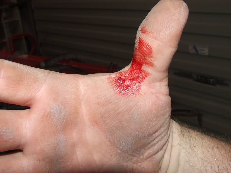

I even managed to cut open the webbing in my thumb, so that was a good time : )
Here's just another look at the modified sump.

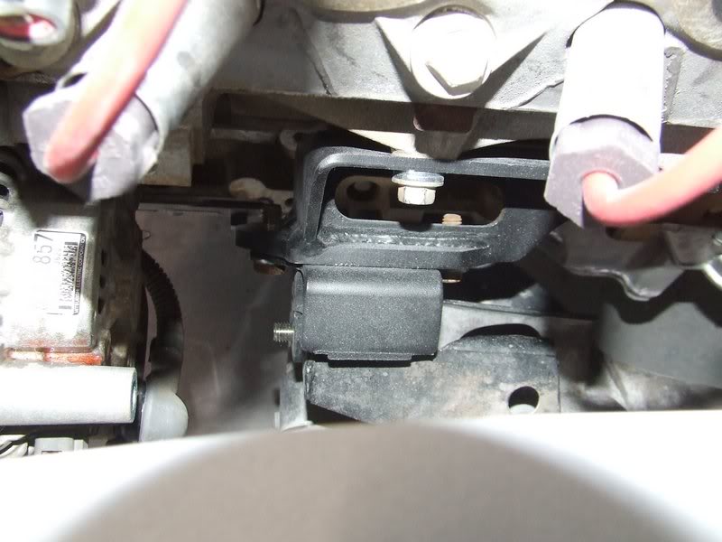

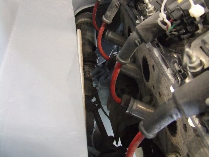

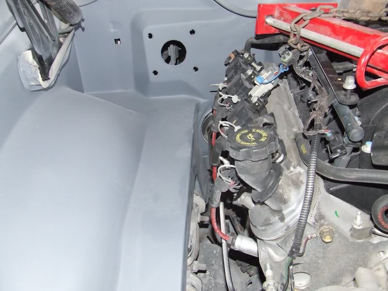

With the motor lowered back into the car I knew it was an improvement as I was able to get bolts through the engine mounts, as opposed to last time when the sump just sat on the crossmember.
I'm really happy with the clearance the sump now has around the rack and crossmember.
I'm not so excited by the amount of room on the drivers side with the steering column put back in :dontknow:
I'd like to run a VT booster and cylinder so will have to see how I go for room there too.

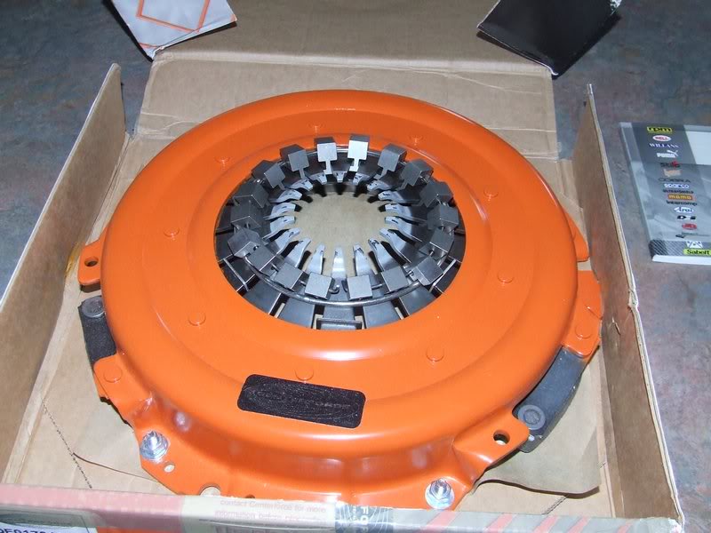

I picked up the new centreforce clutch today too.
Standard Torana ---> only a fishes asshole is tighter, and that's watertight.
#255 ls2lxhatch
Posted 02 February 2010 - 09:19 PM
The booster clearance can be improved by moving the last coil pack up higher on the rocker cover or relocating them altogether.
If you think the steering clearance is tight now, wait until you start work on the headers. You can improve the clearance a bit by trimming the steering column tube back to the firewall.

Those centreforce clutches have a reputation for being very bad at disengaging properly at high RPM!

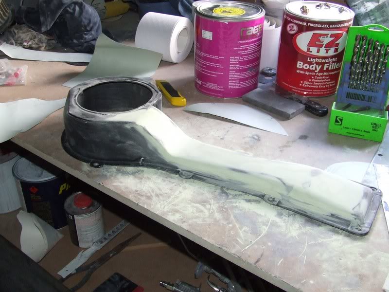

I finally got around to putting a bit of filler on the modified heater box. I'm not too good at icing cakes, so it doesn't look too pretty before it's sanded : )

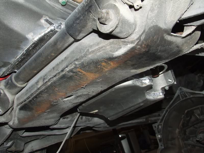

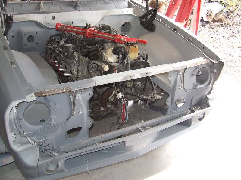

Then after about 2 hours of trying to get the 6 speed in from underneath and nearly having a prolapse, I said enough is enough. Everyone said I wouldn't be able to mount the motor and box through the engine bay, so I decided that's what I'd do. So I pulled the motor out again and bolted the box on.
6 bolts later and the nose cone and top rail or the radiator support were gone. I'm sure glad I went to the trouble of making that top rail removable.
The motor and box go in at such a nice angle with the top rail out of the way. I don't know why I haven't seen this done before when it's so easy to do. Having said that, I'm sure there are lots with it done, I just haven't seen them.
Well after a bit of fiddling around and jiggling things a bit the motor and box are in relatively easily. Just as well as I was on my own.
It didn't look like there would be much room between the tailshaft and the floor, so I machined up these 25mm spacers to lower the gearbox a bit. They might not be needed, but I'll find out when I run a string line to the diff to check for room. The back of the car will be a bit lower than it is now, that's why I'm a bit concerned.

I did a trial fit of the modded heater box. Works a treat.

I've known a few people to run centreforce clutches and had no problems, but time will tell I guess?

I just hope you weren't actually under the car taking those photos when it is just supported by the trolley jack ??
Looking better every day - getting more and more jealous - can't wait to get my hatch home and start working on it.....

Thanks Ken. I'm a bit anal about axle stands myself, so trust me when I say the only thing under the car was my arm and camera. The shots of the sump I had stands under the lower arms, then once I'd taken the pics I dropped the car again. I then thought I should get pics of the box, so raised it up again. I was a bit pooped and lazy, so didn't use the stands. I'm a naughty boy :cry:
LOL!! hatch's seem to like biting that area!

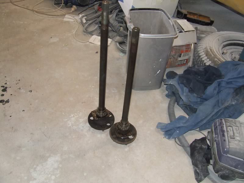

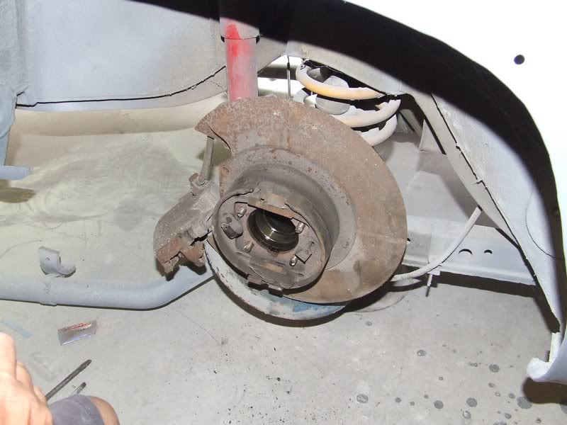

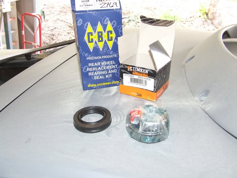

Well there's been a little bit more work done. Stripped one of the axles out to make sure the 9 inch had holden axle tubes, which it does, yay, so commodore discs are going on the rear, nice and easy. Bought the new disc brake wheel bearings and seals to suit.
These are just a tad better than the old corse spline banjo axles : ) Even though they're only 28 spline, they'll do the job.

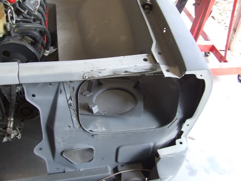

Cut all the old UC headlight gunk off and cleaned the area up a bit.
Then bolted the new headlight mounts in with some stainless allen head bolts.
Also removed all the bits of UC light mounts that were spot welded on. It looks a lot cleaner with all that stuff gone.

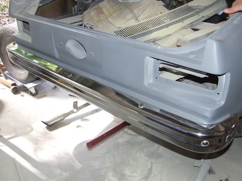

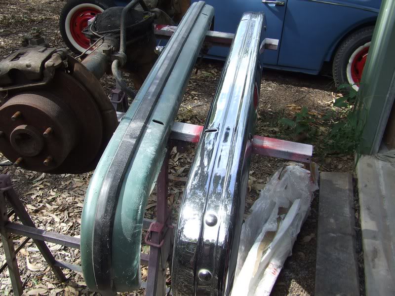

Finally unwrapped the rear bumper today. It arrived a looong time ago, so this is the first time I've seen it. It's not bad except for a couple of minor dings and one end has been pushed around a bit. It'll get the smooth treatment too, like the front bumper.
I don't know why, but I assumed the new bar wouldn't have mounts on it, so I dug the old UC bar out to steal it's mounts, but the new bar has mounts and bolts attached. Bargain : )

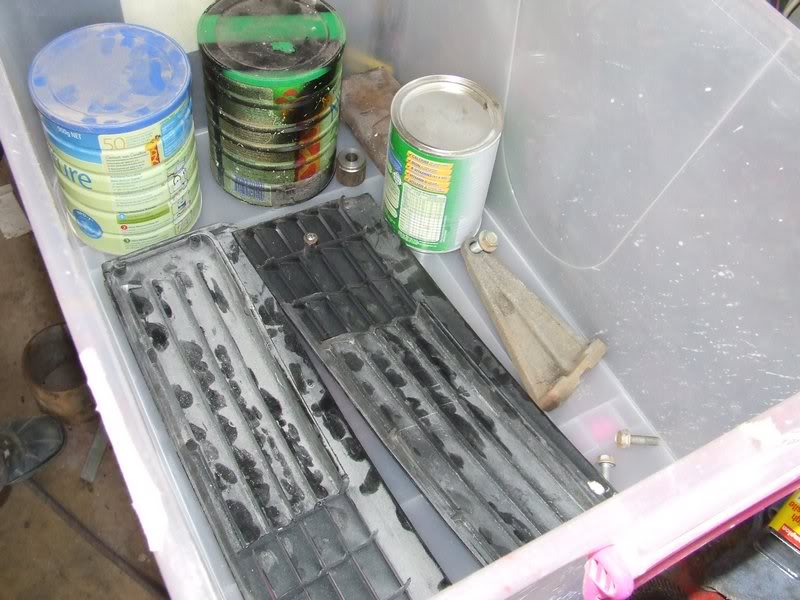

The B pillar vents are so crusty on this thing. There's so much paint on there that it's bubbled up and looks like it has chemical burns or something.
It sure is going to be fun stripping these back, as they're only plastic.
There's only one good way I know of to strip plastic, so we emptied an old plastic tub that the vents would fit in, then added some random bits to take up some space so I didn't need as much liquid to cover the vents.
The poured 4 litres of sweet smelling wonder juice over them : )
For those that might not know what I'm talking about, here it is -

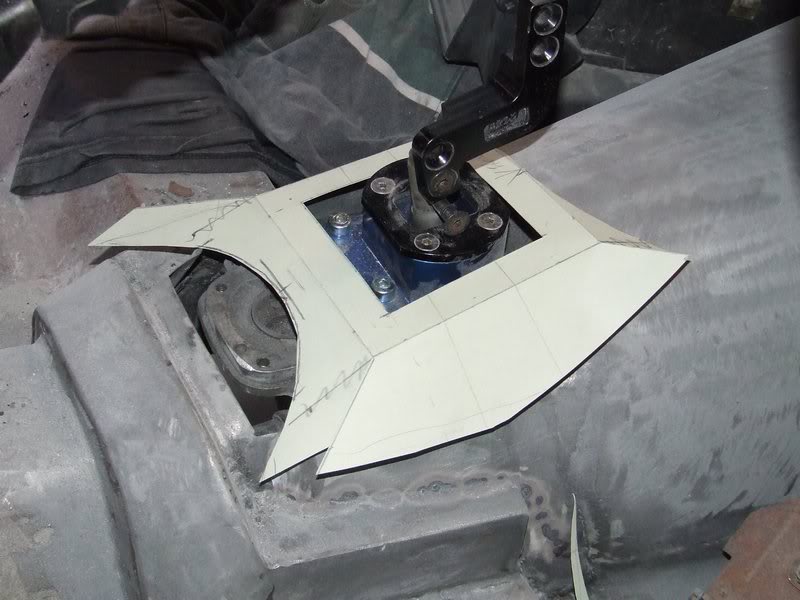

Also started work on the shifter surround that will house the rubber to keep the gunk outside. For things like this I just love thin cardboard. It's the best for making templates.
