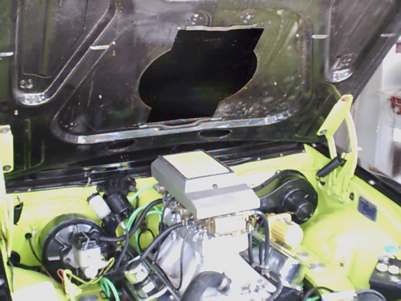

Here's the car from my avatar. It has a tunnel ram with twin 600s so I had to make the scoop 2 inches higher. It's not that obvious, but needed to be done. There's a bit of a write up about it in the members projects section called "My old toranas".
Here's the airbox I made to fit it all under the scoop.

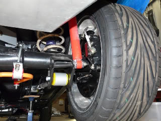

#318 _dirtbag_
_dirtbag_
Posted 10 February 2010 - 05:43 AM
Thanks again Andy. I can't really see the need for a return line if it doesn't have one already. It's only a stock motor, so whatever is there now should be fine.
Does it need a fuel reg at the tank?
My friend (green hatch guy) came over again and got into the floor with a few chisels and a wire wheels to remove all the tar sheeting from the floor, as I was a bit worried what might be hiding under there.
It wasn't too bad though. Just a hole in the base of the passengers side A pillar and some holes drilled in front of the drivers seat. I'm thinking for a fire extinguisher maybe? None of this stuff was visible until the tar was removed.
You can see how nice the floor came up after some wire wheeling.
There was a little bit of rust inside the pillar too. This was treated and plated before the new outer piece was fitted.
The drivers floor had all the holes welded too.
The VP commodore that donated its rear brakes also donated it's foot rest. I had to modify it a little, but it fitted easily.
Next it was time to put the diff back together with the VP disc brakes.
At this stage I thought I'd rip the tail pipes out as I was going to try new rear coils. Look how horrible and tight the welded bend is over the diff. Good flow there : )
All the old rear brakes are completely removed, including the brake lines and flexi line, as it will all be getting changed to metric.
The spring on the right is the coil I pulled out of the torana, the spring on the left is from an IRS commodore. I heard on this site they were good for lowering toranas, so I thought I'd give it a go.
There's less coils too, so I assume they'll be a bit firmer too.
It looks to me like the diff has moved a bit higher in the guard. I'll know for sure when it's back together with a wheel on it. I did have to cut the tiny coil off each end of the commodore springs, so they'd fit over the torana spring seats.
I got the new rear bearings pressed on, as the collets said not to heat them to install. The guys at the diff shop also ran the axles in the lathe to check they were straight. All good news.

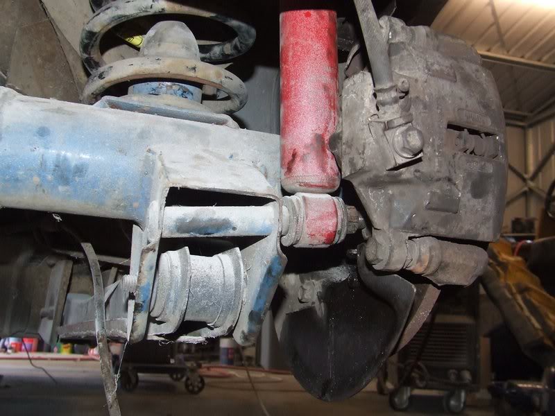

The commodore brakes fit straight on, except for one problem we came across that we didn't come across when doing this to the green hatch.
The calipers hit the shock. This didn't happen on the green car. When you view it from directly behind, the shocks taper outwards towards the bottom. I assumed they'd be straight up and down. All I can think of is whoever did the 9 inch conversion might have put the lower mounts in the wrong position. Meaning the lower arms might be out a bit too. I'm going to try and sort his out today.

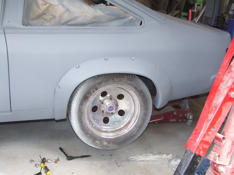

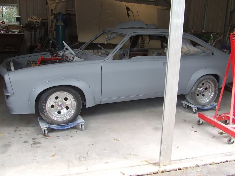

This is just an earlier shot of the car to compare how the back sits now with the commodore springs fitted.
And this is how it is now.
It's come down a little bit. Looks much better in my opinion.

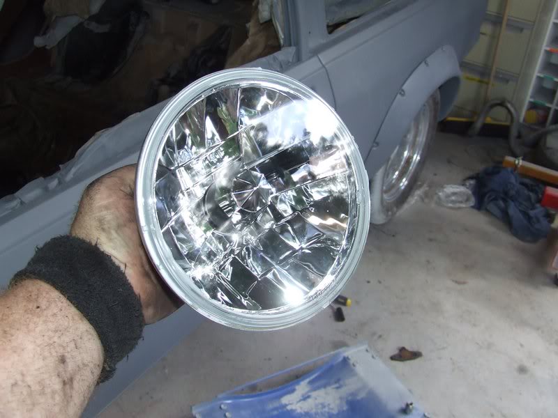

I finally got the headlights I ordered. Third time lucky.

#321 ls2lxhatch
Posted 10 February 2010 - 10:31 AM
It is normal for the Commodore rear disc callipers to foul on the standard Torana shock mount. It typically just clears with new pads but will foul if the pads are worn.
Options
1. Swap backing plates over and run the calliper in front of the axle. This does make connecting the handbrake difficult. It tried this method but was not happy with the handbrake setup.
2. Cut the hub off the backing plate and rotate the calliper mount to the 2 o'clock position and weld the plate back on. You can just see the weld like in this picture where the hub joins the backing plate. I have used this method but then decided to make the diff 10 mm wider.
3. Make the diff 10 mm wider and run the calliper in the standard position. I have used this method.
4. Relocate the lower shock mount. I considered this method but was not happy with the shock to body clearance.
5. Use Nissan Skyline callipers. I was not aware of this method when I did my diff.
http://www.gmh-torana.com.au/forums/index.php?showtopic=29806&view=findpost&p=453104
The Skyline callipers appears to be the easiest to setup for a handbrake ( Personally think the Commodore handbrake setup is crap ). Apparently the Commodore calliper and pad selection is better however this is probably not an issue for a street car.
I have the Commodore callipers but if I was to do it again I would try the Skyline.
Edited by ls2lxhatch, 10 February 2010 - 10:43 AM.

#323 Heath
Posted 10 February 2010 - 01:25 PM
I wouldn't use the IRS springs if you are putting big wheels on it and it's a street car... they are bloody stiff and you really need a decent profile tyre to take up some of the slack

#324 76lxhatch
Posted 10 February 2010 - 02:08 PM
Calipers, mounting brackets and discs required to get the standard Nissan angle without cutting and welding (different diameter and offset rotors)

orangelj, when I first thought about those lights I too thought they were everywhere, so I took notice of cars getting around for a couple of weeks and never saw one set. Either way, I like them better than standard lights : )
Heath, I guess we'll have to wait and see if the tyres will take up some of the roughness. It'll have 265/50/15s on it, so at least they have a bit of sidewall in them.
