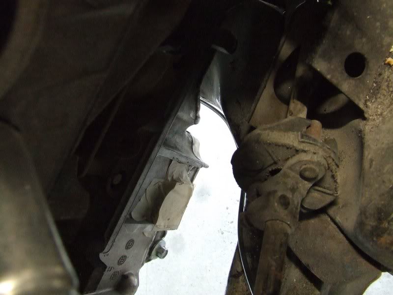

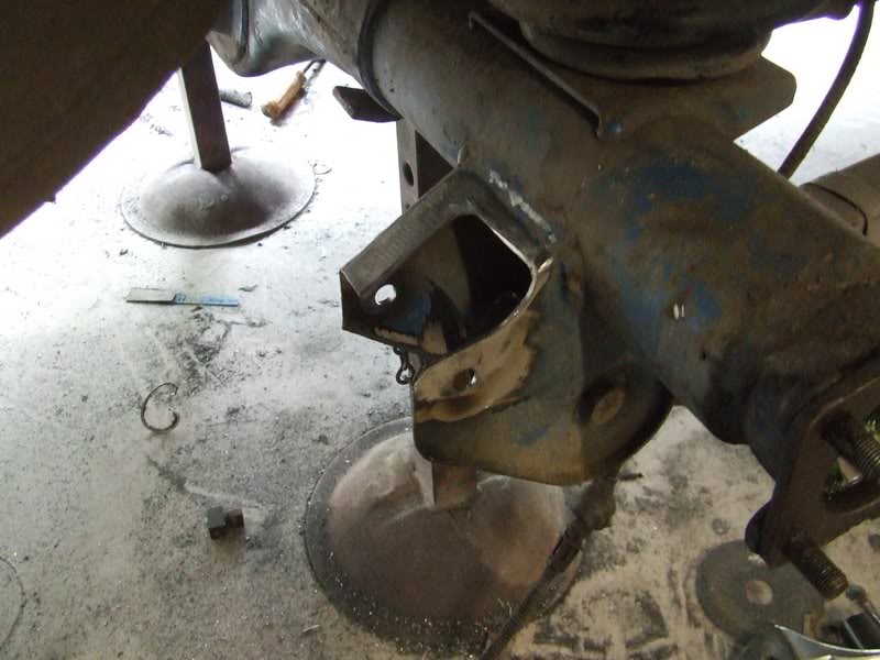

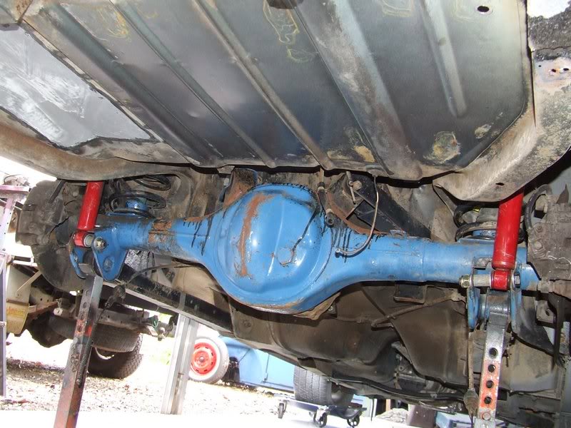

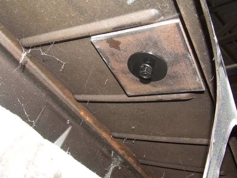

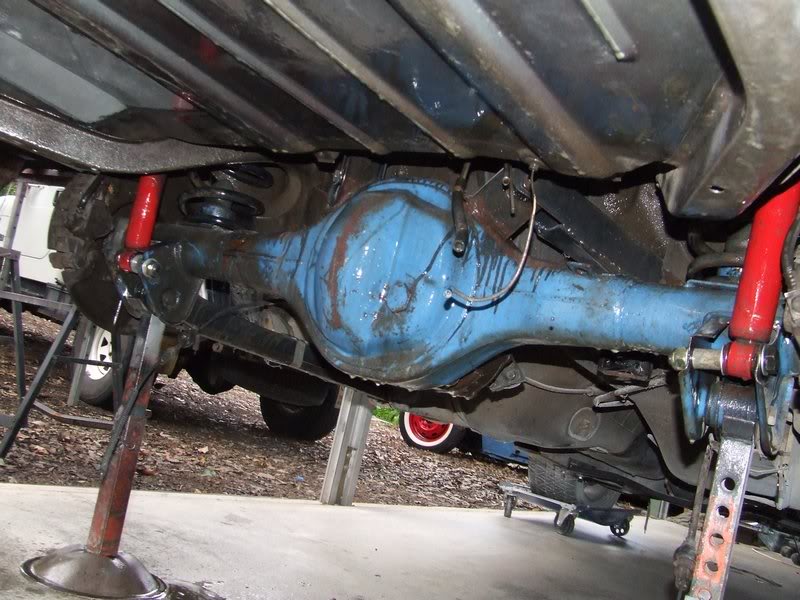

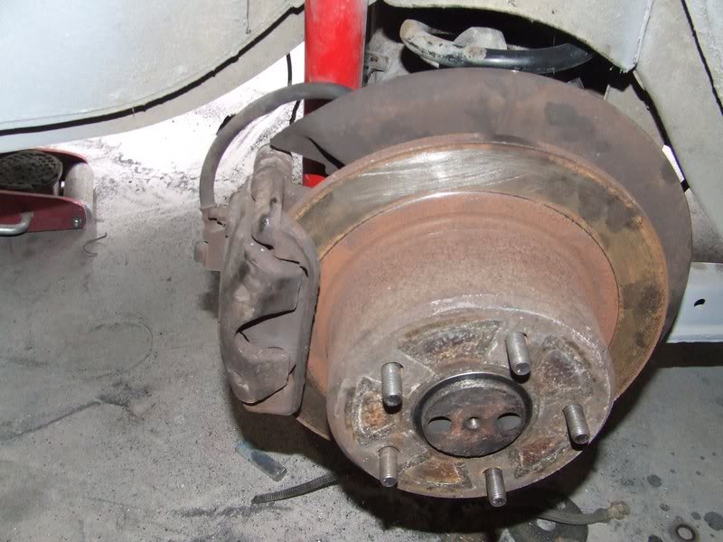

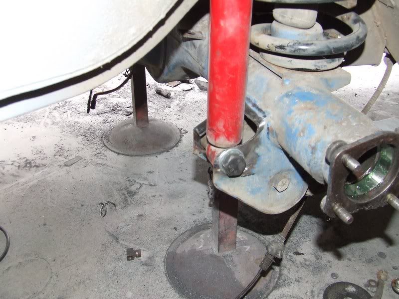

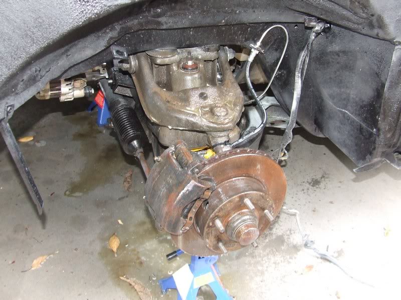

Got the rear brakes sorted out. Thanks to everyone for the suggestions, but me being a tight a$$ I decided to just modify what was already there.
The plan is to mount the shock inside the lower bracket, rather than next to it.
The mount was cut. and the original captive bolt removed. The shock will now mount on a high tensile 5/8 bolt.
This system will work fine. It's a similar set up we used to use on hot rods, so I have no doubt about it's strength. There is still ample room between the shock and the body, and there is stacks of room between the shock and the caliper.
With that done the brakes fit like a charm.
Knowing what I know now I wouldn't have mounted the 5/8 bolt on the same angle as the original mount, but the shock is no more out of shape on the mount than it used to be.

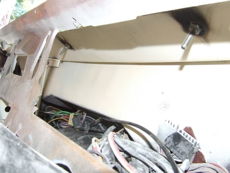

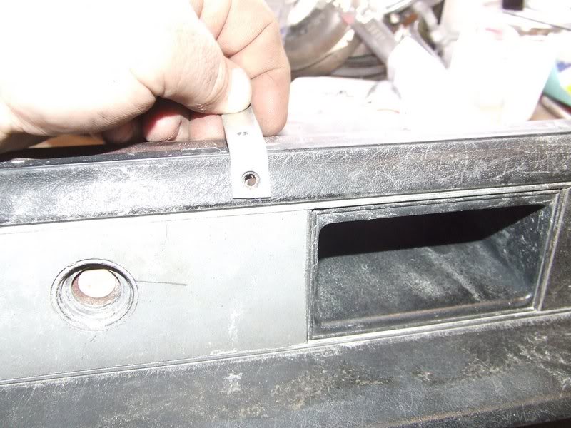

The next job was fine tuning the A/C mounting to the dash.
The A/C had these two little alloy tabs that held the vent/control end of the unit to the dash. The problem with the alloy tabs it you could see them on the dash. I thought of another way to mount this part of the A/C so it didn't need these alloy tabs. It will look a lot cleaner. I also made some fine adjustments to the main A/C mounts so the whole unit sits better against the dash.
You can see in the next pic there are two little holes in the face of the dash down near the A/C unit. This is where the two alloy tabs used to be.
Very visible. In this pic it's mounted to the dash, but the mounts are now internal. I also modified the mounting system so the lower part of the dash can be removed without having to take out the A/C unit. Might be helpful later.
I think the whole unit sits a lot nicer against the dash now. Don't worry about how floppy that big opening is on the right, that's where the vents and controls mount. They hold that part of the unit in shape.

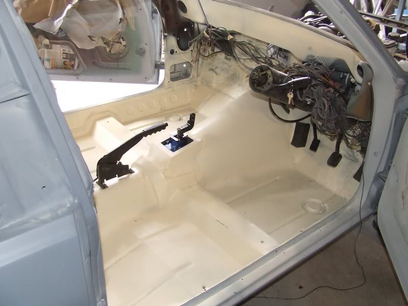

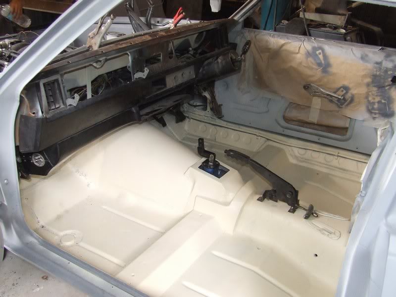

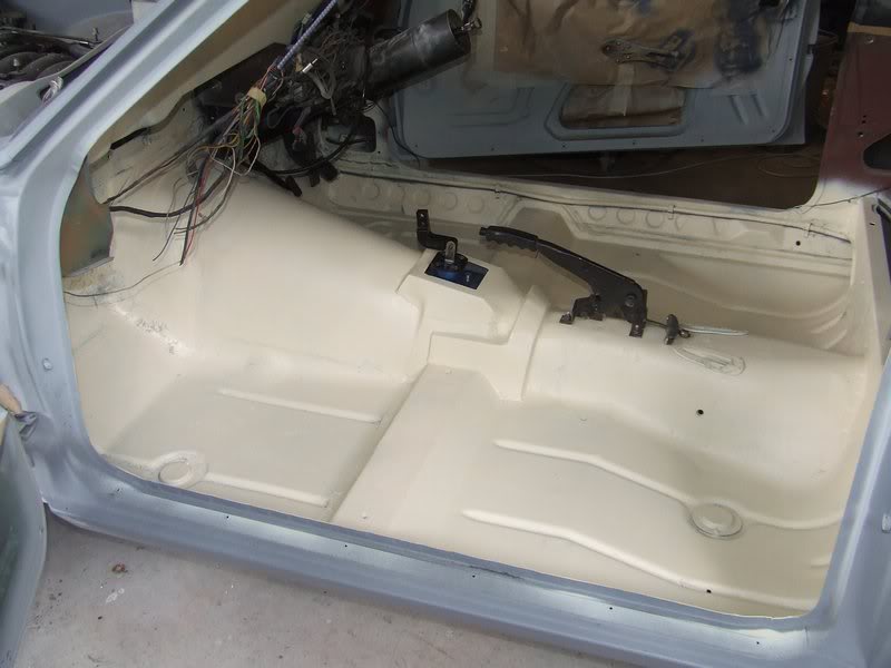

Before I mount the heater, dash and A/C I thought I should seal the floor after it all got cleaned, plus there is a fair bit of bare metal. I used some 2pac etch primer after applying the rust converter yesterday.
It's not pretty, but that's why they invented carpet : )

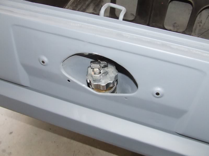

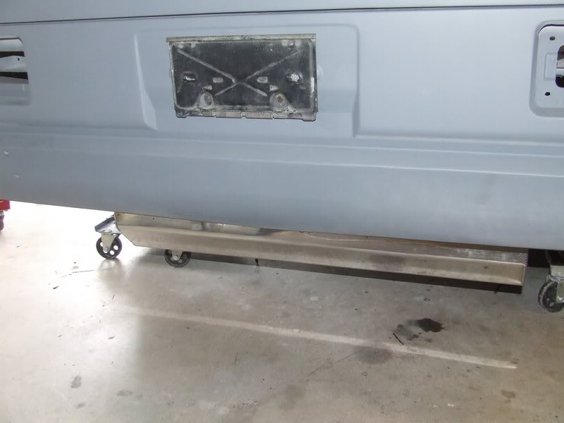

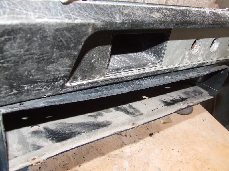

Put the fuel tank back in to double check the filler neck would fit, as it's pretty huge, and to see if there was enough room for the fuel pump/regulator/filter underneath.
Also fitted the number plate mount to make sure it didn't hit the filler. It didn't.

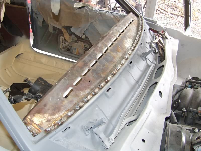

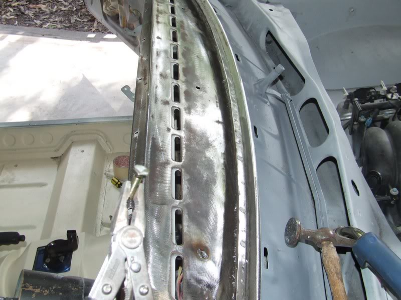

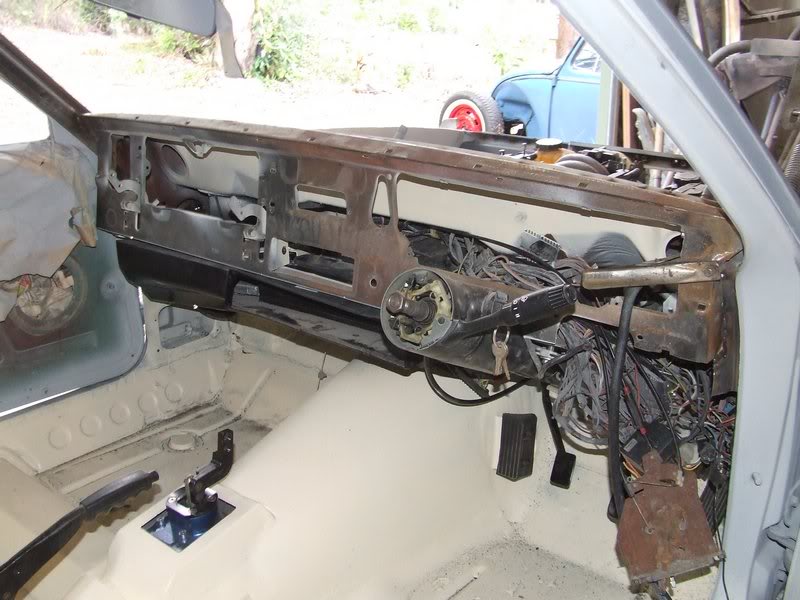

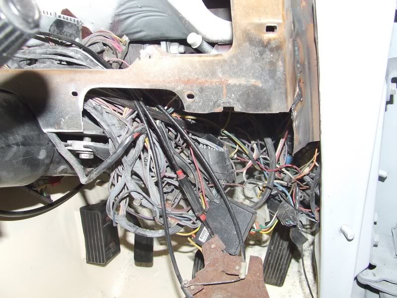

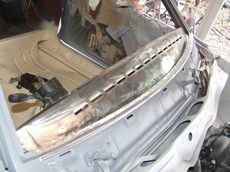

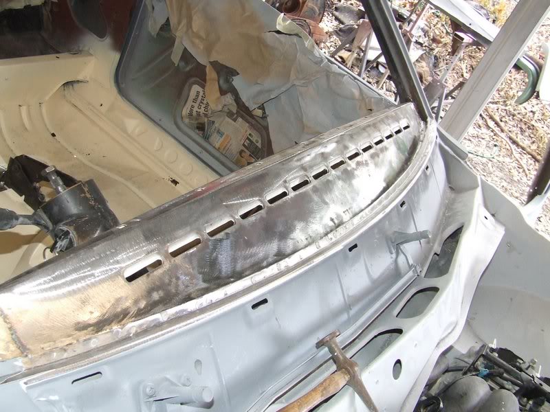

Then it was time to finally weld the dash in.

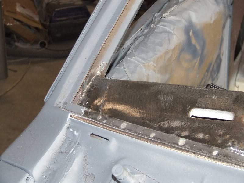

I tacked the sides on and made sure it was in the right spot before plug welding the front to the windscreen frame.
I welded the sides of the dash to the A pillars. I assumed this is how it went. I couldn't remember and the ends of this dash were so rusty when I got it and had to replace both ends. Anyway, it's in, so who cares : )
I ended up getting rid of the 3 square holes in the top of the dash that had dome top bolts that held the demister vent in place, after this shot was taken.
Instead of having the bolt heads on top of the dash, I drilled the square holes out to 8mm and plug welded some quarter inch bolts underneath the dash to mount the demister vent.
Now it's a nice smooth dash. No one will notice, but I know it's done : )
This pic is funny. The metal on the left of the weld is UC, and to the right of the weld is LX. The LX dash was so rusty on the ends I kept a bit of the UC dash there on the sides to help mount the LX dash. Made it a lot easier. Not the prettiest weld though.

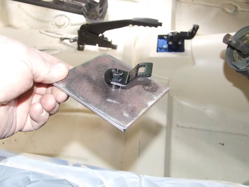

I also made some plates for mounting the child restraints.
It's 100mmx100mmx5mm plate and just a pair of Klippan restraints.
Don't worry about the next photo, I know the bolt isn't tightened up. They were only done up finger tight to check they fitted and to take these pics. They got taken out straight away to clean all the floor in the rear area with a wire wheel. Fun job that one.

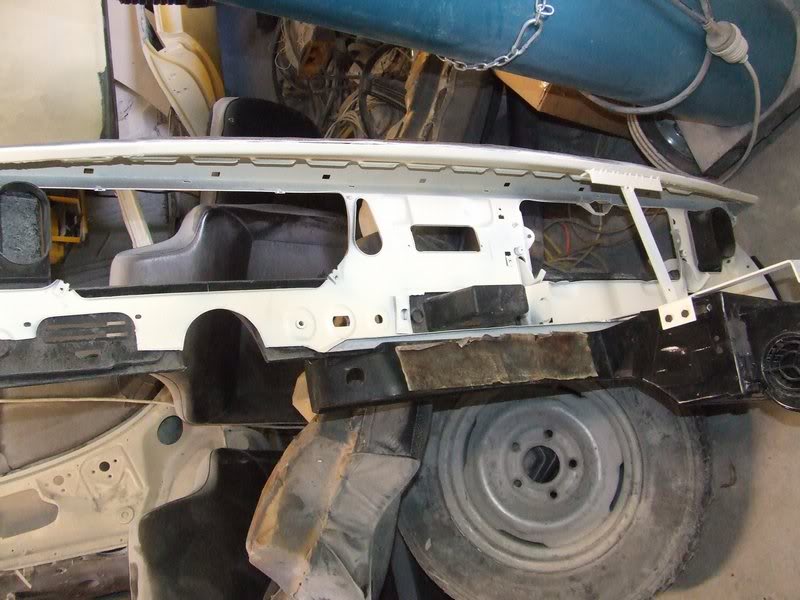

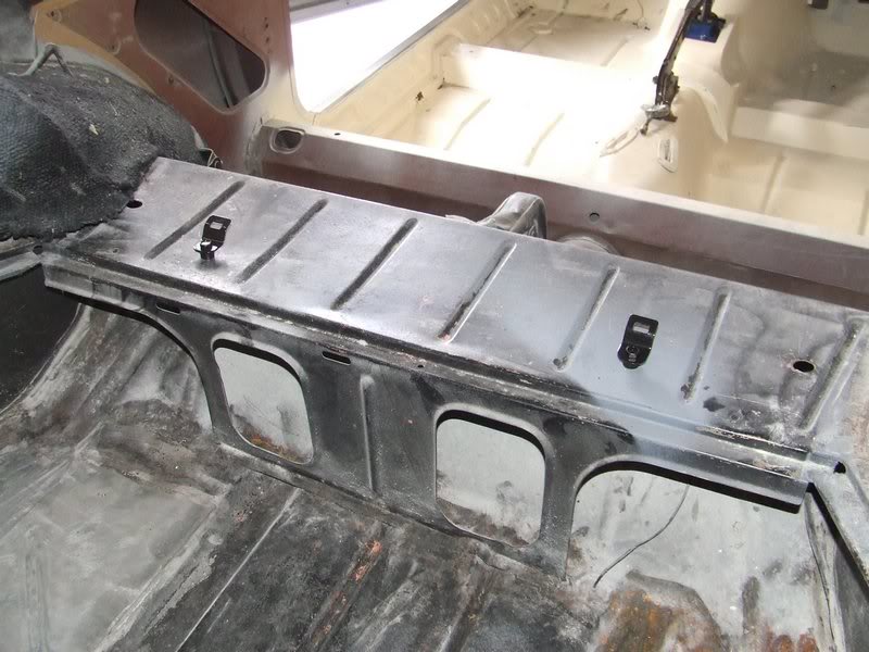

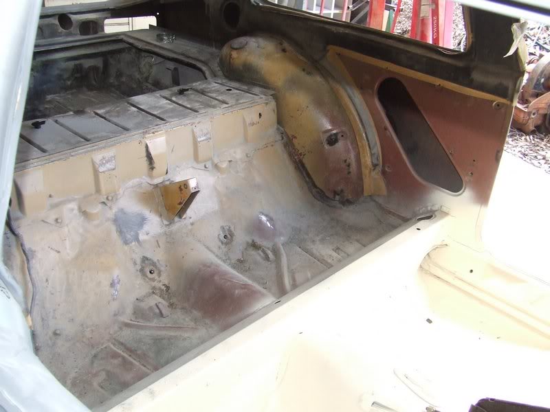

The rest of the rear section was stripped out.

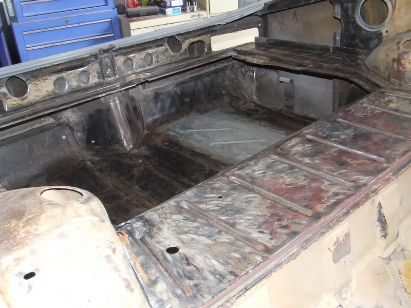

I finished cleaning the inside of the rear section and gave it a quick coat of etch primer just to seal up the bare metal areas,

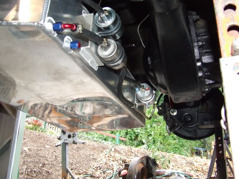

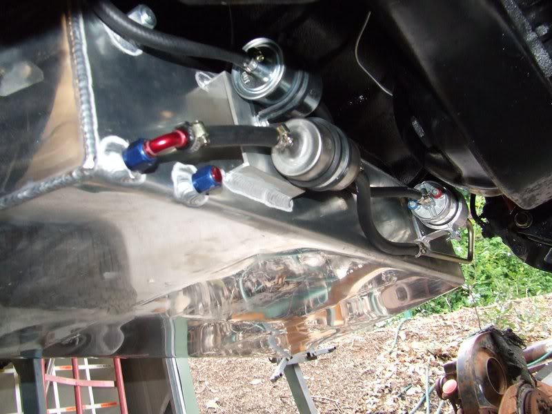

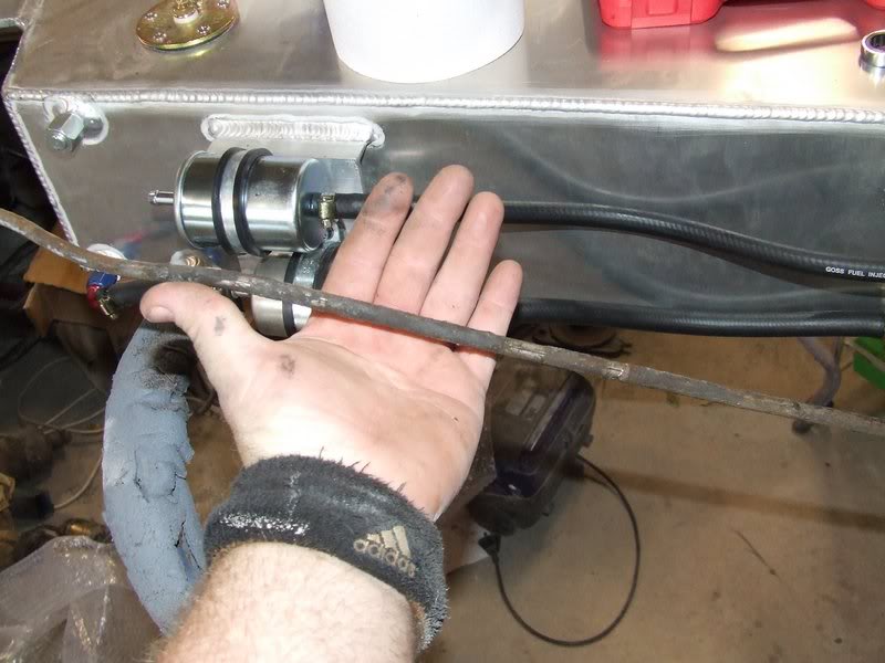

Next up is the fuel system.
I was originally going to mount the pump here but to have room for a filter before and after the pump I ended up welding the pump mount to the other side of the tank and mounting the filters on the plate where the pump is here.
Here's the basic layout with the pump bracket welded on.

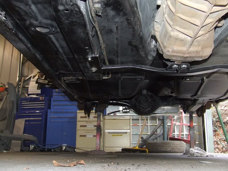

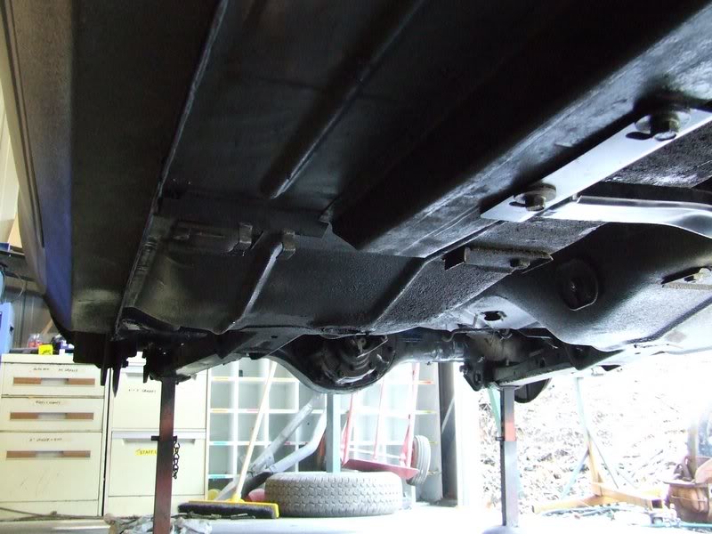

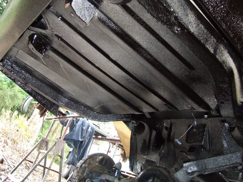

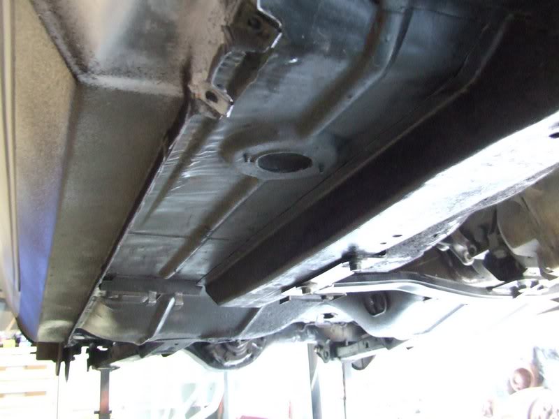

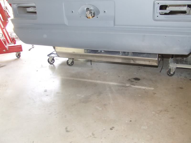

Before I run new brake and fuel lines I decided to give the underside a bit of a clean.
I used CT18 truckwash for the most of it and scraped off the really crusty bits, buts it's really just to check for rust and to make it look a bit less blue diffy : )
I ended up doing the truckwash 3 times, but it came up well in the end.
This is the first spray with CT18.
I let it dry after each going over with the truckwash to see how it was looking. This is after the first spray and hose off.
The under side is just getting a coat or two of stone guard.
The sills copped some stone guard too. I'll reprime over this and top coat over it so it will be almost invisible.

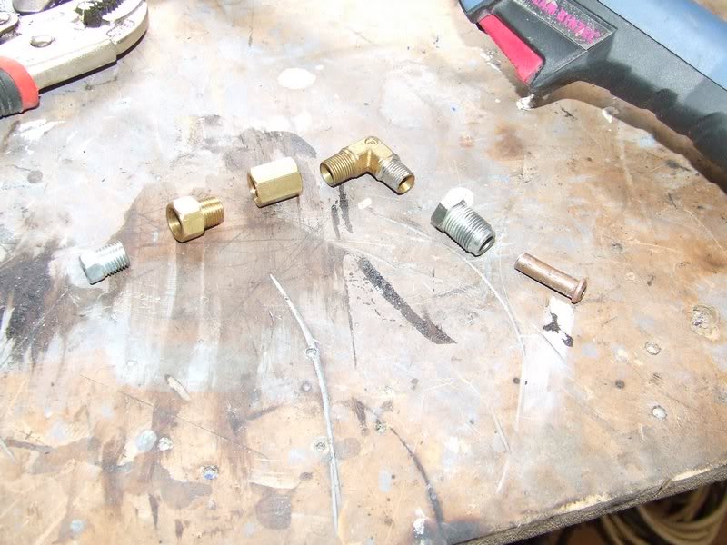

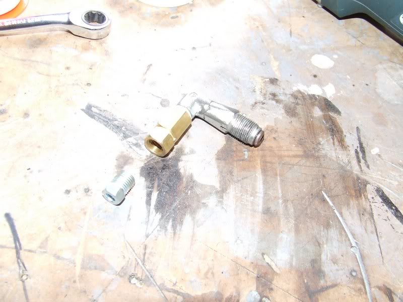

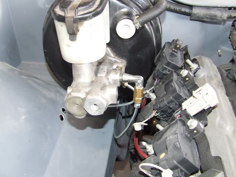

Some of the fittings are for a single pipe flare and some are double flare, even though it all came off the same VP commodore. I just had to make sure I made the hoses the right way around to suit.
The rubber line is also commodore and is the T piece for the rear brakes. It fits perfectly into the original torana mount on the body and is even the right length. Bargain.
I had to check that the rubber hose didn't get squashed when the diff was raised, and luckily for me it didn't.
It certainly isn't super pretty, but it's better than before, and I know there's no rust in there.
I then had the fun job of removing the old hard lines for fuel and rear brakes. Once they were out I cleaned the drivers side of the floor and painted it so I could fit the new lines and not have to paint over them.
There's so much fun to be had cleaning under a car : )

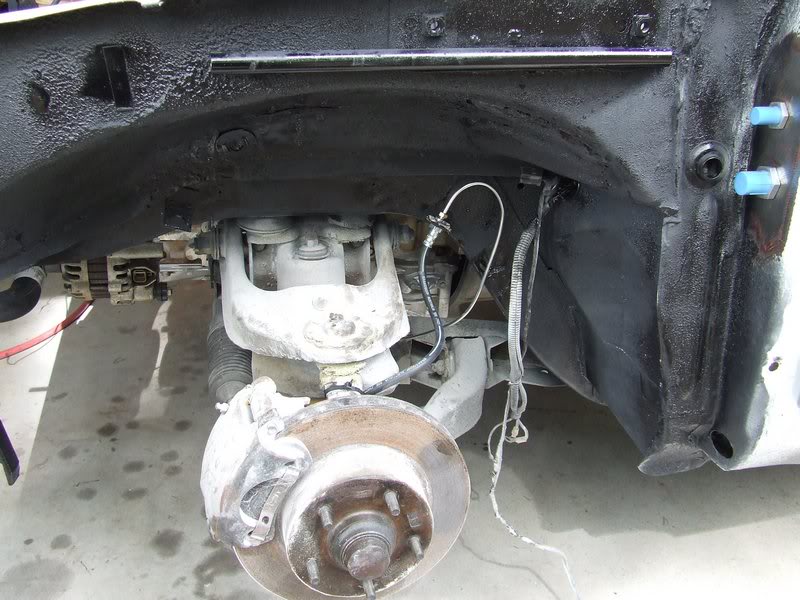

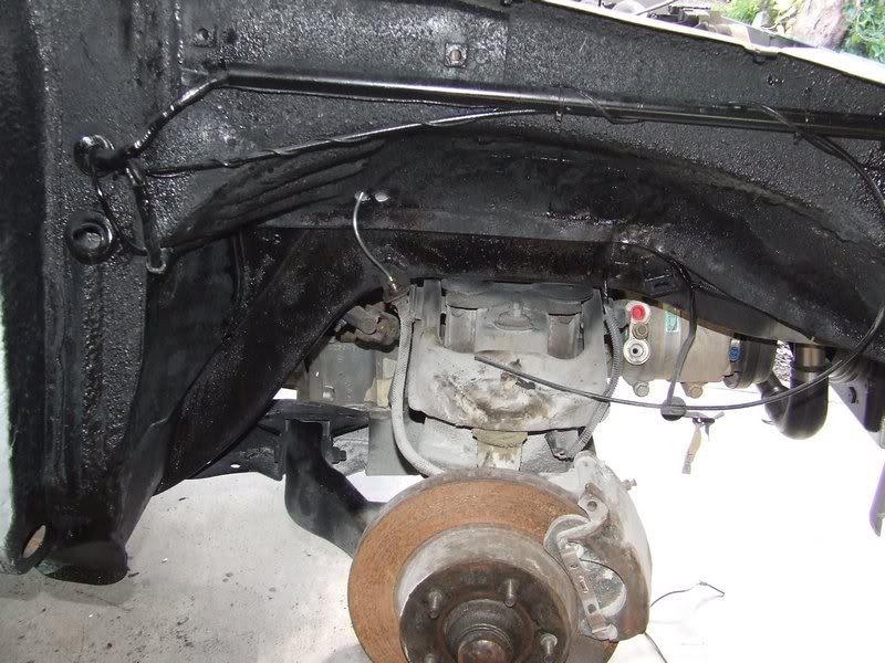

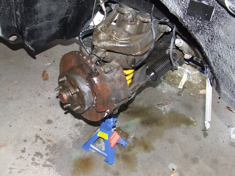

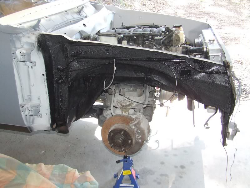

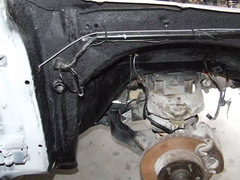

I also did the inside of the drivers side front guard so I could do the brake lines and bonnet release cable.

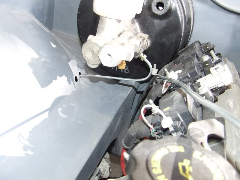

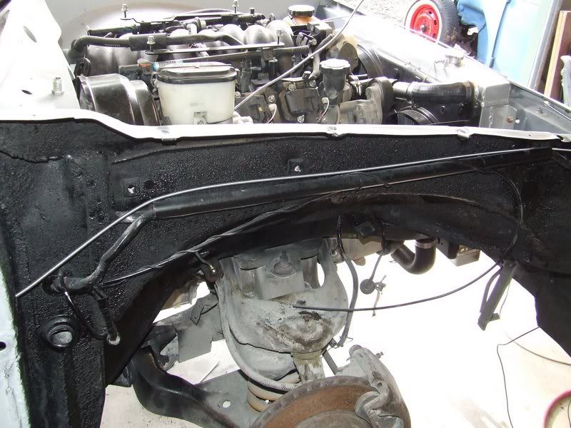

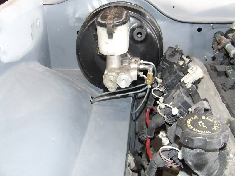

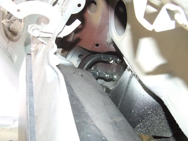

Here's the brake line for the front right wheel. The pipe coming out of the engine bay is for the rear brakes. It's connected to the rear rubber line and runs along the original path under the car. I just need a special fitting to connect it to the master cylinder.
The front right wheel brake line will go through the other hole in the inner guard and then run along the back of the crossmember.
Here's the brake line in place. The flexi hose will need replacing as it's crusty and it needs to be metric at the end of the new brake line.
I also fitted an extra long bonnet release cable so I could completely hide it. It will only be visible at the bonnet latch.
This is the only bit that will be seen as it goes into the bonnet latch.

Posted 25 February 2010 - 06:53 AM
Thanks Ben.
Well I got some more work done on the brake lines. I had to invent a fitting that would allow me to screw the 3/16 fitting into the 1/4 inch hole. This is what I came up with, as there was nothing I could find with the same 12x1mm thread I needed.
The fitting with the flared pipe in front of it got welded to the 90 degree elbow. With the short piece of flared pipe pushed inside it will now seal against the master cylinder. I screwed the fitting in before welding and marked the top so I knew the bend would be facing the right way.
Here it is fitted to the master cylinder with the rear brake line now connected.
I had the new rubber lines made that are metric at the pipe end and imperial at the caliper end. This brake is now finished, along with the rears. Yay. I also changed the pipe from the master cylinder on this wheel comes through the front hole in the inner guard, as it was easier to route the other line through the back hole.
Here's the hose for the left front wheel disappearing towards the motor.
Making the pipe for the front left wheel was a little tricky, as I wanted it in one piece but it curls around so much at each end I don't think it can be removed without cutting it. This made it interesting to make.
Once the motor comes out again I'll attach the pipe to the crossmember with some "P" clamps.
Next step was cleaning the old steel fuel line, as it was covered in crap but still good enough to use.
The new rear brake line and original fuel line still run in their original mounts under the car. Don't give me grief about how crap the underside looks, I'm way too lazy for that sort of attention to detail. Once the motor and box come out I'll be able to do a better job on the front floors and tunnel.
Next the fuel tank went back in and the filter joined to the steel fuel line under the car with a piece of rubber hose. EFI grade of course : )
I tried to make as much room around the diff as possible and still be able to get at everything. I think it's turned out pretty well.
Next awesome job is cleaning the front suspension and steering.
That's it for now.
