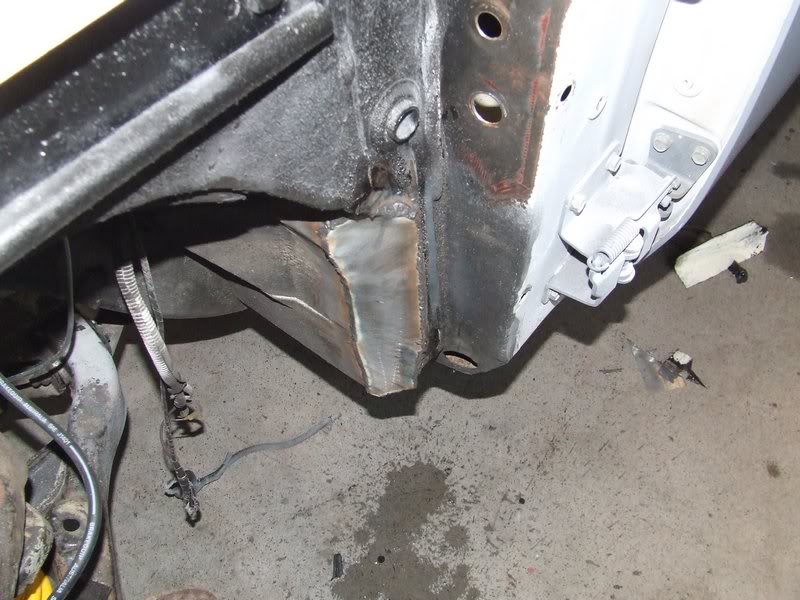

Next job is removing the lip from the front corners of the firewall to give the tyres some more room.
This is how much I'm removing. I don't want to cut too much as it will obstruct the accelerator pedal and look weird.
You can sort of see the new piece in this pic. It doesn't affect the travel of the accelerator pedal.
Here's the new piece. You can see it's taking up a lot less space than it used to.
The firewall now only sticks out about 45mm.
Here's the other side that hasn't been cut yet, It has though, at some stage been flogged in instead of removed,
Before the cut there was about 90mm of lip sticking out.

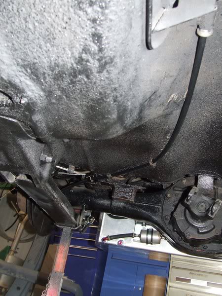

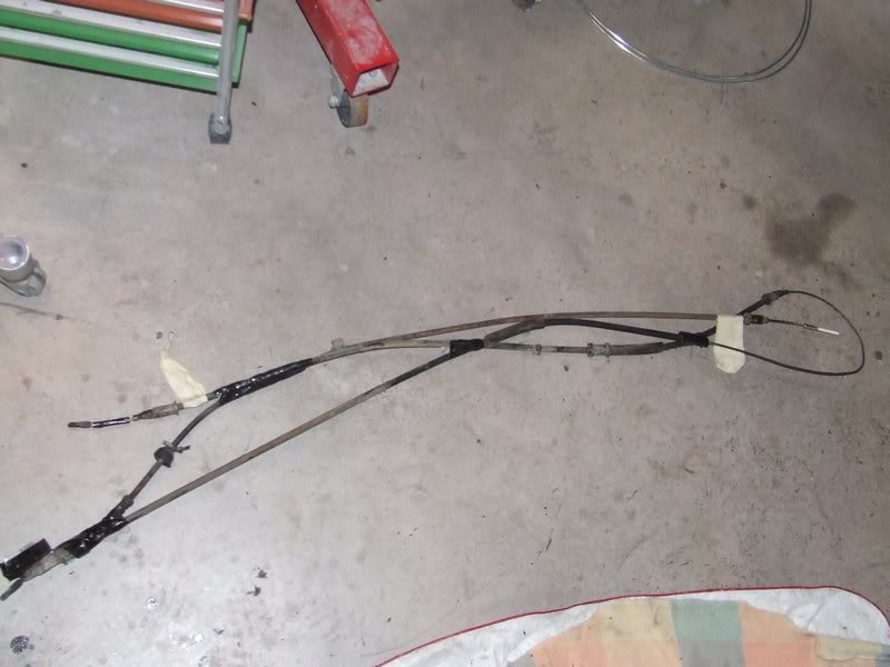

I refitted the UC hand brake cable to the lever, then mounted the commodore hand brake cable to the disc. I then positioned them as if they were one unit and taped them together at the right length.

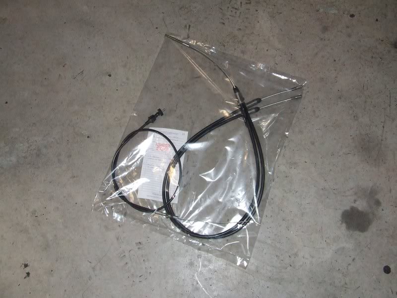

I also sorted out the changes I wanted to make to the accelerator cable. It'll be shorter than standard and have a barrel fitting on the end instead to suit the LS1 throttle linkage.
I took these in to the cable place today. I should get them back tomorrow or wednesday.
This pic shows the UC - VP commodore hand brake mixture taped together. The ends with the white masking tape are the ends I need, so you can see how the cable will look.

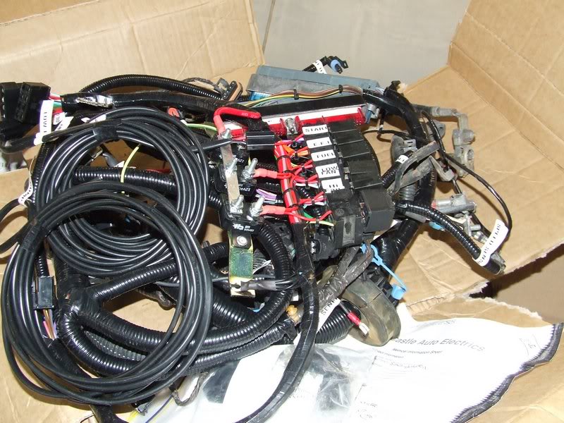

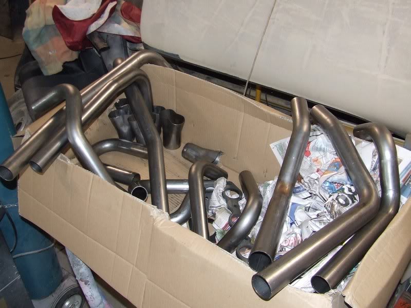

The computer and loom came back from CAE today with all the changes/reprogramming done. It's now MAFless so no air flow meter. Yay.
CAE also supplied an extractor kit for me to have fun with. It's not cut to size and there are no instructions so it will be a lot of fun I think nutting it out. I spent a while today going through the bends and think I have most of the left extractor figured out in my head.
First thing I did was bolt the new flange into place to make sure it was a nice flat fit. It was of course.
I didn't get any more actual work done to the pipes today, as getting the cables sorted and trying to figure the pipes out took a while.

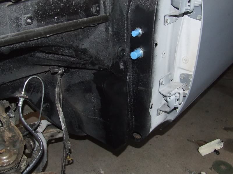

I did get the other side of the firewall done.
Here's the new piece welded in but not sanded down yet so it's a tad ugly.
This shows how much room is gained by doing this.

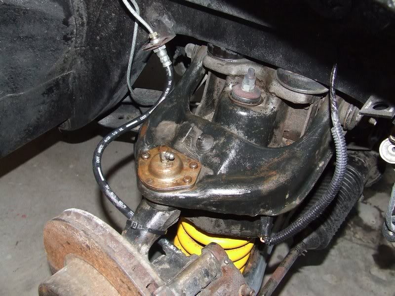

You can see in the above pic that the A/C lines are gone. I removed it all just in case doing this mod damaged any of it. I guess it wasted a bit of time doing so, as I should have done this before I fitted the A/C, but I didn't think of it then. I know, I'm a dumb ass : (
Here it is back together with a bit of black.

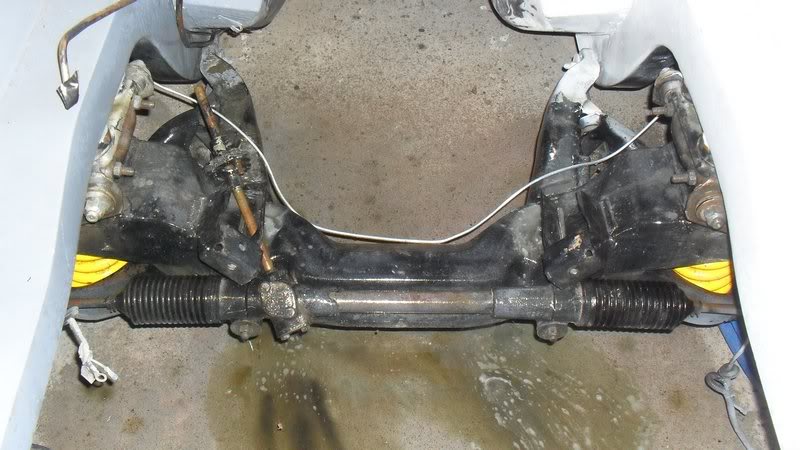

The front suspension is starting to look a little better bit by bit.

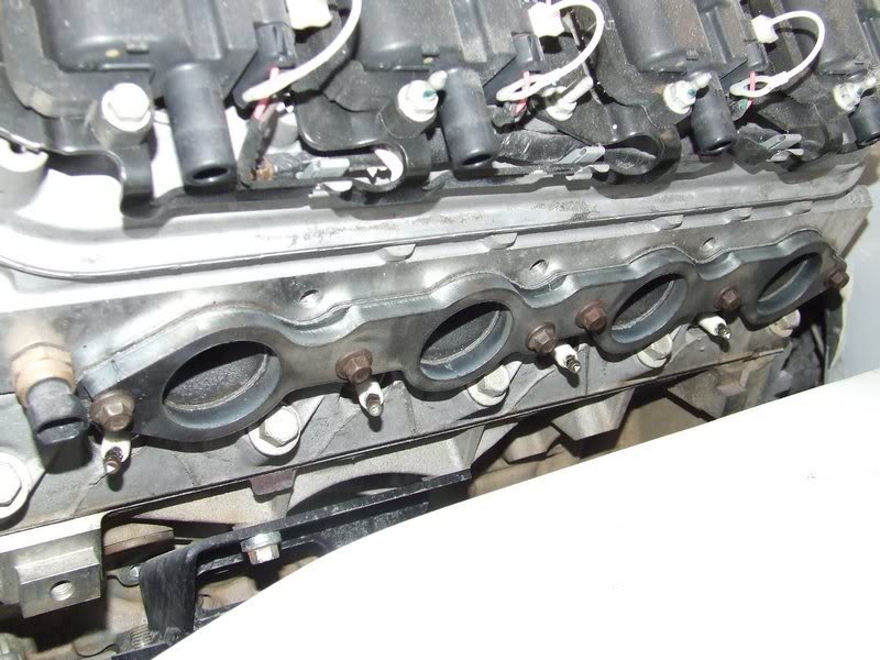

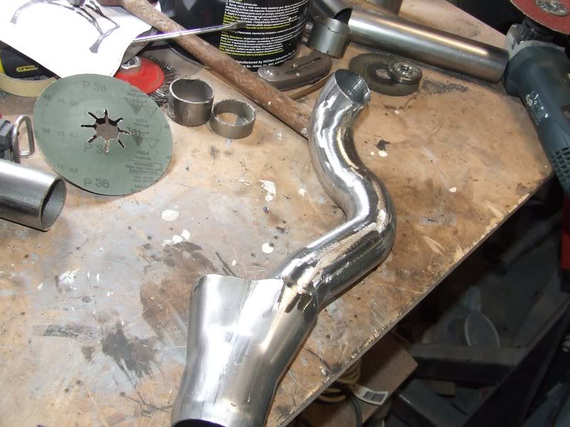

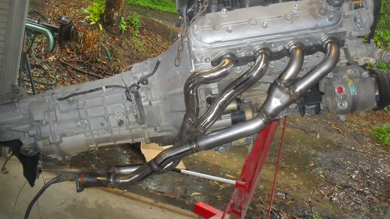

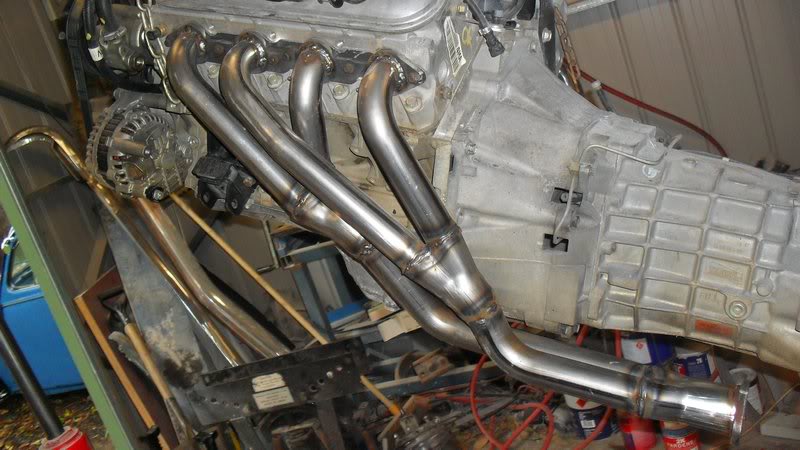

Well today was a good day. I got to pay around with the extractor kit. I kind of assumed the kit was just the same bends and everything as the CH-77 extractors that CAE sell to suit LS1 into torana. There are some pipes in there that are totally different to the picture I printed of some of their extractors completed.
I decided I'd just wing it : )

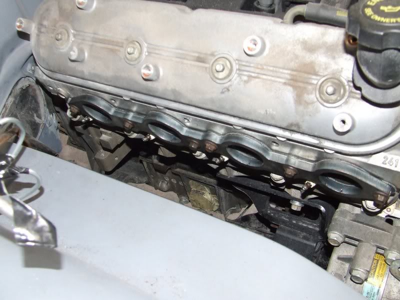

First move after bolting the flange on was sorting the pipes in some order in my head, then start cutting and tacking, making sure it fitted and that the Y pieces had enough room too.
Obviously I had to make sure there was enough room to attach the secondaries after the Y pieces.
I started on the left side as there is nothing in the way, like a steering column or starter motor, so the extra room made this side a lot easier.

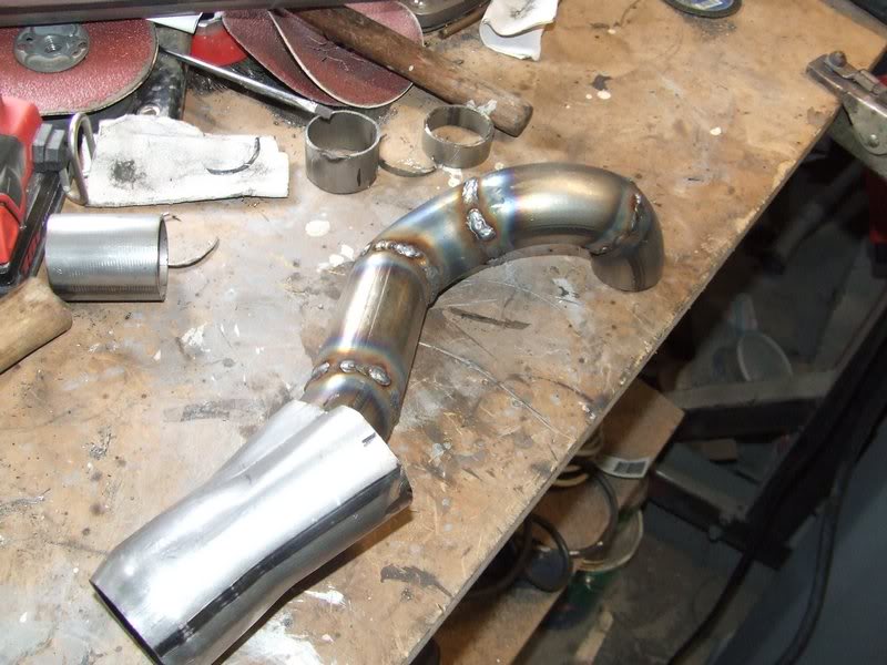

I welded he flange onto the collector from the inside and used a die grinder to clean it up. Seemed more interesting than just welding the outside : )
I had to use my pipe bender to shape one of the secondaries on this side, but not too much. All the bends are mandrel bends, so I didn't want to put a huge crush bend into it.
They look pretty good now though.

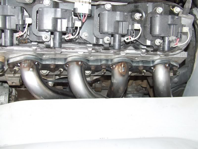

When I first fitted the extractor flange, I saw the middle 2 bolt holes were offset, and looked like they only went on one way. I put the flange on, it fitted, so I guessed that was the right way. ls2lxhatch tells me to flip the flange and it will still fit, that way the slotted hole at the end will have the slot at the bottom, not the top like I had it. Derrrrr!!!!! Sometimes I surprise myself how dumb I am : )
Anyway, I cut the flange off and flipped it, and it looks a lot neater now. Thanks Andy, what the hell would I do without you buddy???
There's still a bit of room around the extractors, so hopefully the paint will be OK heat-wise once it's painted.

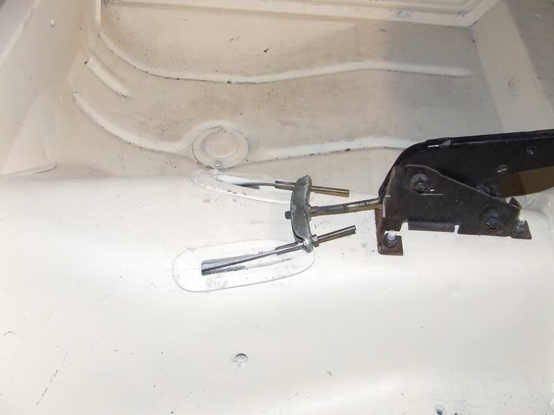

Here's the cables I had made for the hand brake and accelerator pedal.
The hand brake outer casings fitted perfectly, but for some reason they made the inner cable too long. I'll have to go back to Beerwah and get them changed. Such a pain in the bum as it's a bit over an hour round trip and a boring drive to boot.
If you go back and look at the cable I used as the template, that was half UC and half commodore cables all taped together, you can see there isn't much inner cable sticking out each end, but then you look at the new ones in the plastic bag and there's about 4 inches too much inner cable. I'm a whinging bugger I know, but I was charged top dollar so expected a bit better.
Here's one of the cables mounted to the floor and rear brake.
The accelerator cable seems to be good though. It now has a barrel fitting on the end so fits perfectly into the linkage on the throttle body.

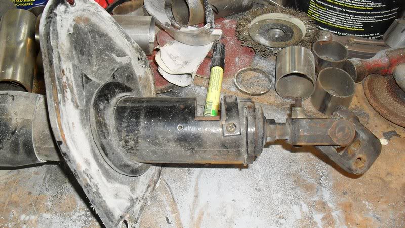

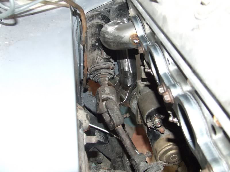

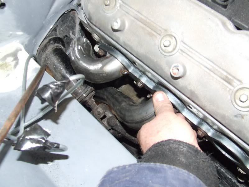

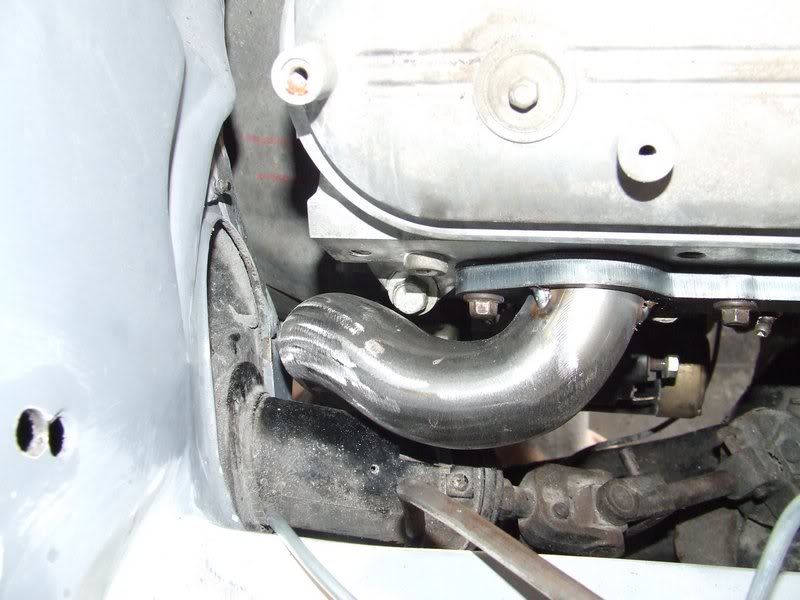

Next fun step is the drivers side extractor. I removed the brake booster/master cylinder and the coil packs to give me a bit more room.
Not a lot of room in there.
Unfortunately I spent a while this morning trying to make both the rear pipes go down and inside the steering column like the CAE one seem to do. The bends I have just weren't tight enough to get it to fit and the Y piece was too big, so I went a totally different way.
It was a shame to waste the time on the earlier design, but as long as it works in the end I'll be happy.
I ended up running the rear most pipe backwards beside the column then down behind the head.
You can see there's a few bends here. The welding is a bit ugly, but that's what grinders with sanding discs are for :)
After a bit of sanding.
Here's the piece tacked in place.
You can see where the Y piece is. I should be able to get the next pipe into there OK I hope. It is very tight beside the steering column though.
The next pipe isn't ready to get welded in yet, but it's taking shape. The front two pipes will be able to join into one straight away hopefully as there is a bit more room at the front for the Y piece. That way I only have to run a single pipe through the maze.

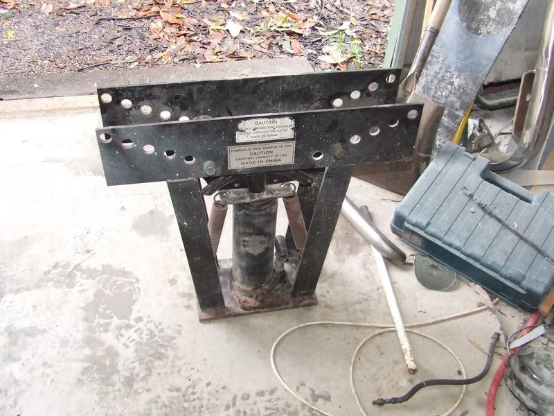

Here's the old monster. My cheapy pipe bender. It's not great for exhausts, as it tends to crush the pipe a bit, but it's better than nothing, and so far has been worth it's weight in gold. It's good with thick wall tube, so will be good for when I build a roll cage for the excort : )

Ooh..that pipe looks so close to the steering rack you might end up with a heated steering wheel for winter! have to charge him extra for this feature.. :tease: seriously though its looking the goods, one thing though Tim did you end up shaving the rails in the engine bay before you did the smoothing job?? i cant remember?? and am too lazy to search through the thread..:tomaatit:
Edited by AD_75, 04 March 2010 - 07:58 PM.
#365 ls2lxhatch
Posted 04 March 2010 - 09:36 PM

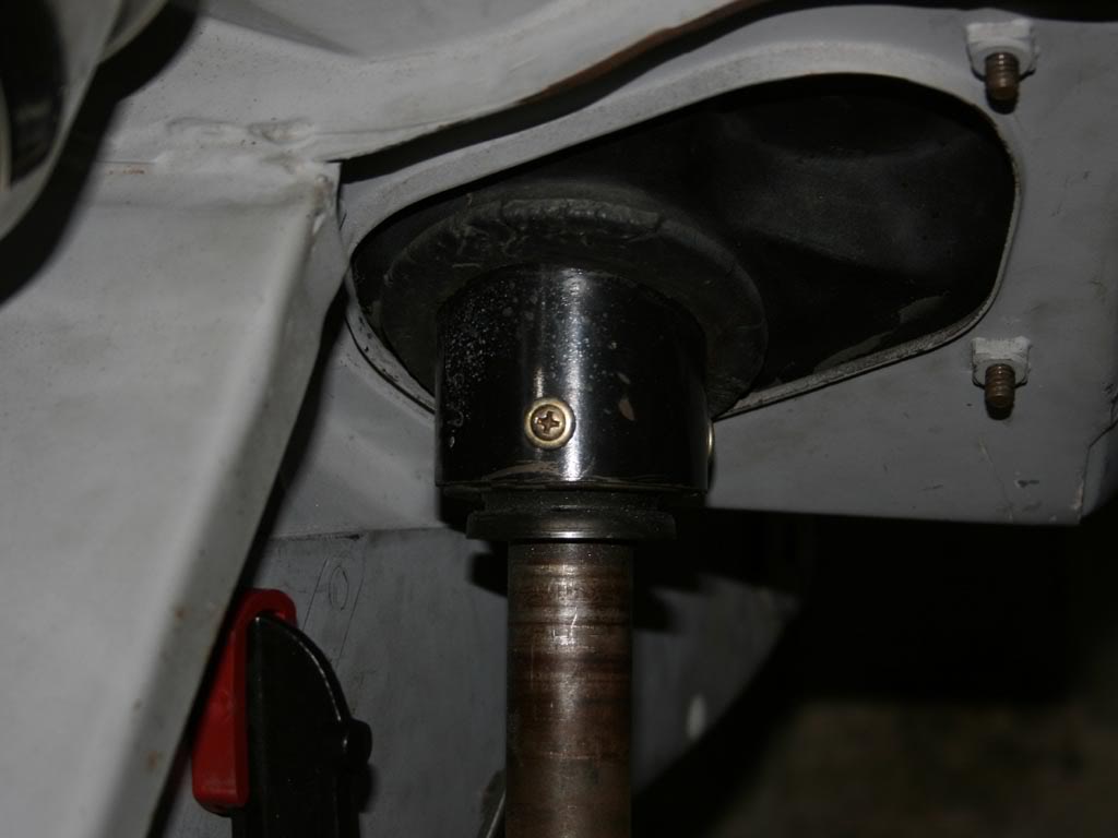

If you need more clearance you can trim the steering column.

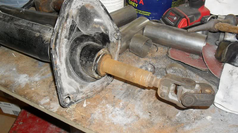

Swapping the donut for a second steel uni on the steering shaft gives another whisker of extra space and firms up the steering feel

Well, today saw a job get done that I was not exactly looking forward to, but enjoyed the challenge none the less.

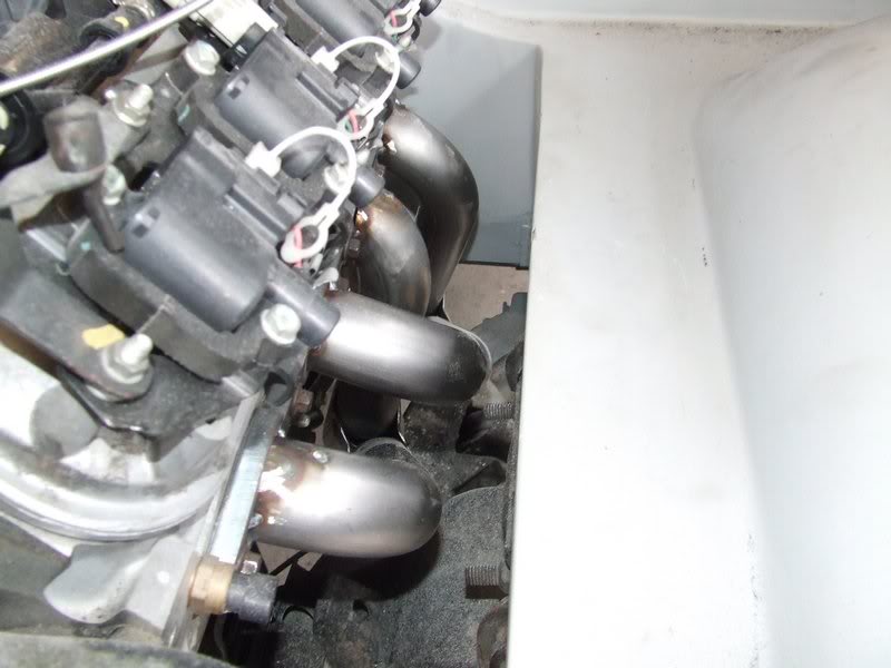

I got the drivers side extractor all tacked together even with the standard starter motor in place. Apparently it's a bit of a problem with LS1 conversions. I can see why now : )
The second pipe was just as much a pain as the first. I had to tighten the bends a fair bit to get the pipe in there, but seems to be quite happy where it is now.
The Y piece for the two rear pipes is down next to the bellhousing, but the Y piece for the front two pipes will be closer to the head, as there isn't enough room to run the two front pipes around the outside of the steering column.
It's amazing how much trouble I had trying to hold three things at once to get things tacked together : ) This is my first set of extractors I've ever made, so some teething problems are normal I guess : )
It was a fine line getting the pipe through here without hitting everything.
I have to admit it was a very nice feeling to have to be under the car to finish the pipes, as it meant the top section was in place.

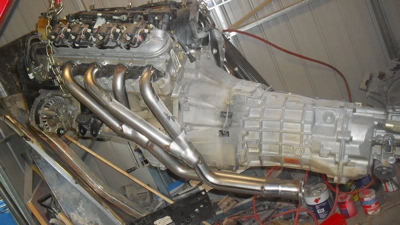

Finally the whole side is now tacked together. I'll put some more welds on them before I start pulling it all apart so they are a bit stronger. I'll then bolt them onto a piece of thick box section to fully weld them, so they don't distort too badly.
I know they're certainly not the prettiest extractors in the world, but I'd hope they're not the ugliest either : )
Getting the pipe from the front through the gap between the firewall and the K frame was a bit of fun too : ) It's funny how when it's all together it looks really easy. Maybe it is, and I'm just a dumb ass : )
Next step with these is to rip the motor and box out again and weld them up. Then the wiring. Yikes!!!!!!!

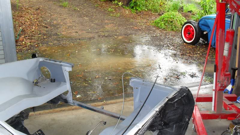

Well I did a bit more today, until the power went out : (

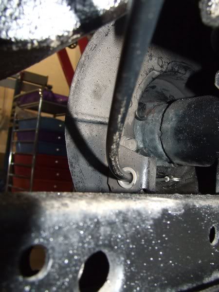

I finally have a working handbrake. There was a bit of a mix up with the cables, but the guy who did them stepped up and fixed them no dramas, so good on him.

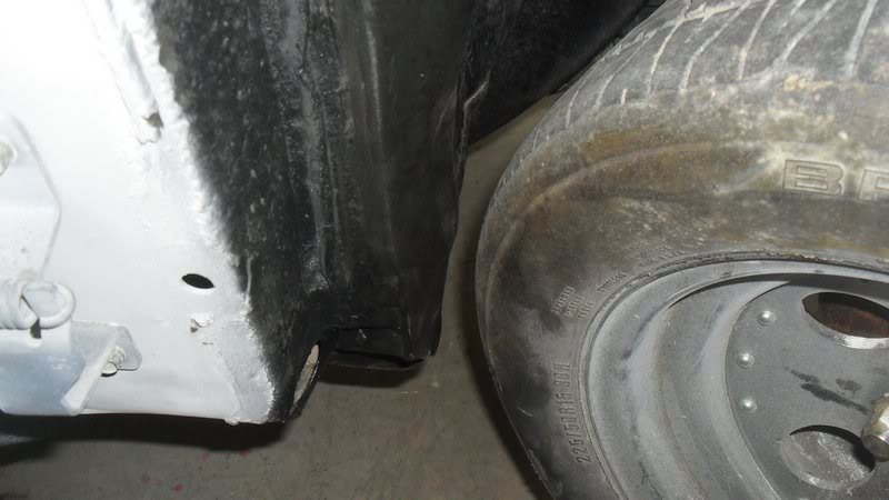

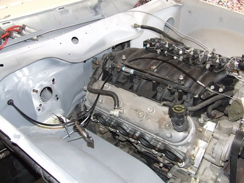

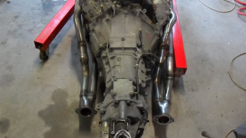

I had to put the car back on its wheels today so decided I'd take a pick of the clearance between the tyre and the firewall now the lip is removed. It might still hit when the suspension moves or if the tyres/wheels are bigger, but it's a definite improvement.
The next thing to do was rip the motor and box out again.
One thing I was actually trying for, but didn't mention while I was building the extractors in case it didn't work out, was to have them be able to stay bolted to the motor for removal and installation. As it turns out, I was able to leave them bolted on and still get the motor and box out in one easy step. A lot of this is because I kept the pipes as close to the engine as I could, and because I've made the top piece of the radiator support removable. I pulled the motor and box out by myself and it was easy, but once it's painted I think I'll get some extra hands to help me not scratch the heck out of it.
While it was up in the air I welded all the joins as much as I could while the extractors were still bolted to the motor. There's only a few areas I couldn't get to, so I'll do those when I take the pipes off.
I think for my first attempt they turned out pretty well. My opinion, anyway : )
My next job was to trim the steering column. I got this idea from Andy (ls2lxhatch). It's a nice easy mod that gives some more room for no cost. I'm glad he told me about it though, as I doubt I would have thought to do it.
The idea is to move the steering shaft support and bearing closer to the firewall.
There's an easy 21/2 - 3 inches of extra space to be had by doing this. I still need to get some short screws to hold the plastic bush in place, but other than that it's done. Thanks again Yoda : )
The steering shaft had a fair bit of gunk and surface rust on it, so I sanded it as well as I could, as the cleaner and smoother the shaft is the easier it is to move the end bearing.

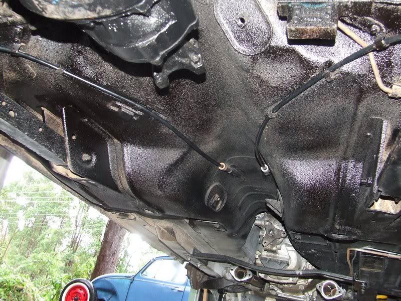

Time for a bit more cleaning. Yay. While the motor is out I thought I'd give the crossmember a bit of a clean up and paint. Then I can mount the left front brake line to the crossmember with some rubber lined "P" clamps.
It's been bucketing down here on and off for the last week, everything is soggy and wet, and even the front of the shed is a shallow pool. It sure is nice working in Qld heat and humidity....NOT!!!!! : )
So to top it off, the power went out. Plus we're on tank water, so no pump. At least I got to have a shower on the driveway : )
That's it til next week.
Here's my little shed pool.
#375 fenz
fenz
  • 220 posts
  • Name:Aaron
  • Location:South Australia
  • Joined: 26-July 09
Posted 06 March 2010 - 06:03 PM
Nice job on the pipes looks like they came up spot on.
