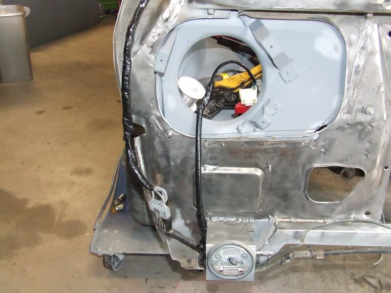

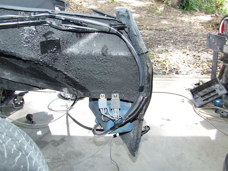

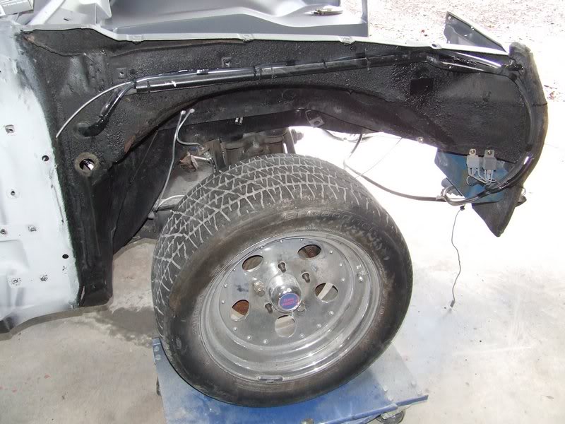

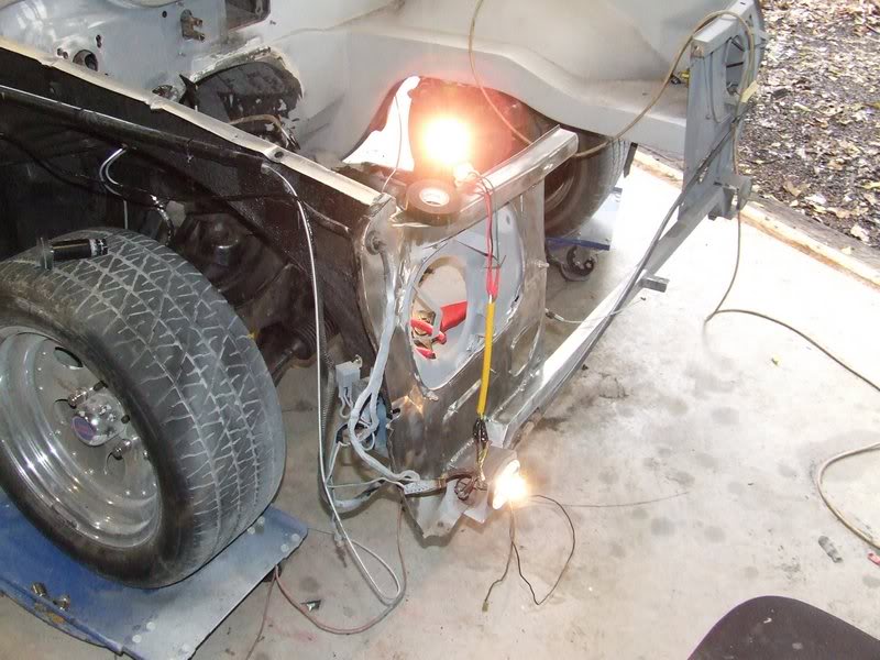

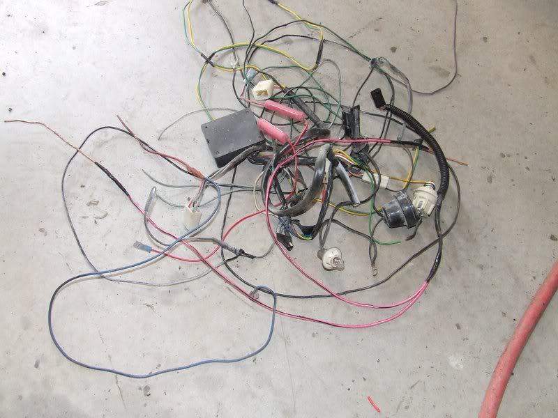

Starting to get somewhere with the original wiring finally. Basically nothing worked and nearly every wire was spliced into.
I bought new "00" size battery cables as the battery is going in the back. I also bought new alternator wire, heat shrink, bulbs, battery terminals etc.
This is less than half the crap I cut out from under the dash.
Now all that's left hanging under the dash is the intermittent wiper switch, the fuse box and the flasher unit.
After some mucking around I had lights and indicators. Better than nothing.
I even got excited enough to start cleaning the front of the radiator support panel.

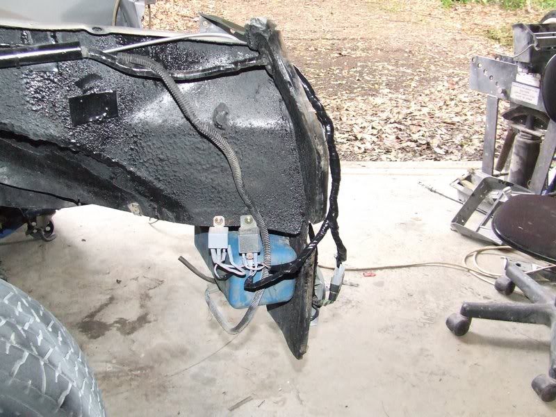

I mounted the window squirter bottle under the guard and even got the wiring working. I just need to hook up the hose now. I also tried to neaten up the headlight wiring/relays a bit.
I changed the indicator wiring to suit the new indicators too.

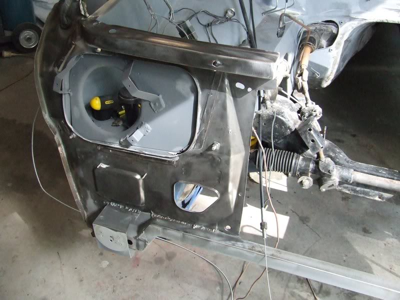

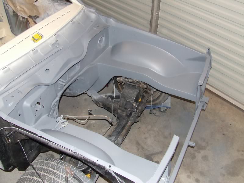

After mucking about a bit with the wiring I got a tad over it so decided I'd go back to the front of the radiator support panel.
I cleaned the rest of it back to metal and welded up all the unused holes. There were quite a few.
Once that was done I thought seeing as the engine bay is getting a bit knocked around I'd give it all a sand with some 120 dry and reprime the bay as well. I also sanded and reprimed the headlight mounts and the heater box.
I'm really happy with the way the heater box turned out after I chopped it up.
The lip at the top of the firewall is looking a bit neater now too after being smoothed out.
I really like this primer that I've been using. It's just a protec 2 pack primer filler, but it tacks off really fast so it doesn't get full of crap as it dries. This is only about 15 minutes after I sprayed the last coat and it's already lost it's shine. Easy to sand too : )

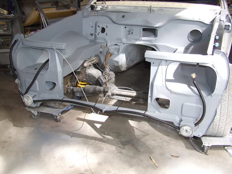

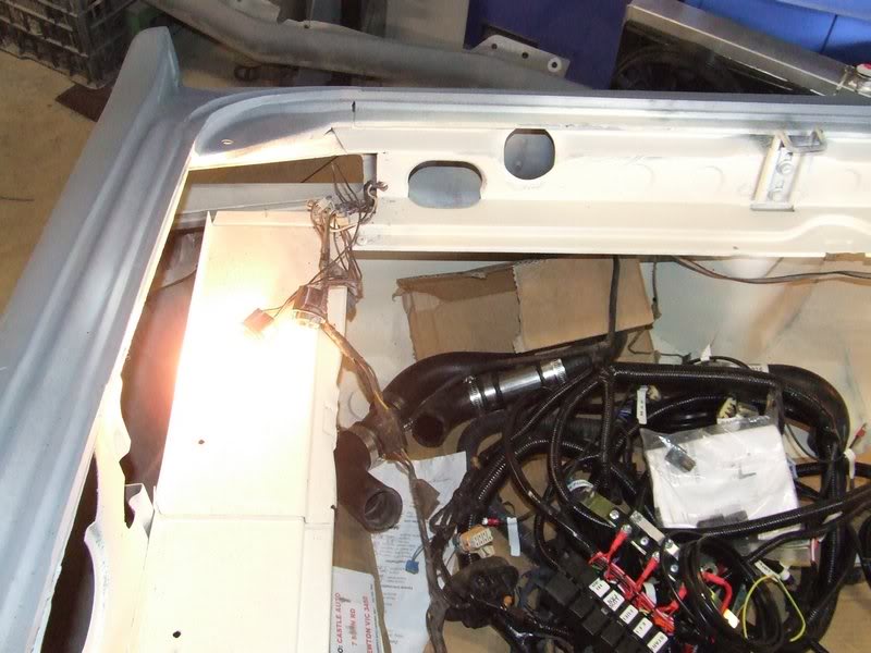

Not much to show when just doing wiring, but here's a couple of pics anyway.
The front of the original loom is now finished.
I ran a new hose for the windscreen squirters as well.

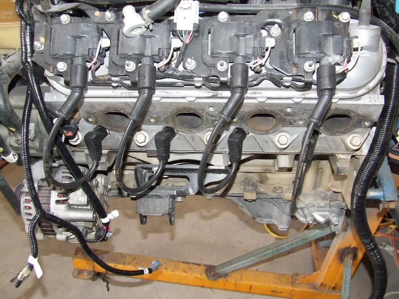

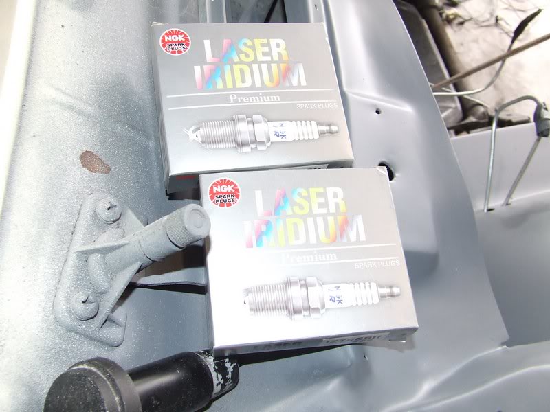

I also bought some fancy pants long life spark plugs.

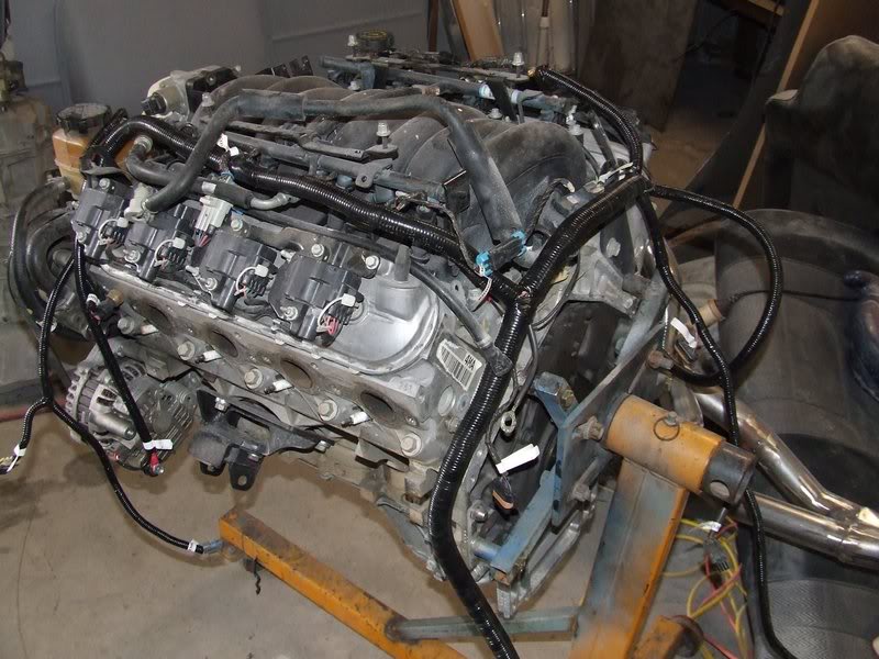

I refitted the wiring loom to the motor after it was modified by CAE.
I had custom spark plug leads made up to suit the new extractors.
