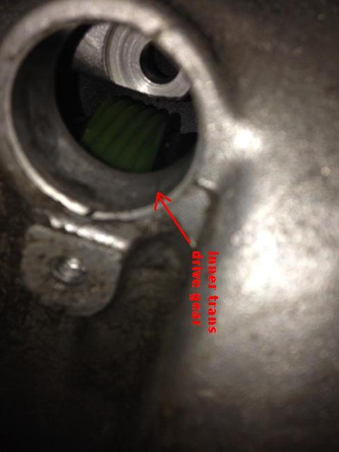

latest endeavors

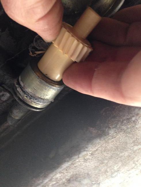

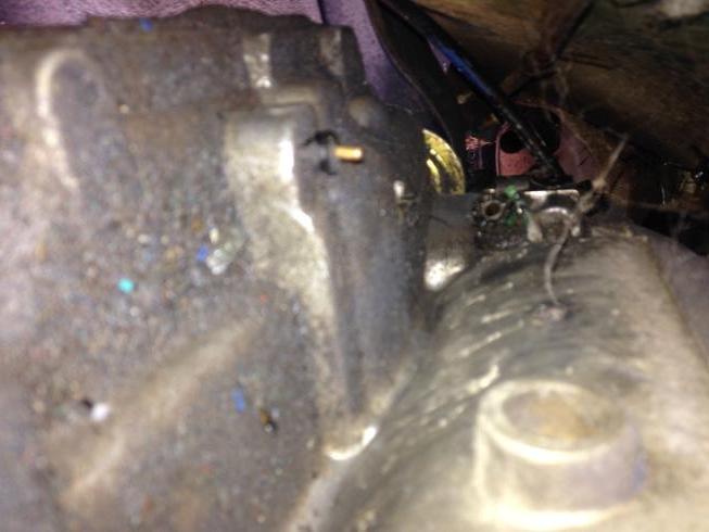

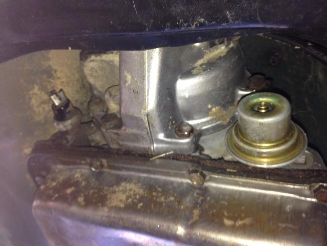

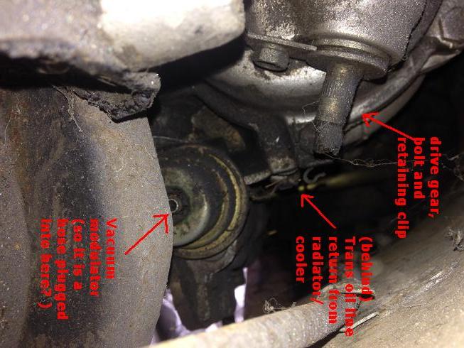

so.. the vac mod to auto tee on manifold plugs into here?
how does it stay on? (doesn't seem long enough to attach any clip/clamp)
and, andrew,
it's.... green! green???
added info, the old cable one was... white
what's green and my red in the kph matchup..?
or..
any chance the green internal to white cable.. is the "hundred k's/spot on" matchup??
(as the tops just pop off and can change. well, mine do at least)

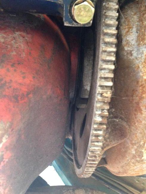

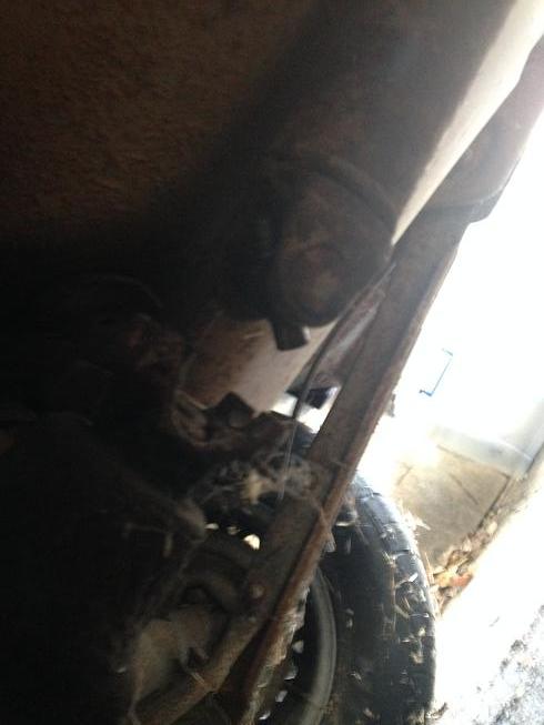

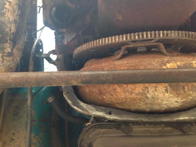

Disregard my concern over the torque converter bolts, I can see at least one nut and bolt is done up (and there's only 3 of them) so assume the other two will be done up as well.
Hmm... a green drive gear, well that's different! I've never seen any mention of a green drive gear for the Aussie boxes before, the only ones I have listed are:
Red - 7 tooth
White - 8 tooth
Blue - 9 tooth
Yellow - 10 tooth
The only green one I have listed is a 9 tooth gear for the American boxes (Muncie / Saginaw / Powerglide / TH350), I wonder if they fit and somebody has been playing with it?
Can you see in there well enough to turn the slip yoke by hand and count the number of teeth? You're counting the number of new teeth that start on one edge, you will need to mark one of the teeth with a texta or similar so you know where you started from.
If it is a 9 tooth drive gear, use your red driven (cable) gear, that should be close enough (works out to a reading of 103 when you're actually doing 100).

not a chance seeing in there sorry
camera jammed up into crevice to get that photo!
if am correct, going by the photo it's a ??6 tooth gear?
to get access to attach trans oil line.. i can put jack under yoke and remove crossmember and lower/drop trans a few inches can't i?
a good idea to install the missing engine mount bolts before i do? or not.
be hell getting to the return one without lowering, am suspecting.

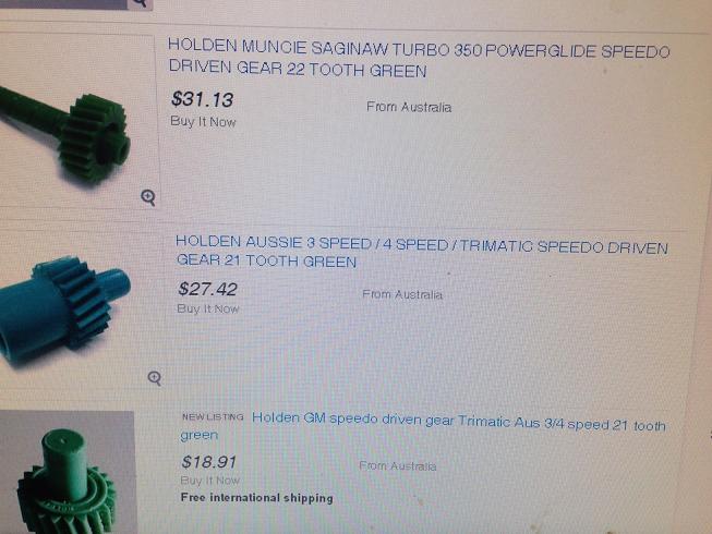

ebay says 21 tooth for the cable gear
internal.. still haven't found

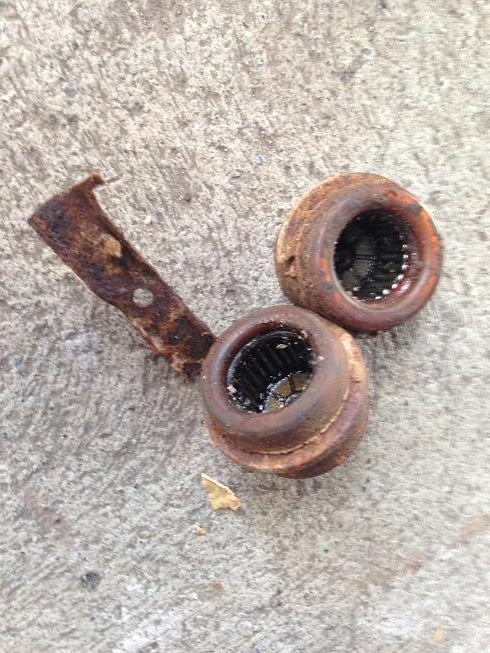

Those cups for rear uni will be ok as long as pins didn't fall out.
Green gear most likely commodore probably sle with 2.60 diff...will look it up if can remember where info is.
https://www.google.c...jJTTphx3JMnENew
Above link on right punch in tyre size,the drive/driven gears & diff ratio.
Yep looks like missing flex plat bolts too

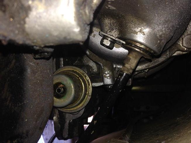

The nipple on the vac. modulator does not need a clamp to hold the rubber tube on , see how it has a raised area where the tube
pushes on ! , that is what holds the tube on , originally there was just a short piece of tube that fitted on to the modulator , the plot thickens , it was then connected to a steel line that led up to the fitting on manifold and connected by another short rubber tube.
They say you shouldn't just run a rubber tube all the way up because under full vac. the story goes that the tube will "choke off' and affect gear changes, how true it is i don't know ?
The oil cooler fittings are a pain to get to , they too were originally steel but i can't see too much of a problem just running a half decent
rubber line that will handle a bit of temp. up to a cooler , it does not need to be high pressure.

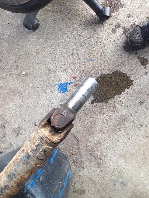

howdy gtr,
noticed in ebay ad i linked that uni's seemed different/beefier in the 8 version

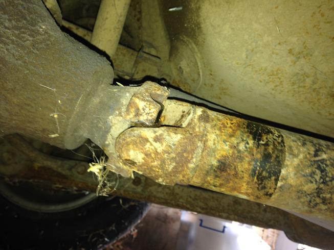

concern with my tailshaft is that it is a full 2 inch short of being long enough. it would slip in and then pull back to the diff,
but i fear the yoke would only be about 2 inches inside the trans, and not what seems about 4-5 needed.
(because on a 6 cyl the trans was further back?, hence shorted shaft)
can test it, as i don't think the trans is full of fluid. (might be? will find out soon enough)..and check seal groove worn in slip yoke lines up as you say.
(will clean as you recommended first)
don't know jack about uni's so will post a pic and show damage

flex plate has one bolt in tight doesn't it?
(i did well if the photo actually even shows the flex plate! ha!)

see what you mean about modulator tube,.. now that i cleaned it!
and get what you mean about vac hose, would have to have strong enough wall to not squeeze itself. will find out!
and, running decent rubber trans lines would be cheap and sweet as!

Eunuch it's missing fair amount of parts,likely vb 253 mixed with odd bunch of parts parts
Most trimatics have 3 bolts + nuts,high tensile things.

TBH always used 6cyl shafts to get driving cars driving although been years vaguely remember majority parts interchange so should fit when bolted in
Yoke probably goes in further than you think dont forget with suspension travel & drive movement it slides further in.

Think green gear is same 9 tooth as blue not much info found on them think green 253 sle trimatic(reason 15" rims) 308 sle(yellow gear) BUT not much info out there.

My guess is if green gear 9 tooth you'll need yellow 24 tooth gear with 3.36 diff & 245/60/14 tyre means 1% underdriven(slow) speedo

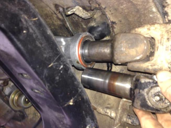

heya gtr, trying get info needed to make easier to judge, hope have ![]()
first, don't know about pins but the clip holding them on has broken and rusted
cleaned up to test
when pushed all way in..
rear comes up this short
and when pushed back to diff... as shown
it looks like this
again, with spare yoke for comparison
so, about 2 inches in, and 3 inches out (when resting on ground)

There is a fair amount of stuff that needs to be considered , firstly i would be cleaning everything up a bit so that things can be identified a bit easier ![]()
The slip yoke into the trans. as said needs some movement , can't remember off hand how much it moves when the diff. moves from one extreme to the other but it is not much (15mm max at a vague guess ?)
There should be 3 bolts with nuts that hold the converter to the flex plate (the toothed bit) , one is pictured but it would be wise to check that the others are there as well , they are not an ordinary bolt.

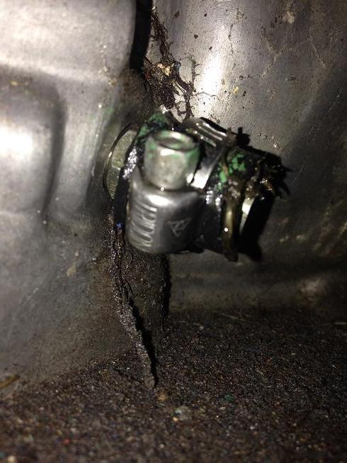

One thing that might be a little concerning is that the cooling lines were not plugged ?

Once you pop them cups back onto tailshaft then slip it back into diff add u-bolts 'probably' will be right one...you'll know as there groove worn into yoke over time will be close.
Kinda think it's correct...not sure wtf that metal tab is usually just the u-bolts & diff yoke holds it all together.
From pics mounts looked close enough....just pop cups back on that universal joint & bolt it up,no bolts tape it together either will fall apart or land on ya head haha

I think the metal tab was only a "lock tab " that went under the nuts and was bent up over a flat on the nut that held the U bolts to the yolk to stop those dreaded little factory lock nuts coming off for safety reasons ?
Edit, i think you will find that the 6 cyl. universal j's will be fine on a 253 with 336 , there are 202's out there making more than a stock 253 and they don't seem to have too many problems ?

gotta admit, you guy's are braver than i !!!
first, if movement is only 15mm ish either way, that leaves about 3cm left in shaft..??
now, this car setup is never going to supped up.. but is that enough grab?
and second.. if it pulled back 2 inches... and say.. fell out..
i am going to go ass over tit and on a heck of an exciting adventure.

will see if can get better look for the other 2 flex bolts
cooling lines not plugged..
don't jinx me eunuch!
(and yet, not optimum, for sure! blocked would of been better to see for sure.)

and
"only a "lock tab " that went under the nuts and was bent up over a flat on the nut that held the U bolts to the yolk to stop those dreaded little factory lock nuts coming off for safety reasons ?"
i'll say safety! cus at the moment they just fall off! can't be right can it???
fear needs to be "pressed"?? out and replaced??
