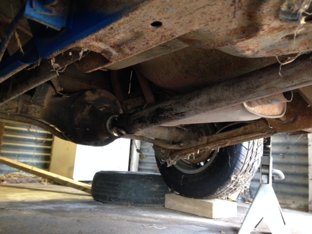

I really shouldn't even mention this since you're already running around like a head with it's chook cut off but...
I just spent the last hour or so going through Hardy Spicer catalogs looking for a conversion uni joint from 6 cylinder to V8, but it just wasn't meant to be. Still, it was an interesting exercise!
All Torana 6 cylinders take a 17R series joint, whereas all Torana V8's take a 2R series, both have the same diameter caps (25.4mm) but the 17R is only 43.64mm circlip to circlip, whereas the 2R is 59.53mm.
They make five different conversions from the 17R series, and ten different conversions from the 2R series (including Holden V8 to Ford 9"), but there's none that even come close to converting from a 6 cylinder diff to V8 tailshaft. I guess the difference in strength must be too much?

 "spent the last hour or so going through Hardy Spicer catalogs looking for a conversion uni joint from 6 cylinder to V8"
muchos gracias for effort and trying andrew!
am starting to think people who have done this conversion just drive around with a six barely sticking in the trans.
(..or replacing rear of diff to an 8/bigger and then able to use v8 tailshaft?)
re: "17R is only 43.64mm circlip to circlip, whereas the 2R is 59.53mm."
hmm, so cant fit standard v8 tail in my diff end(with 6cyl u-bolts), and just call the excess coming out the sides "overkill"??

 ~ and just call the excess coming out the sides "overkill"??
No I wouldn't recommend it!
Yes the proper way to do it is to swap the yoke on the diff for a V8 one and use a V8 tailshaft, correct length, correct uni joints, all good.
How have you got the car jacked up at the moment? If you have axle stands under the diff then the rear suspension is somewhere near ride-height, but if you were to jack up the body and let the diff hang down, then the 6 cylinder tailshaft may well just fall out of the transmission?
That would be bad, like major damage bad if you're driving down the road at the time, at the very least you would likely bend the tailshaft and flog the hell out of the floor, and that's if you're lucky!

"Yes the proper way to do it is to swap the yoke on the diff for a V8 one and use a V8 tailshaft, correct length, correct uni joints, all good"
never done before, shock horror!
as easy as changing a spark plug..?
car is jacked on two stands, about a third from front.
now... it would be GREAT if i dropped on floor and found yoke went an inch further in
..and
then i jacked up rear... and let diff/wheels hang...
and found yoke about as in as is now
could get away with that maybe..
though,wishful thinking i suspect ;)
anyways, for another day,
as gtr said, just use as test tailshaft for now, fix later.

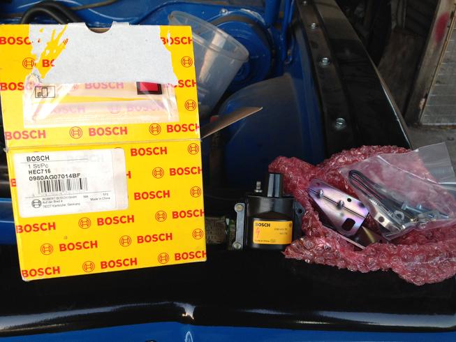

got my coil for my hei dizzy
not going to even attempt fitting by myself till have someone next to me making sure "top dead centre", from what i've read anyways

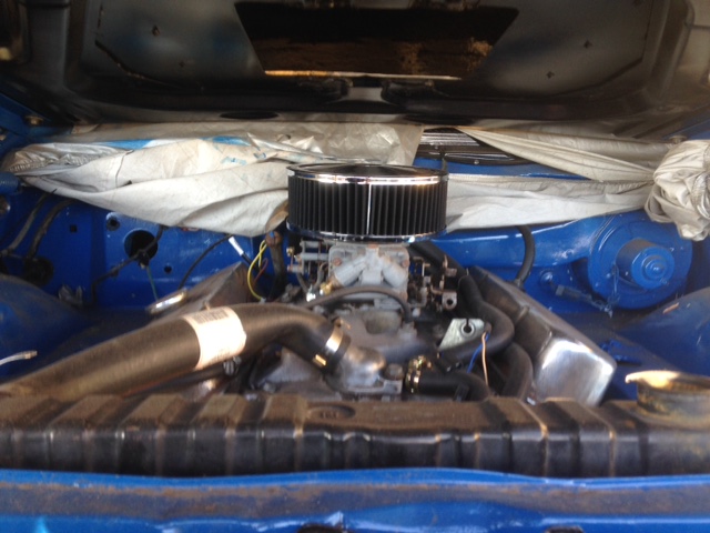

heater hoses chopped and lowered.
and a brandnew wiring harness, as my "6" was old and tattered.
got the "post poll" one, just in case need later.
as you can clearly see... i don't have a clue what the wires are for basically
the 9 has been run thru engine mount to starter
as for "7".. there is no "7", oops!

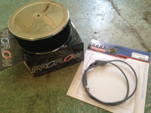

9 x 4 ich air filter and accelerator cable goodies.
(am going to buy the taller 5inch with open top at later date)

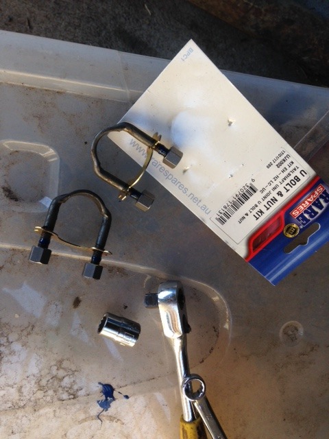

Posted 19 April 2017 - 03:51 PM
6cyl shaft ubolted in,
will get the 8 another day/paypacket
(i now have the v8 diff yoke standing by thanks to a gmhtorana member!)
