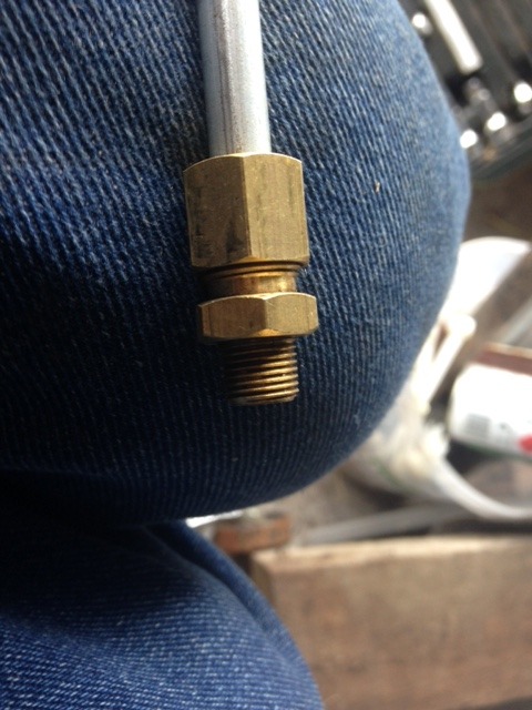

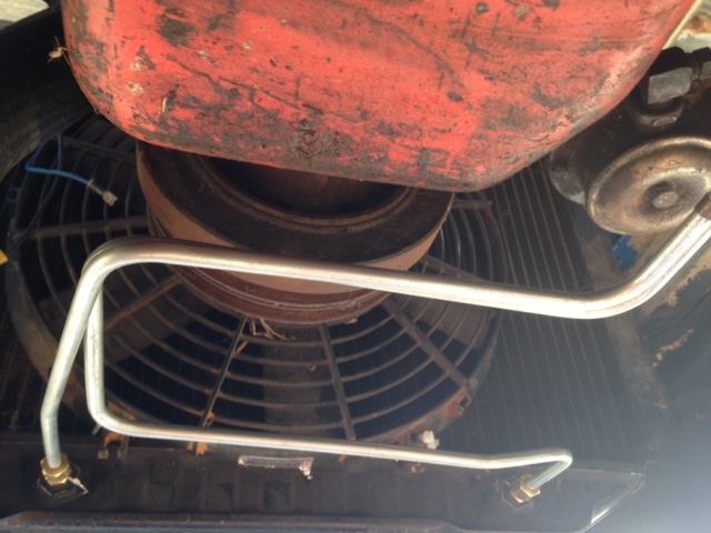

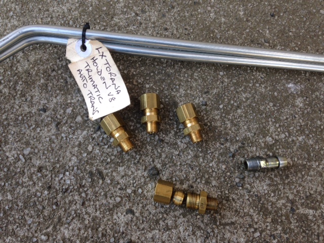

went to pirtek for help with auto trans lines "adapters"
said frOck those ends off, chuck these on.
so bought 4, and did.

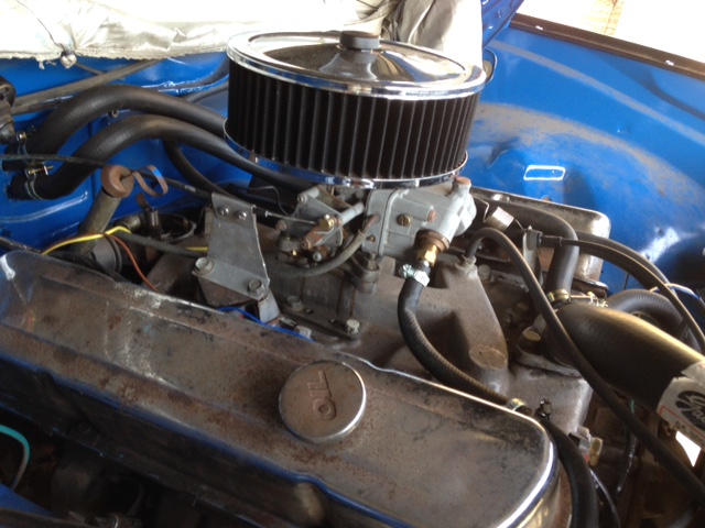

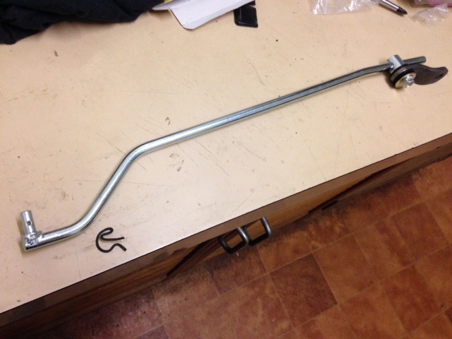

my accel cable, mount, and scrap spring fitting
and my fabrication work for a choke cable holder.
(i ain't great at it, BUT still.. i find fabrication fun to do. i might be alone there.)

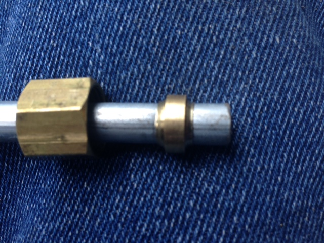

#478 _livo74_
_livo74_
Posted 19 April 2017 - 04:02 PM

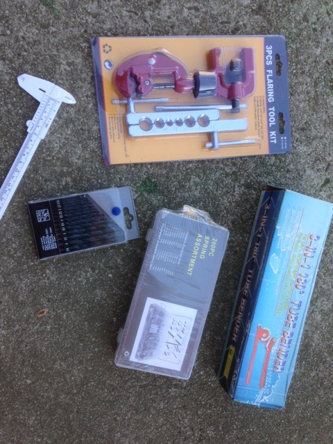

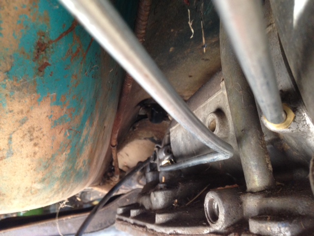

bought the pipe bend/flare stuff as a whole package for about $40 off ebay delivered.
going to attempt making own pipe from manifold tree to modulator. will be interesting.

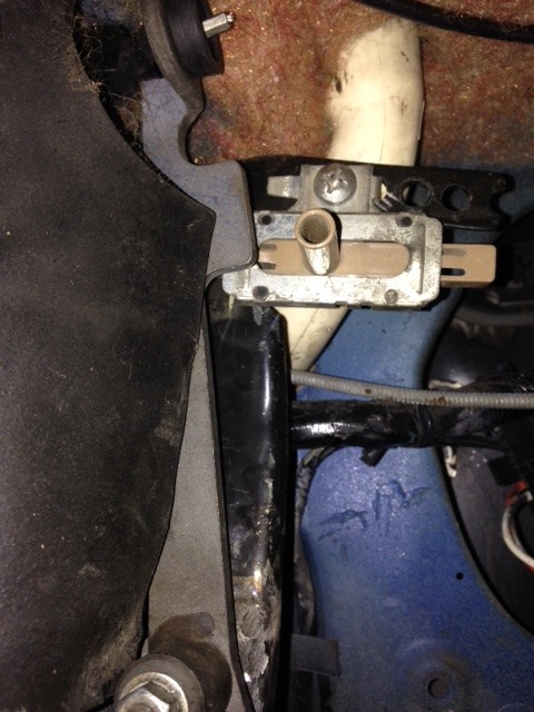

Posted 19 April 2017 - 04:07 PM

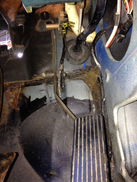

got kick down off ron, so this is now in :)
cheers ron!
needed some bending/welding to match the lx

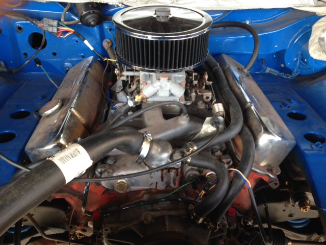

What model is harness meant for & is it for points dissy???? Be easier to decipher
Purple wire should be solenoid starter
1 Coil most likely..guess yellow is (positive) & brown (negative) for hei have to join 2 wires at ignition switch for 12v starting
2 Blue? unsure maybe idle solenoid or something
3 brown wire looks like alternator charge light
4 Green water temp sender
5 & 6 Tan & blue no idea unless for rochestor car
7 LOL
8 Blue Oil pressure sender
My 2 cents guess
Got to do trans lines like yours eventually except short section of rubber line to allow for engine movement.
Edited by gtrboyy, 19 April 2017 - 07:17 PM.

heya gtr,
cheers for info!
i explained to seller wanted for hei upgrade.
here's hopin'!

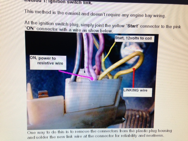

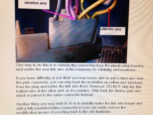

fortunately, came across info of how to send 12v to dizzy, i think, in easy to follow picture form
1, agreed, coil
2. figured too for post poll or different carb
3. thought alternator.. which still yet to buy
went to pickapart for my mum,. and also had a look for a v8 vn-p 85 amp alt while there.
whoda thunk they didn't have one! hahaha not a v8 in sight.
4. water temp. so have put it on fight point, i gather.
5 and 6 are a puzzle. expect is more post poll that i don't have.
8. in right spot then. excellent.
and my max elery torana book is a joke.
has a few wiring diagrams, hard to read a none for an 8cyl.

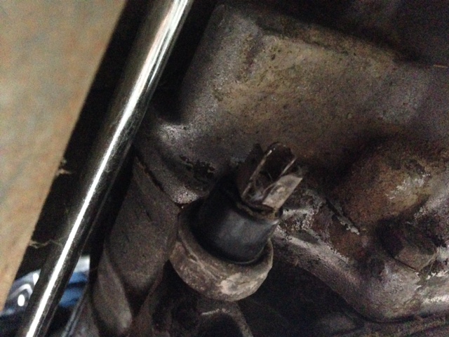

shift rod and selector plate fitted :)

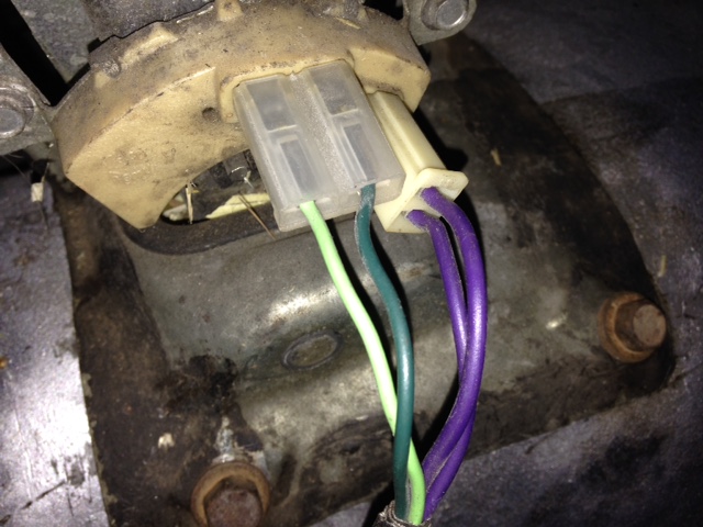

can't read wiring diagrams for shit. darn it.
tried googling images of peoples shifters to see if plugged correctly
as for these.. i don't have a clue where they go.
do they go here??
"Reverse switch", i believe it's called.
connections don't seem to match up from what i can tell
Edited by livo74, 30 April 2017 - 10:55 AM.
#488 _livo74_
_livo74_
Posted 30 April 2017 - 11:03 AM

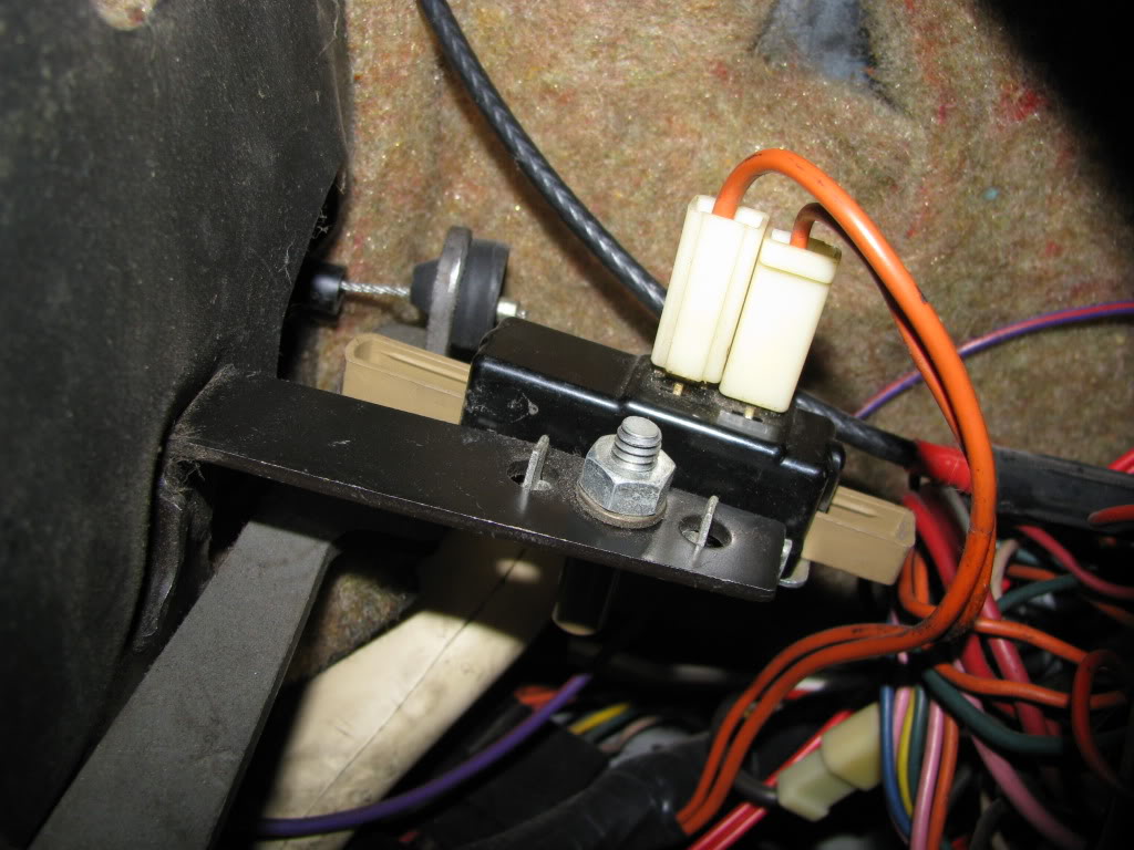

and.. i take it i send one end of orange to here to "kickdown" on trans
below is a photo off site of anothers car with wiring done.
theirs seems to be original wiring setup...
so as mine was a manual.. i don't have this on my car.
1. is the wire towards front of ccar "power in" and towards rear "power out"?
2. and, do i tap the orange "power in" out of any of these wires??

Posted 30 April 2017 - 07:36 PM
Purple for inhibitor/starter
Greens for reverse lights
Orange is kickdown -pedal to probe thing side of auto,shouldn't need to tap wire...I'd leave4 it alone!!! Later on can check with test light if got acc power then push pedal down both will power test light.
Grey is illumination light globe for selector panel
#490 _livo74_

although now thinking.. as car was originally a manual i am not going to find ANY ports to plug those into.??
auto elec may indeed be necessary.
and that pick is not of my kickdown. it is someone else's.
was just adding a pic of it to show what needs to be done, and asking for any info of how to achieve with mine. (as in where to tap power from to send to kickdown on trans)

Should be simple plug change from auto to manual...usually manual cars have small bridged plug for purple starter wires you unclip then add small auto harness that has purple wires to inhibutor on tbar,the revers light wires & grey wire for indicator light.
Kickdown wire + earth thing are usually left clipped to auto,rarely taken off.
You got some more searching & parts tracking to do methinks to find out what's needed.
