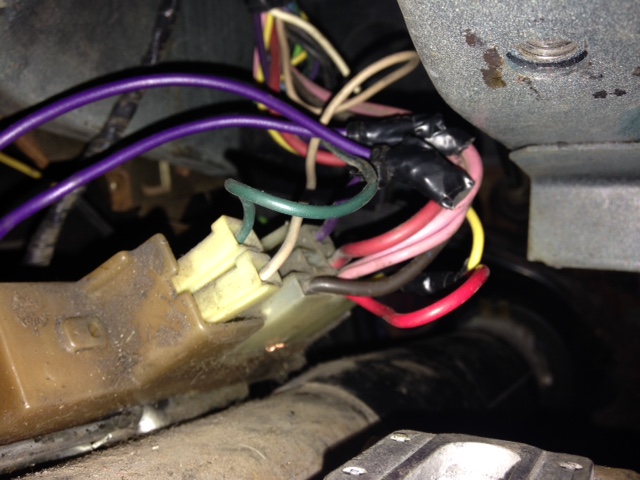

Posted 15 May 2017 - 04:24 PM
no blurring together for me, that's for sure!
___________
see that wasn't so hard was it!? ;)
much much much appreciated everyone!
i was WRONG, turns out these connections were compatible
so, reverse lights DONE.
console light, DONE.
inhibitor switch, DONE.
dash, back on.
massive cheers all!

~ as for "hook up battery".. car didn't come with any of that cabling, so have to put some scraps together from an ef falcon battery leads and terminals.. or start from scratch. ~
Does your engine have the steel tube that runs down the side of the block to the starter motor?
If so then your thick battery positive cable runs from the battery (+) terminal, through that tube and connects to the outside "bolt" terminal on the starter solenoid. The purple starter wire from the engine loom also runs through that tube.
You may also need to run a not-quite-so-thick red wire from the "bolt" terminal on the alternator back to the battery (+) terminal, unless that was included in the wiring loom you bought, I can't remember?
This wire should have some kind of heavy duty fusible link in it too, rated slightly higher than whatever your alternator is rated at (so 100 amp alternator requires say 120 amp fuse).
Then you need a thick earth cable between the battery (-) and the engine block, just make sure to scrape any paint, grease, oil or rust off before attaching to the block so it makes a good contact.
Lastly you need an earth from the battery (-) to the body, this one is important because it will earth all the lights, heater. stereo etc., if you don't have this connected all kinds of strange things happen!

Purple wire to the male spade fitting. The idea of the metal tube was to protect the wires from exhaust heat, so you will have to watch where you route them.

By the looks of it, that loom you bought may have a big red alternator wire already included (the one with the fusible link)?
Can you confirm that the wiring loom has a thick red wire at the alternator already? If so then you don't need to add another, but I would be pulling it out of the tubing and running it direct to the battery rather than the starter, no sense exposing more wires to the exhaust heat if you don't have to.
Hard to find a definitive answer on the rating for the fuse wire, but one website I looked at says 1mm2 is rated at 160 amps for 30 sec or less, or 270 amps for 5 sec or less, if that's accurate then I'd say it should be okay with an 85A alternator?
With that purple starter wire, it connects to the blade terminal on the starter solenoid. I can't remember exactly but I'd guess it's the single terminal at the top (number 1 in your photo)? Doesn't matter if it's wrong anyway, it won't hurt anything, just swap it to the other terminal if the starter doesn't work.
EDIT: I forgot to say, make sure those threaded battery hold-down rods don't hit the bonnet when you close it? They look pretty long.
Edited by Bigfella237, 16 May 2017 - 06:39 PM.
it has bloody 3 male spade fittings, just to be tricky!
as andrew says below, possibly top one to give a go first.
and.. will now be careful where running wires, away from exhaust, cheers laurie!

Posted 16 May 2017 - 07:00 PM
Should be fine with that fusible link...most are tiny anyway.....it's main purpose is to blow first to protect wiring harness
I'd try position no.1 on that funky old starter ...can test it anyway with wire from battery to each spot..whichever gets it to spin is the winner.
Cable from alternator to battery is fine for 85A...only if you go bigger alternator you need beefy cabling.
Factory metal that battery cable runs through is simplest/easy way to fit but I have fitted them through engine mount or along sump with p clamps when hiding wires.

heya andrew,
no red on my new loom to alternator, only the brown.
so going by what you said initially, and also the "lx wiring diagram" i added,
i do need the "thinner" red from battery to alternator,
and the thin "fusible" (from engine loom) goes to the starter, along with the purple..
from what i can read from diagram anyways! lol
__
and your checking out of fusible ratings sounds good to me!
Edited by livo74, 16 May 2017 - 07:04 PM.
so i do need the "thinner" red from battery to alternator,
Yep, looks like you will need to run your "thinner" red between the "bolt" terminal on the alternator and the battery (+) then after all.
Note that this wire should have a fusible link near the battery as well (although I've seen people do it without).
I know your loom was designed to have that fusible link connected to the starter, but I'd say that's mainly for cars with the battery in the boot, with your battery up front I would definitely be connecting that fusible link to the battery itself.
That wire powers EVERYTHING in the car, if it melts from the exhaust then you're stuck where ever it happens!

Whether that red wire/fusible link goes to the starter or the battery doesn't make much difference, it's connected to the positive power either way.
I'm just saying it's pointless to risk running it past the exhaust if you don't have to.
#545 _livo74_
_livo74_
Posted 16 May 2017 - 11:25 PM
am happy to run it to battery, better safe than sorry later that's for sure. but means will have to chop off the protective shroud that protects the purple as is. oh for a factory pipe!

According to diagram fusible link is 12v ignition power...instead of at battery terminal like later holdens it's at starter...earlier models are worse they have it at dash switch
black fusible link to starter
purple to solenoid     <^ these 2 go up engine to join body harness
Thick red from + battery terminal to starter stud
Thinner red follows ^ to head then goes left across engine to alternator stud
Brown wire (alt charge light) goes back across engine
Green,blue & brown wires together run along manifold/rocker cover to join body harness.....google image factory engine bays you'll get the idea.
Yes still agree 85A is  good value...just hurting for when I buy bigger alternator lol
have done as much as can,and what are saying have done some,
will be fitting off starter wires tomorrow.
