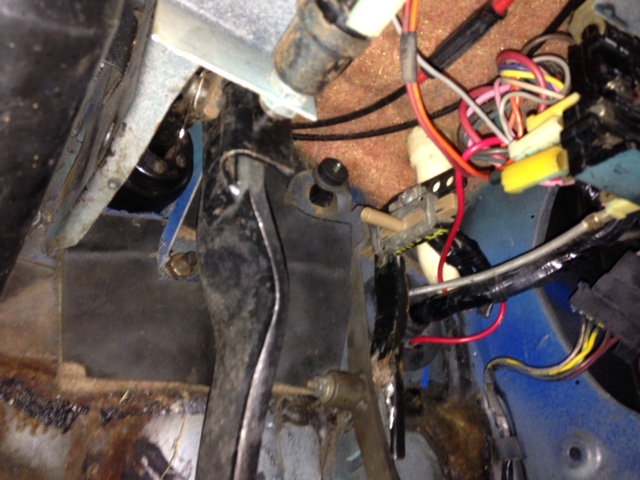

I'd just changeover that whole assembly (in the second pic), the steering wheel has to come off either way.
and why has the switch got three plugs, and only two used?
It's just the type of microswiitch they used, the middle and one end terminal will be connected in the up position, whereas the middle and the other terminal will be connected in the down position, which isn't needed here.

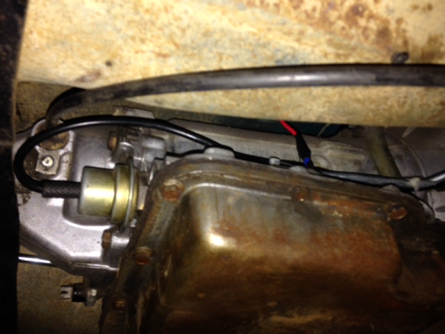

kickdown and modulator hose (temp till get 4mm tubing to bend. )
kickdown
#582 _livo74_
_livo74_
Posted 28 May 2017 - 11:56 AM

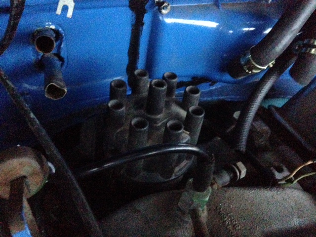

modulator hose and new dizzy in, (care of my neighbor who gave me hand fitting control arm bushes)

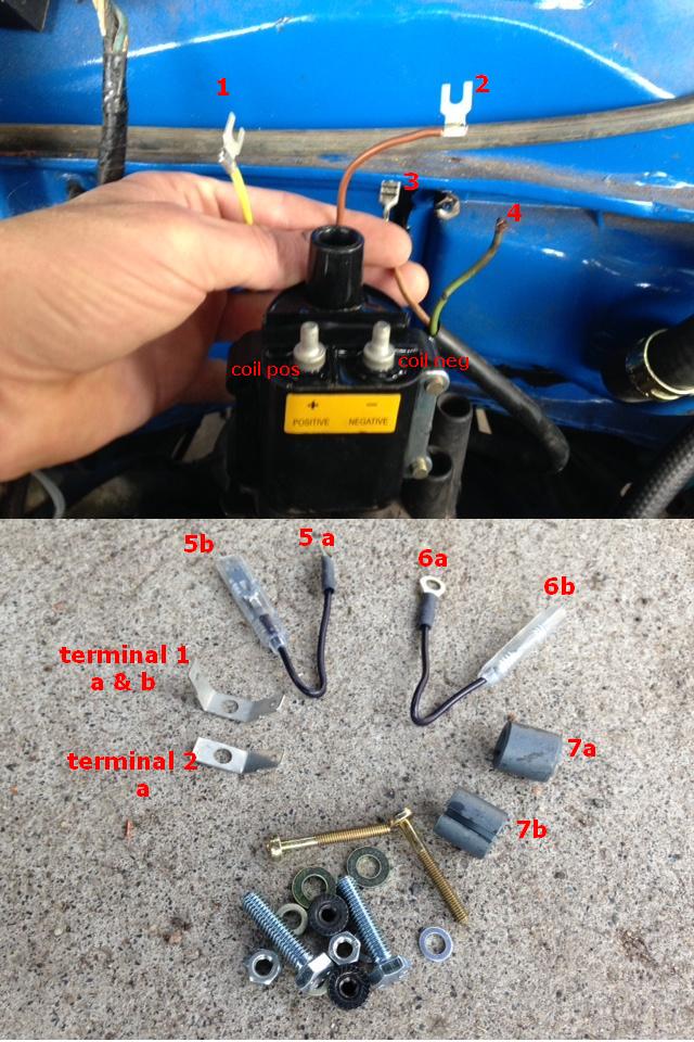

if anyone knows how am supposed to hookup hei coil would be tops!.. no instructions came with it to help
will do some more searching for examples of setups in forum

so far from what have read i think i understand it to be No1 & 3 go to Coil + , and 2 & 4 to coil -
although in some threads people talk of red wire.. and i don't have a red coming from the dizzy. have a brown.
bit more research before attaching i reckon!
Edited by livo74, 28 May 2017 - 11:23 PM.
#584 gtrboyy
gtrboyy
  • 3,265 posts
  • Location:SYDNEY,NSW
Posted 29 May 2017 - 12:05 AM
My brain is a bit fried from fixing moo mang at moment so double check.
Brown is rev tacho..negative
Green from dissy to negative
Yellow is power from ignition switch...positive
Pink/tan from dissy to positive.
Usually have radio suppressor/capacitor thing on coil postive too.
Red wire probably be 12v to ignition switch
You get L bracket for coil to bolt it to manifold?

Cheers gtr, will try to double check also but seems to match info I found for 4 of the wires👍
Only, I don't have a Red wire that you mention,
And no radio suppressor wire, I think.
Will look into

And I do have the L bracket 👍
