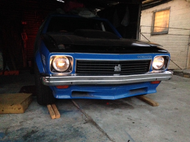

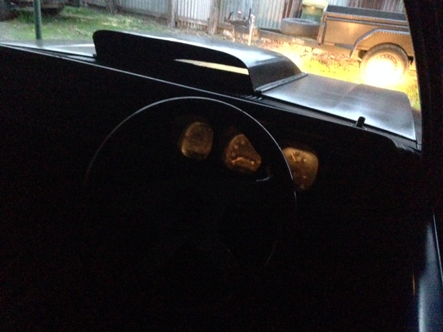

so, have asked the old bloke down the road who helped me press in the bushes etc.. to give me a hand with dizzy. brave?? not really, but can learn while assisting. hope to do timing too, at some stage.. goodness willing!
and, this is something I"VE NEVER SEEN BEFORE
it's alive!
nevermind the fact the brake lights seem permanantly on, one side not working at all
indicators don't work,
instrument panel individual lights don't seem to work at all
and..
few things i didn't notice.. that weren't working either.
*no alt hooked up, no brakes hooked up, and think will have to recheck my (entire) wiring effort/guesswork
----------edit: just re-looking at photos..
think my brake lights come on with the high beams.
Edited by livo74, 25 May 2017 - 08:46 PM.
#555 Bigfella237
Bigfella237
    Socially Distant
  • 4,396 posts
  • Name:Andrew
  • Joined: 31-October 14
Posted 25 May 2017 - 09:45 PM
With no alternator you won't get the charge light come on with ignition on.
Without the brake fail switch connected (on the proportioning valve under the bonnet) you won't get a brake fail light, although the hand brake (err... foot-hand brake... err... park brake, that's the word I'm looking for) light should still come on with the ignition on, and park brake set of course.
If the blinkers don't work, I wouldn't expect the turn signal indicators on the dash to work either.
Does the blue High Beam light come on at least?
First the easy fix (hopefully), this is the brake light switch...
...to start with, just disconnect one of the wires and the brake lights will hopefully go off? If you don't have the brake booster installed yet then there's nothing to hold the pedal up, therefore the brake lights are on. You may need to adjust this switch later (it screws in & out) but I doubt it.
But while the brake lights are stuck on might also be a good time to find out why only one works (may be just a blown bulb, may be a dodgy earth, or a wiring fault, or a corroded bulb holder, or...)?
Blinkers would be next on the list, there was a thread about them here recently:
http://www.gmh-toran...rs-not-working/
Although the OP never responded so it didn't really get too far, but the reverse light trick is a worthwhile starting point, especially since yours should now be working?
#556 _livo74_
_livo74_
Posted 25 May 2017 - 10:10 PM
much appreciated info and effort andrew
"no alternator you won't get the charge light come on with ignition on."
gotcha!
______
"Without the brake fail switch connected (on the proportioning valve under the bonnet) you won't get a brake fail light,"
 gotcha! (is not plugged in.)
_____
"park brake light should still come on with the ignition on, and park brake set of course."
park brake is not on.
..might have something to do with me snapping the handle off two years ago when brought car home and didn't know how to release. yep.
____
blue high beam on dash...
no.  insert frowny face.
_________
"easy fix"
insert optimistic hopefull face here.
."..to start with, just disconnect one of the wires and the brake lights will hopefully go off? If you don't have the brake booster installed yet then there's nothing to hold the pedal up, therefore the brake lights are on. You may need to adjust this switch later (it screws in & out) but I doubt it."
brake booster is installed. "installed" by me.. that is.
(not hosed up or anything.)
will disconnect wire you've highlighted to see if turns brakelights off.
and then change bulbs, check for corrosion... then assume my wiring is going to cause t-rouble.
______
"blinkers work with the IGN key in either the accessory or ignition positions, reverse lights work only in the ignition position."
HAVE turned key to accessories,
but not turning to IGNITION right now.
(spark plugs aren't in, dizzy not connected, haven't primed engine etc.. and
aren't sure how many turns before turns starter motor)
will look into when can turn on ignition and will follow your advice in thread
:bowdown:
_________
edit: a couple of fuses appear blown, just realised. will buy set and fit all new ones also.
Edited by livo74, 25 May 2017 - 10:15 PM.

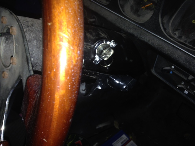

What else... Oh yeah, the ignition switch...
The only position you can remove the key (in a working barrel) is the "LOCK" position, so starting there...
With the key in, turn the barrel backwards (anti-clockwise) one click to get the "ACC" position (actually, you may be able to do that without the key, but I'm not 100% sure if I'm thinking of the correct model)
Turning the key forwards (clockwise) now, one click gets you back to "LOCK"
One more click gets you to the "OFF" position (the steering wheel should also be unlocked now)
One more click gets you to the "IGN" position
And one more spring-loaded click is obviously the "START" position
I don't see any problem with just clicking the starter very quickly to confirm the motor turns over, just don't wind it over and over without all the oils & fluids in.

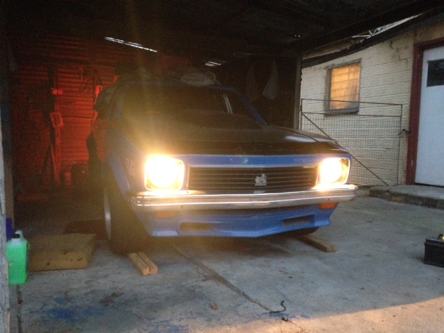

Posted 26 May 2017 - 06:15 PM
heya andrew,
knew meant disconnect one of the "brake switch" reds,
did it, and lights went off.
also... pulled brake pedal hard up against switch... and it went off.
yay! (may have to adjust when have "plumbed" brake lines etc)
went to repco, only sell fuses in bulk and as am broke will wait till wednesday to buy few sets to replace all.
as for "wedge bulbs", he asked what ones.. and i said don't have a clue.
will take apart dash and buy replacements on wednesday too.
same goes for ALL bulbs in car.
________
know NOW, about twist n pull for park brake. didn't then, hence oops.
(mine didn't have the better" twist n pull" logo for learners.)
was wrong, brake lights don't get brighter when i turn on the headlights. (twas optical illusion/camera playing tricks)
... but, found i don't have tail lights at all. only brake lights.
thankyou for info on the turn of keys steps.
had no idea.
still.. am NOT brave enough to turn to "start"
will wait till have few more things connected and primed.
and come to think of it, my heater lines are disconnected so as to make room for dizzy removal/install
hope to be doing over the weekend.
(although.. have bought some fluids. EXCITING! A FIRST!
coolant and 20-60 oil with ??zinc"
repco guy said might be good idea. )
after have changed all the bulbs, will go and check all connections aren't corroded and give a good scratching

Posted 26 May 2017 - 08:33 PM
I reckon it's got some dodgey earth issues & maybe flasher can.
Handbrake you'd need to check at switch to see what's going on.
If it was blowing fuses then that be nasty
I'd rather be fixing that torrie than vp ute just bought for a grand with every common fault bombadore of that era have
#564 gtrboyy
gtrboyy
  • 3,265 posts
  • Location:SYDNEY,NSW
Posted 26 May 2017 - 08:46 PM
Had an lx once if you moved fuse box slightly all rear lights came back on
Highbeams might be floor switch if not at blinker on these(cant remember tbh)
Fuel gauge find (brown wire) earth to shell..if gauge goes to Full all good
Some of those bulbs might just have dirty connection from rust/junk/dust/moisture or whatever..sometimes just unplug & plug action can be fluke fix..
Remember car has not been used or anything turned on in years,don't be afraid to muck around with it.
For first fire up I'd just I'd just use tap water,fix leaks & flush out gunk that might still be in there...also cheap oil in right grade is fine,flush & change later like water.

With the headlights off, lifting the stalk will "flash" the high beam, but only while you hold it on.
Turn the headlights on, and now lifting the stalk will (or should) change from high to low beam and back again every time you pull the stalk. Hopefully your little blue high beam indicator does work after all?
One small caution... just something to bear in mind really... the high beam always comes on whenever the stalk is pulled toward you (that's to "flash" other drivers as earlier), so when changing from low to high beam it is possible to have both high and low beams on at the same time, it's actually supposed to do that so the lights don't go out altogether when the relay is changing over. Normally this is only for an instant and doesn't hurt anything, but if you hold the stalk up for a long time it can burn out the bulbs?
BTW, turning the headlight switch while the lights are on should dim the instrument panel illumination (including the centre console "PRND21" if you wired it up right).

my column is from an lh ..going by the texta writing on it.
so i have neither switch, i sadly surmise.
yup

on bright side, twisting switch does dim,brighter dash illumination!

Bummer on the LH column, didn't even think about that. So do you have an LH wiring loom or an LX?
You will need to get the stalk switch assembly from an LX, it's an easy changeover but the steering wheel will need to come off again. Three screws hold the switch assy to the "coffee pot" from memory, then just feed the wiring down through the column.
Providing you're using an LX wiring loom, otherwise you need to splice in the wires that used to go to the floor switch?
EDIT: Actually disregard that question, if you had an LH loom without the floor dipswitch connected then the headlights wouldn't come on at all.
