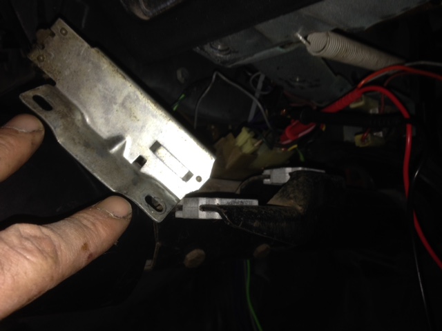

#611 _livo74_
_livo74_
Posted 03 June 2017 - 02:49 PM
(oil light dims and then goes off after about 5 seconds of cranking over.)
#612 _livo74_
_livo74_
Posted 03 June 2017 - 02:57 PM

Posted 03 June 2017 - 05:04 PM
It's all fun, I actually don't mind wiring... well except for when you have to lay on your back on the floor with your head under the brake pedal and your arm jammed up under the dash that is!
With the blower fan... start by turning it on (I think it works on both IGN and ACC) and check for power at the connector in the engine bay where it goes into the fan motor, one wire will (or at least should) have power on one speed, and the other wire on the other speed.
The slower speed is actually achieved by that curly (yellow?) wire on the fan connector having more resistance than the straight wire.
If you have voltage at that connector on both speeds then you may need to pull the fan motor out and check it's not blocked up with leaves and crap?
hmm, now my car only turns over in neutral, but not in park.
The inhibitor switch likely just needs adjusting as well, just loosen the screws and slide it back or forth, checking it works in both park and neutral, but obviously not in reverse or drive.
I know you haven't fitted the correct oil pressure switch but it sounds like you're getting oil pressure up okay then?
If you have a tail light coming on instead of reverse then that's a typical sign of earth problems (one bulb can't earth back to the body so it earths back through the other bulb's wiring).
#614 _livo74_
_livo74_
Posted 03 June 2017 - 06:44 PM
cheers andrew!
will check for power on fan to see if fan is the culprit.
didn't realise (read:look/notice) that inhibitor is adjustable.
mmmmight.. be that. as in too far backward (by 3-5 mill)
when in neutral it has to be jammed tight up towards reverse.
will check.
oil sounds good!
and, had lights on, so was expecting tails,
but when checked five seconds before i had both reverse lights.
i swear.. turn my back for just one second..!!
will do a thorough check of wires and connections.

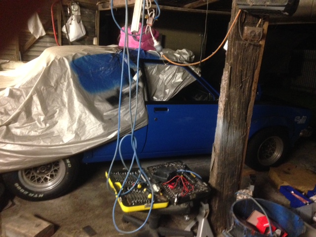

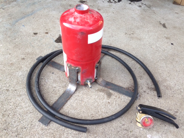

#621 _livo74_
_livo74_
Posted 04 June 2017 - 01:06 PM
checked, have power at fan, both. and ground seems good.
sooo.. will take apart fan an have a squiz inside.
and my latest garage addition. fancy!?
#622 Bigfella237
Bigfella237
    Socially Distant
  • 4,396 posts
  • Name:Andrew
  • Joined: 31-October 14
Posted 04 June 2017 - 01:37 PM
Don't tell me you did all that just for a temporary fuel supply?
#623 _livo74_
_livo74_
Posted 04 June 2017 - 01:41 PM
I said fancy! Hahaha

#625 _livo74_
_livo74_
Posted 04 June 2017 - 03:13 PM
most people aren't desperately trying just to pass the time till ufc 212 starts, i sure was.
(well done max! Go conor!)
and took out fan, bench tested, worked fine, put back in, worked fine.
anyways, now have a working two speed fan!
