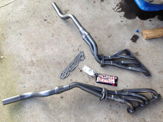

Posted 15 June 2017 - 06:09 PM
think they were wrong way round in pic . just plonked together to show length
anyways, test fitting seems good thankfully
length gets to half way of the trans mount plate.
on to the drivers side tomorrow.

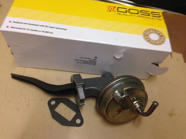

goss hi-flow mech fuel pump is in the mail, as mines shat itself. got it for $110. asked repco for a price first.. they said $240
so... didn't go with repco.

Not a bad looking pair of extractors, although the trick is making them fit with the steering coupling on the driver's side.
You could've just bought a rebuild kit and done your original fuel pump for about a quarter of that price, not all that hard to do, getting the "peened-in" valves out is about the only tricky part. Anyway, doesn't matter now I suppose.

thanks andrew! hadn't seen anyone else using them in my searches, thought would give em a try. liked the length.
had read drivers side can be a bitch. not looking forward to it, but hopefully goes ok.

as for pump, was pretty happy being able to get hi-flow for $110, so am not complaining.
much cheaper for rebuild as you say, which i was unaware was option too. live n learn.

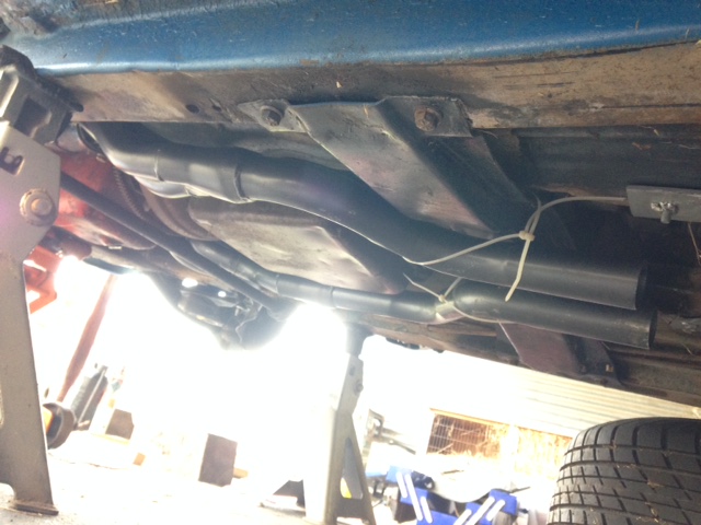

Posted 18 June 2017 - 11:46 AM
done.
fun to install?
no. not really.

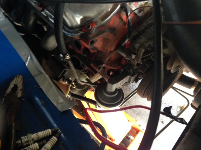

Posted 20 June 2017 - 04:42 PM
suspect is a good thing i elec taped up the coil and haven't hooked up any leads.
now, i don't know what the hell i am doing, but i don't think that was good to see.
rebuild needed i can only gather at moment. will do some research

Nah probably just a stuck needle & seat, not surprising really. Just give that adjustable nut looking thing on the top of the fuel bowl a couple of taps with the handle of a screwdriver or something soft, it may unstick itself?
Or maybe your fancy-pants fuel pump has too much pressure?
Or maybe the float... err... doesn't, which is not uncommon for old Holley carbs?

Posted 20 June 2017 - 06:15 PM
don't know how fancy it is as only cost $17 more than the stock brand one.
bought it as the threads i looked into said holleys need between 6-7psi, so bought it.
will try your tapping idea first. much appreciated.
as for it being an un-float, will look into.
obviously expected some sort of dilema, as carby is old and sat unused for ...??years

Posted 20 June 2017 - 07:04 PM
Stuck needle & seat...probably old fuel residue gummed up.
Grab 2 screwdrivers play drums & get all tappity on it around float bowl..
Big screw on side near next fuel line is sight level...unscrew that if fuel keeps pissing out float too high.

Posted 20 June 2017 - 08:29 PM
cheers gtr, will do as you and andrew say,
although you made it more of a fun experience lol
and.. will check level, gracias!
#641 _livo74_
_livo74_
Posted 21 June 2017 - 02:49 PM
thanks fellars!! (took the beat of "kickstart" to get freed up ;) )
first time i checked float bowl, came flooding! out
now, just a dribble
cheers!

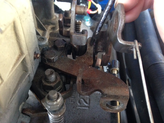

checked for squirting as you advised andrew
acc pump not ... great.
for a start, seems it's jammed down.
so i slackened off a bolt/spring at REAR that stops acc lever going backwards/releasing to give it  "play". done.
acc pump STILL jammed down tight. (??)
so i loosened acc pump spring and pushed to side
pressing up and down on acc pump lever has no "pressure", freely moves. too freely ..i guess?
(as well as slightest drips of fuel leaking from gasket)

#649 _livo74_
_livo74_
Posted 22 June 2017 - 10:17 AM
have just been learning about "acc pump cams"
wondering if mine st FAR too high? as in cam really jamming too early
doubt it. but what's causing pump lever to be press fully down even when no throttle being applied.
aargh.
my $100 second hand holley.. might not be worth $2
#650 _livo74_
_livo74_
Posted 22 June 2017 - 10:39 AM
if anything, it's certainly forced learning hahaha
easy fix? take a pair of pliers to this leaver that runs off the cam and bend it upwards about a cm
everyone does it, don't they? lol
